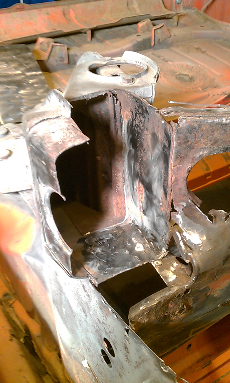

Back to it .............
Going to remove the remnant of the rear inner firewall.
Plan to leave to back one and the corner to see if I can reuse the corner.
First thing is to remove the rear engine lid cable tube.
Weapon of choice. Mapp gas torch.
Spot welds are marked and ready to be drilled out.
Still using Rotacut spot welder cut #2 (IMG:style_emoticons/default/cheer.gif) (IMG:style_emoticons/default/cheer.gif)

Removed the j-pipe. The red arrows show you were the 2 tack welds are. I've now removed two. Both pipes have had the tack welds in the same place. The problem being is the 3 lb's of seam sealer spread over the entire area. Makes it very hard to find the tack welds.
Here's the tore up corner that is on the car ..............
