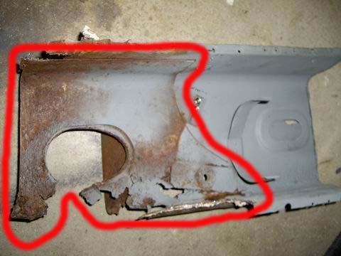

Looking for some help.............
Went back and re-read Jeff Hail's Dead thread.
When I tie in the new to me part that is double walled. How/can you cut back the existing inner wall without damaging it?
I want to build a new inner box to tie the two parts together.
Picture from Jeff's thread.

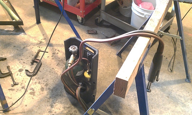

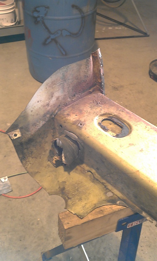

Back to it .............

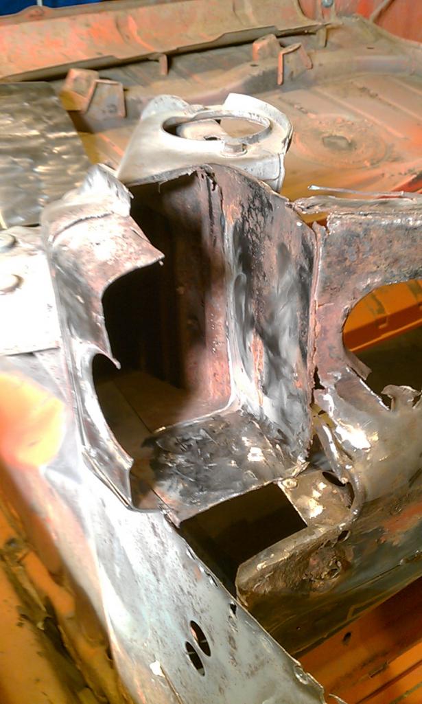

Going to remove the remnant of the rear inner firewall.
Plan to leave to back one and the corner to see if I can reuse the corner.
First thing is to remove the rear engine lid cable tube.
Weapon of choice. Mapp gas torch.

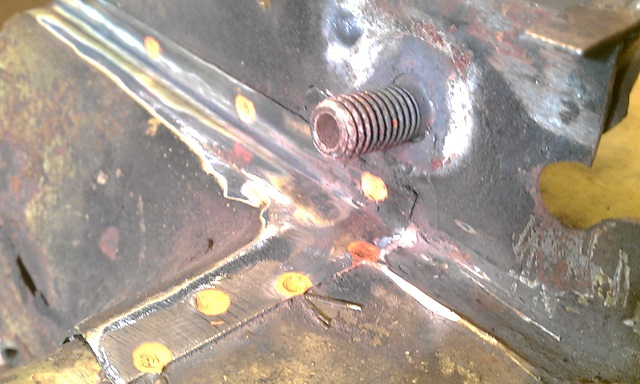

Spot welds are marked and ready to be drilled out.
Still using Rotacut spot welder cut #2 (IMG:style_emoticons/default/cheer.gif) (IMG:style_emoticons/default/cheer.gif)

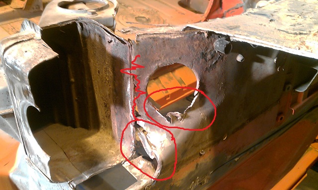

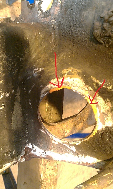

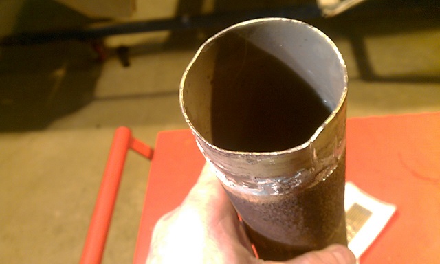

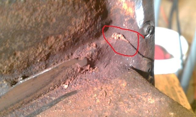

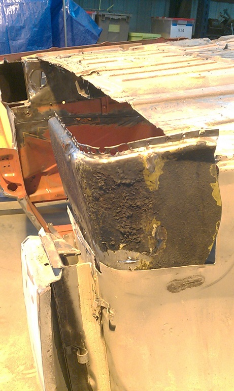

Removed the j-pipe. The red arrows show you were the 2 tack welds are. I've now removed two. Both pipes have had the tack welds in the same place. The problem being is the 3 lb's of seam sealer spread over the entire area. Makes it very hard to find the tack welds.
Here's the tore up corner that is on the car ..............

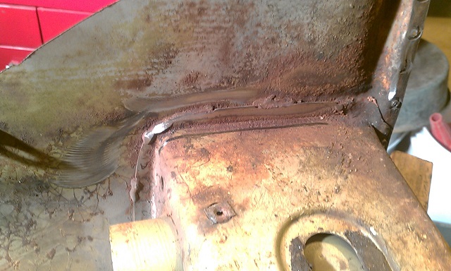

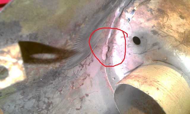

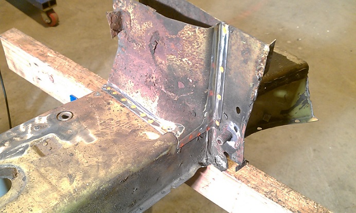

Now to remove the front inner fender .............
Tack welds were attacked with big and little cutting disks.
No way to get at this tack weld. So I cut it out from the back side with the
small cutting disk. Hit it dead on...... (IMG:style_emoticons/default/smile.gif) (IMG:style_emoticons/default/smile.gif)
Another tough spot ..............finished with cold chisel.

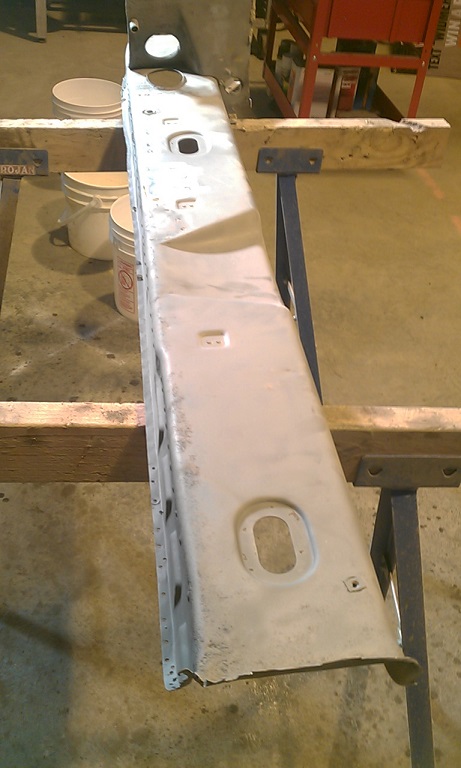

Here's the long after a couple hours of sand blasting ..................
Paint : very easy
Rust : a little more work
Seam Sealer : PIA ...........
All in all a pretty good day. It will still need a patch at the bottom of what was the jack
point location. Inner box needs a little work too ................

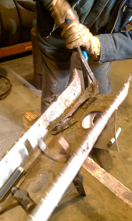

Another work day...............
I got the inner reinforcement out of the drivers wheelhouse long. So that when I install the new inner long it will be ready for the new inner box.
No real way to find or drill out the spot welds. So I just kind of pried it out of there.
Using Rick's BA screwdriver method, a little chisel action. Both hand and air.
Cut the inside edge with a Dremel disk. Took a few. But it got the job done.
Turned out pretty good.
