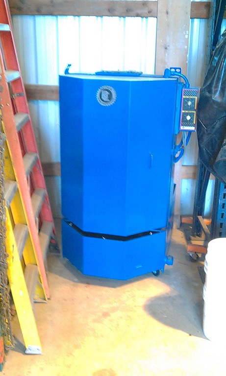

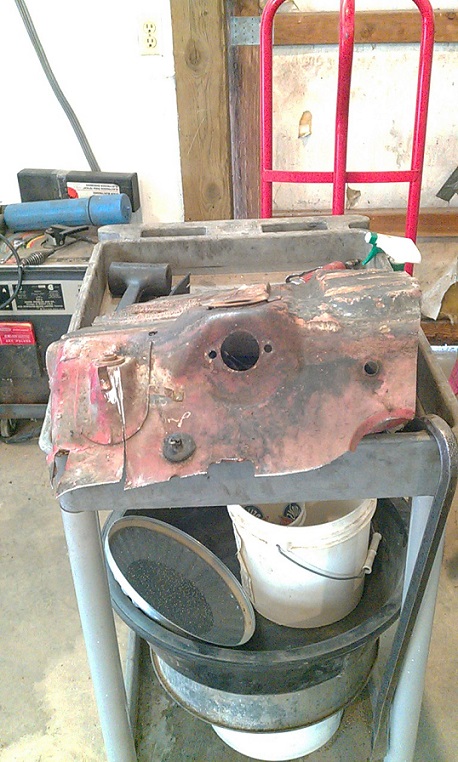

I unpacked the brake master cylinder floorboard area I bought from Bruce.
Looks really nice. I'm thinking it might be my first real part to get washed in the parts washer.
Waiting for it to warm up enough so I can leave the soap solution in it without worrying about freezing.

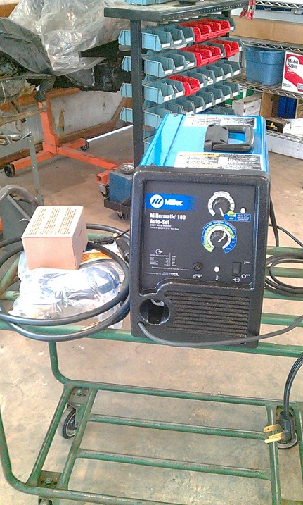

Finally broke down and bought my new Millermatic 180.
This is a milestone purchase for me. I've been wanting one for a long time.
But my 15 year old 90 amp Craftsmen 115v just wouldn't wear out.
Here she is right out of the box.

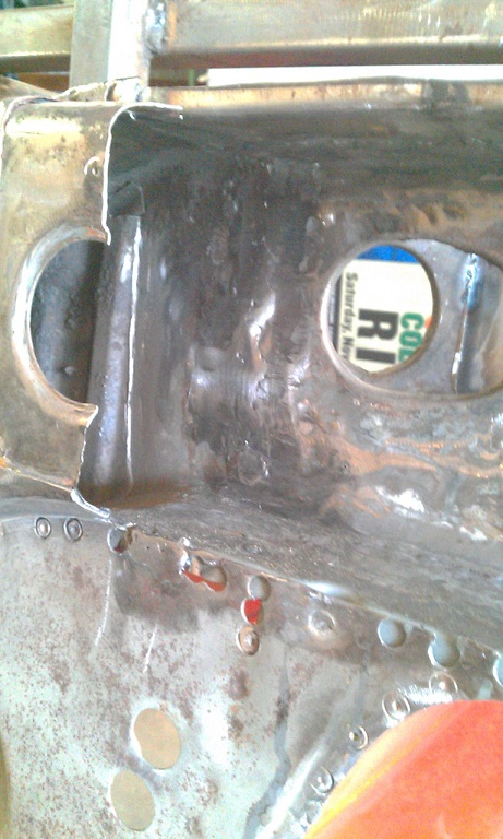

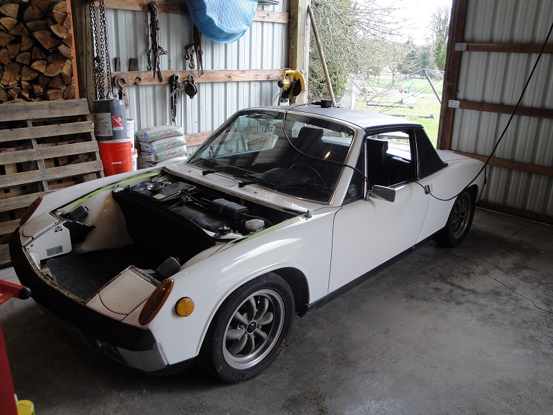

Test fitting the inner fender after trimming a bit off.

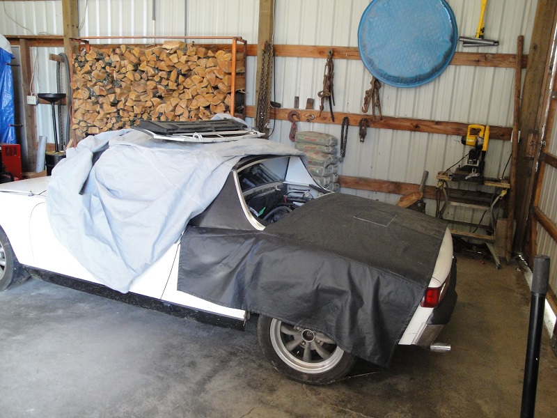

Taking a time out to get the other car ready for season opening AX on 3/15-16.
New front trunk seal with a little rust repair.
And welded the engine lid hinge bracket solid to the firewall.

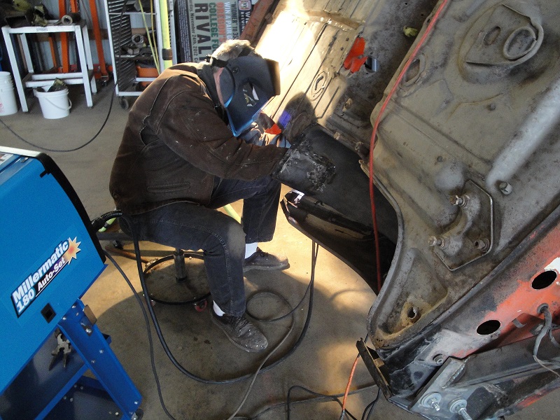

Back to work. Super In Law (82) back working on the inner fender patch.
Its our first use of the Millermatic 180.

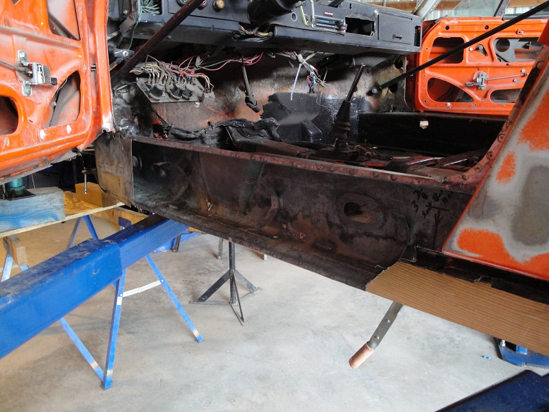

Working on setting things up to install the drivers long.
Asked for a little help on welding shrinkage.
http://www.914world.com/bbs2/index.php?sho...p;#entry1833832
Here's where we ended the day. Continuing to work on the fit.

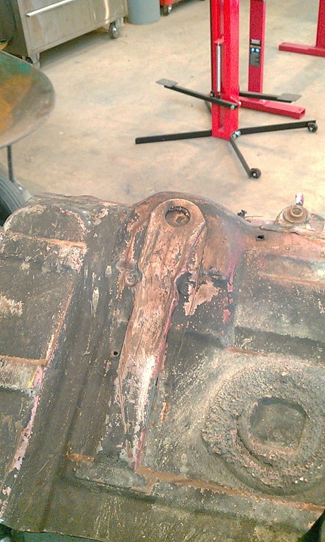

Had a little trouble with creating the patch under the jack point.
I did finally got the doors properly aligned.

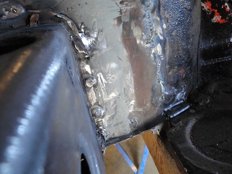

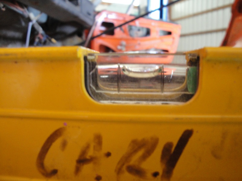

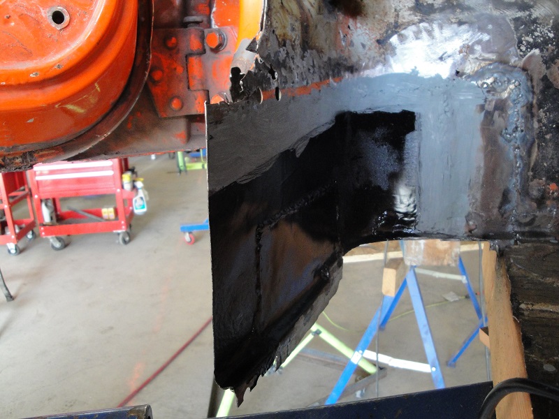

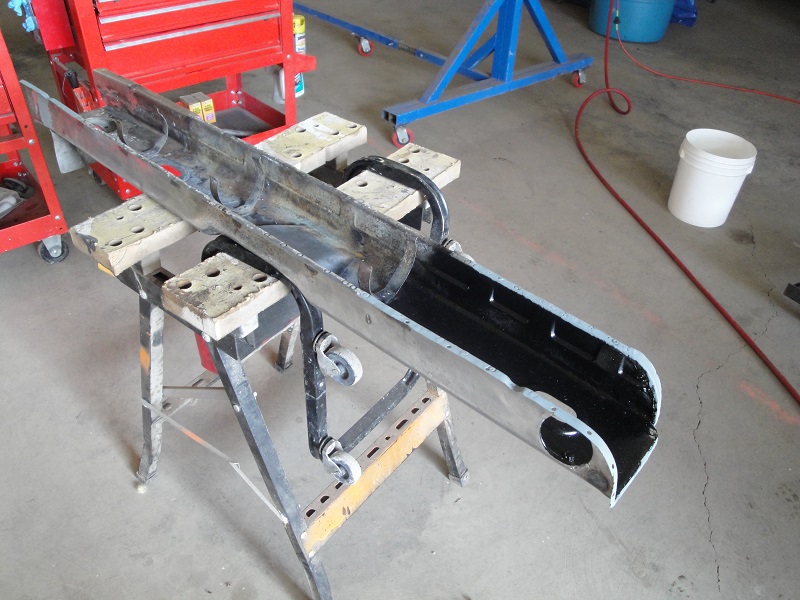

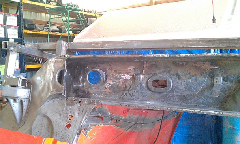

The day finally came. We installed the drivers long.
Here it is prepped and ready to go.
1. Flanges painted with brush on weld thru primer.
2. Cavity painted with Rustoleum.
Inner fender prepped with brush on primer and Rustoleum.
cary
post Mar 20 2013, 09:46 PM
Post #174
Posts: 3,900
Joined: 26-January 04
From: Sherwood Oregon
Member No.: 1,608

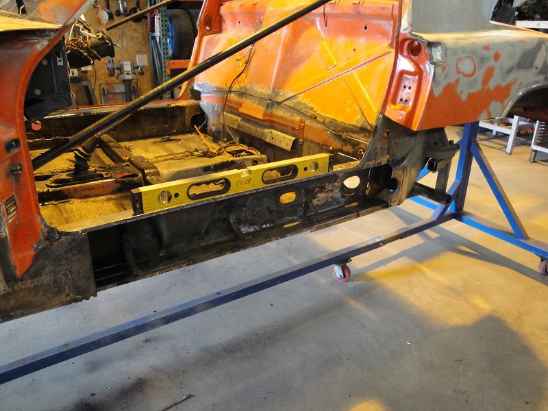

Here it is tacked in place and back on the rotisserie.
Both sides at exactly the same level. (IMG:style_emoticons/default/piratenanner.gif) (IMG:style_emoticons/default/piratenanner.gif)
Started with a door gap of 5.5mm, finished at 5mm. (IMG:style_emoticons/default/welder.gif)
cary
post Mar 20 2013, 09:54 PM
Post #175
Posts: 3,900
Member No.: 1,608

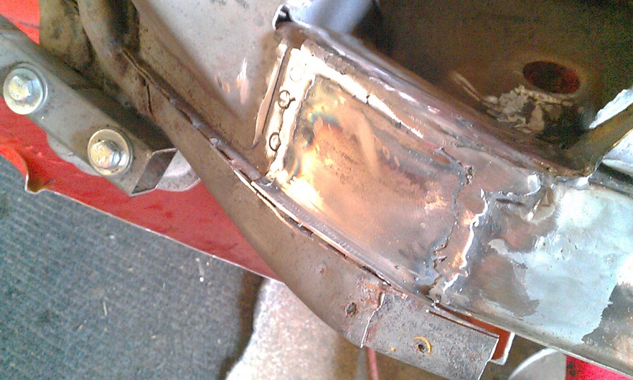

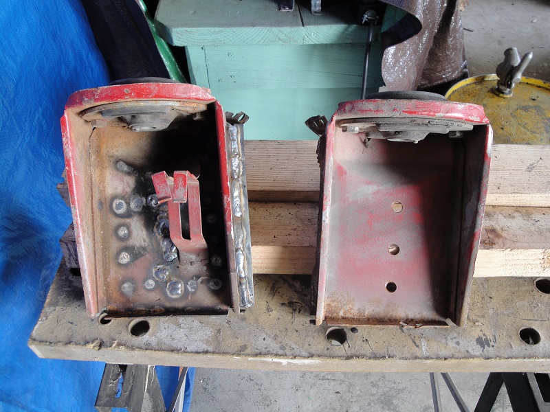

Here's the inner fender to long welds.
Mine are the two bottom ones.
1/2 plug, 1/2 tack. I don't want the bitch moving.
Super In Law got a little carried away on his.
By the end of this project I'll either be a master welder or a master grinder.

Things are looking up ..............

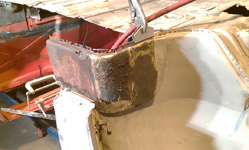

We patched the bottom of the drivers wheelhouse. The spot under the rear floor jack point. Super In Law had a little trouble trying to get the puddle to move without blowing holes in it.
I'll try and do some more work on the right side ................
Both sides are new metal. Don't know exactly what the problem was.
I think he's out too far with the wire.
Inside is just about prepped for the inner box.
cary

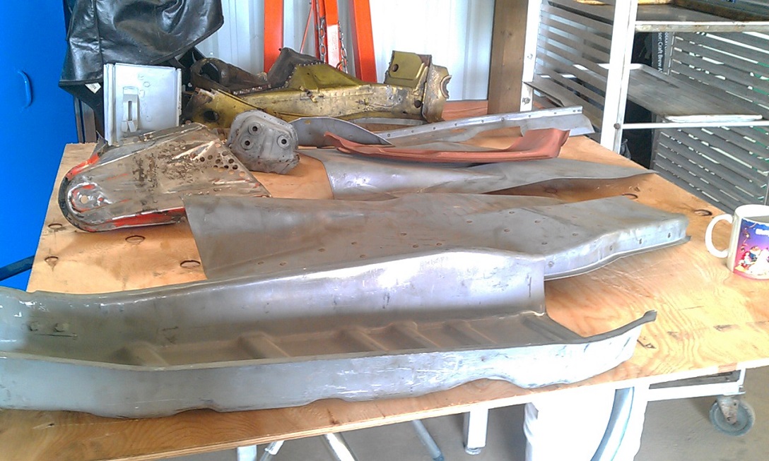

Laying out the next project..............
Complete passenger side wheelhouse replacement.
It's going to nice working with new metal.

QUOTE(cary @ Mar 25 2013, 07:49 PM) *
I've been following along, glad to see someone going deeper into a 914 than I have. (IMG:style_emoticons/default/popcorn[1].gif) (IMG:style_emoticons/default/smile.gif)
Just remember the replacement panels are galvanized - best to sand it off anywhere you're going to weld.
