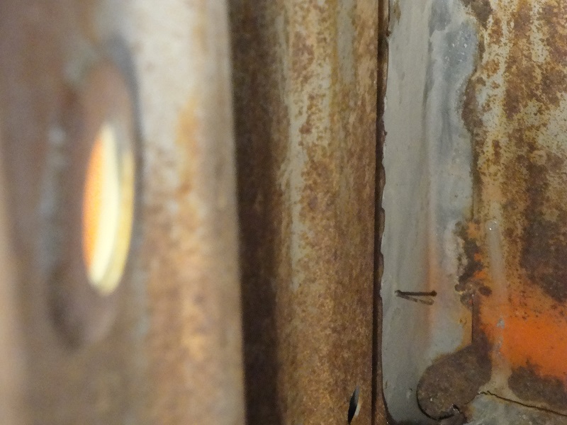

How does this deal work?
There is a light metal frame right at the base of the sail panel.
Just tacked in there with 4 wimpy welds, then a pile of seam sealer.

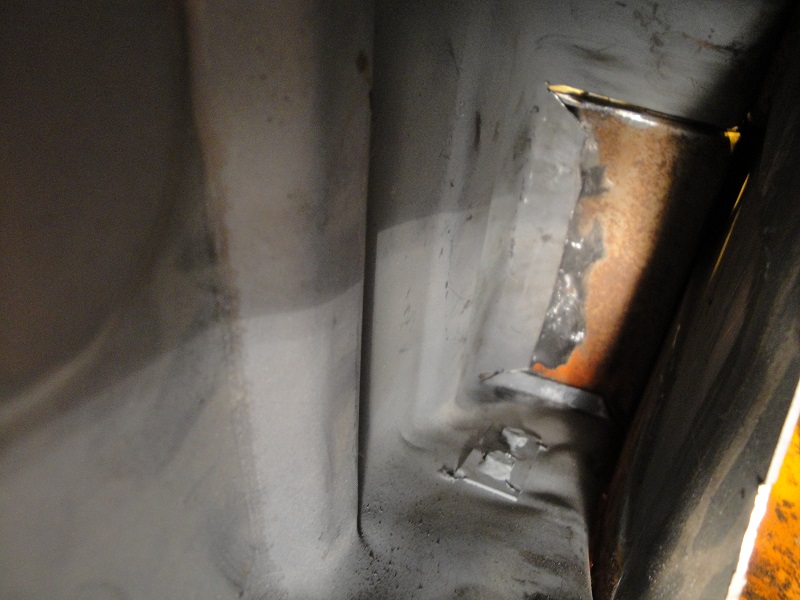

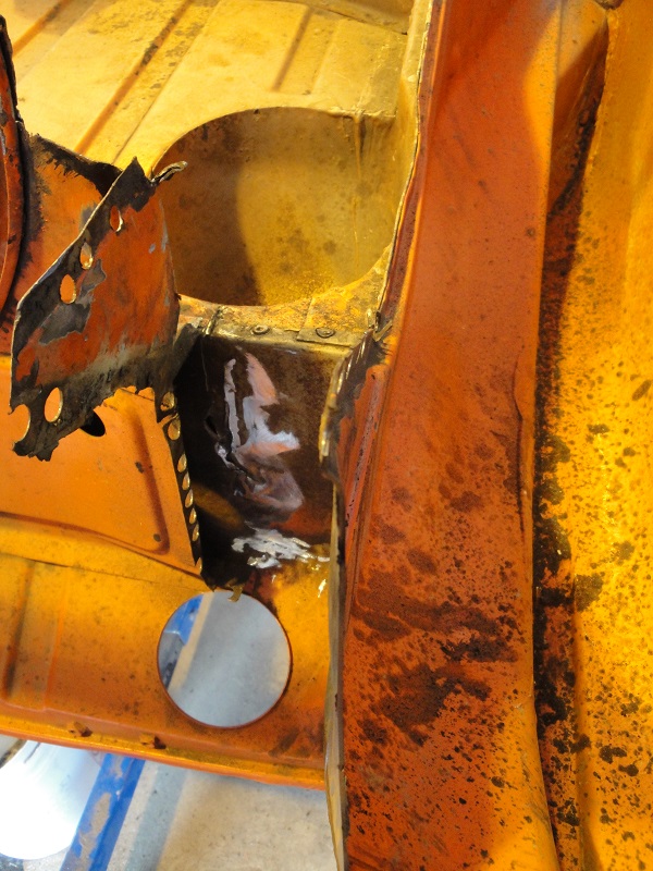

So decided that I would start tearing into the passenger side wheelhouse.
Start drilling out spot welds............... (IMG:style_emoticons/default/biggrin.gif) (IMG:style_emoticons/default/biggrin.gif)
Just when I think I can remove the inner wheelhouse longitudinal.
I find these tack welds way up at the end of the wheelhouse.
Not good............ I tried chiseling them out.
(IMG:style_emoticons/default/evilgrin.gif) (IMG:style_emoticons/default/evilgrin.gif) Poked a couple holes with the chisel.

Got it out. Cut it into three pieces to get it out.
Made a mess .............I'm thinking I went thru 6 cutting disks.

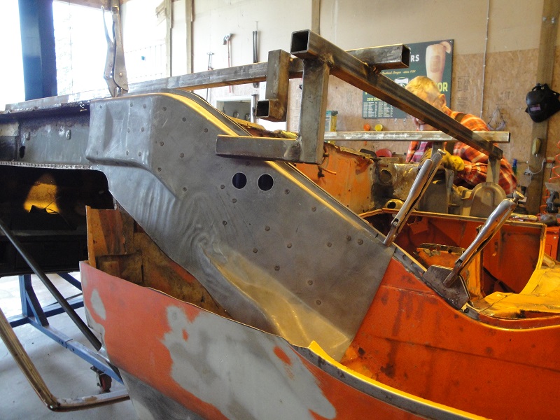

Test fitting a couple pieces. Inner needs some trimming to get it to fit against the trunk wall.

Now in lies the big question. How do weld back in the top of the
inner wheelhouse long against the rear trunk.
I'm thinking arc welder turning way down with a small rod?

QUOTE(cary @ Mar 27 2013, 08:20 PM) *
I would turn the mig up high and then make sure that you concentrate the heat at the larger metal. That's the problem with mig welding, because heat and fill are hard to separate. Stick is pretty similar in that regard. It sounds like you are worried about penetration at the long. Try a test piece of the same thickness. With your new torch I bet it works.

plug weld from the shock tower side

I don't think I can reach in there ....................
But I haven't tried.

QUOTE(sixnotfour @ Mar 28 2013, 02:11 PM) *
No access. Its backs up to a closed in cavity. The shock tower hole.

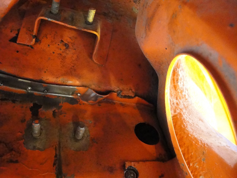

Next order of business.
Measuring the inner/engine long.
I'm using the hinge studs as a point of reference.
It was about a 1/4 off ..........................

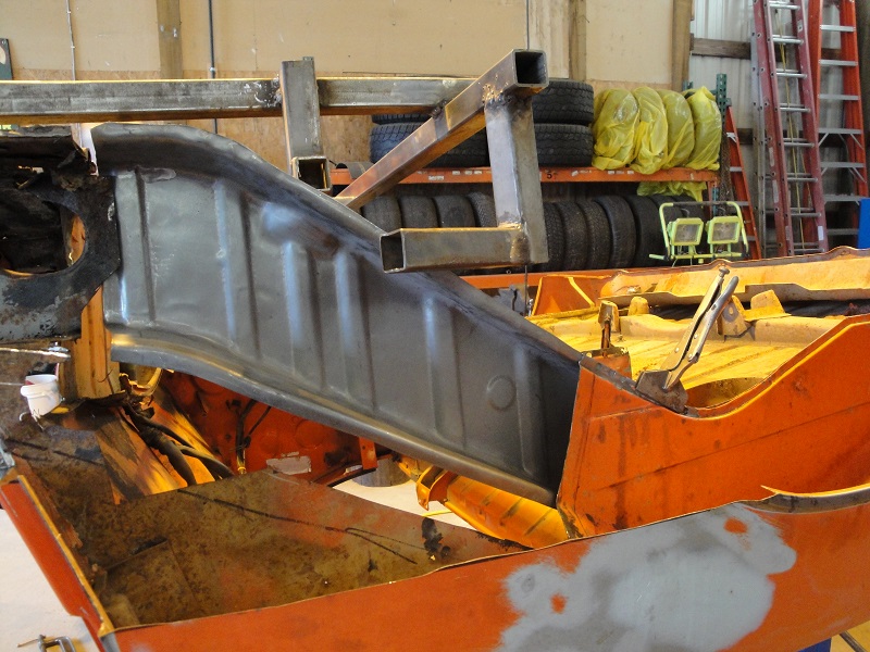

So I had to fiddle with the top end next to the back shock tower.
Still didn't fit. Had to recut the flanges.

Now it matches the drivers side.
Here's the virgin divers side.
Now the passenger side after I finish tinkering.
