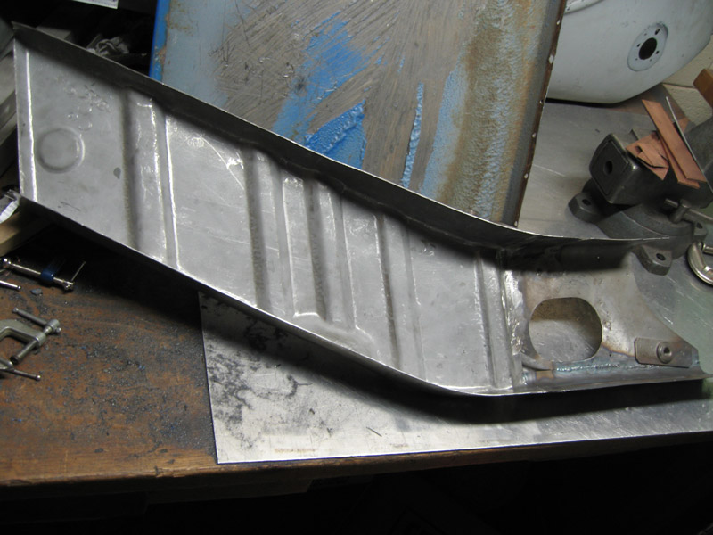

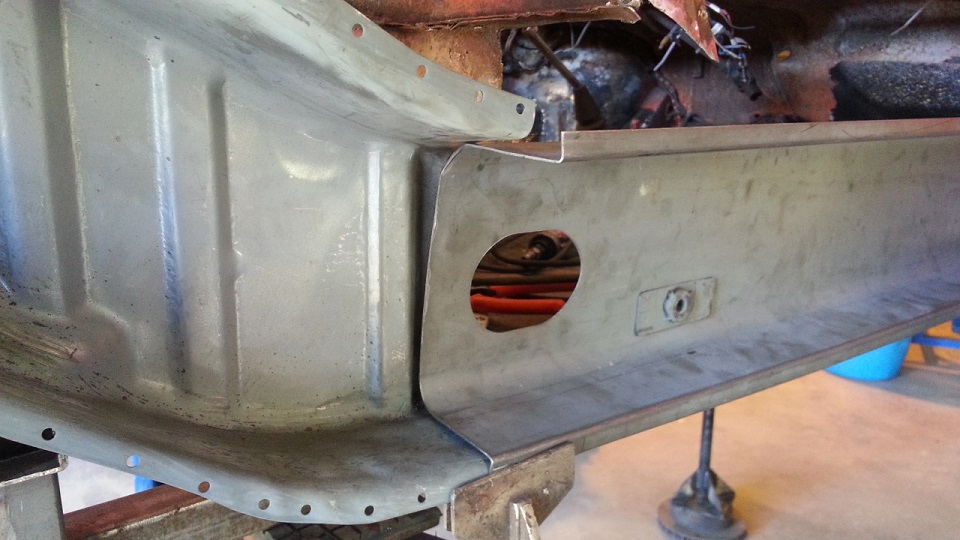

Here's the next piece we need to recreate. McMark called it the torque box.
The new outer long doesn't come with that piece.
In flipping thru the pages in the Body 914 manual. It looks like its a seperate piece.
Here's the new outer long from RD.
You'll see where the block and c-clamp is attached doesn't have the torque box.
Now you see the NOS door pillar. It doesn't contain the bottom of the torque box either.
But here's a picture with the door off.
Here's where we need to get too.
cary
post Nov 30 2013, 10:15 AM
Post #254
Posts: 3,900
Joined: 26-January 04
From: Sherwood Oregon
Member No.: 1,608
As I wrote the last post I'm thinking I have a good piece for the drivers side that I took off of the long I bought from Perry @ 914 Network.
When I get to the shop I'll have to do some digging.
Nothing has been tossed yet.

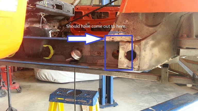

Here's the piece I'm looking for.
It has to be created like the factory piece so it will fit under the RD frame stiffener.
But after spending an entire day tinkering with the door alignment. This is one of the most important attachment points on the car. Very critical in the upper 1/2 of the door alignment.
I think I'll some research on the PET to see if the part exists.

I stand corrected. The NOS part picture is the complete part.
The blue car looks like it has an RD 346 frame stiffener installed.
The primered car is Jeff Hail's 1st. class metal work.
It's interesting how these pieces are layered together.
If you would want to take this apart in the future you can't put any welds behind that torque box at the bottom of the a-pillar. Hmmmm.

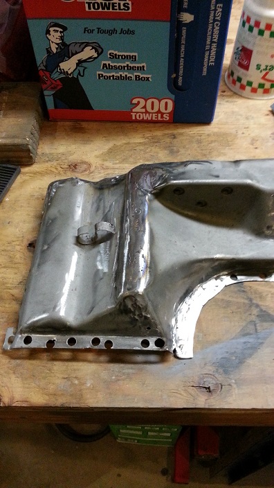

Found the part in the parts pile.
Here's the place that needs repaired.
cary
post Dec 1 2013, 10:04 AM
Post #260
Posts: 3,900
Member No.: 1,608

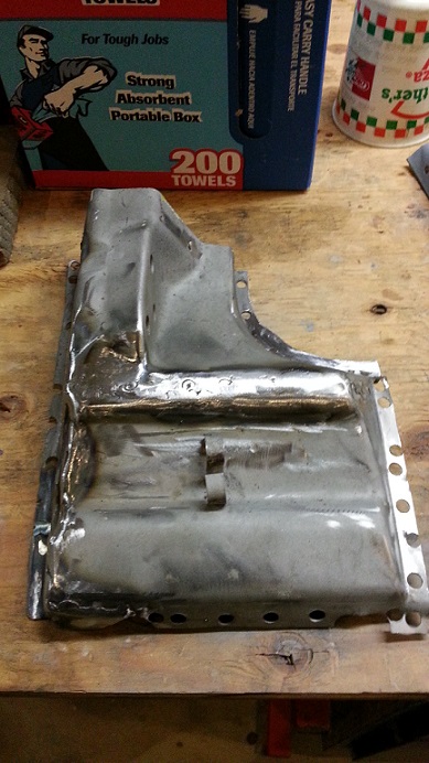

Here's the only patch I had to put in.
Pattern cut out of cardboard.
Patch ready to weld in. Old metal got a little religious on me.
cary
post Dec 1 2013, 10:13 AM
Post #261
Posts: 3,900
Member No.: 1,608
All repaired and ready to shoot on some Rustoleum.
I'm learning not to over grind the thin spots LOL

But that gave me some ideas about how to tie in the new passenger inner wheelhouse to the new inner long. JPG is where I'm at. Long is not welded in.
Looks like Nathan fabricated a new inner layer.
Thats over my pay-grade. Whoa.
But I do believe I will create piece that goes into the long.
The caveat is, is that the new inner wheelhouse is considerably thicker that the original piece. But I'd still like to be double layered.

Then I went digging thru the take off/ cut out parts that came out of the long I bought from Perry.
First I determined that I created one of the inner boxes to short. So it will have to be cut off and redone.
cary
