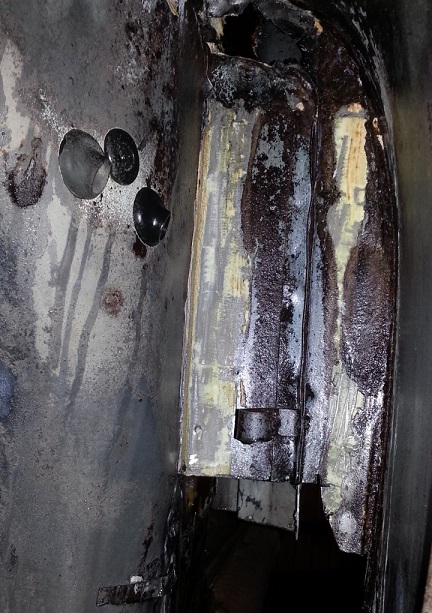

It's a lot of work to make not only the inner forward of the firewall with the relief for the floor, but the outer rear of the fw is a real pain with the engine shelf cut out and the radius, the bend, etc.
You might want to do it the way Jeff Hail did, kind of an in-between way, the corrugated piece stays on the outside. It would help to add the top and bottom to the inner that the template is representing there, 3-dimensionalize it for strength, like the factory, but not as elaborately shaped. Seems like He should have brought it forward more to double layer where the lower seatbelt nut is

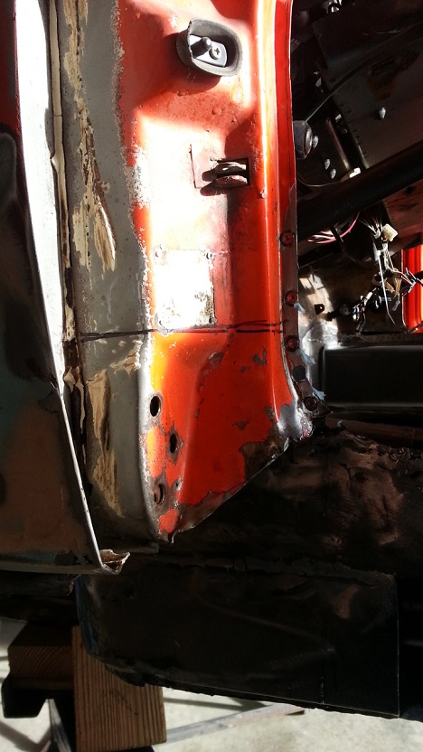

Still chilly in PDX. 32 degrees when I made it to the shop at 9:15.

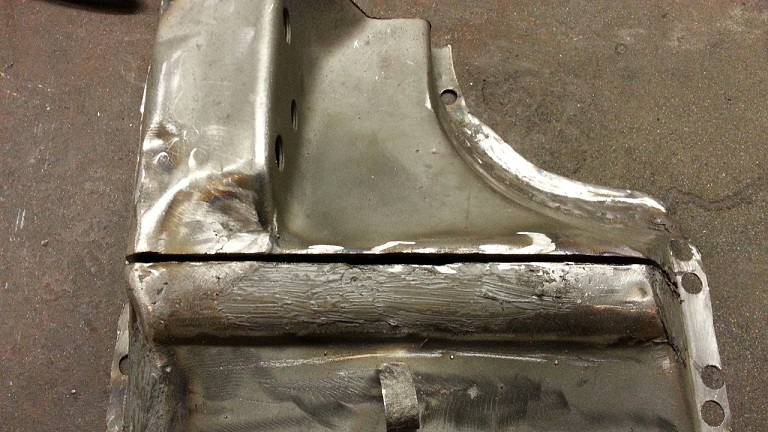

Decided to put on my big boy pants and cut the door post.
BEFORE
AFTER
That will have to be cut in order to slide the inner rocker in place. Dumbass, I shouldn't have bothered seam sealing it.

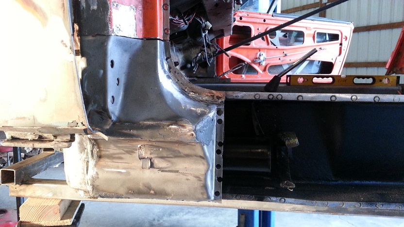

I went ahead and added to the inner portion of the wheelhouse extension.
Might be a bit too long ...................
Plasma cutter will make short work of it if need be.
Learned today I need to do a better job of making sure the pieces are perfectly flat before I weld them. That way I won't end up with the craters on the outer edge. (IMG:style_emoticons/default/mad.gif)
Then I test fit the outer wheelhouse extension over the inner. A little long on the top .............
Bottom right corner needs a little hammer work too.

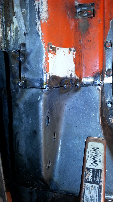

Then we dug into the left hinge post and fender support.
Trying to figure how to patch the upper hole without removing the fender.
Sprayed down with Ospho

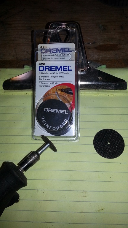

Tool Whore Comment :
First time I've used the reinforced cut off wheel for the Dremel. Impressive.
So I bought a couple refills.
Works great when you want to peel back a double layered section.
The brown thin ones are a POS. I usually cant make it from the bench to the car without breaking one.

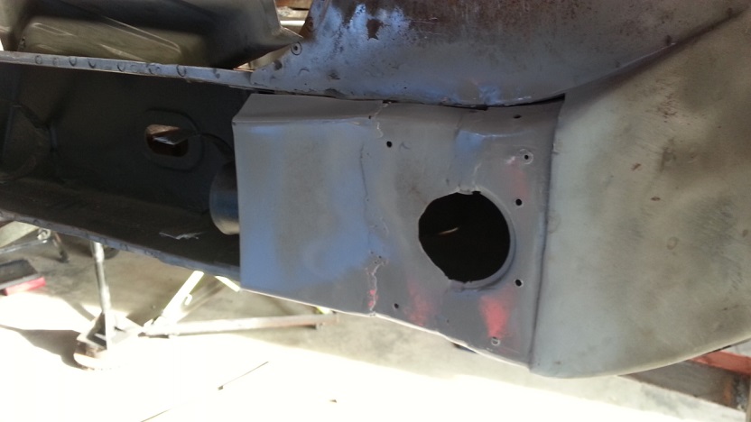

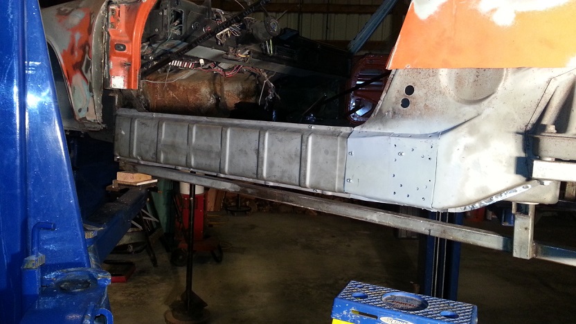

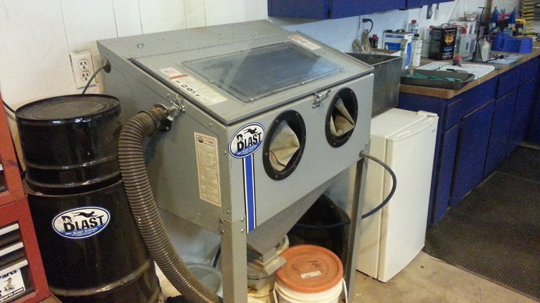

Decided it was time to build up the right long. So I need to tidy up the heater pipes.
Time to use the blast cabinet. Just finished giving it a tune up. New hose, nozzles and shield.
cary
post Dec 28 2013, 10:13 PM
Post #276
Posts: 3,900
Joined: 26-January 04
From: Sherwood Oregon
Member No.: 1,608

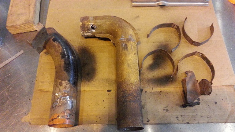

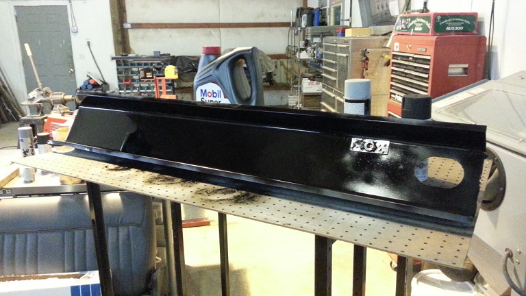

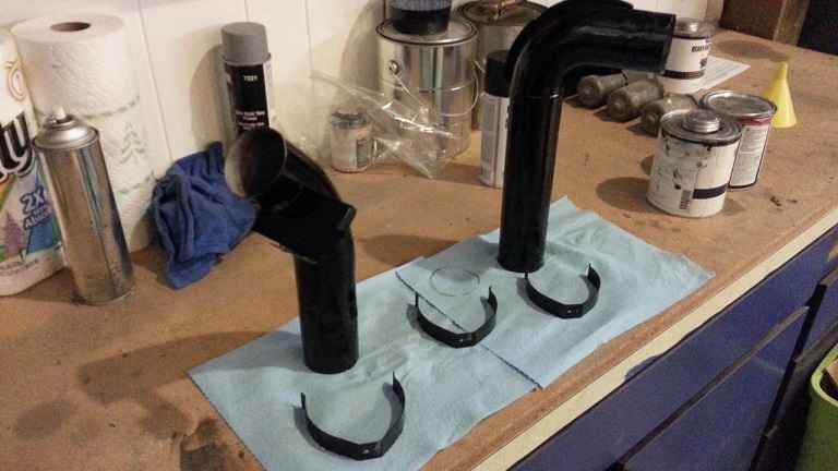

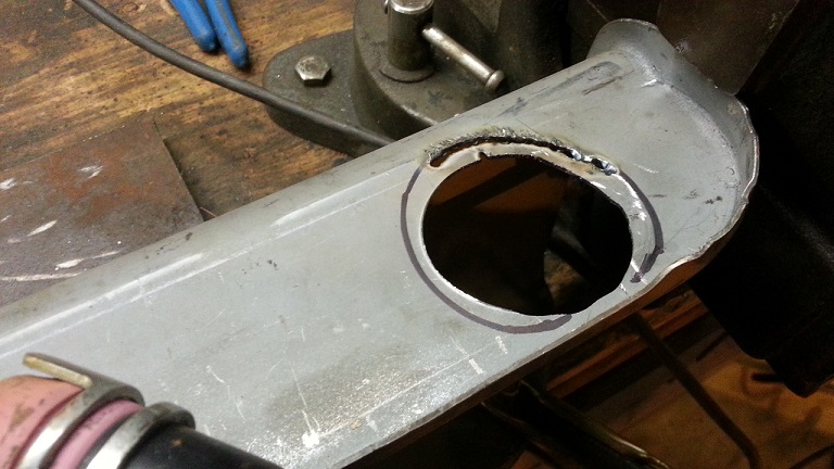

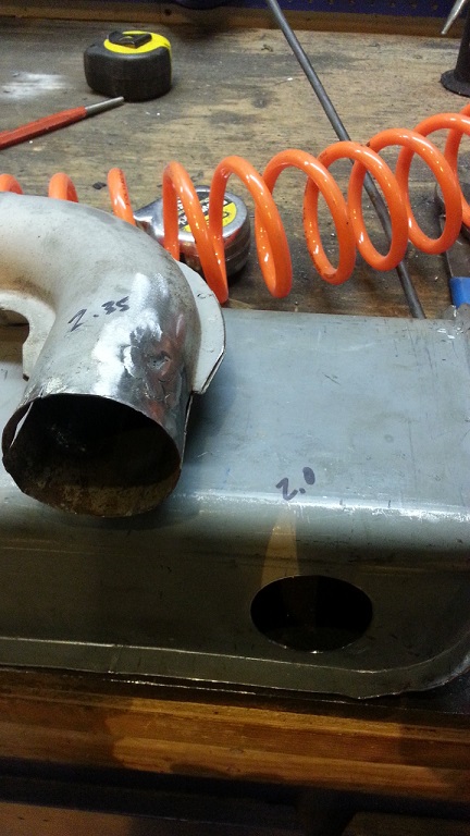

So I begin to prep the long. Come to find out the hole in the new long is 2". The heater pipe in 2 3/8". Dandy ..............
So time to hook up the plasma cutter. Getting a little better at setting it up and free handing it.
After a coat of primer. It's time for a couple coats of Rustoleum.
cary
post Dec 28 2013, 10:28 PM
Post #277
Posts: 3,900
Member No.: 1,608

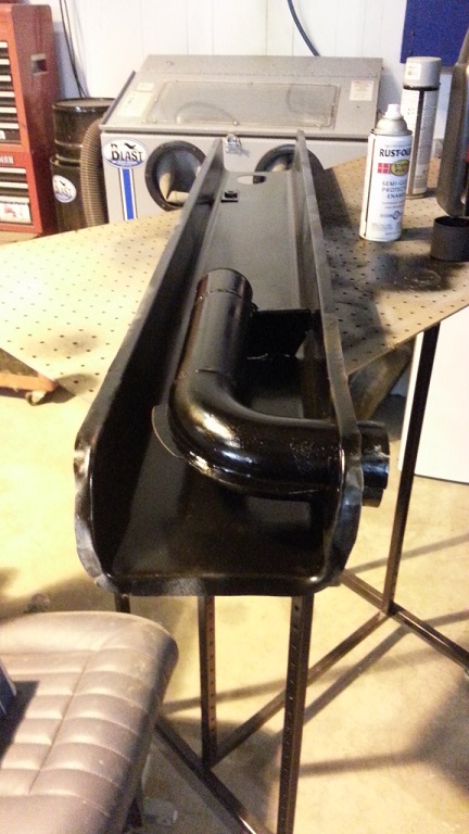

Pipes all primered and painted with Rustoleum.
Long all built up and ready to install. Make sure you install the heater pipe before you mount the long.
Spent the rest of the day adjusting the left outer rocker position. I had to relocate the position I'd been using. Couldn't get the bottom of the hinge post lined up.

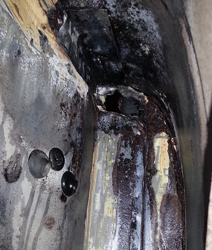

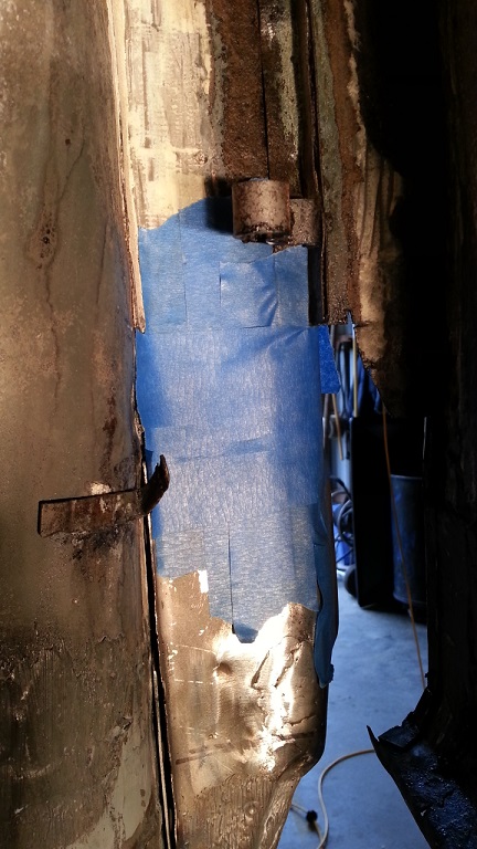

Time to create a pattern to extend the hinge post that I'd already prepped. I cut out some cancer inside the left front fender. I used the Ed from Wheeler Dealer tape pattern technique.
Worked pretty good. Should have cut the pattern inside the lines.
cary

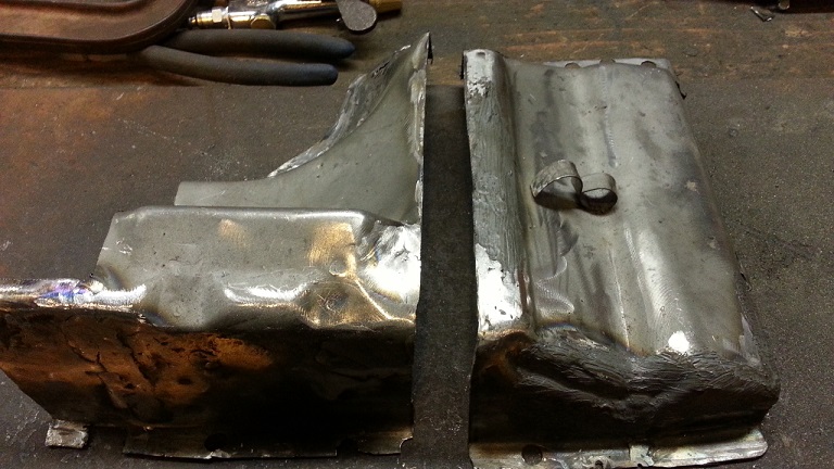

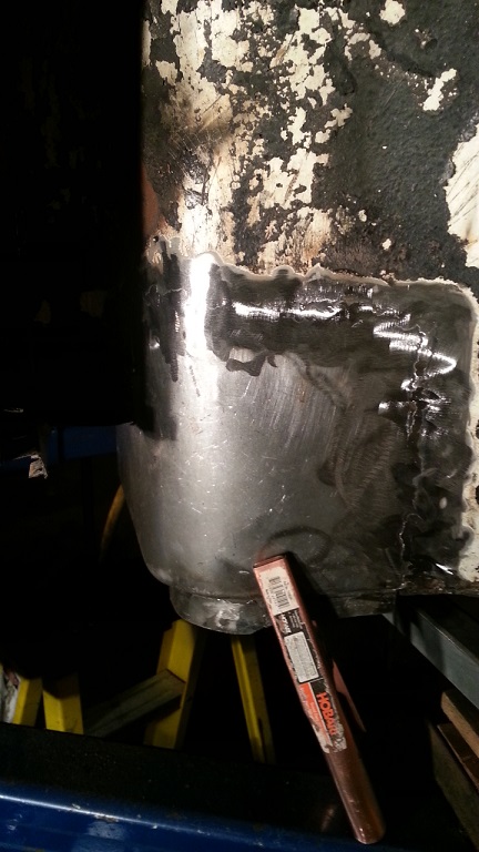

Spent quite a bit of time fiddling with the fit. Had a tough time creating the rounded out of site corner. Once I had it trimmed and fitted it was time to cut the bottom off so the inner rocker panel can be installed.
cary
post Dec 29 2013, 09:55 PM
Post #280
Posts: 3,900
Member No.: 1,608
Ended the day with tacking in the hinge post base. Tough duty welding material that can't be totally prepped. Backside

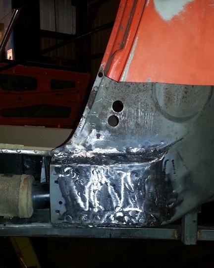

Here's yesterday's repair. Making those little patches is a lot of fiddling..............

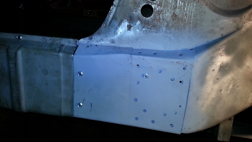

I started with trimming the flange off the firewall. I've decided I'll attach a backing plate to the firewall. It will grab 6" of the upper and 6" of the lower long. Not exactly CW but it will add strength and structure.

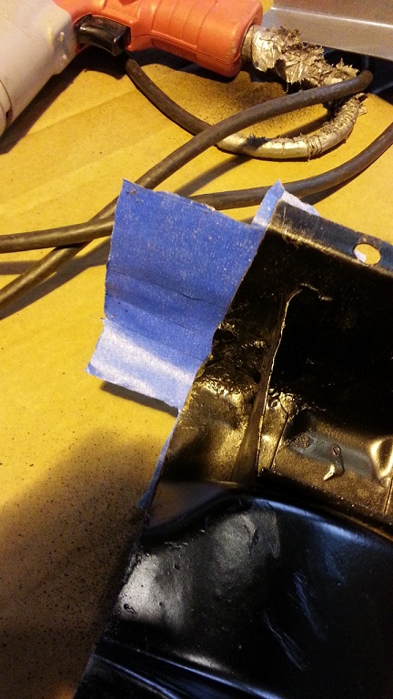

After I trimmed it off .............
