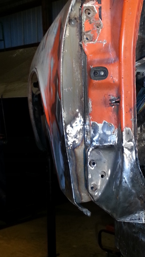

Here's yesterday's repair. Making those little patches is a lot of fiddling..............

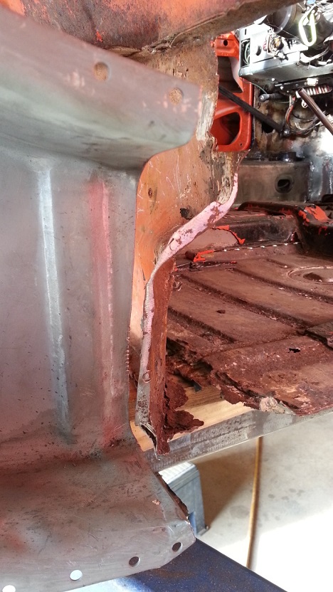

After I finished modifing the front end of the long.
I made the MONEY CUT .................
Only measured about 6 times.
Bad news. It will need more fiddling. The upper long is wider than the lower long. (IMG:style_emoticons/default/mad.gif)
And the bottom radius of the upper long doesn't match the back lower radius of the lower long.

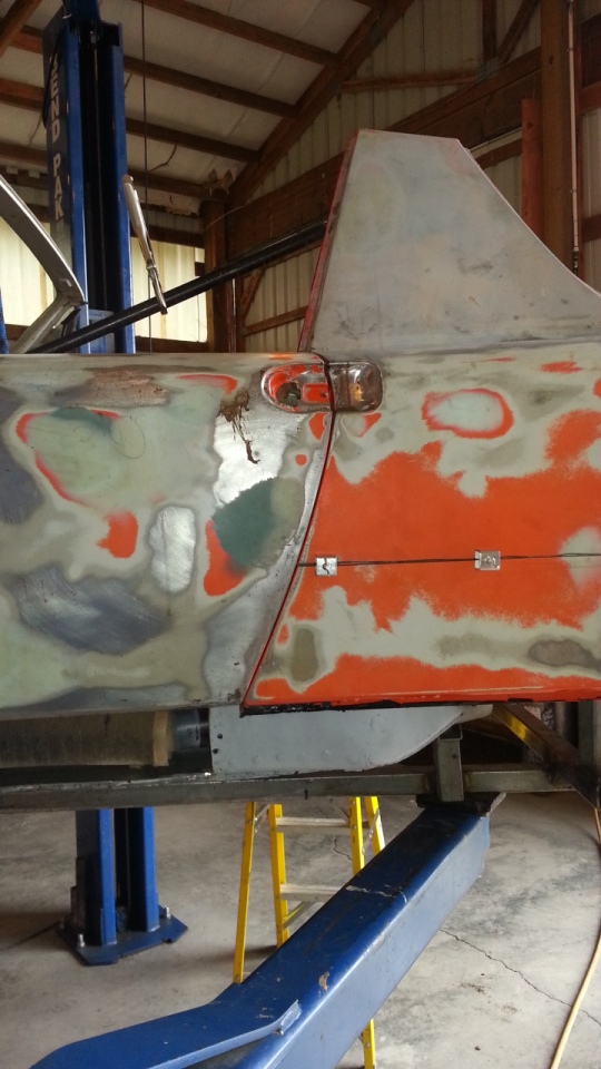

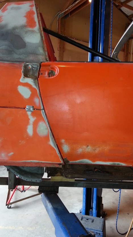

Ended the day with measuring the door vs. the long on the inside.
Drivers side, long already attached.
I'm real happy with that ...................... (IMG:style_emoticons/default/smilie_pokal.gif)
The right side ............... not so much. Glad its not attached ......................
A little more fussing with that front end will lower the front a 1/4 inch.

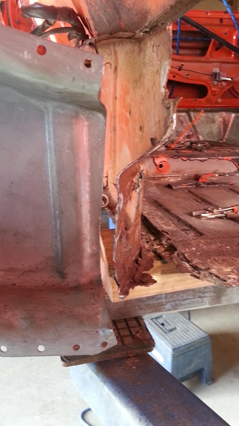

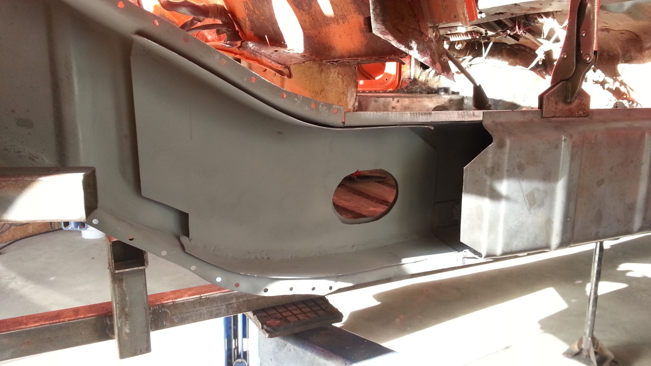

Here's where I struggled today.
This is how the front end of the RD piece comes.
I finally found the picture I was looking for.
Here's how it came from the factory.
Here's what needs to happen ..................
THEN it will slip into the inner fender like it should.
Waste of a 1/2 day. No wonder restorations cost $200k.

Here's the trimming I needed on the front end of the long.
Upper Trimmed
I needed to modify the curve to match the inner fender radius
Lower Trimmed
The Sharpie mark is where I finally cut off the lip too.

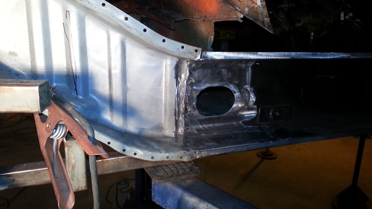

Finally, the right long installed ............ (IMG:style_emoticons/default/smilie_pokal.gif) (IMG:style_emoticons/default/smilie_pokal.gif) (IMG:style_emoticons/default/smilie_pokal.gif)
Tough welding, under the car. Arm stuck up throw a hole. Helmet all jammed up and twisted. Over did the weld ............... (IMG:style_emoticons/default/mad.gif) (IMG:style_emoticons/default/mad.gif)
Happy with the penetration though .............
I'll wait to tidy up the welding till after I remove the floor. (IMG:style_emoticons/default/welder.gif)
Plus I'd like one more behind the heater tube.

Here's the long seam weld. Should have been better looking.
Tried to pass thru the tacks. I should have knocked them down with the grinder before I finished the seam welding.
