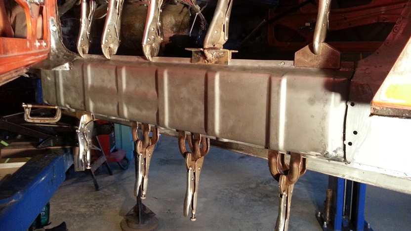

Finished welding in the left rocker.
Nice .....................
Then moved on to installing the right long inner box.
Pre-drilled the holes.
Sprayed with weld thru primer, again.
Stayed away from the long seam weld. Rosette welds only. No seam welds.
Finished the night with seam sealing over all the welds and the two edges laying on the bottom of the longs.
Today's lesson. Don't spray on TOO much weld thru primer.
Spitter, sputter .............
Today was the last shop day of vacation. Didn't meet my goal of getting the car off the lift. But I'm close.

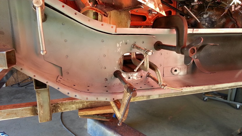

I'll add a couple notes :
The upper long did end up coming together fine. Had to do a little reshaping on the upper to get it to align with the lower.
Final result ...............

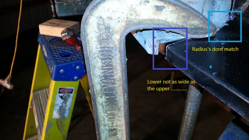

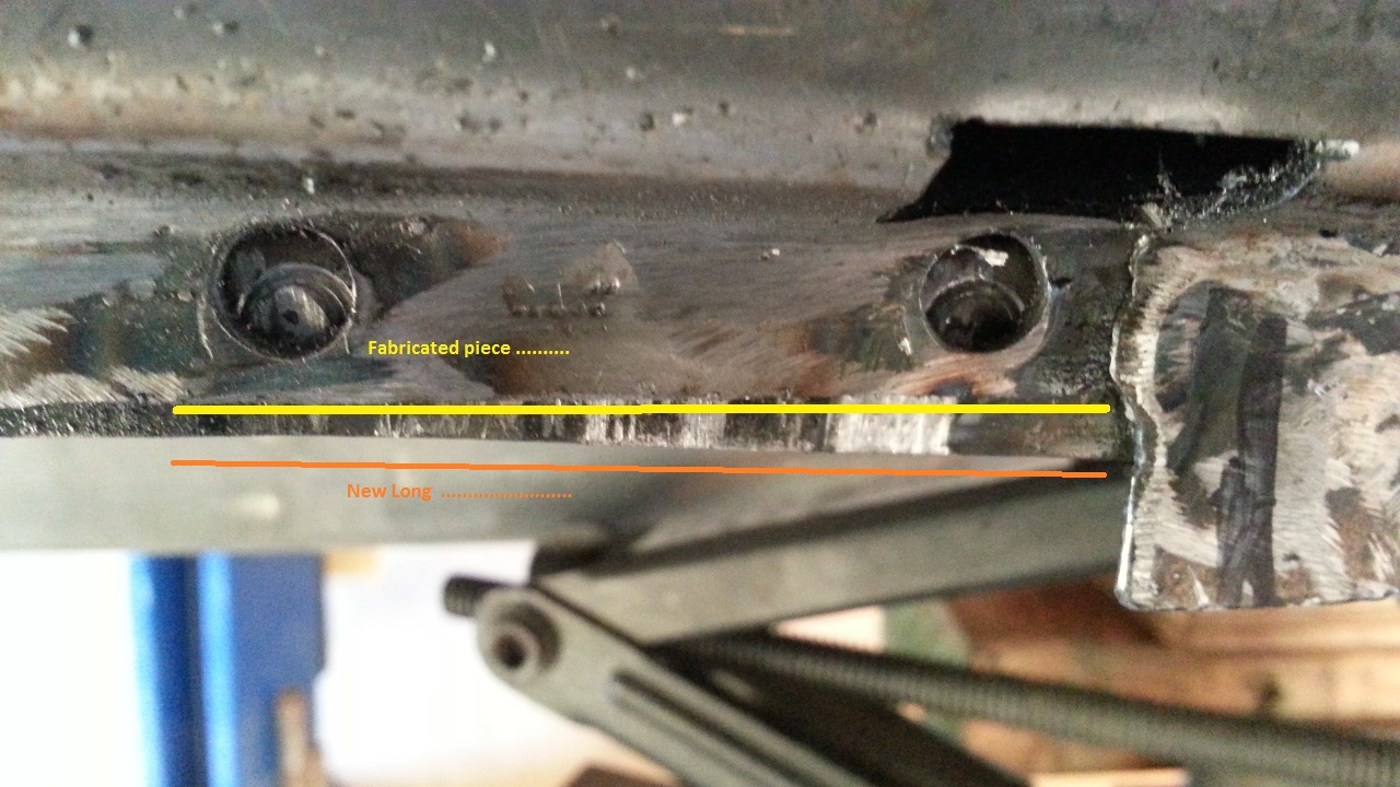

NEVER, NEVER............NEVER
Take the car out of door alignment to tinker with a fit. (IMG:style_emoticons/default/headbang.gif) (IMG:style_emoticons/default/headbang.gif)
I'll let you in on my biggest mistake ...................
First, on both the inner fender corners we created, the bottom edge wasn't perfectly horizontal. This is where the Celette would be nice. Something to measure against.
I'll figure out something for next time........
Second, I was thinking because I didn't have the outer rocker attached I could tweek the long to tidy up the fit. NOT
Here's what I did ........................
Doesn't it look beautiful.
After I cut out the welds ........... That little bit kept me from aligning the doors.

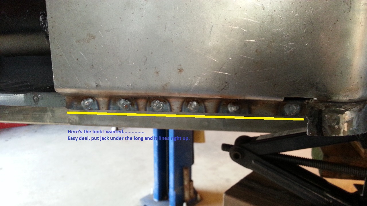

Finally got the car off the lift .............
Bought some leveling jacks
Here's where we started .............
cary
post Jan 27 2014, 11:22 PM
Post #318
Posts: 3,900
Joined: 26-January 04
From: Sherwood Oregon
Member No.: 1,608
Finally off the lift ........................ now I can get back to work.
