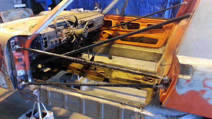

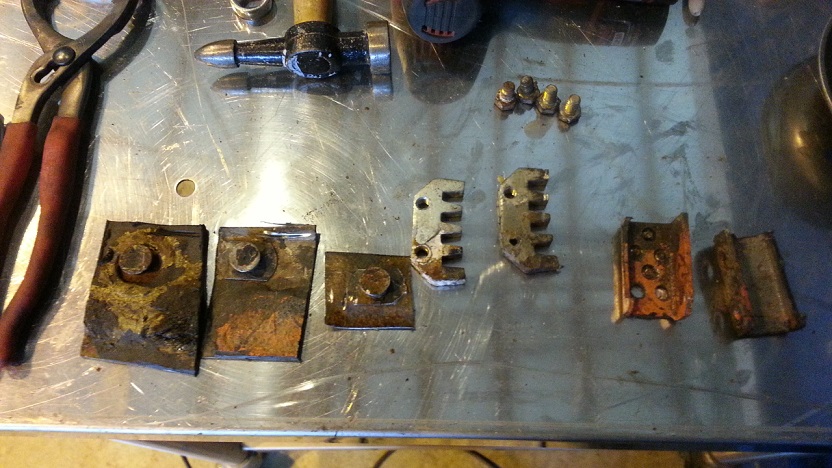

While Super In Law is building our new door braces I decided to do some housekeeping. I needed to cut out a few parts from the sheet metal that will be scraped.
Here's the new door braces. I want to be able to flip it upside down and not have to worry about everything staying in place.

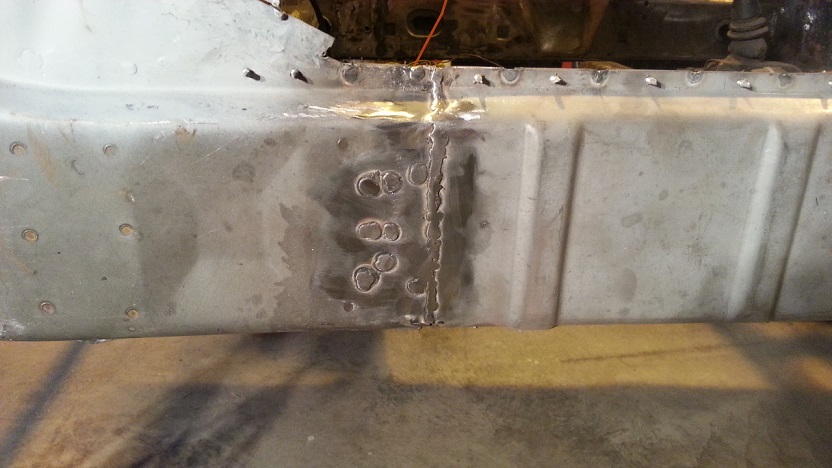

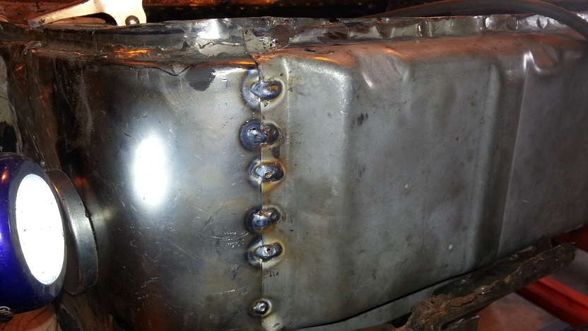

Tried some thing a little different. I pulled the puddle up while I was stitch welding the rocker seam.

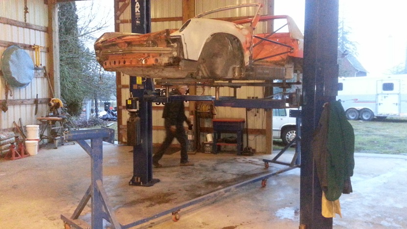

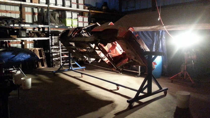

Finally putting her back on the rotisserie.

Heading home ....................

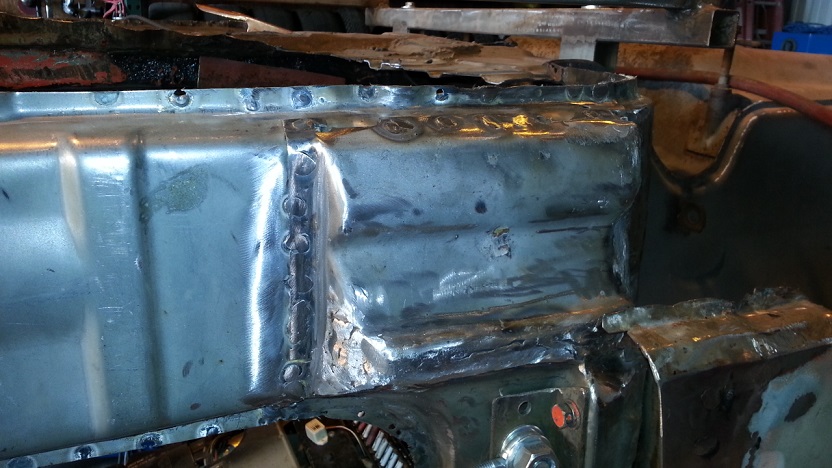

Spent Wednesday finishing up welding in the inner rockers and grinding down the rosettes.
Then I went after the hinge post bases.
Finished up welding in the left side.

I finished up welding the long to the front wheel well.
This is some of my best welds. Practice, practice ..........practice.
