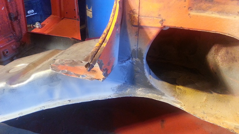

Then I went after a bad spot on the bottom of the left wheelhouse that I didn't like.
It was just too thin.
So I welded in a patch.
Before grinder .............
Then I attacked cleaning up my crappy overhead welds from being on the 2 post lift. I haven't figured out overhead welding yet ........
Looks like my farmer welds back in Montana.
Tidied up ..........

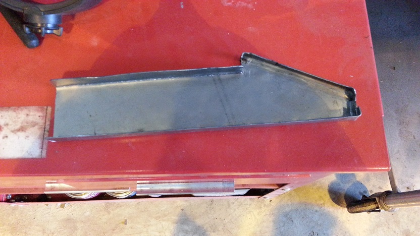

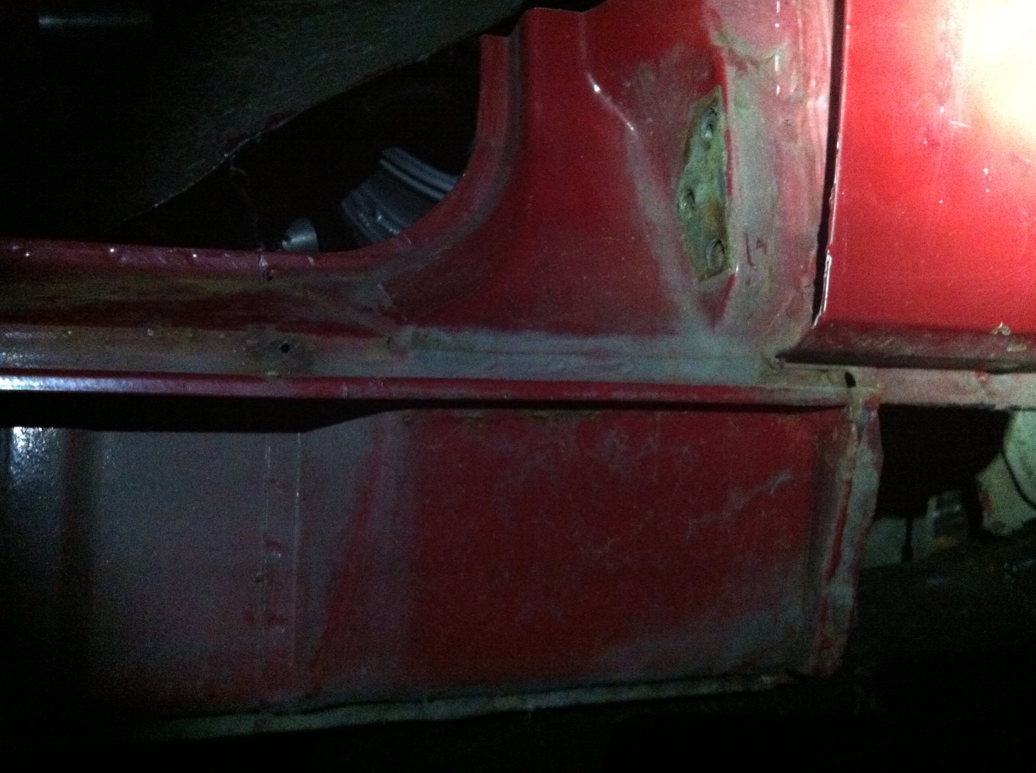

I ended the day seam sealing the long to inner rocker flanges.
Plus Super in Law fabricated a new fender rocker end cap.

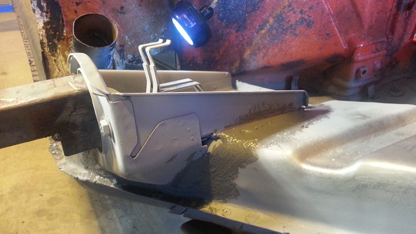

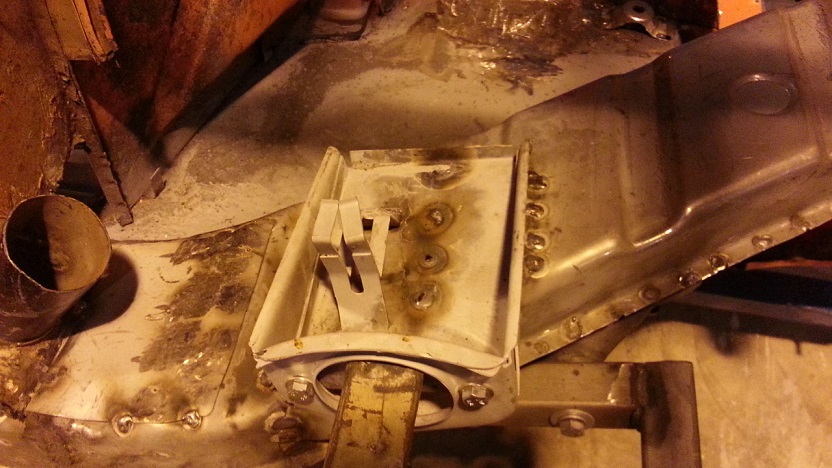

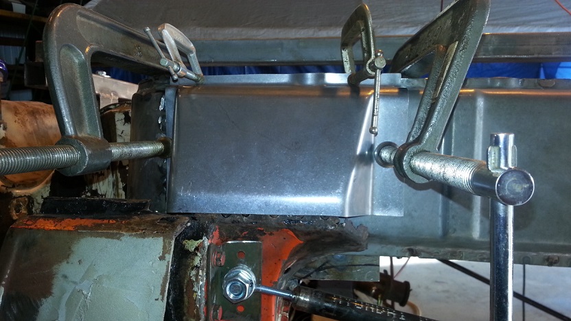

Been a couple weeks.

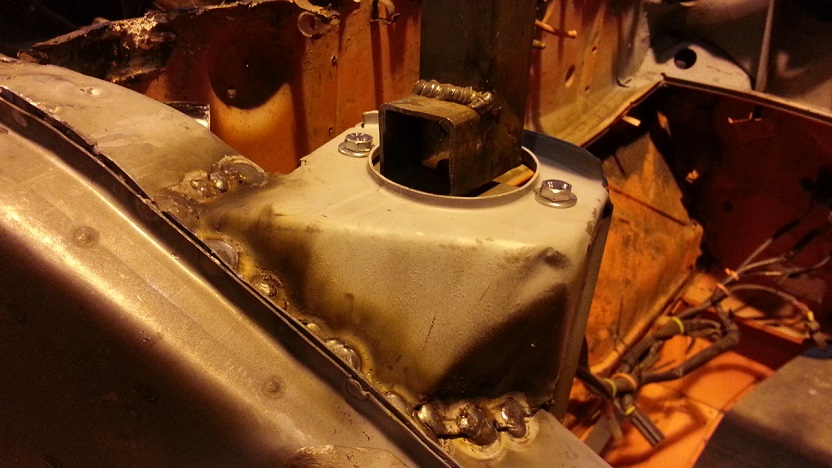

Installed the motor mount that was given to me by worn.
Having the jig made installing it pretty simple.
Tidied up the inside of the wheelhouse and installed the hinge pivot.

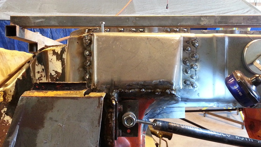

cary
post Feb 27 2014, 09:49 PM
Post #335
Posts: 3,900
Joined: 26-January 04
From: Sherwood Oregon
Member No.: 1,608

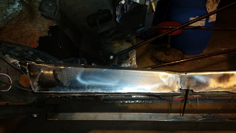

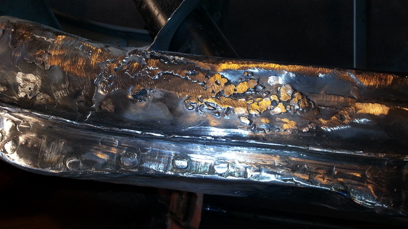

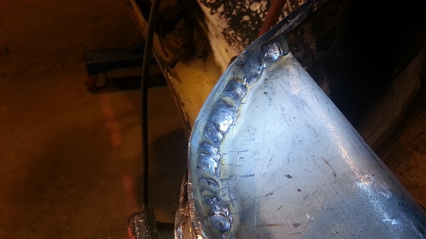

Then I finished welding the upper long to the suspension tower.

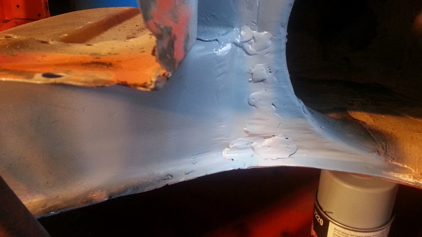

Finished welding .........................
Was a good boy and didn't over grind the welds and metal.
Seamed sealed ..............

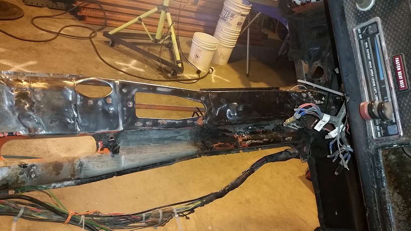

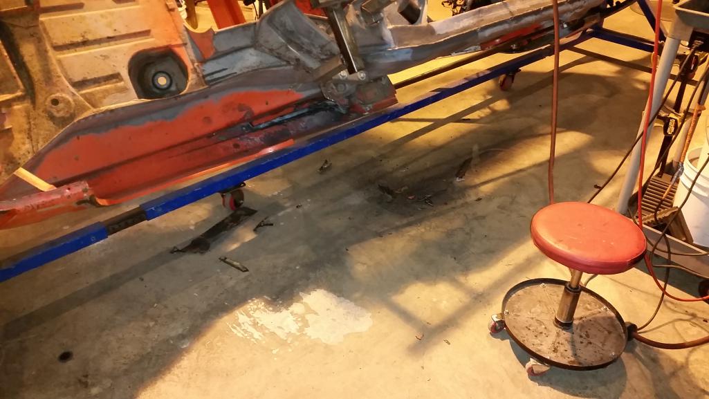

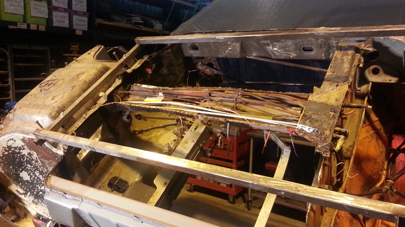

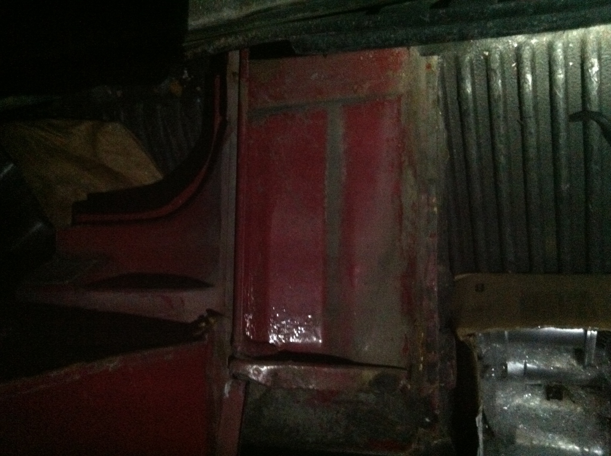

Then I get to removing whats left of the floor plan.
Finally I get the tunnel opened up .... (IMG:style_emoticons/default/piratenanner.gif) (IMG:style_emoticons/default/piratenanner.gif) (IMG:style_emoticons/default/piratenanner.gif)
Don't miss the two spot welds under the corner/foot brace.

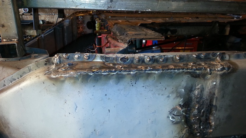

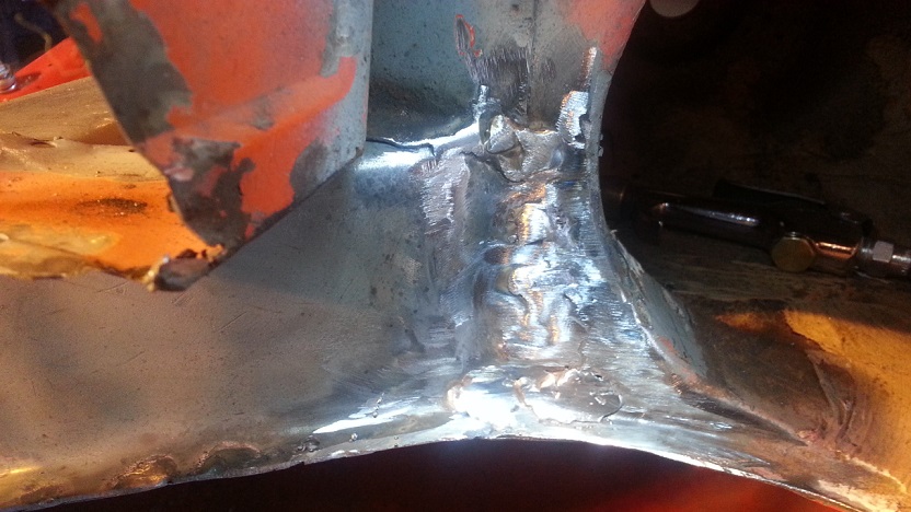

I finished up welding the long to the front wheel well.
This is some of my best welds. Practice, practice ..........practice.
Now we'll move onto the back of the floor pan. This is going to be tricky.
We really over welded when we built up the car 12 years ago.

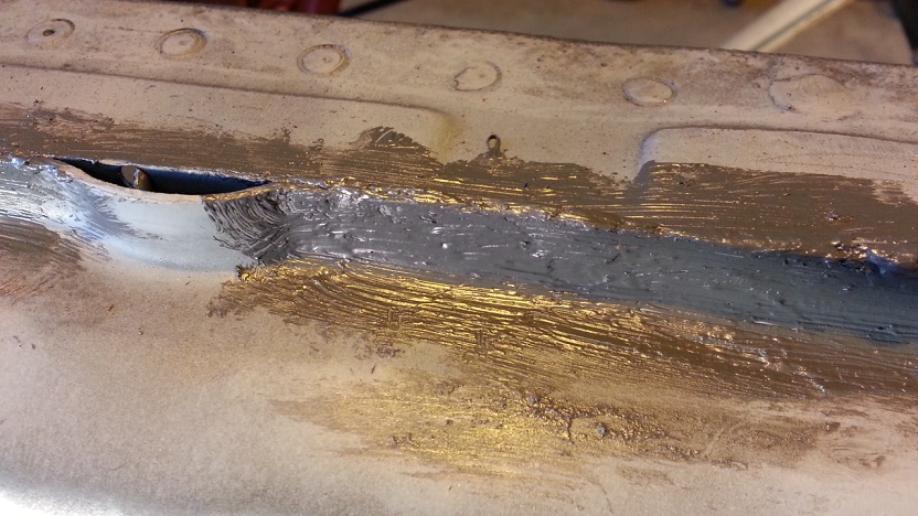

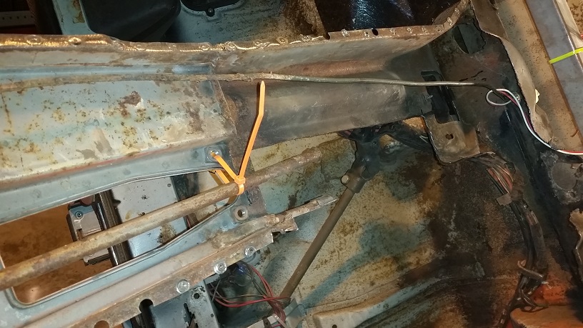

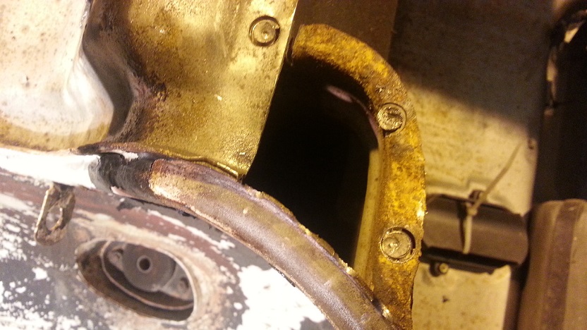

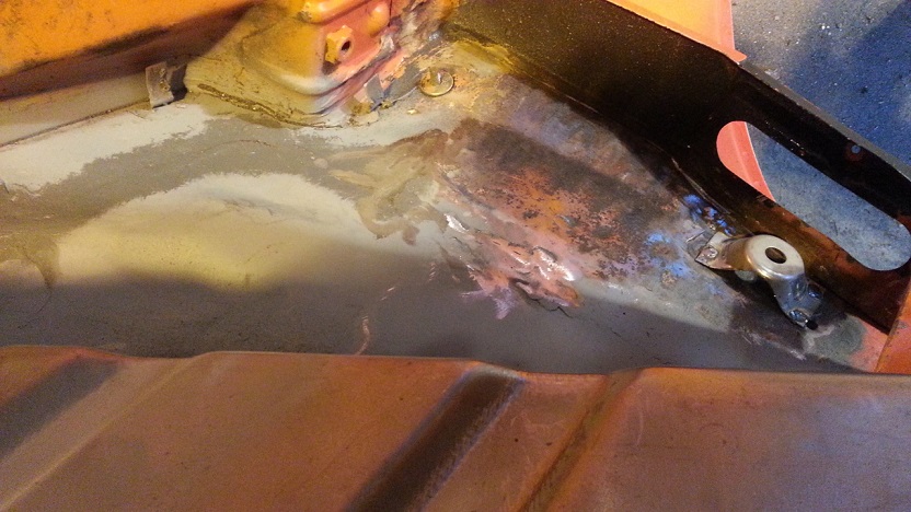

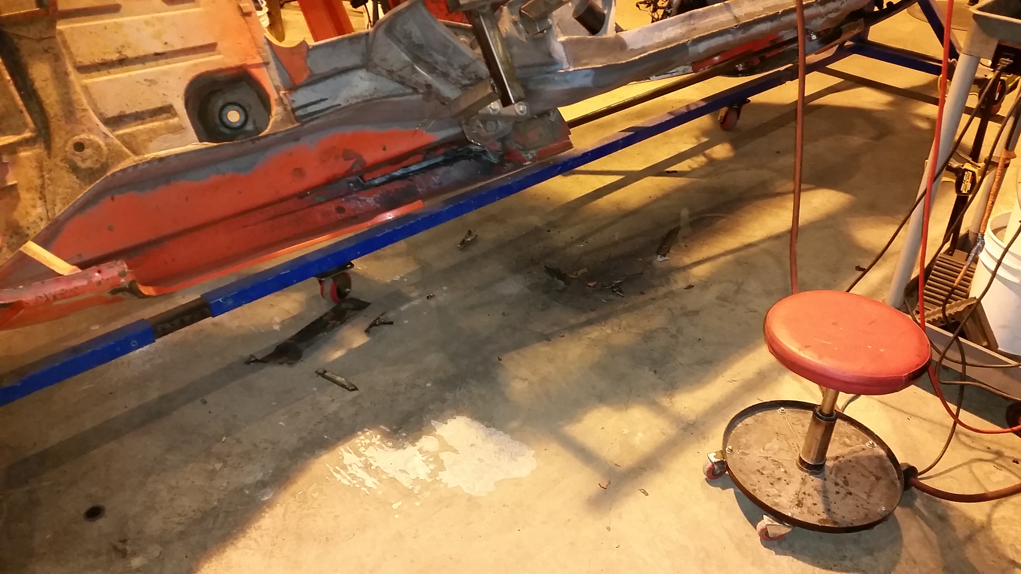

I'm finally back. We started working on the clobbered up seam we created years ago on the floor pan to outside firewall. It's going to be a tedious process. I'm going to take it off about an inch at a time. A couple cross cuts got too deep. (IMG:style_emoticons/default/mad.gif) Today I'll set up more light for the delicate surgery. Or maybe the Dremel if I can't get it right.
Sorry for the yellow tint. That's what I get if I don't turn off the halogen lamps before I shoot the pictures.

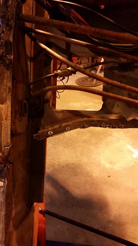

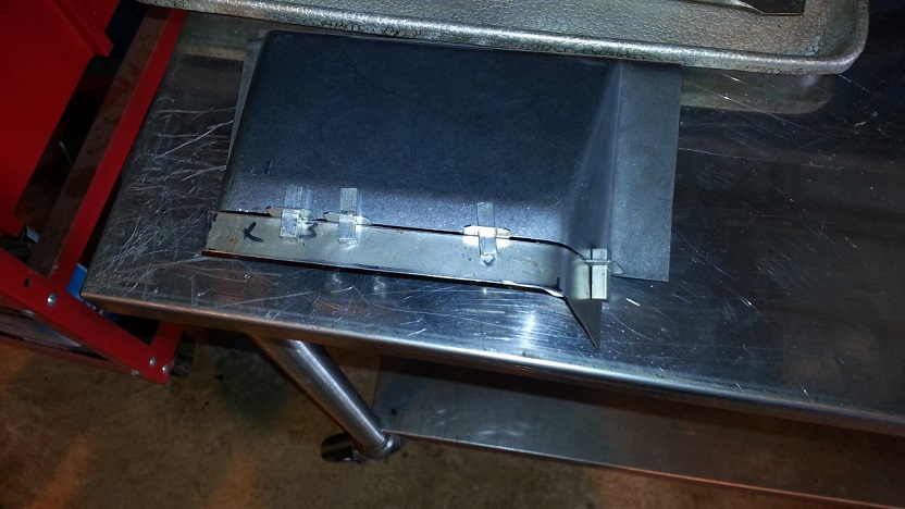

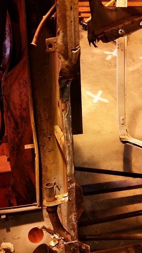

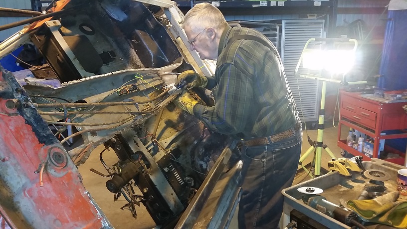

The day went well. Decided to cut out the previous hack job clutch tube repair access panel.
Super In Law making the pattern.
New panel welded in ...............

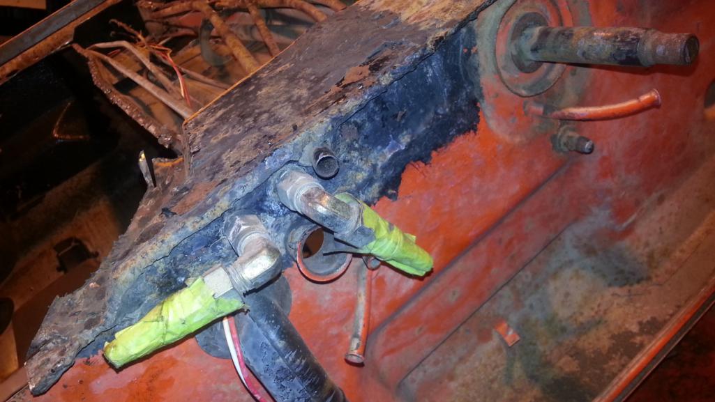

Next we'll attack the engine firewall. I'm going to cut out the bottom 1.5 inches that contain the fuel lines and clutch cable tube. We'll also need to fabricate a new flange for almost the entire panel.

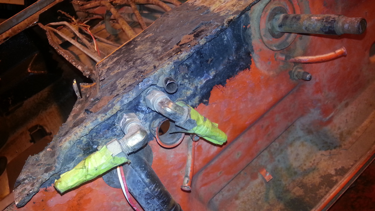

The dreaded WYIT (while your in there) bug has hit again. I think I'm going to change out the heater wire and accelerator tubes. The rust barnacles are so big I don't even what to touch them. I figure we're going to recreate the bottom inch and half of the engine firewall so we might as well change them out.
Plus it will give me a chance to use my new to my torch set up. (Craigslist)
Floor pan install looks to be pretty simple. Putting in the inside firewall looks like its going to be a bitch. I assume floor pan first, then firewall?
