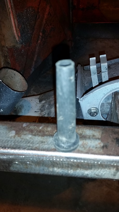

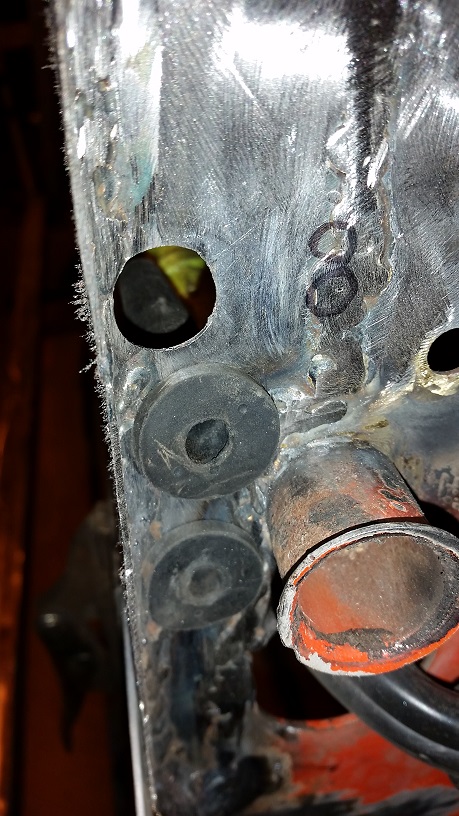

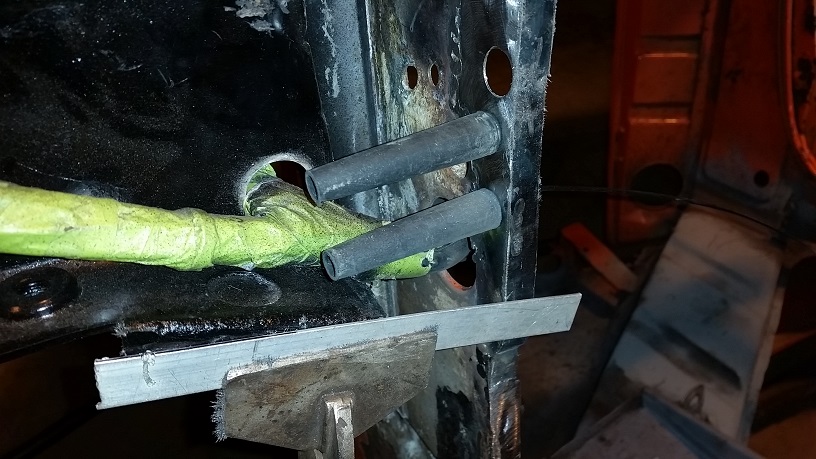

Then I bought some power tool cord repair sleeves to use as fuel line firewall bushing.
I'll trim them down after I see if they'll work.

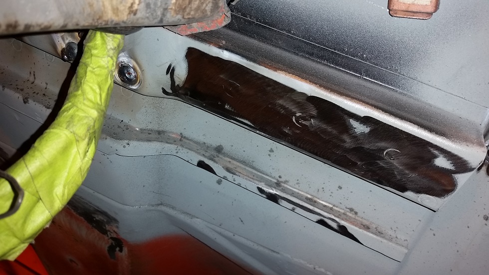

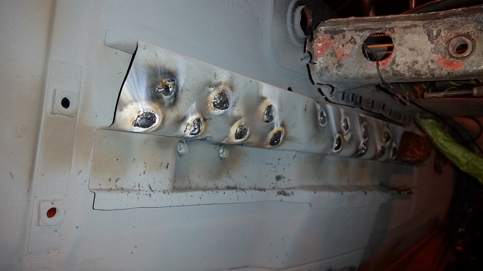

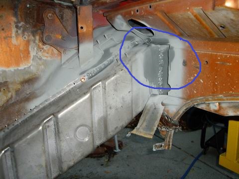

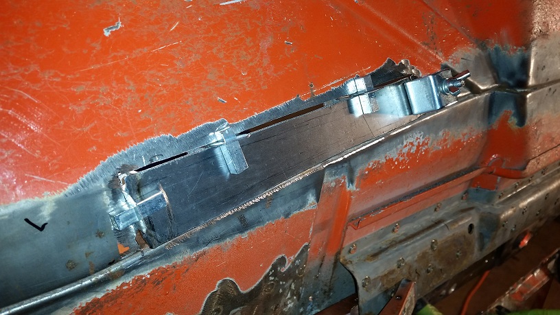

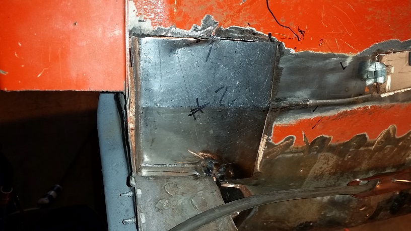

Welded in a cover over the left front suspension point next to the pedal/master cylinder mounting. Hole had been punched in it. Cant imagine why? Threads are good.
Then we went about building some patches on the upper rear firewall right above the seam to the lower portion. These are caused by moisture getting behind the engine sound pad.
The new Christmas tool made short work of that glue/hair left from the firewall pad on the engine compartment side.
All I can add from yesterday is. Make sure you make the patch big enough to make sure your welding the new patch to good metal. You'll spend more time stitching the big hole you blew in the material than you will welding in the whole piece.
Dammit that pisses me off.................
Flashed my eyes tinkering with my helmet on my first weld. Made for a tough start to the day. I was tinkering with grind setting. Turns off the auto darkening. Probably wont use that again ................... When I started burning rust it made it a little tough to see. Plus like a dumbass I laid down too much weld thru primer, again, Which causes another good flash. By the end of the day all was good. All fine this am.

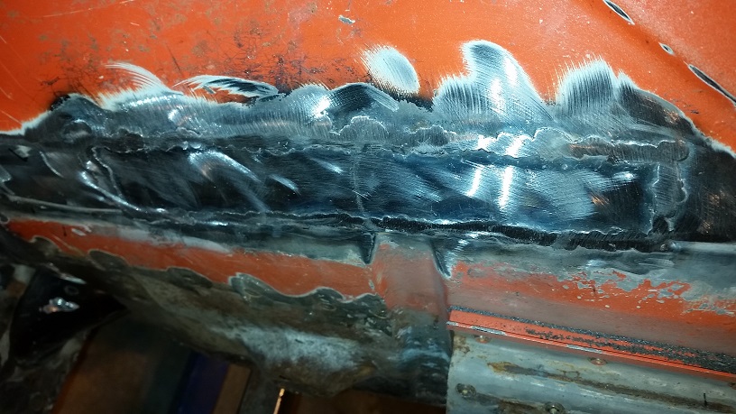

Well, here's where we started today. Upper firewall patches.
Left patch welded in.
Left all sealed up.

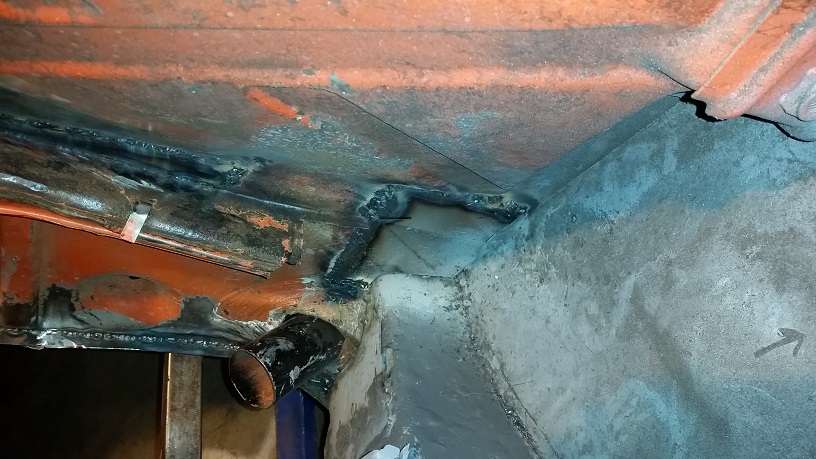

Then I move to the middle patch.
Trying to be a good boy and not over grind. I'll take it down just a bit more before
I seam seal it.

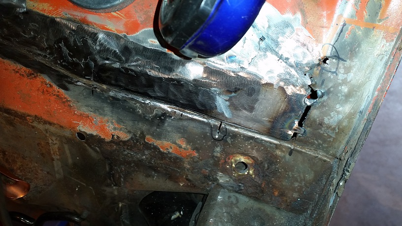

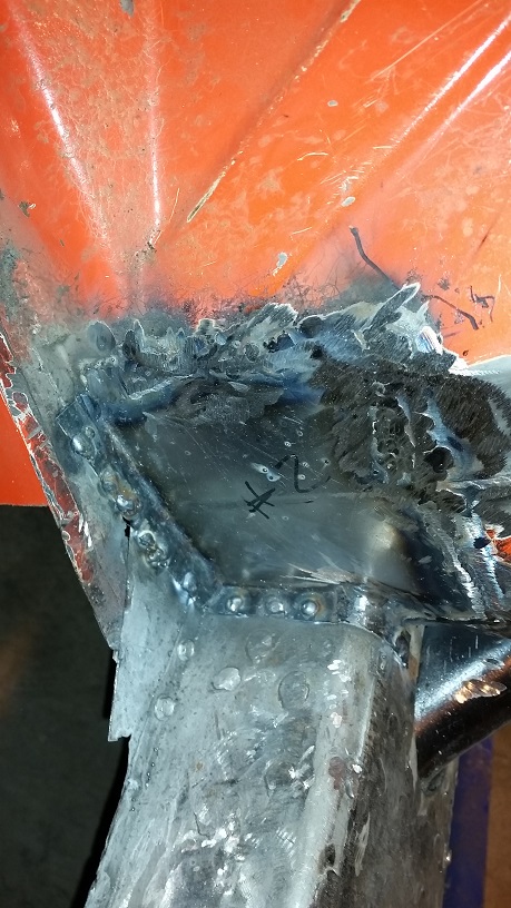

Then I move to the right patch. Super In Law is making the patches right ahead of me.
A couple spots got a little too rusty on the backside. Therefore blew out a big hole. But it was exacerbated by the fact that Super In Law turned up the wire speed to 40 and I missed it. Too Hot.
Elected to put the flange on the inside. It will make for a better sealed joint in the bottom of the hell hole.

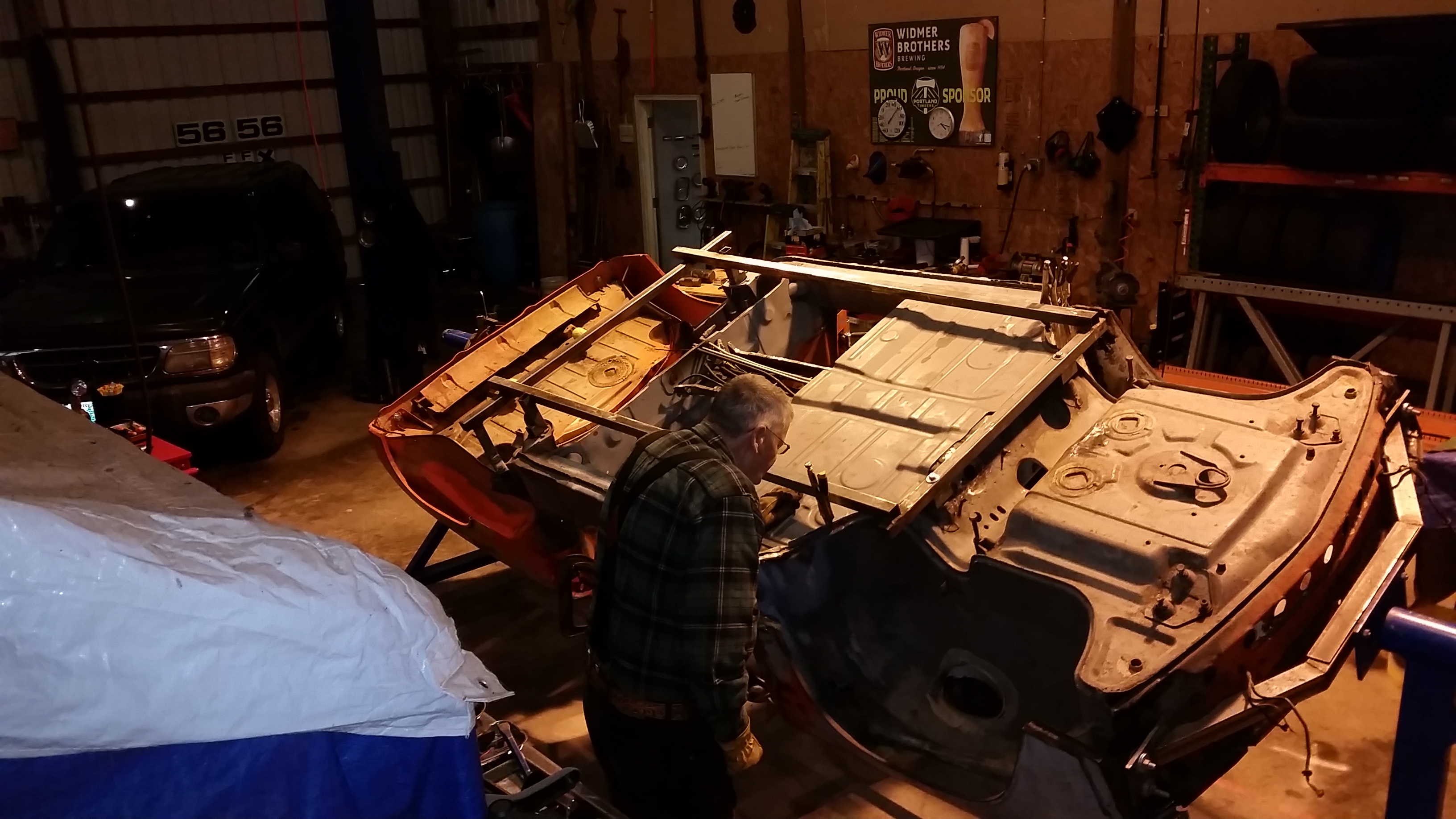

Super In Law is fabricating a locking ring on the rotisserie. Currently we have four pin holes. This will give us infinite locking locations.
So I decided to teach myself to braze. Kind of got it figured out. I do a beautiful with copper pipe and solder. I'll work on when to pull away the torch.

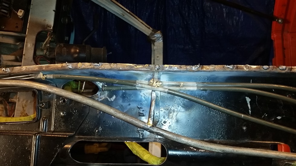

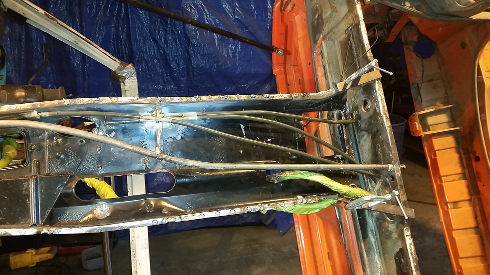

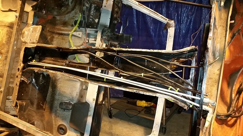

On to rebuilding the tubes in the tunnel. All new except for the clutch tube.
First shot at brazing the torch wasn't hot enough. Spent my morning coffee time watching brazing videos on YouTube. Now I've got it figured out. Easy Deal.

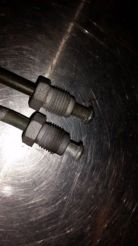

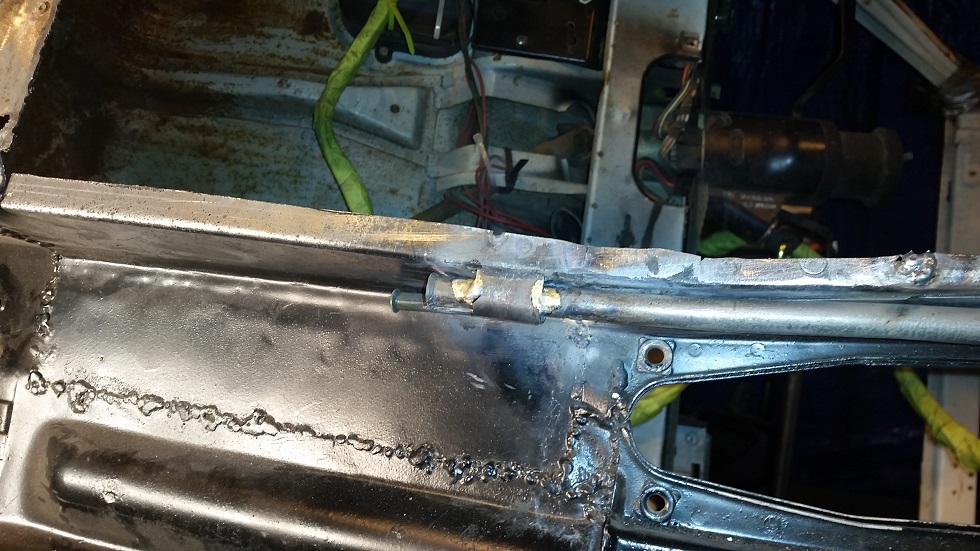

Building a new center tunnel brake line. To do so I had to put a new bubble flare on one end. Took 4-5 test runs to get it dialed in.

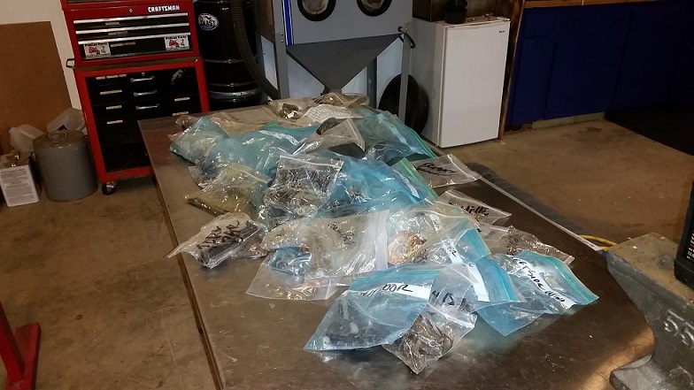

Started the day by pulling all the hardware bags out of the parts totes. I'm working on a plan to hang them on the wall so I can find them as needed. I'm getting tired of digging thru the totes to the find pieces I'm looking for. After I get them hung on the wall then I'll start preparing them for plating.

Ended the day finishing the plumbing in the center tunnel. Added a conduit for the fuel pump wires. It always bugged me that the wire was just flopping around in there.

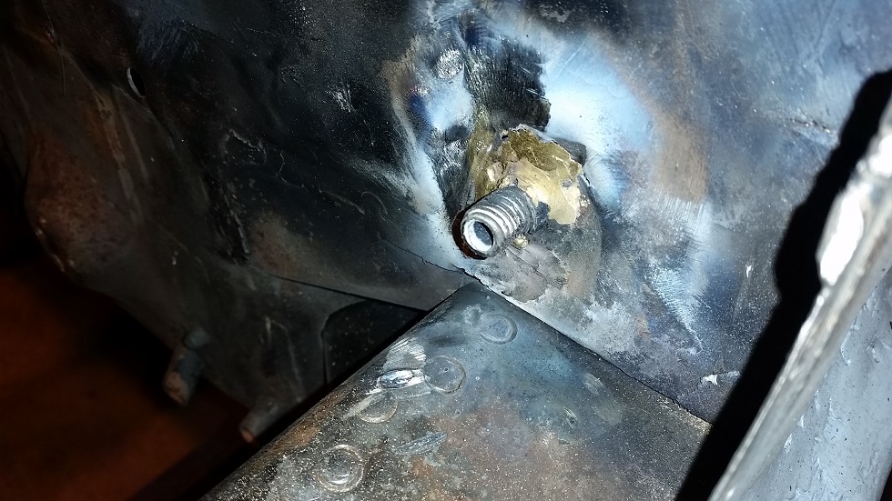

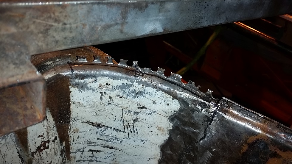

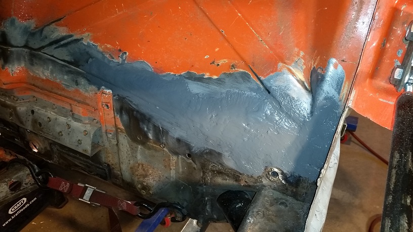

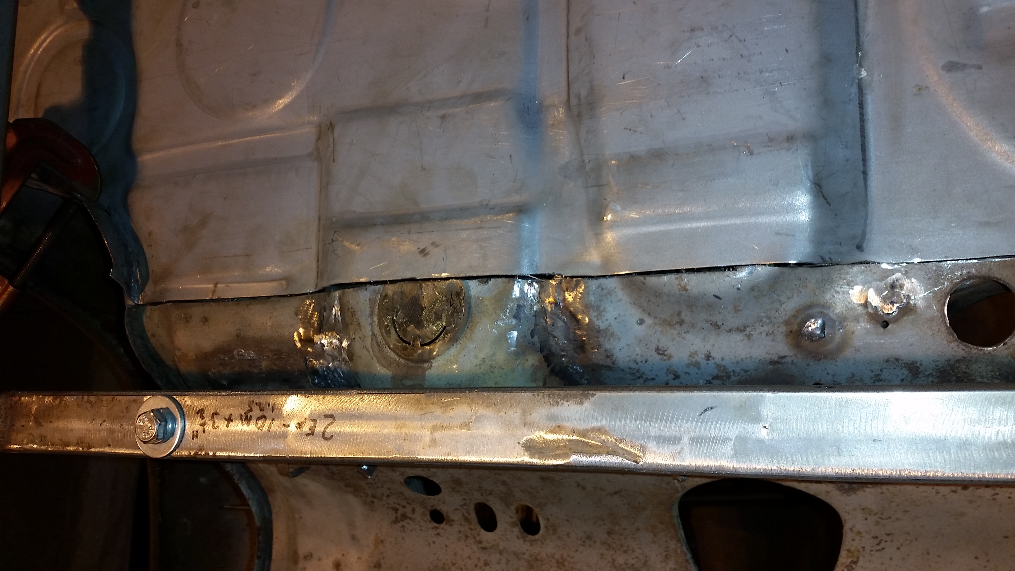

I'm working on filling the spot weld cutter holes left over from the inner lower fire wall removal.
Super In Law is working at prepping the lips and floorpan. Getting ready to install the floorpan. Feels like it will be a big leap.

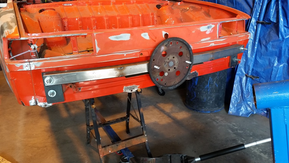

Been busy selling the seats in my 911 and removing factory mounts. Now I'm going to fabricate some mounts to install my new Corbeau Clubman seats. Lowering the seat about 2"s I hope.
But we did make the money cut yesterday on the front edge of the front floor pan.
Its starting to feel like its coming back together.
It will take some fiddling and dolly work to get it finessed the way I want it.
Nice and Sanitary
It's going to be a joy welding on good solid steel. LOL.

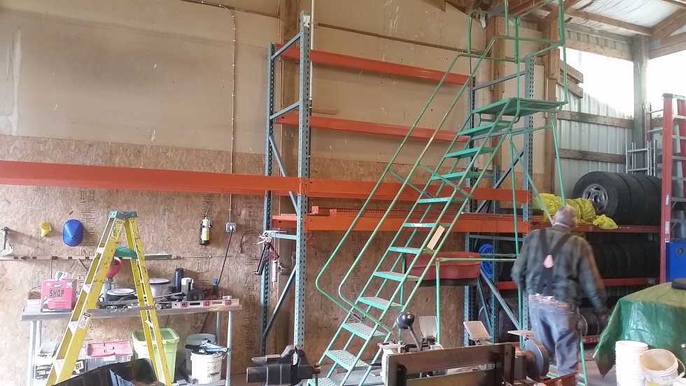

But while we're at it Super In Law (Grandpa Jack) is installing some new to us pallet racking.
