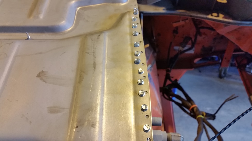

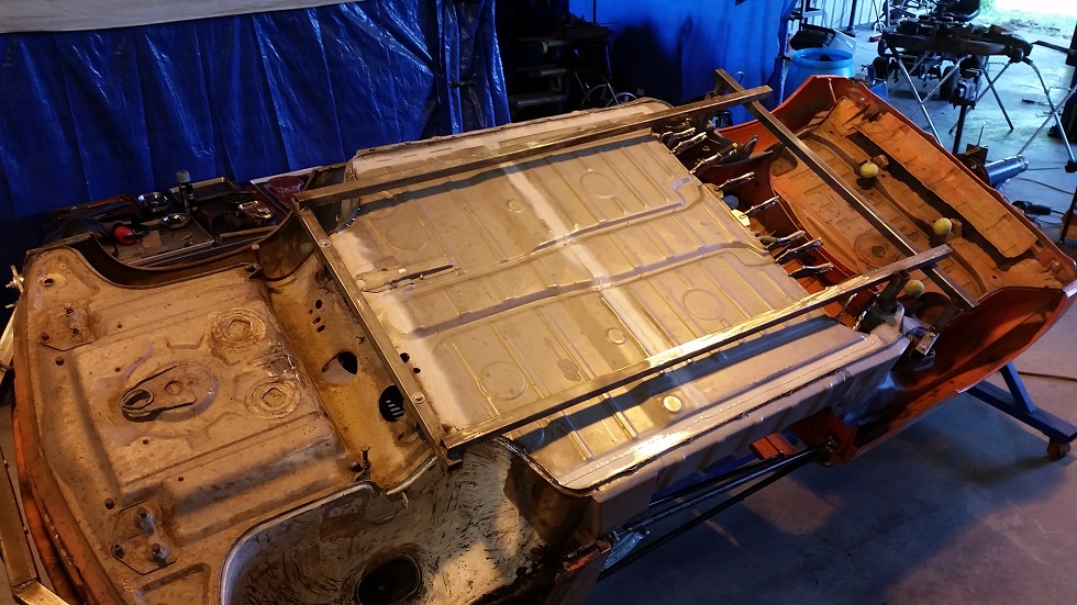

Started the day by tidying up the shop.

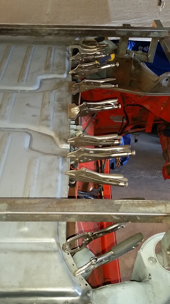

Ended the day with the front edge of the front floor pan welded and tidied up. Quite a bit of fiddling to get it to line up perfectly. Next time suggestion, I would make the cut/seam to the tub be all up on the top/flat surface. Passenger side looks tidy, Drivers side I was down in a dip and couldn't really tidy to the weld as much as I like. As for the fiddling. It was relatively easy work. I never welded more than an inch after I had all my tacks in place.
As you can see I have the rest of the pan all screwed into place. Ready to go for tomorrow. I finally feel like we're making progress, man what a feeling. I left the shop with huge smile on my face. Oh yeah, it's really fun welding on NEW RD metal. I only ran into a couple thin spots when mating up to the tub. All it takes is a little bump down in heat, I mean a little. My MillerMatic 180 has settings for metal gauge. So lets say I'm operating at 17.25 on the dial. I'll bump it up to 17.50 -17.65 and puddle the hole closed. But for that front seam I've been running in the mid 17's. But that's not seam welding, its stitch welding. Maybe three puddles max. Man do you want to keep going. But your putting way to much heat in one spot. Take your finger off the trigger.

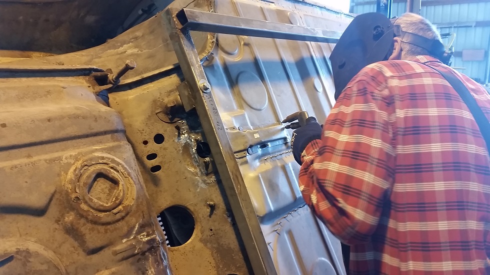

I didn't weld in the pedal support yet. I wanted to get the seam welded first. You can see on Adam's RD floor install video you'll need to elongate the hole in the pedal support just a smidgen to get the pedal support to align correctly. Mine was exactly the same. A word of wisdom, when you lay the pedal support on the pan to draw where to drill the holes. Draw the hole about 1/2 the width of the stud towards the fire wall. That compensates for the angle. A Habor Freight step drill bit was real handy for drilling the holes.
If you've keep up with the entire thread you can kind of figure out that I'm kind of fixture/tool/gadget whore. We built a jig to hold up the floor because the inner bottom firewall has yet to be installed. Tunnel is still loose. Seems to have worked great. Built two. One for the front, one for the back. It was made out of an old bed frame.

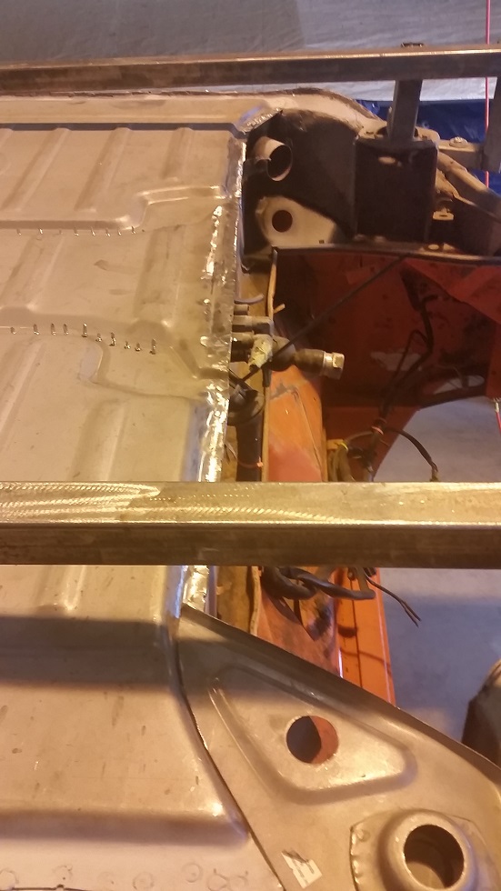

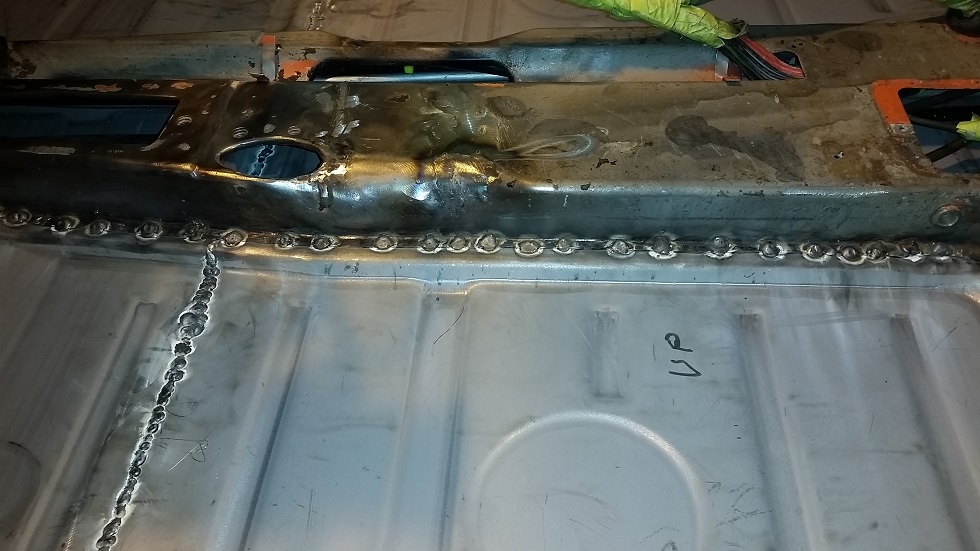

I had to re-cut the center seam again. Had a little too much hanging off the back. (IMG:style_emoticons/default/mad.gif)
All it takes is time. So by the middle of the day I was ready to start welding.
Here's the promised shot to the welder dials.
Then I started stitching ............

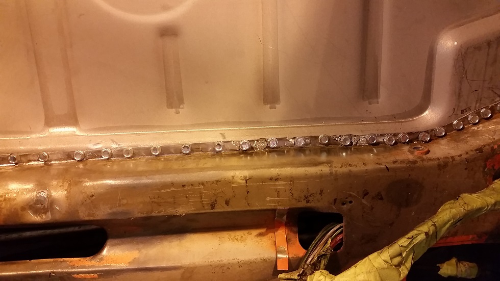

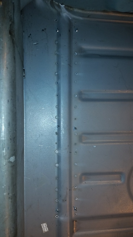

Another lesson today. After watching Adam's RD floor install video. I was thinking it was a waste of time putting a screw into rosette hole. So I did every other hole.
Come to find out there is a method to his madness.
The holes punched out without a screw ran though them are a pain in the ass. Your fighting the flash off of the weld thru primer in every weld.
The screw holes created a much nicer weld. All you need to do is start the wire on the bottom layer and circle your way out.

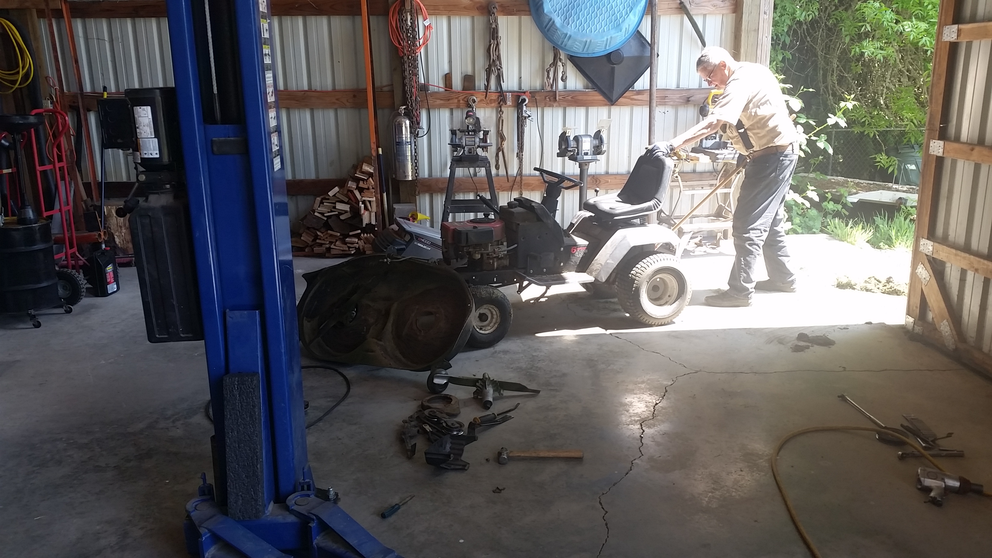

Landlord blew up the lawn mower.
Super In Law spent the day working his magic. I've had the mower for 23 years
Mowed 2 acres twice a week in Montana.

Prepped the tunnel before lunch.
Welded the engine firewall lip after lunch. Some of the punched holes were in a
a bad location
All tidied up. Prepped the jack point.

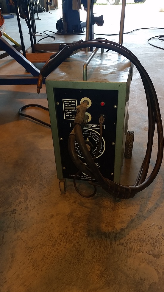

Started the day by making sure the pedal cluster goes back in without issues before I spot weld in the pedal box stiffener. It's little tight. Elongated the holes a bit. Good too go.
Panel Spotter ready to go.
Super In Law gives it a go .................

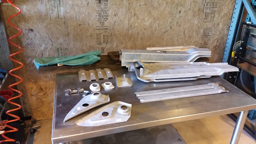

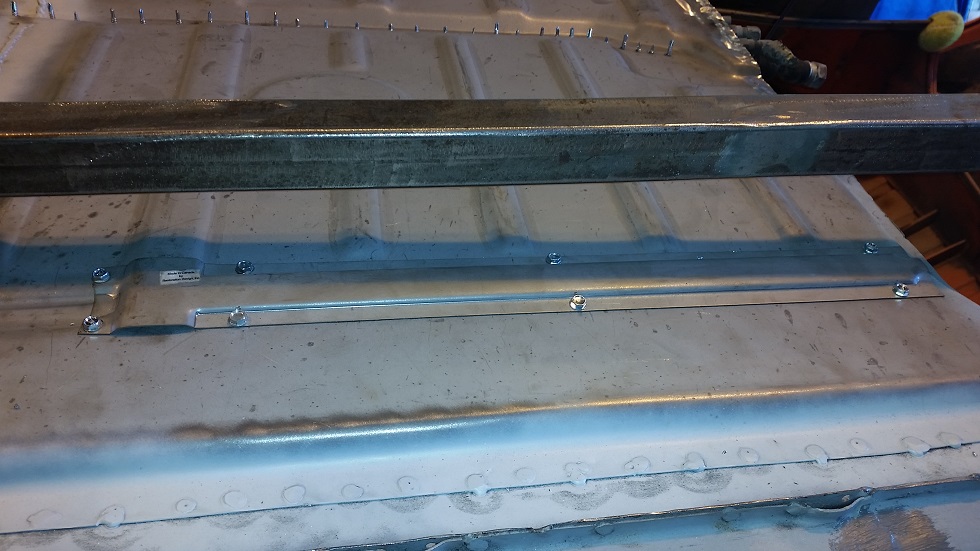

Got the rest of the floor pan parts out and ready to go.

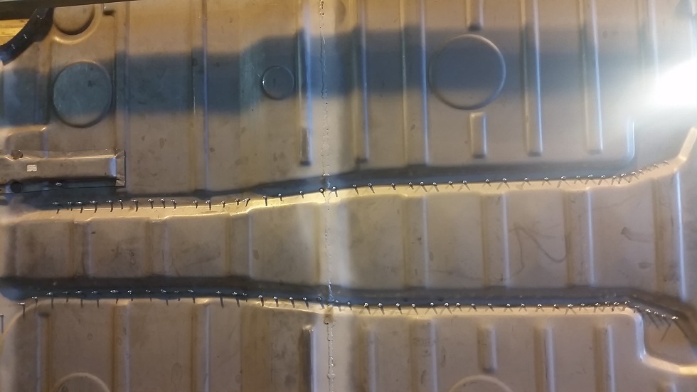

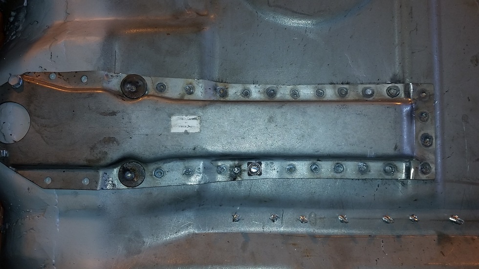

With the Panel Spotter hooked up and ready to I decide to install the seat stiffeners.
Inside look at the backside of spot welds. (IMG:style_emoticons/default/biggrin.gif) (IMG:style_emoticons/default/biggrin.gif)

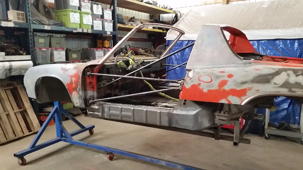

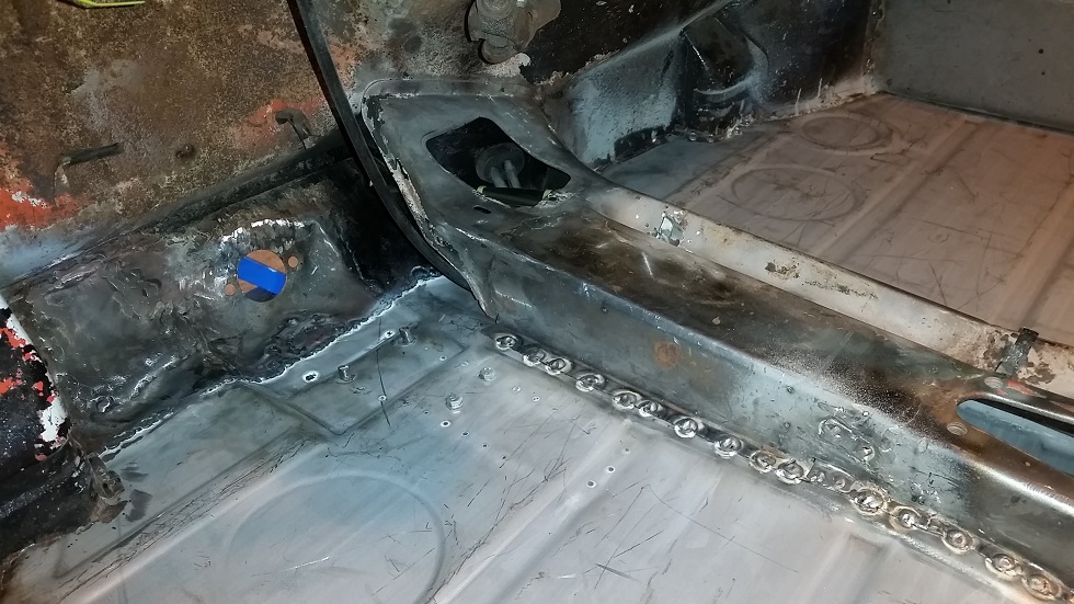

Come back from lunch and I get after the tunnel rosette welds.
Got some grinder work to do. But man, what a great feeling. (IMG:style_emoticons/default/beer3.gif) (IMG:style_emoticons/default/beer3.gif)
Kind of looks like a car again.
