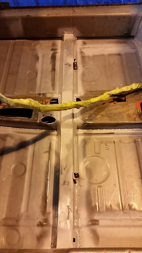

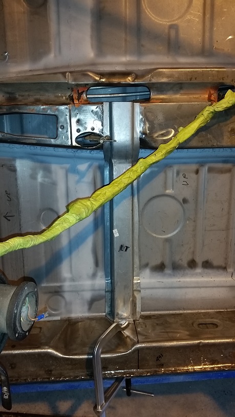

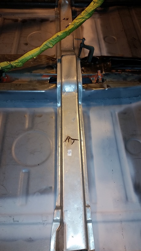

Now on to the center braces .................... I thought I'd never get here. Like everything, it takes fiddling to get that perfect tight fit. It's beginning to become fun.
Left side fitted. Clamped in place. (IMG:style_emoticons/default/biggrin.gif)
I forgot to say. I have the 74 to measure and get dimensions off of. Measured off the back wall to get the correct location.
Started tinkering with the right side. (IMG:style_emoticons/default/beer.gif)

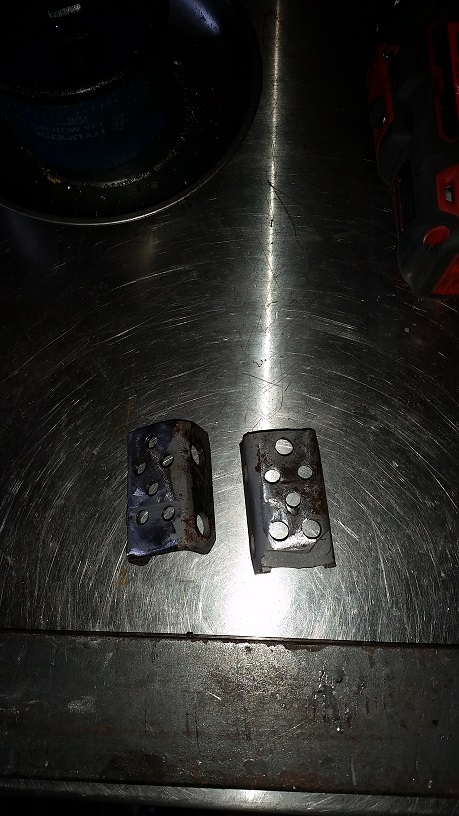

Then I decided to prep the seat adjusters. Drilled out the rosette weld holes. Then cleaned off the cutting oil in the parts cleaner. They are ready for weld thru primer on Friday.

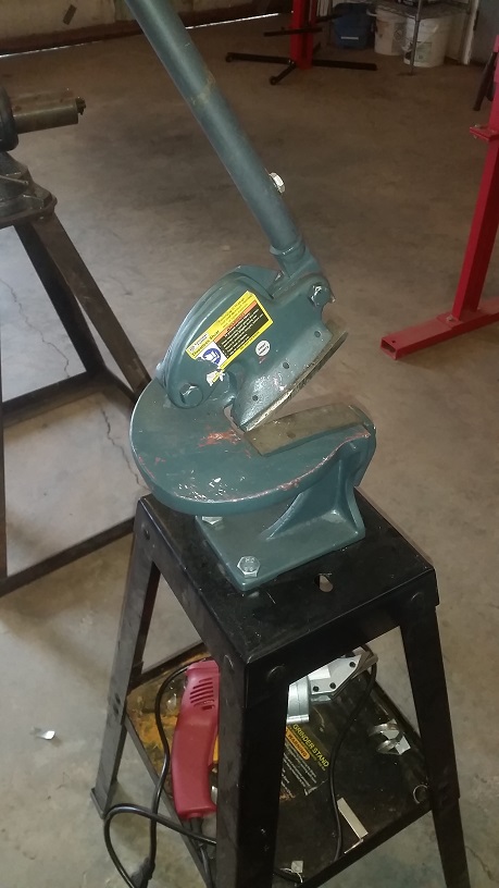

A tool whore shot. The shear sure makes short work of the trimming. (IMG:style_emoticons/default/biggrin.gif) (IMG:style_emoticons/default/biggrin.gif)
But I wish I had a big shear that would cut thru 3ft. of 16 gauge mild steel. Maybe when I win the Powerball.

QUOTE(cary @ Jun 3 2015, 10:52 PM) *
I got that for Christmas. I think my son wanted one so I have it! Great things fathers and sons. Wish I had a super in law, but perhaps I will simply become one someday. Forlorn hope I suppose.

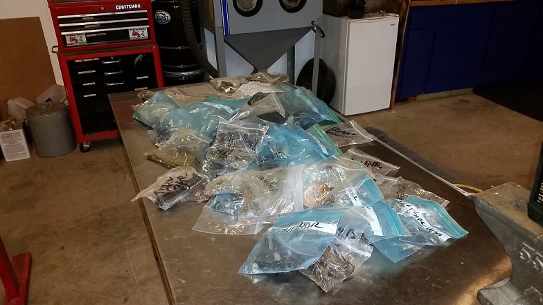

Next shop project.
We're going to build a two sided panel to store/clip all the plastic bags of parts on. It will be on wheels so it can be moved around.
It's almost time to send stuff off to be plated. So Ill go thru every bag. Photo every bag. Rename if needed.
Hmm ........... I need to find that e-brake tube/spring bracket. Having to dig thru the tub of bags isn't real handy.
On the way to the shop this am we're stopping at HF for a couple more magnets. Ace Hardware for some eye bolts and maybe some copper tubing.
Oh yeah, maybe some taller wheels for the bag panel at HF.
Time to make some coffee .................

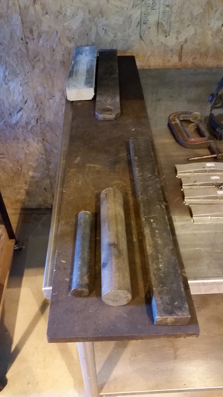

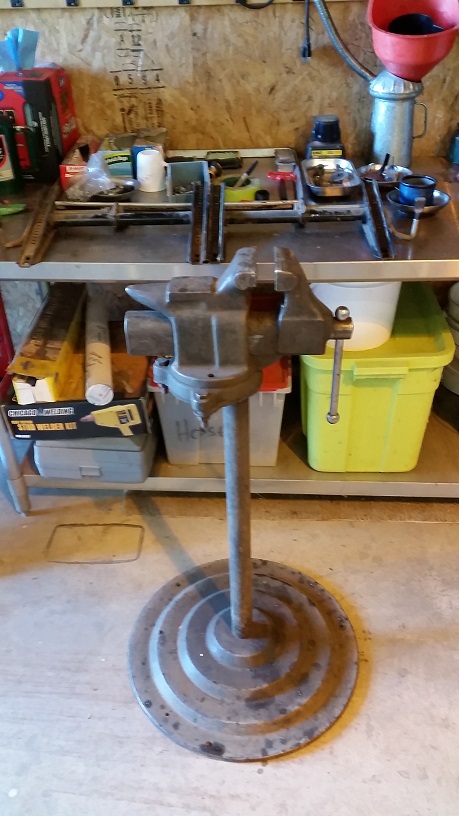

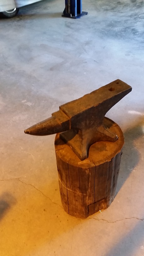

Here are the fiddling weapons I was talking about.
Metal. Different shapes an sizes.
Something to hold the metal and wood.
Something to pound on.

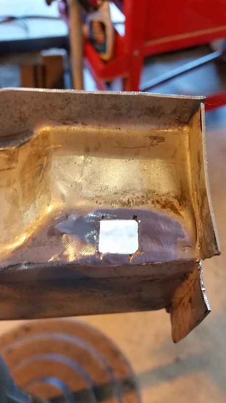

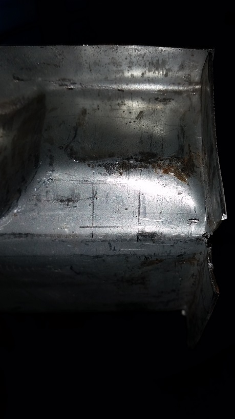

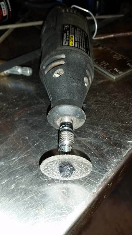

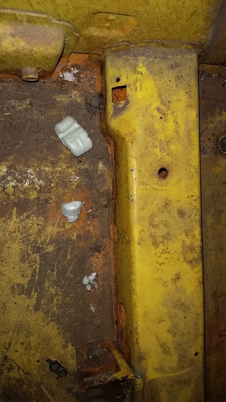

Decided I'd cut out the e-brake light switch while the brace was out. Took the location and size off the yellow (74) car.
It's just a smidgen shy of a 1/2" square. Drilled a hole in each corner. Then cut between the holes with the Dremel. Should have used a smaller cutting disc. But I like the reinforced one ................ Does blow apart when you breath on it.

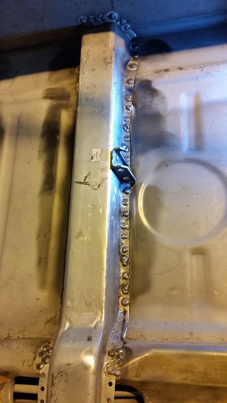

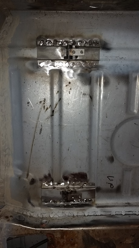

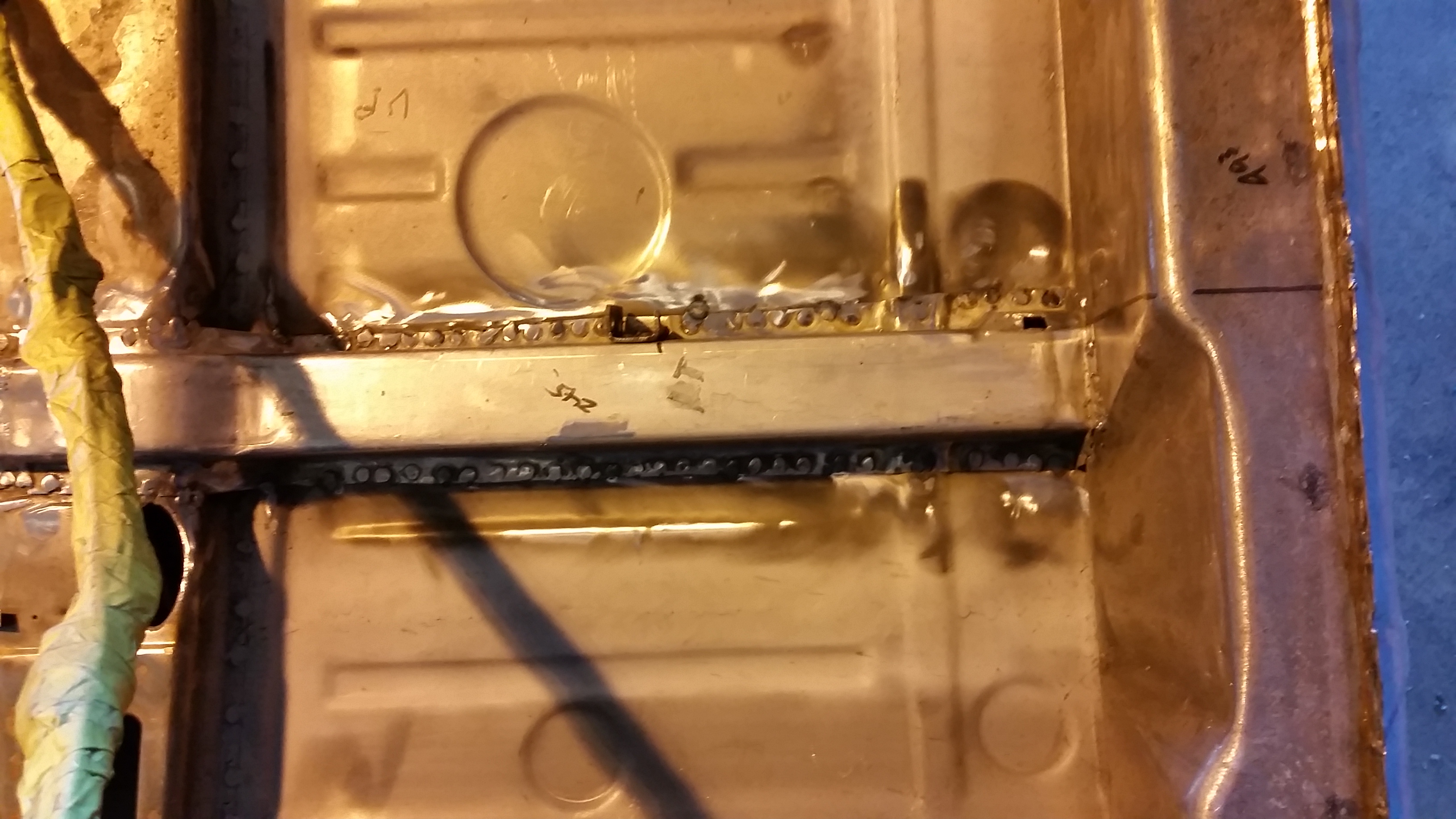

Now for the task at hand ...................
Forgot to shoot pictures of installing the adjustment brackets. Pretty simple. 245mm from the long. Square up. Weld in the rosettes.
Rosettes welded in. The larger ones are caused by not letting or the getting the metal cooled down.
Beautiful ending to wonderful day .................

post Jun 6 2015, 10:51 PM
Post #432
Spooling.... Please wait
Posts: 13,380
Joined: 20-January 03
From: Riverbank, Ca
Member No.: 172
Great looking work!! Turn your wire speed down or your temp up on your mig, your welds are a hair large (IMG:style_emoticons/default/smile.gif)
cary
post Jun 7 2015, 07:02 AM
Post #433
Posts: 3,900
Joined: 26-January 04
From: Sherwood Oregon
Member No.: 1,608
I think I'm going to tinker with turning the wire speed down just a hair. This is a good test area because I can look a the penetration from the back side.
On this beautiful RD Galvanneal I run the Miller 180 (220v) at 17 on the thickness gauge (heat) and 45 on the speed.
Thanks for the critique ....

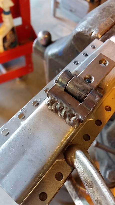

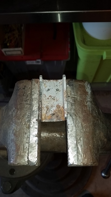

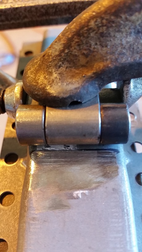

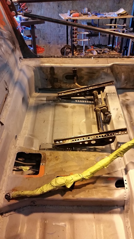

So we have another day to play. First half of the was spent unloading the enclosed trailer full of the middle kids stuff into the warehouse.
Then onto the seat mount/hinges. Watched the RD video a couple times, Adam does a nice job. Tried doing the hinge tack on the first one. Just didn't work with the door braces in the way. Really pretty simple. The hinge pin is supposed to be centered right at the peak of the mount. Just scribed a line on the mount and aligned the hinge pin the line.
First step was to get everything in place. Bad part, looks like the seat frames will need a little restoration. Handle shaft has some rust. I'm thinking yellow cad plating on the handle ?
A couple shots of the hinge welding.
Once again lots of time spent cooling the metal. Rosette welds still a little too big. Turned down the wire speed, which made them flatter. But still to wide.
Maybe Next Time. But the welding is just about over. Next will be the door sills.

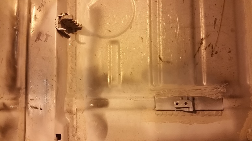

Back to work. Finished grinding down the spot welds and touching up the backside.
Kind of tricky grinding. A lot of using the outside edge.
Then proceeded to apply the first layer of brush on seam sealer.
