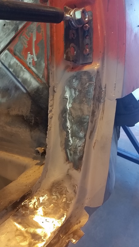

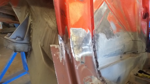

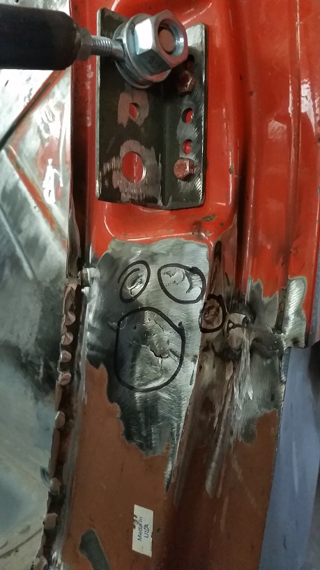

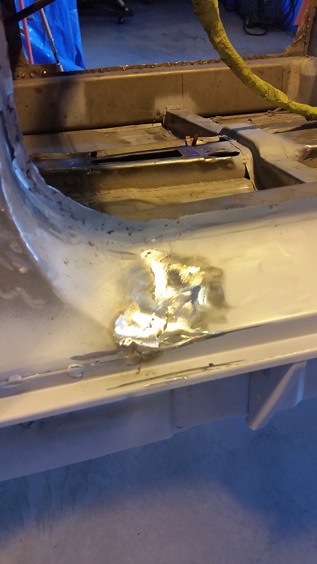

Todays work ..................
Here's were we started.
Here's were I ended.
Not my finest work. Nothing a little finishing putty wont fix.
Way toooooooooooo much grinder action. Material got to thin. (IMG:style_emoticons/default/mad.gif) (IMG:style_emoticons/default/mad.gif)

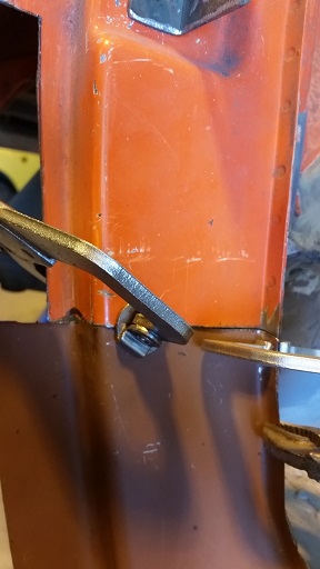

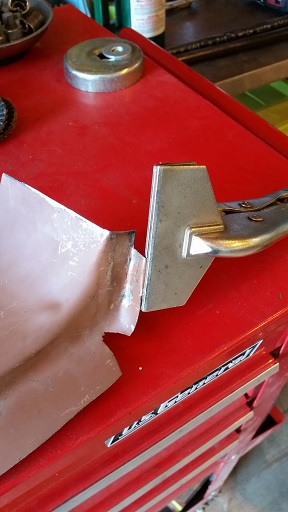

No butt clamps on the other side. We'll try the Cleco's fasteners.

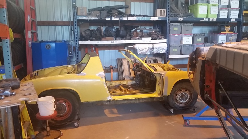

Donor in its temporary home. Super In Law spent the day with pencil and paper engineering his car stacker design.

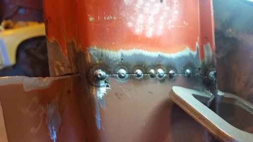

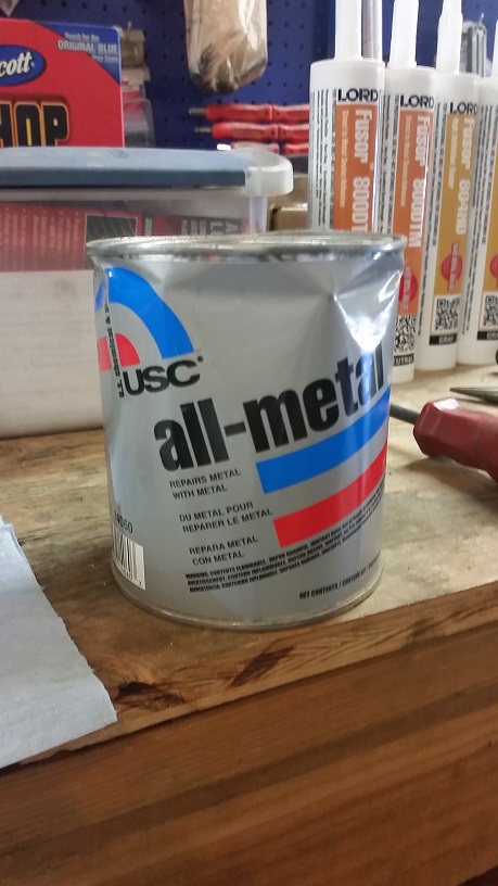

I decided that I will MIG weld the jam to sill joint. Then we'll tidy it up with All Metal body filler.

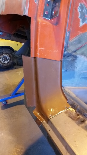

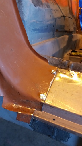

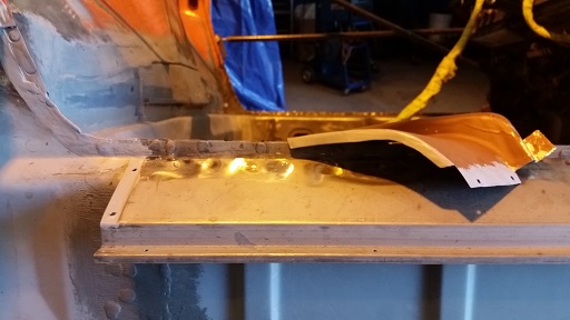

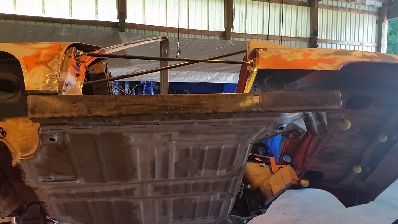

After getting the jam seams welded I moved on to installing the rocker end cap we fabricated some time ago. This car had quite a bit of rust repair in the inner fender/hinge post area when we made the car road worthy many years ago. Some good, some bad.
I'm just working on it being functional. If I run into this on another car. The fender will have to come off and be refitted.
Now that I look at the bottom of that left front fender I may decide to cut that out and recreate it. But I need to keep reminding myself this is going to be a daily driver.
As these cars continue to go up in value and the front fender is welded on. Maybe RD will look at making a patch panel for this area. I think there's one for both the 911 and the 356. I'll look and see what the one looks like on the donor on Monday.
We cut the rocker cover channel off because it was so rotten when we took apart the car. Either way it will have to be recreated. Looks like in our first go around we did some welding and took correct shape out of the bottom edge of the fender. It kind nof rolls down and it isn't attached to the inner support.
When the time comes both sides will get some VERY detailed seam sealing, both tube and spray on. Then they'll get undercoated. Then on top of that they get Mark's inner fender liners to keep the debri from getting up there in the first place.
I did test fit the rocker cover.

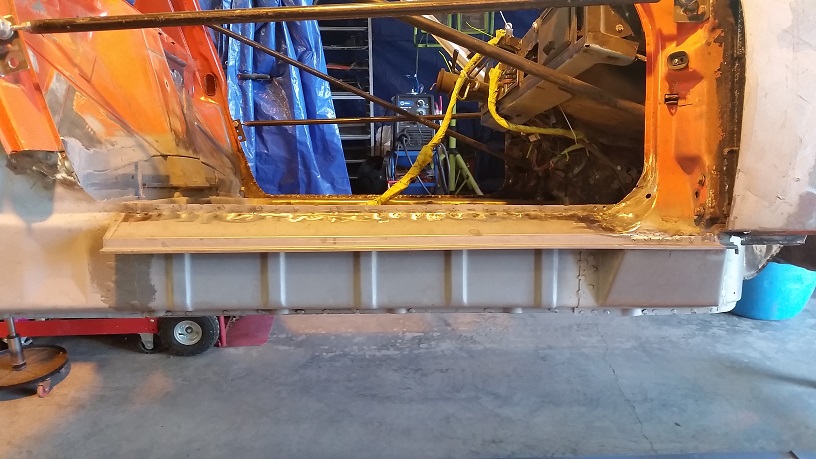

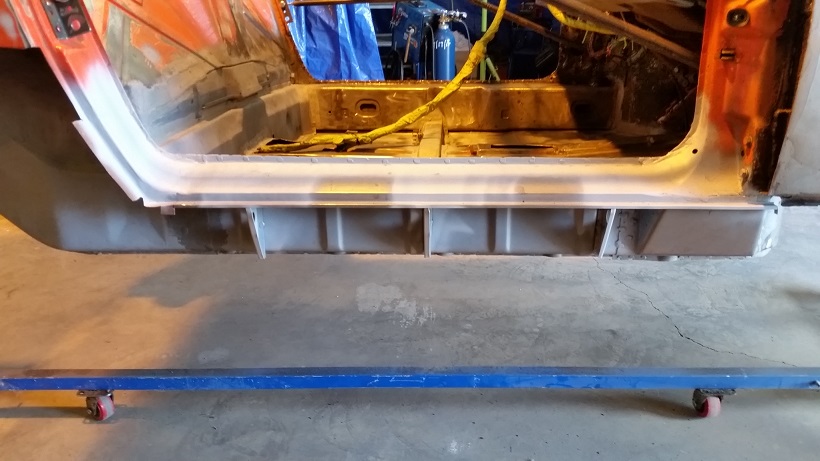

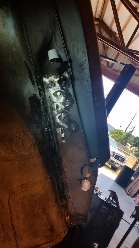

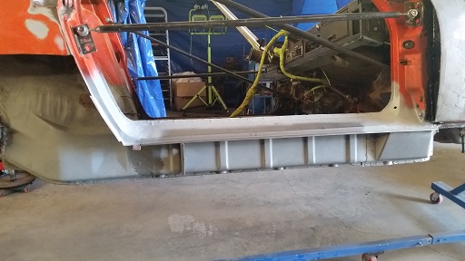

Then I moved on to installing the right door sill. Pretty uneventful.
I have some welding to do around the bottom of the hinge post where I recreated the layers. Right at the bottom radius.

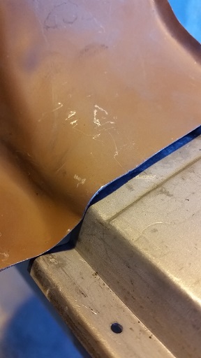

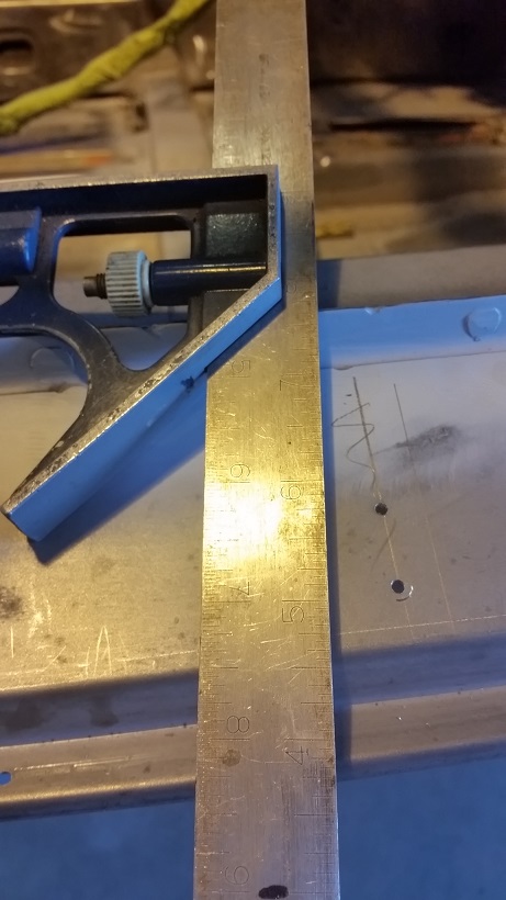

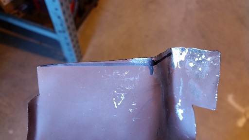

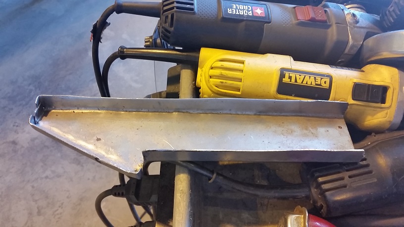

Onto to fitting, fiddling, cutting and installing the right door jam.
Here's where we start. Not exactly a high quality recreation. The the odd thing with both of these pieces, they seem to be made of a softer metal.
Then on to matching up the edges. (IMG:style_emoticons/default/sad.gif) (IMG:style_emoticons/default/sad.gif)
I used the fine wheel on the bench grinder to cut down and square up the edges.

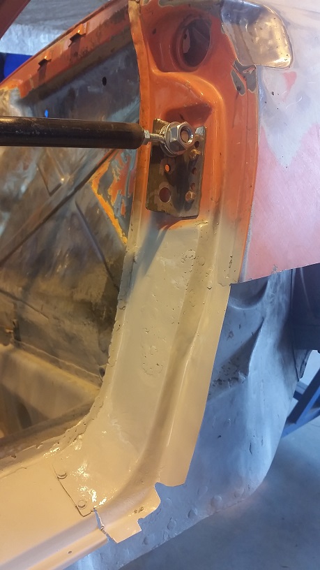

After lining things up. I scribed the back and cut it off with the cut off wheel. When I made the cut I left the line on. It was too tight. But I'll do the same thing again.
Once again I cut it back with the bench grinder. That gave me a nice tight fit.
Took it back off and brushed on the weld thru primer before we went to lunch.

This time I took my time. (IMG:style_emoticons/default/cheer.gif) (IMG:style_emoticons/default/cheer.gif) (IMG:style_emoticons/default/cheer.gif)
I just wish the metal was a little bit harder and a little thicker.

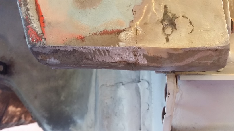

You do need to turn up the heat just a smidgeon when you tie the welds together.
Knowing that I'll be using All Metal on the sill seam I didn't over grind it.
Much better. I still don't think I'll be able to weld the fender back on like Jeff ail did.
But it will be pretty close. Its more about being able to keep the two pieces level.
At the end of the day. She's covered with SE primer and ready for next time.

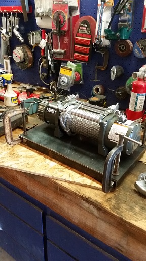

While I'm working in the big shop. Super In Law is working on the new 12,000 lb winch he bought. A little over kill for pulling cars onto the trailer. He's fabricating it to mount into the 2*2 trailer hitch. Plus we'll add a tube to the floor of the open car trailer.

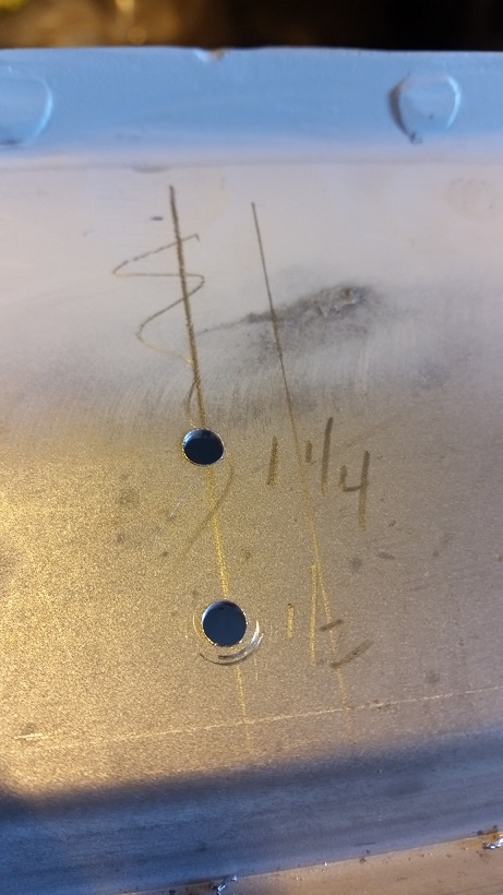

Added the sill supports to the right side. This time I decided to pre drill the top holes first.
All tidied up and primered.

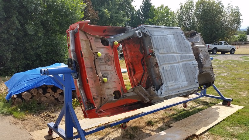

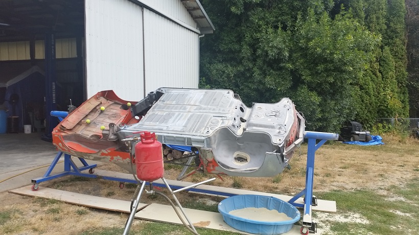

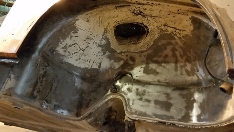

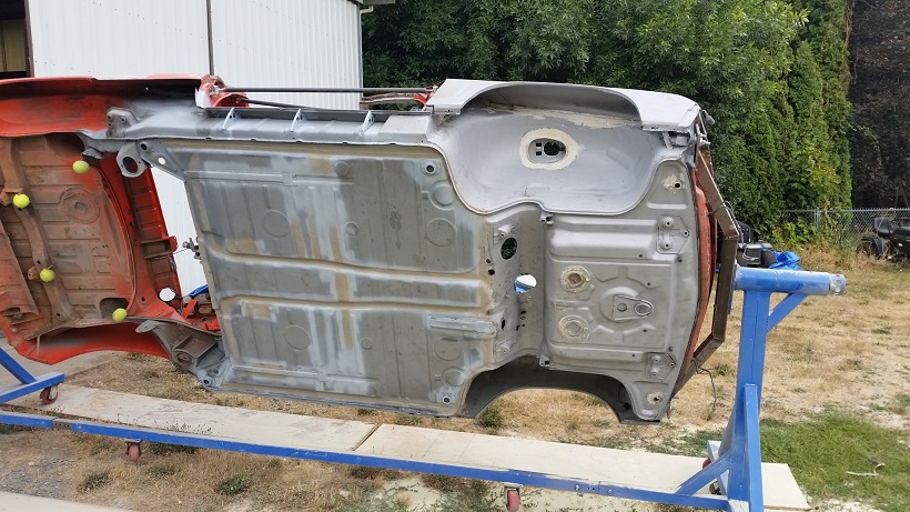

Now on to the BIG task. I will begin to prep the entire bottom of the car for epoxy primer.
I still have a little work to do with the e-brake. But I'm getting antsy to start shooting primer to make it look like we've made some progress. I've been reluctant, because every time you do some grinder work everything gets filthy.
Here's the starting point.
Yesterday I took a trip out to KleenBlast the blasting material supplier out in North Portland and bought 5 bags of the Fine GlassBlast. The equivalent of walnut shells.
I thought I'd roll the dice ..............................
cary
post Aug 4 2015, 08:41 PM
Post #477
Posts: 3,900
Joined: 26-January 04
From: Sherwood Oregon
Member No.: 1,608
Wow, this stuff was impressive.
Even with my cheezy HF sand blaster with the upgraded deadman valve.
http://abrasive-equipment.kleenindustrials...c=100|1189|1226
Doing the work was actually fun. I only had to wear a face shield and and a welding cap. In hindsight I should have wore ear plugs. I still have glass beads in my ears.
Blasting using sand puts out so much dust you have wear a hood and face mask.
In 2 hours I have the entire front pan ready to go. (IMG:style_emoticons/default/biggrin.gif) (IMG:style_emoticons/default/biggrin.gif) (IMG:style_emoticons/default/biggrin.gif)

QUOTE(dangerranger01 @ Aug 4 2015, 07:44 PM) *
Looking good! What are the specs on your air compressor?
I don't know right off the top of my head. It was working pretty hard.
The first thing I'll do on Thursday is check the oil and drain the water. I did seem to slow down a couple times. So I hung up the gun and let it catch up. I will get you the numbers on Thursday night. I'm pretty sure it was largest one that Home Depot sold 10 years ago.
I forgot to say that I cleaned up the front fenders too............... with the little blaster it didn't seem to heat up the flat panels.
It was a good day !!!
We'll go back out there on Thursday AM and get 10 bags this time.
