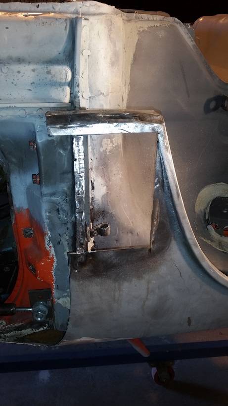

Super In Law finally finished the upper tie. A little crude, but it will work.
He built it a little bigger than the factory one on the other side. I predrilled 5 rosette holes. Then it was ready to weld.
I know its over welded. But I just can't help myself. I just love melting metal. LOL.
I drilled a drain hole thru both layers. I also opened up the drain on the suspension console.

For working with 12gauge, I don't consider that crude at all. I'm dreading having to make them in the coming months and almost wonder if doubling up 18 or 20 could accomplish the task.

Super In Law (Grandpa Jack) went to work on the suspension console tie.
It was created in two pieces like the one on the web hypertext.
Test fit .............
As far as I got welding before it was time to head home.

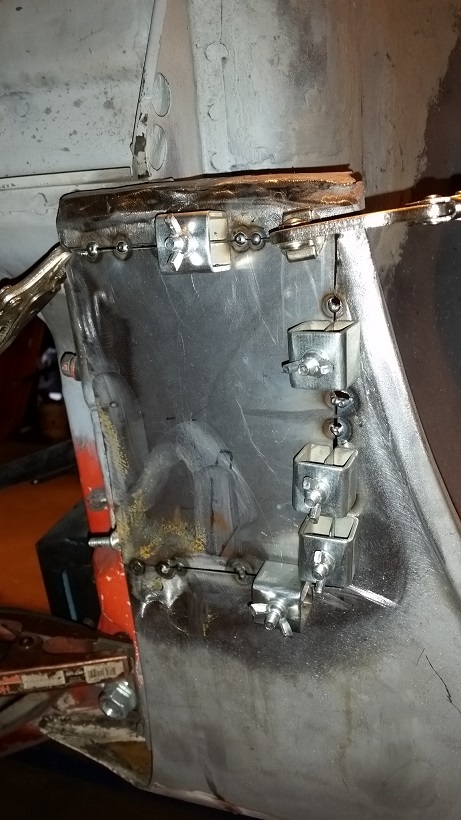

Then on to welding it in.
I could have used 2 or 3 of these. The pair I have are too small for the right side. The 4" ones worked great for the left side.
http://www.cometsupply.com/mp/IRWIN/pm/IRW...6bCgaArxg8P8HAQ
Looks like I'm on the right track. Taking my time, cooling with air, moving all around the piece. The bottom piece is kind of crappy. As you can tell from the holes blown thru it.
I think I'll hold off on the grinder until I'm finished. I'm a little grinder happy
I'm challenging myself to be able to put my cut off fenders back on without a huge amount of filler. Using Jeff Hail's example as my goal.

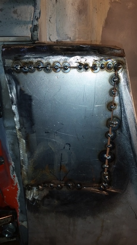

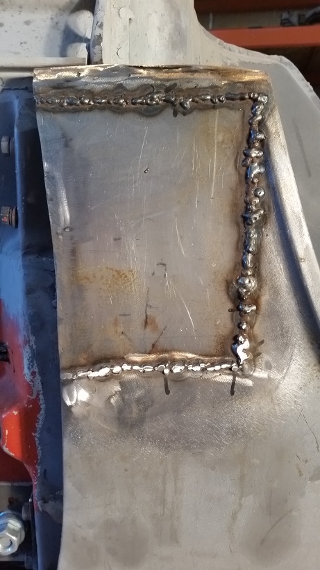

Started by finishing up the welding in of the suspension tie. Just for fun I decided to give the Millermatic function a try. On the 12 gauge stuff it worked like a dream. Unbelievable.
I should have tightened up my E's to stack the puddles a little tighter.
So I decided to try it on the front fender is was working on. BIG MISTAKE. I blew a hole with the first weld. It went form bad to worse. Today was a turd. I had visions of grandeur of getting it welded in perfectly with invisible welds.
Now that I now where the crappy steel is. I'll cut it out AGAIN and do it over. (IMG:style_emoticons/default/mad.gif) (IMG:style_emoticons/default/mad.gif)

While he was finishing the end cap. I welded in the patch on the bottom of the fender.

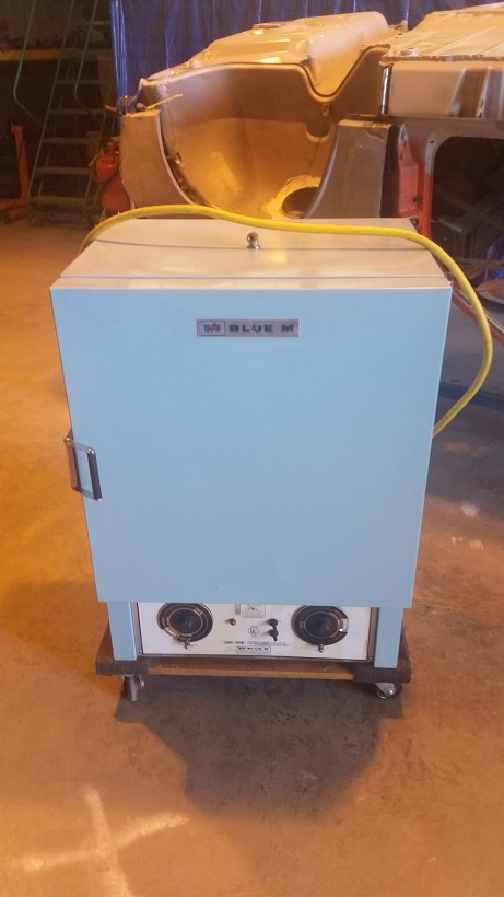

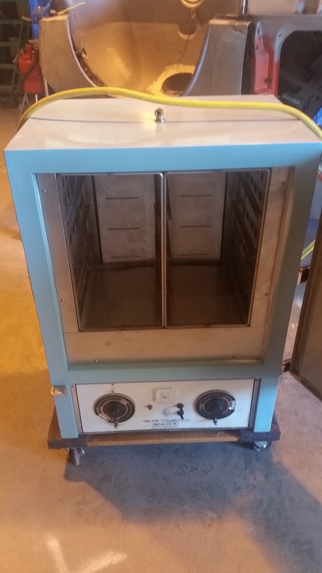

Another episode of Tool Whore
Ran across this manufacturing oven while looking for a frame rack. Building a powder coating oven was one of our next projects. This will give us a good start. Its about the same size as our wall oven here at the house 19*15*18.
I still want to get a frame bench before I restore my 911. So I keep an eye out on Craigslist every once in a while. I've conceded the fact that I'll never be able to find or afford a Celette.
http://www.ebay.com/itm/USED-CELETTE-SEVEN...512&vxp=mtr
I'm most interested in the table and pinch weld mounts. I know I'll have to create my own shock towers for both a 914 and 911. The search continues. I low balled a price on one in Seattle. Pissed the guy off. We'll see if he comes back.

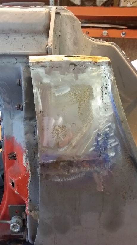

Left front fender round two. I cut out the section again. Just didn't like it.
A shot of the cut out. Then a shot of the patch all set up and a couple opening tacks.
Last grind on the right side was a bit too much. Wish me luck. Plan on backing every tack with a brass backer.
I thought I should go into a little more detail on the patch panel. We used the cut out section as the pattern. Dah. But we needed to create the folded over seam edge for strength. So I decided to use the air flange tool to start the fold. Then moved to the metal brake to bend it. Then we flattened it with a hammer. Then we finished it off with the 12 ton press. Using the blocks that come with the press to sandwich the patch.
So next we needed to create the radius in the fender. Once again we used the cut out section as the pattern. Ground the double edge down to match the pattern. Then welded the edge closed. Ground the welds down to bring in back to a finished edge. If needed I'll use All Metal to final finish the edge.

Slow and steady wins the race....................
The day went real well. I took my time welding it in stitch by stitch. A couple spots got a little too hot. But in the end it went in relatively flat.
I'm a little paranoid on over grinding. Thins the metal too much. I'll use All Metal to smooth out the imperfections.

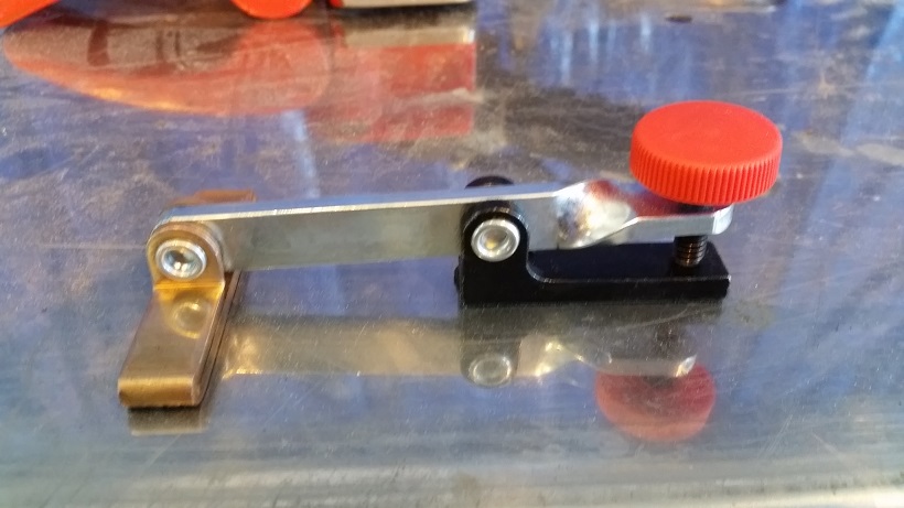

Magnetic Welding Backer from TP Tools. Worked great. Keeps the back real tidy.
Then I bought a bottle of cooling gel. Its working good too. Not sure how it works. But it does.
