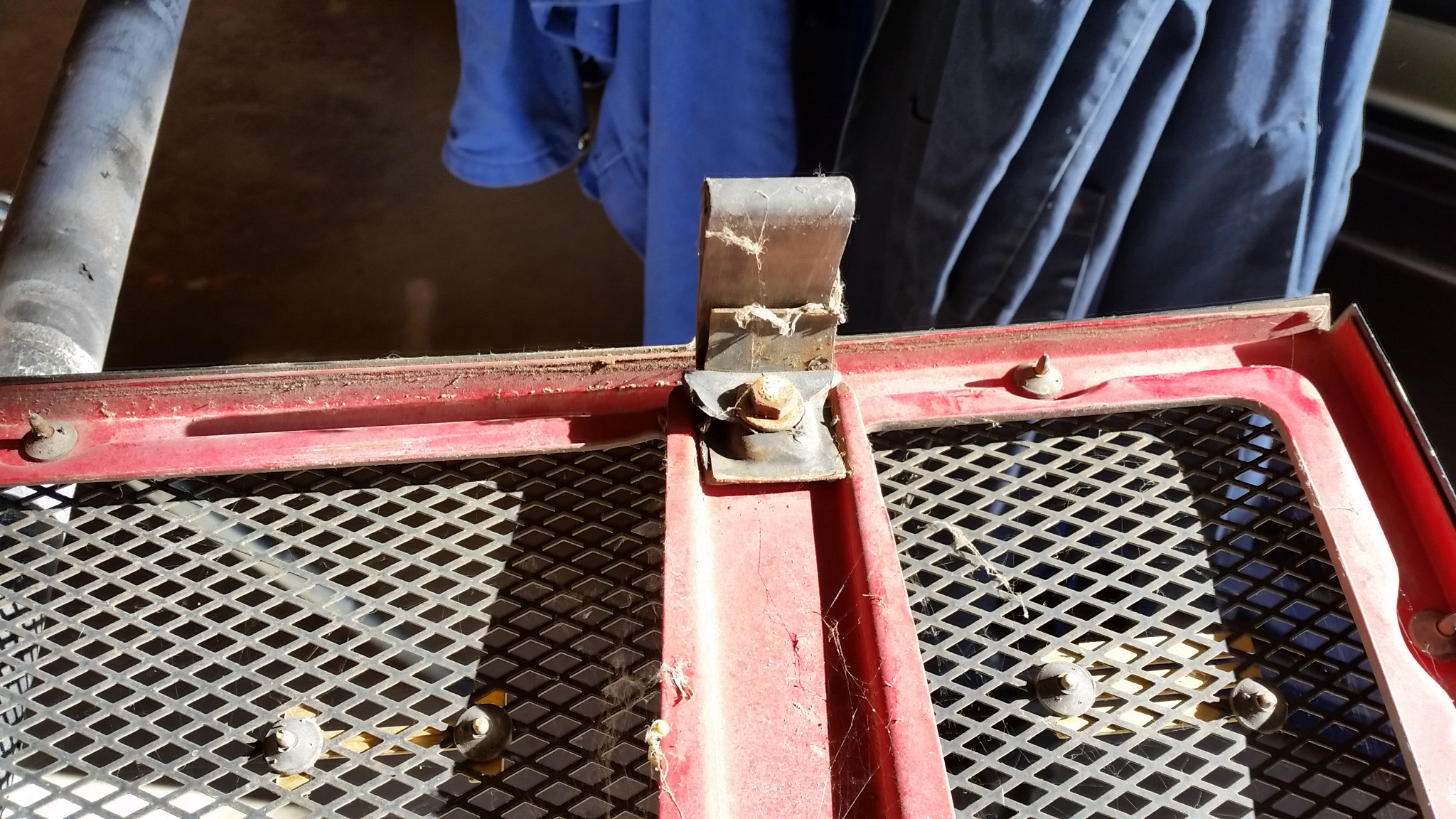

I was digging in my parts stash looking for a front hood that I'll start using for paint gun testing panel when I found early engine lid. It had a pair of rubber bumpers. (IMG:style_emoticons/default/piratenanner.gif)
