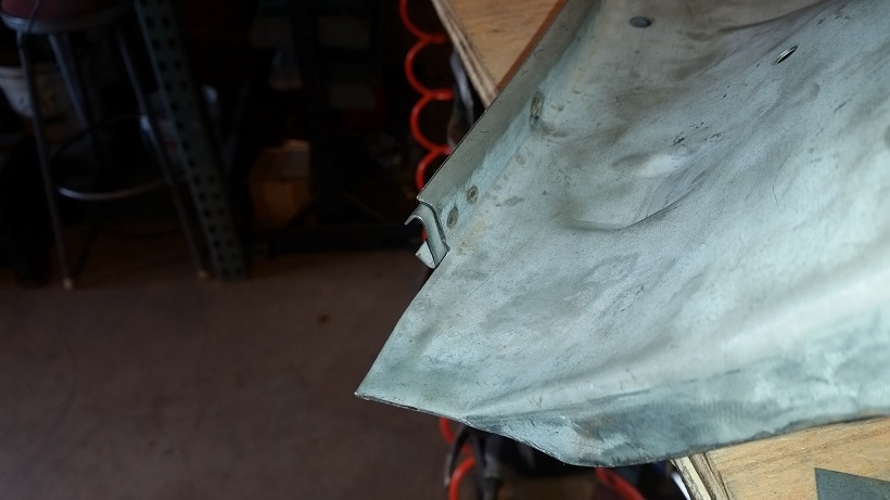

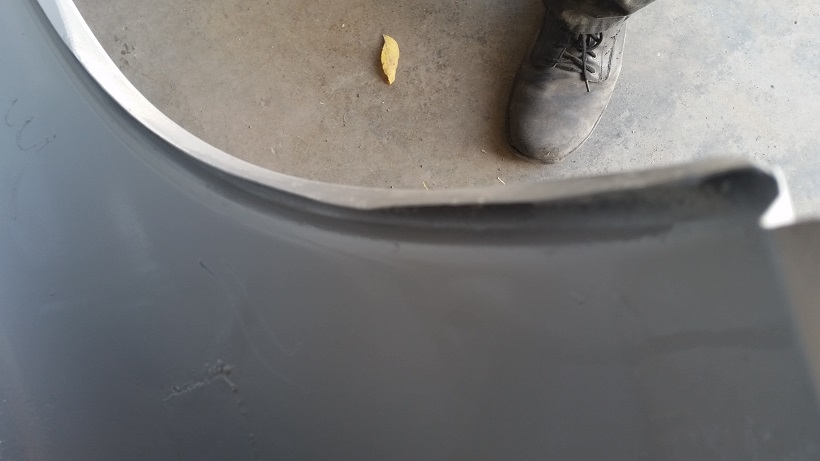

Back to the fender support patch.
Here it is having weld thru primer shot on the portion that will slide into the hem on the fender patch.
That primer portion will slide into the hem you see here.
Here is a couple shots of it installed both front and back.
The hem has been left loose until I install the doors. After that I'll either spot weld or tighten the hem and 2 part seam seal.
The bumpy welds you see are usually welding on top of old welds. I probably don't give them quite enough heat.

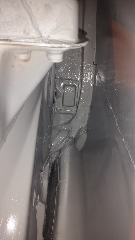

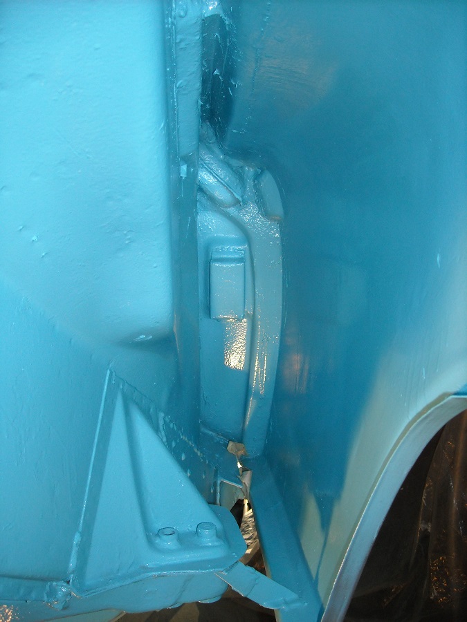

New Episode of Tool Whore .............
Dragging the air regulator and the filter into tight places with the spray gun is a PIA.
I'm going fabricate an air hose union on a stand mounted to an old heavy truck brake disk. Then have a short 6-10 ft. hose made to go to the gun.
I had a bitch of a time getting into here .............
Without on a rotisserie I don't know how you'd get the coverage I'm looking for. It will still need more more work after I build my stand.

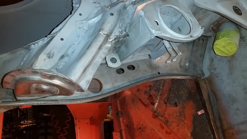

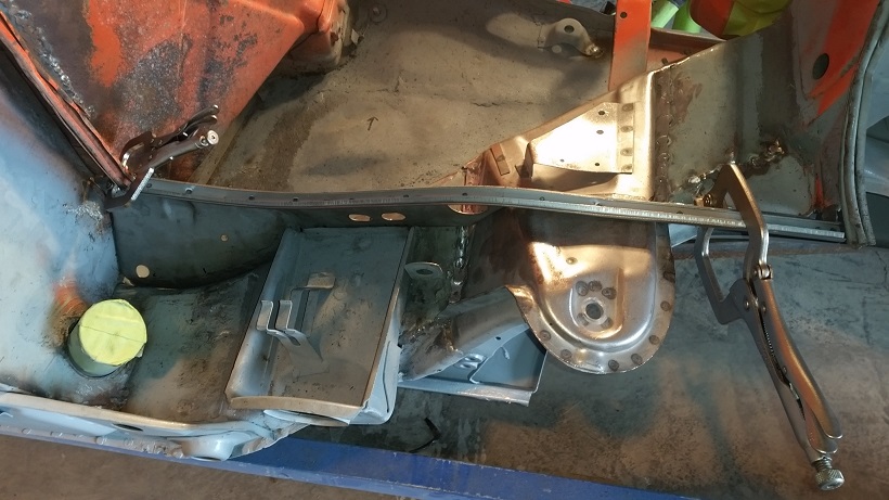

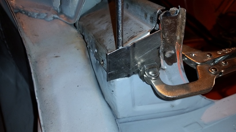

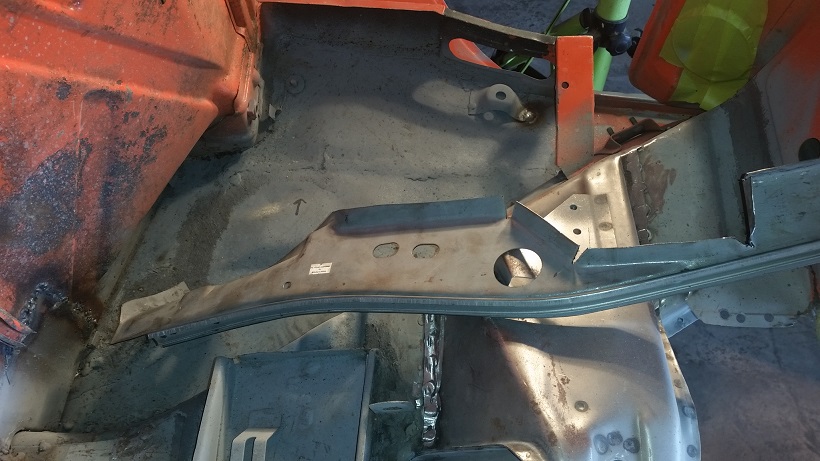

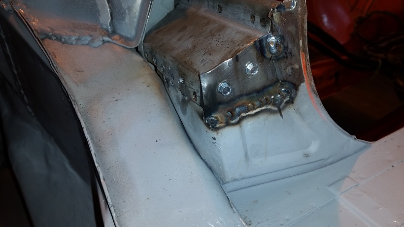

So on to installing the passenger side engine shelf. I'd been putting this off (IMG:style_emoticons/default/dry.gif) . Tinkered with it a couple times, I knew it was going to take some time.
Started by watching Adam's video from RD a couple time.
https://www.youtube.com/watch?v=uZGf9yaFHEk
Here we go ..............
I paused Adam's video quite a few times to see where he did the bending and cutting.
cary
post Oct 27 2015, 09:37 PM
Post #569
Posts: 3,900
Joined: 26-January 04
From: Sherwood Oregon
Member No.: 1,608
Words of wisdom.
You'll have trouble with lining up the new one with where you cut out the old rotten one.
Back engine shelf. Rear corner.
Most of the three hours of fitting was spent right in the hell hole corner.
Then I had to cut just a smidgen off the engine seal rail at the fire wall rail corner.
Most of the work was done with the floor vise, anvil, body hammers and these pliers.
http://www.amazon.com/Irwin-23EL5-8-Inch-L...t/dp/B0000TFGFU
After three hours it was fitted and ready to be welded in.
cary

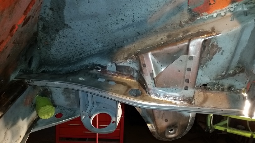

post Oct 27 2015, 09:43 PM
Post #570
Posts: 3,900
Member No.: 1,608
Back from Subway and ready to go ................
No real issues with welding it in. Except that dumbass used too much weld thru primer, again.
Shot from underneath .............
cary

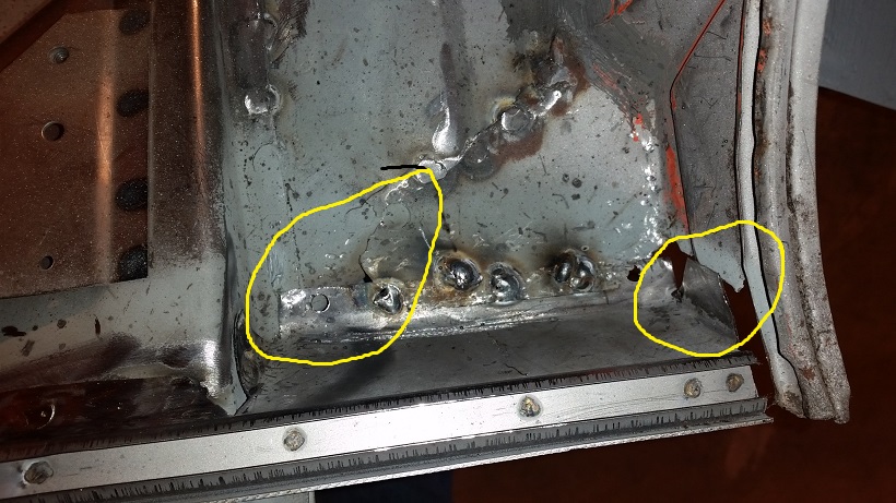

Ok, on to the bad news.
The rear corner will need some reworking fabrication. Tomorrows project

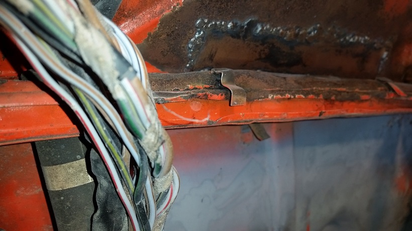

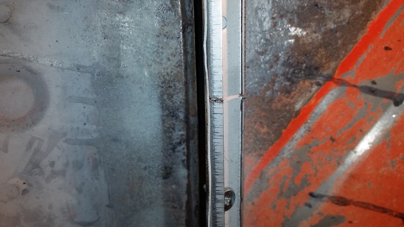

So while working on the side shelf I decided that the rear shelf needed some tender loving care.
Off came the rail. I actually tried Rick's spot weld removal technique. All I did was use my auto center punch from HF. Then drilled a dimple in the spot weld then popped it off with a screw driver. Easy Deal.
An hour or so with the hammer and dolly and the multiple wire wheels on die grinders.
I'll give it some more love tomorrow. Then give it a spray down with OSPHO.

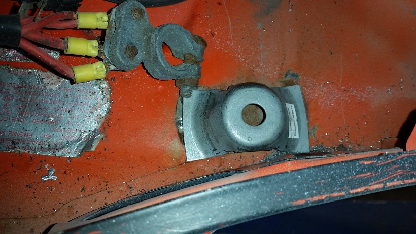

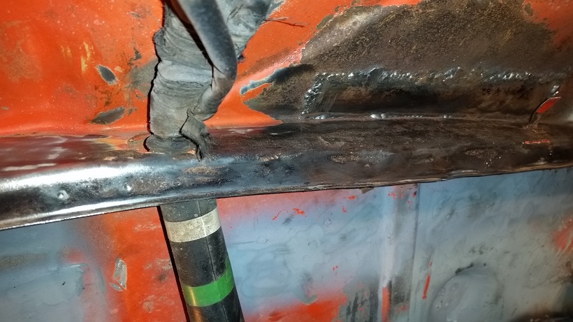

I was on a roll ............. off came the broken rear trunk hinge pivot.

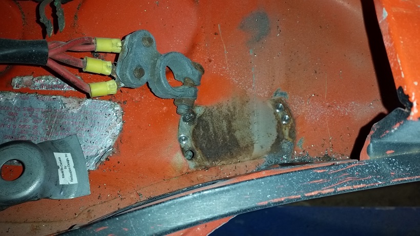

The trunk pivot point is one of my upcoming projects, what process will you use to line up the new part?
cary
post Oct 28 2015, 09:04 PM
Post #574
Posts: 3,900
Member No.: 1,608
The part lays up against an overlap seam for starters.
Then I line it up with the marks I made with the spot weld cutter. The only issue that I saw was that new part is just a smidgen smaller.
One could make a cross with a scratch awl in the pivot opening. But with amount of adjustment you have on the trunk it's not real critical , + or - 1/16. IMHO.

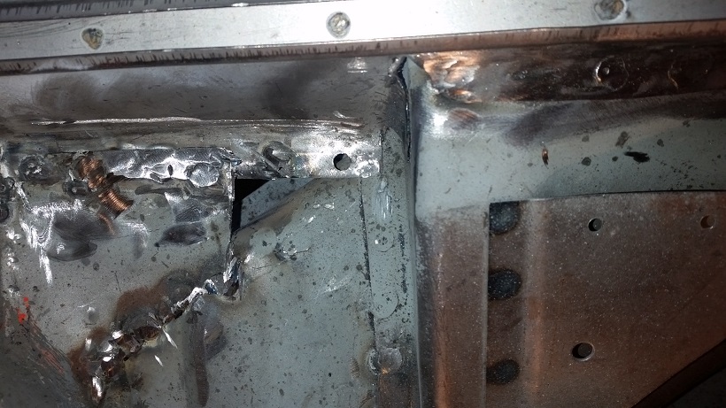

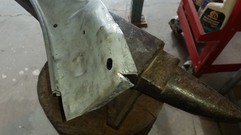

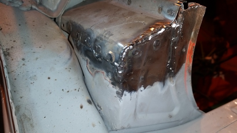

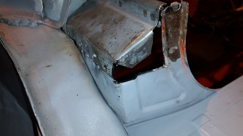

Started by cutting out the tore up end panel. If IIRC it wasn't so much rusted as it was over welded, imagine that. Who'd do some thing like that. Factory Weld. I swear I didn't touch it.
Patch cut out. Added a ramp (kinda) with the vise and a hammer.
Fitting the patch. Lots of back and forth to the grinder. Touch ups with the die grinder.
Time to weld it into place. Cut off the excess with a cut off wheel.
Ground it down a smidgen more after the picture was taken. This area will get sprayed on seam seal so not real critical.

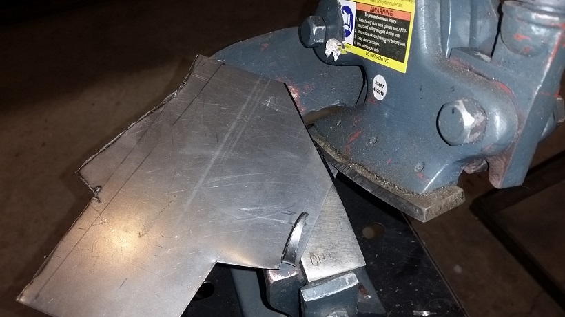

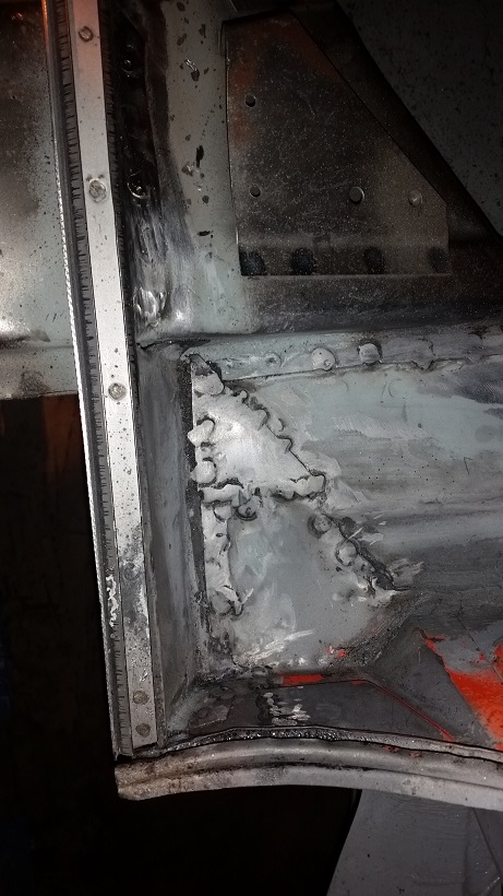

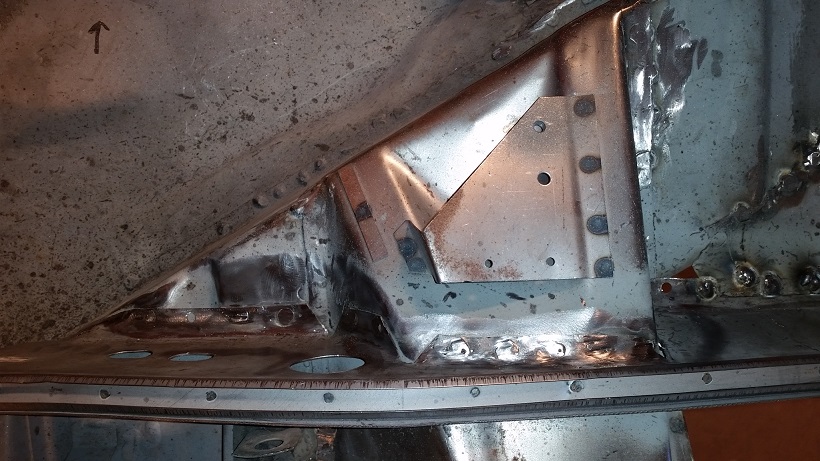

Now on to the inside. Once again it was kinda messy getting the old engine shelf out.
Big rosette welds. (IMG:style_emoticons/default/sad.gif) (IMG:style_emoticons/default/sad.gif) Plus its a new upper long.
Off to the shear to cut out the patch.
All welded in .................
Fairly straight forward welding. All new metal. Just reset when going from 18 to 18 vs 18 to 16 or 14 (long).
This area too will get sprayed with seam sealer.

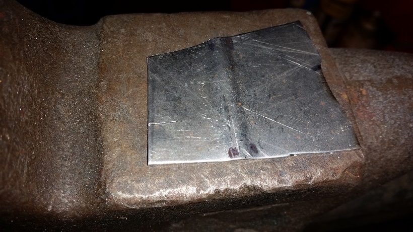

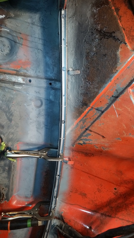

Now on to the rear RD, Engine bay channel, must be bent to fit. Sorry to say I couldn't get it to bend without buckling the channel. Maybe getting out the torch would have worked. But it too would have deformed the channel. So I cut slits in it. Bent real easy then. LOL.
If I every put the piece on a CW car I'll need a new plan. Or at least 2 or 3 pieces to tinker with.
Pretty straight forward. I did go in and clean out the slits with the edge of the cut off wheel so I don't have issues installing the seal before I installed it. Did the same after I did with the rosettes after welding. Ran a small flat screw driver along the inside to feel for burs.
After I decided to cut the slits I should have pulled out the spot welder.
Note to Self, Next time. Cut slits. Hold in place with clamps. Use spot welder.

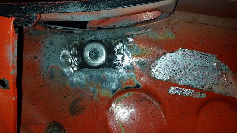

Last project for the day. Welding in the trunk hinge pivot.
