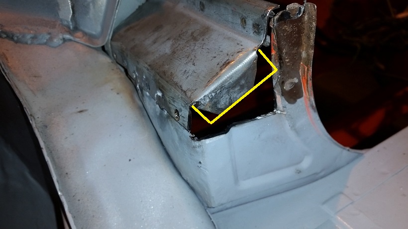

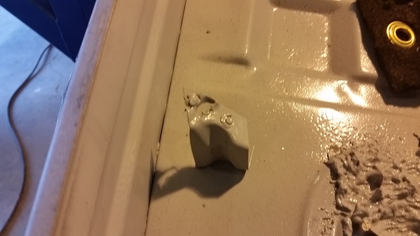

The back edge/flap on the engine shelf/shock tower/rear trunk fire wall belongs on the outside. I shouldn't have cut the corners off either.
I think that will be a piece I surgically remove from my parts car. On a CW car that would be tough to replicate, its a pressure formed piece.

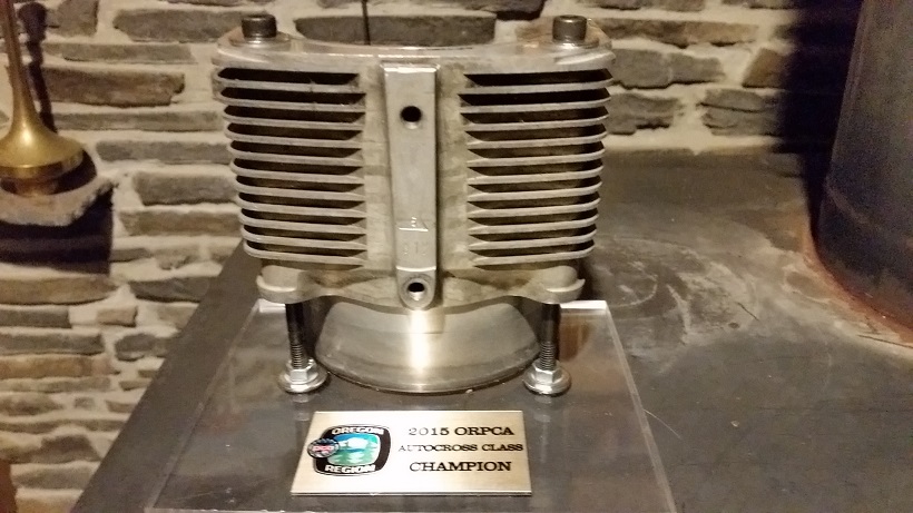

Time for a bit more horsepower. I stumbled upon a pair of SSI's for the 3.2. I need to go and talk to Dr. Gamroth an see what other couple pieces I need to blend with that.
To get to the winners circle sometimes you need to tighten up your line. But not this tight. (IMG:style_emoticons/default/biggrin.gif) (IMG:style_emoticons/default/biggrin.gif)

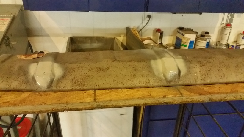

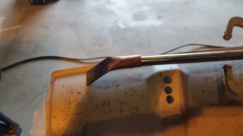

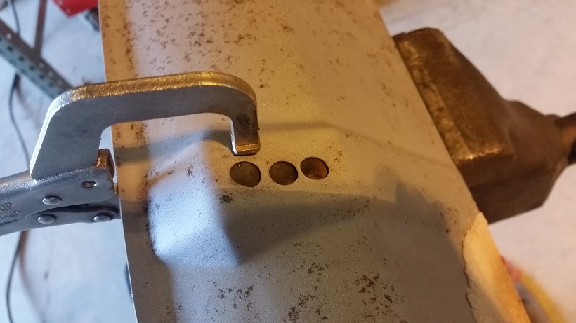

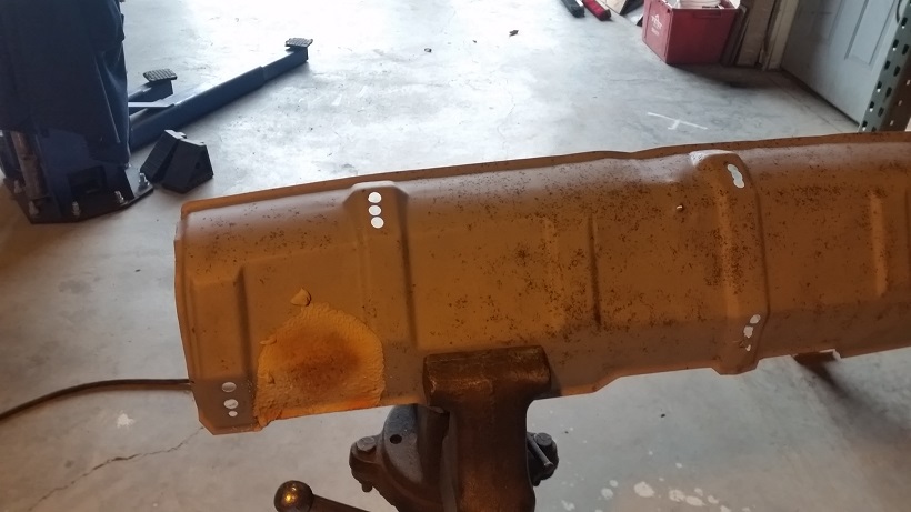

So on to preparing the exhaust heat shield for epoxy primer. First order of business is to fill the spot weld cutter holes.
So I (Tool Whore) start looking for some brass or copper to back the holes with.
Here's what I start with.
All set up and ready to go.
I'll tell you a secret. All that backer is is a copper pipe squished flat. Not up to the task.
The shot above looks like the way you'd like to weld it. But I switched backers and switched the welding to the inside. Much more better
Below is the backer I used, much thicker. Backside comes out almost flat.
http://www.harborfreight.com/welding-spoon.html
All finished up. Shot a little SE primer to keep the welds from rusting. SE primer will have to be shot off in the blast cabinet before the epoxy is sprayed on.

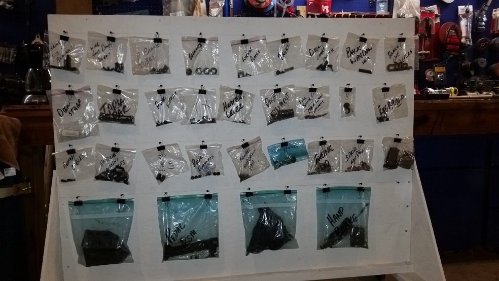

So I decided to unpack the tote of plastic bags. They went on my rolling wall. Not quite the metal wall and magnets that Canepa uses, but it will work. I think the next tear down of a car the bags will go straight on to the wall. Its two sided.
I have one bag without a label and I can't remember what they are. I'll post a ? for the entire World.

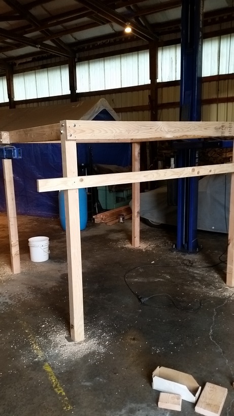

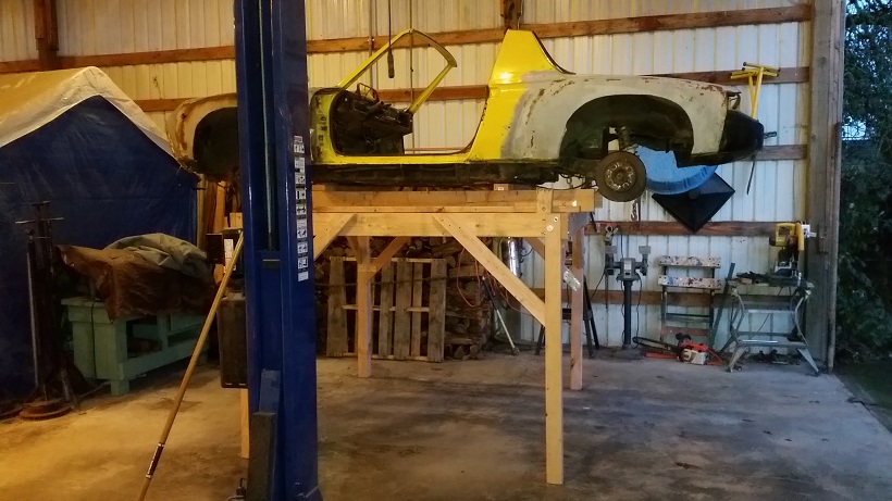

While I'm working on that. Super In Law is building his car stacker. I get the basic design and loading the top car with the lift. His moving it with a snowmobile trailer I'm not quite all in. I'm told yesterday that moving design is based on how they moved 90mm gun emplacements in Korea. More details to follow. 4 * 4's and 2 *6's.

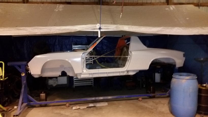

The paint booth passed the test. 68 degrees. So we are now ready to paint again.

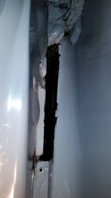

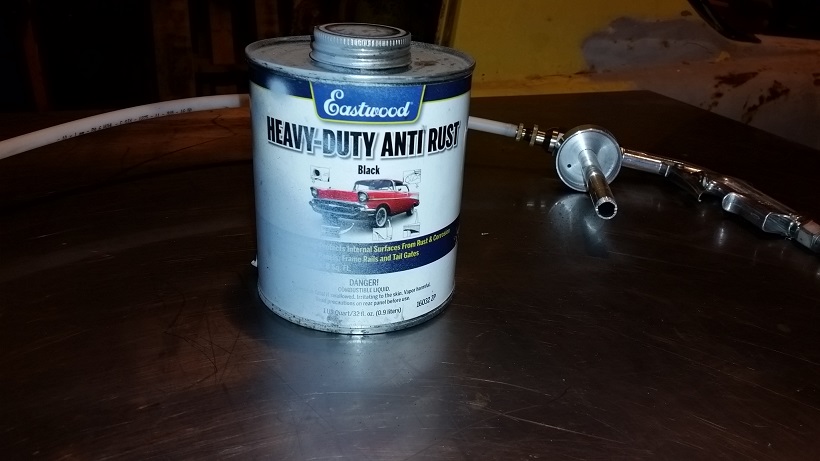

Decided to coat the inside of the targa bar first. I used their HD Anti Rust with a schutz gun with an interior spray hose.
The black stripe is the targa bar cavity hole all sealed up. It's now ready for our custom cover to be tacked into place.

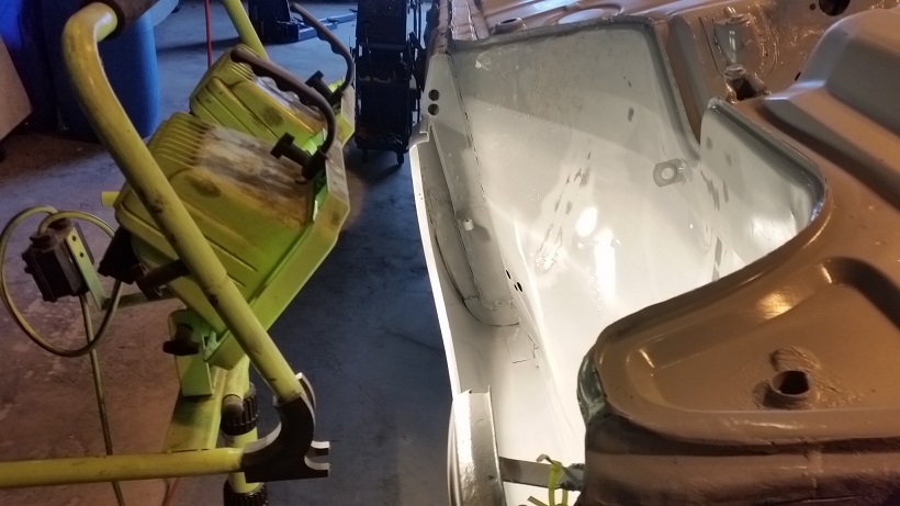

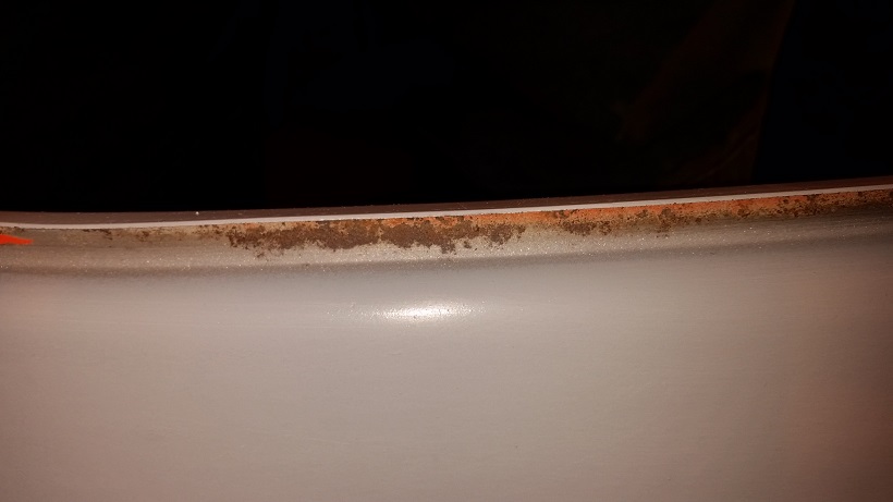

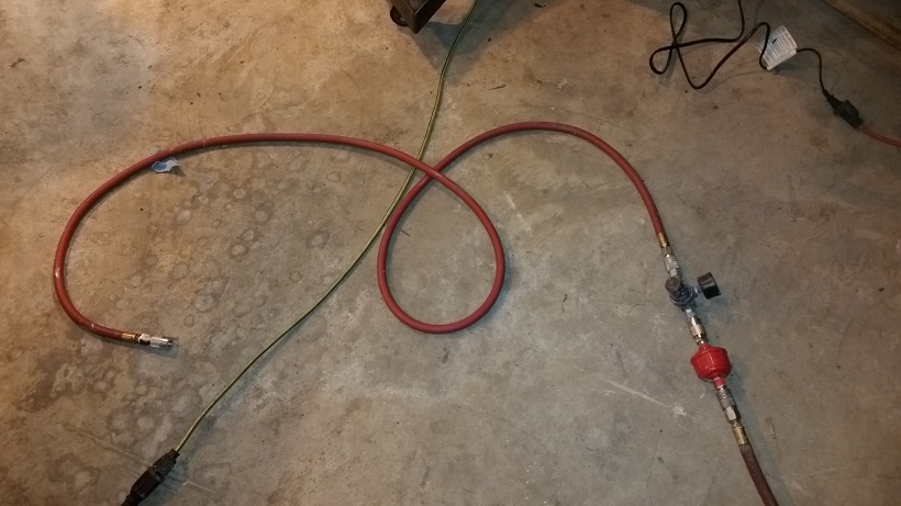

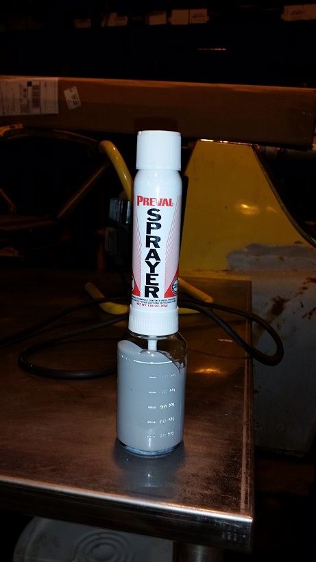

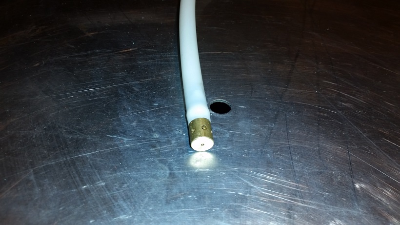

Now back to spraying epoxy primer on the inner fenders. On the first go around I couldn't get the primer into the inside of the fender lip.
So I decided to give the PreVal sprayer a shot.
I'll shoot some finished pictures tomorrow. Needed three hands to get the job done. Mirror, flashlight and sprayer. But it got the job done.
Then I gave the front inner fenders its second coat of epoxy. I built the jumper hose I mentioned earlier so I could use the detail gun without the filter and regulator hanging off the end.

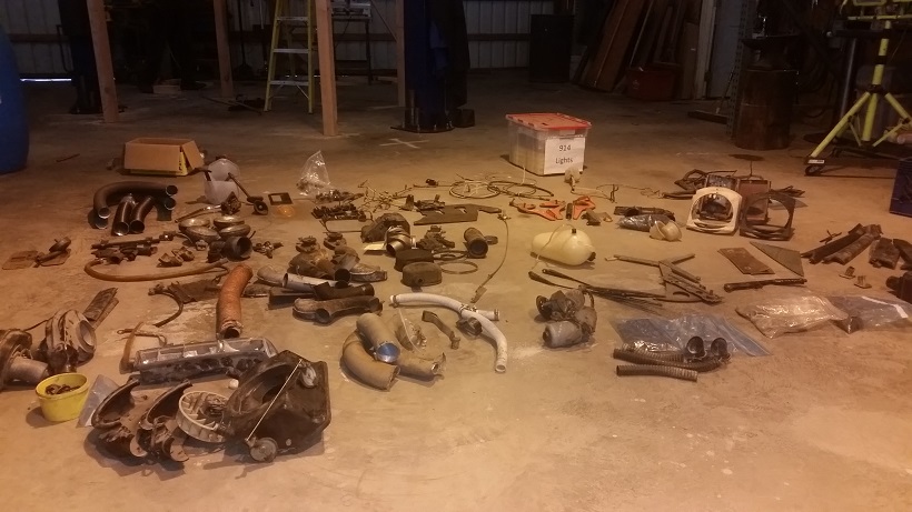

So I set about unpacking the 12 totes of medium sized parts.
SOME ASSEMBLY REQUIRED (IMG:style_emoticons/default/bye1.gif) (IMG:style_emoticons/default/bye1.gif)

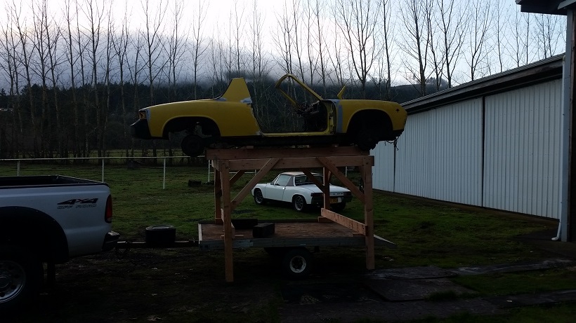

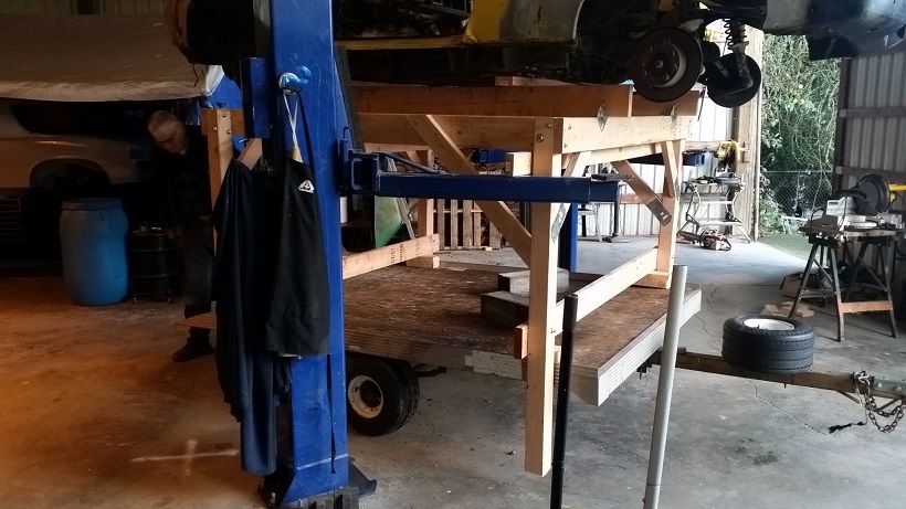

So we start the week finishing Super In Laws car stacker.
Loading on the trailer.
Here I am towing with the truck.
Into its new home/location. Not quite ready to park my car under it. (IMG:style_emoticons/default/popcorn[1].gif)

QUOTE(cary @ Dec 14 2015, 08:50 PM) *
All this needs is some heavy duty castors on it....
Looking good.

That is version #1. The traveling version so we could move cars to and from the other building. Version #2 will have some mods and wheels.

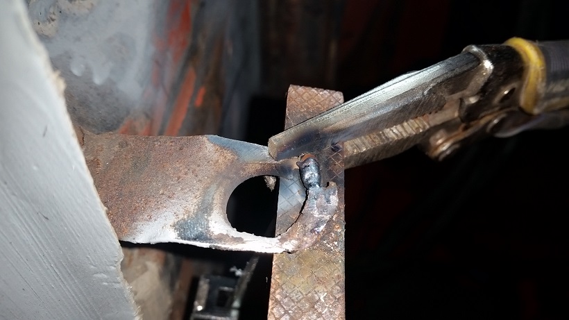

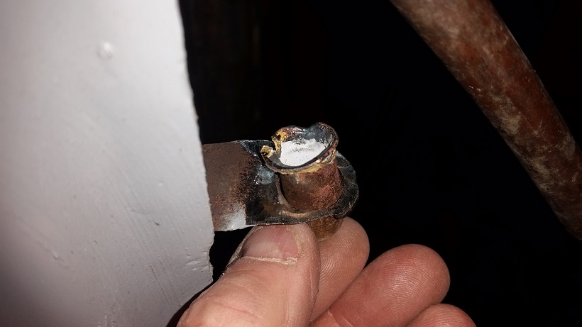

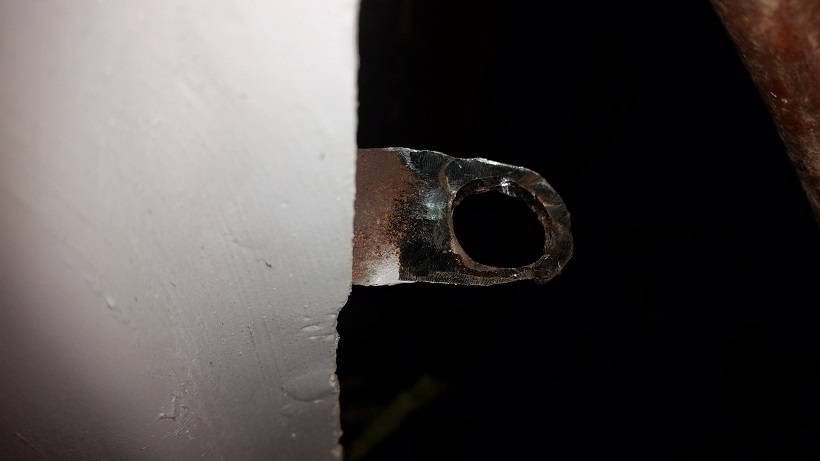

Decided to start tackling the brass e-brake pipes that go thru the firewall. First item to work on is the hoop that holds the right side pipe to the firewall in the engine compartment.
Started with this ............. got melted removing the original with the torch
Got some brass backing and started to blip, blip, blip.
Ended up with this ...........
Stopped at Ace on the way home and picked up some 1/2" brass refrigeration pipe.
The stuff I had laying around was too old and hard. Wouldn't bend.
