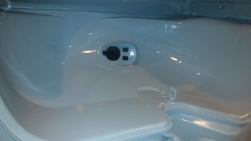

Here's a shot of the front fender after the SPI epoxy has cured.

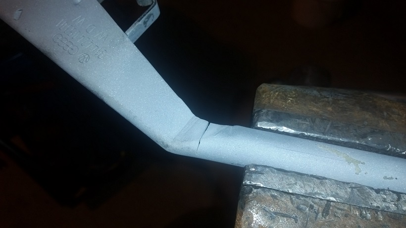

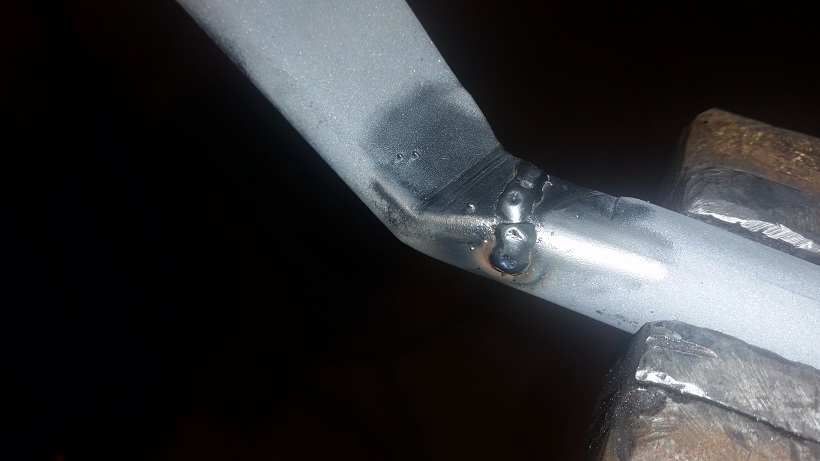

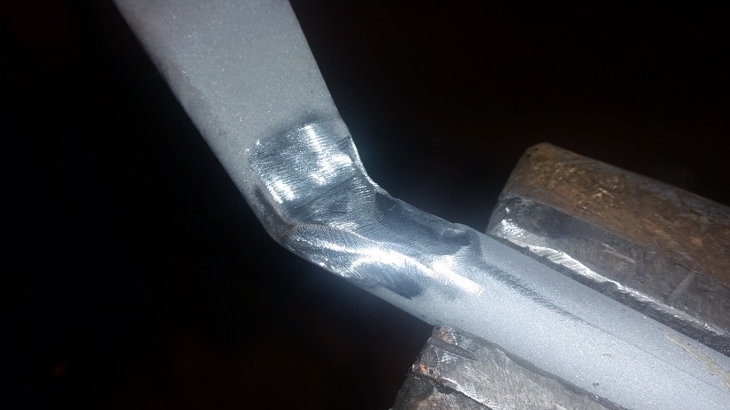

Started the day in the kitchen.

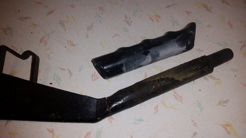

Boiled some water to get the handle off the e-brake. I got side tracked and cooked it a bit too long. Came off with a simple twist.
Unscrewed the push button and pulled the rod and spring out. Then ran the handle thru the blaster cabinet prepping it for welding the crack.
Measured the metal. 14 ga. Then reset the MillerMatic accordingly. (IMG:style_emoticons/default/welder.gif)
Good as new. (IMG:style_emoticons/default/cheer.gif)

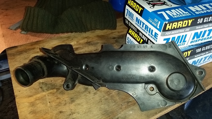

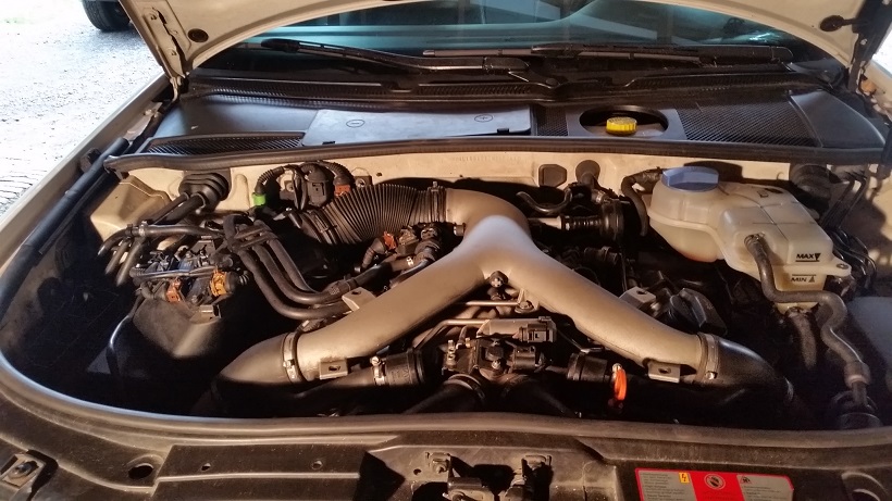

My auto project the last couple weeks has been working on my son's 2002 A6 2.7T, again. I finally drove in and put new gaskets under the cam tensioners and replaced the cam plugs. Then set about finding a one quart per month coolant leak we've chasing for 5 or 6 years. After taking it apart and putting it back together a couple times I finally found it. It was a small chip on the lip of the thermostat cover. That rim seats right into o-ring that is used as the thermostat gasket.
It's got a few more hoses and electrical connectors than our T4's.

Looks familiar... Needs more coolant (IMG:style_emoticons/default/smile.gif) You replaced the spider hose yet? PITA...

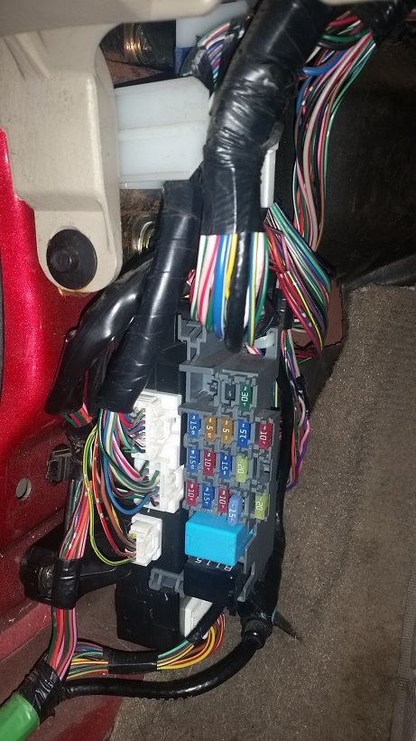

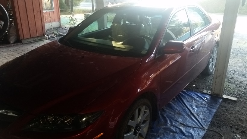

#1 Project. #2 sons fiancees 2006 Mazda 6.
Car goes electrically crazy when it rains. Turn signals and flashers don't work. Turn signals stay on and drains the battery. Thru web research I narrowed it down to the flasher. But then we have a problem. Most the brain surgeons on the web don't have a clue where the flasher is. News Flash, 2006 Mazda doesn't have a stand alone flasher relay like our experienced (age is an attitude) cars do. It's embedded in the Body Control Module. Which I finally locate under the small inside fuse panel. The going crazy issue is caused by leaking water. When I finally find it, it and the attaching plugs are drenched. (IMG:style_emoticons/default/barf.gif) (IMG:style_emoticons/default/barf.gif) Took the module apart and put the board in a bowl of rice to dry out.
Carpet is saturated. (IMG:style_emoticons/default/sad.gif) (IMG:style_emoticons/default/sad.gif) Dandy. The leak is coming from a Mazda design flaw. The hood release cable pops out of the side panel. So when driving down the road at speed in the rain some kind of pressure/vacuum event sucks the water in. The hole in the inner fender is behind the plastic inner fender. Really out of line of fire.
Remedy. Time to use the Big Ass Craftsmen screwdriver and press the strain relief/grommet back in the hole. Getting enough light and screwdriver in place is a bitch. But it finally pops in. End of story.
Except the little heater is still running in the car to dry out the carpet. The board fired right up without any issues.
Body module is the black box with the white plugs.
Car will have one more big road trip. After he and the fiancce pass the Oregon bar in June. They're heading to Wall Street to pay off their loans.

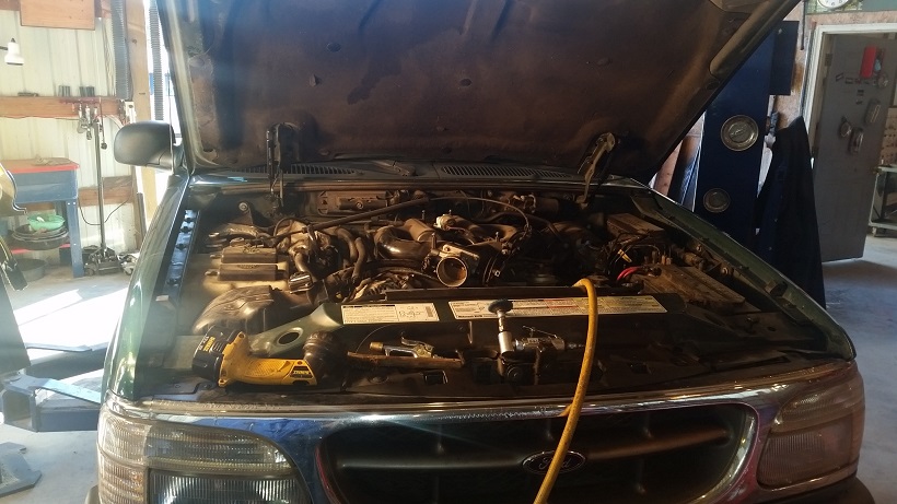

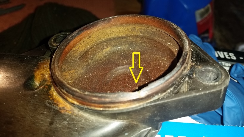

#2 Project. The water pump goes out Sunday night in our one owner 99 Explorer. Girls were coming back from the mall. So we hook up the open trailer and go and pick it up.
Pouring down rain and 40 degrees, pitch black Nice thing about a water pump failure. Belt comes off and the power steering stops, all the lights come on.
No story. Got only 70K on the water pump. (IMG:style_emoticons/default/mad.gif) NAPA warrantied it. Finished up installing the pump last night. Pulled the thermostat right before quitting time so we can do a static flush this am. Rinse and repeat till it comes out clear.

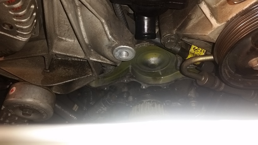

Finished up the Explorer. Flush went smoothly. Probably ran 20 gallons thru it to get completely clear. (IMG:style_emoticons/default/driving.gif)

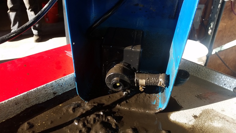

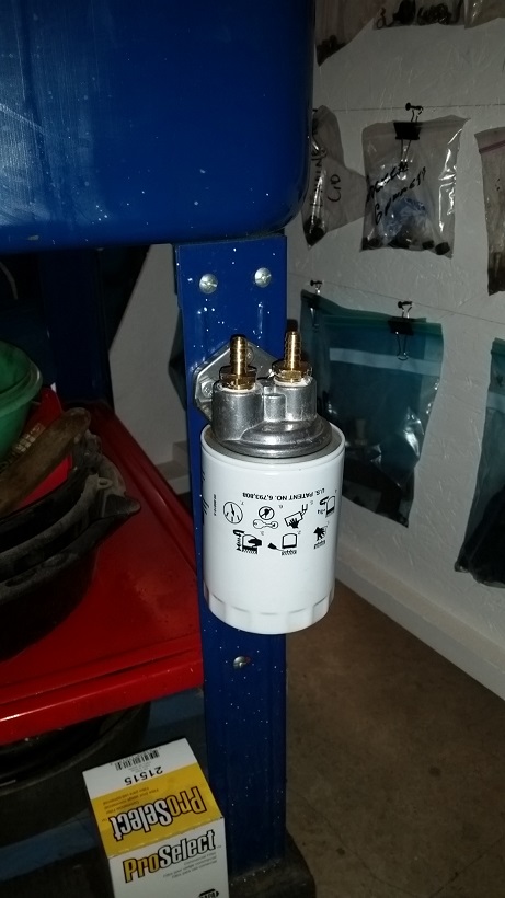

Decided to install a spin on filter onto my HF parts washer.
https://www.youtube.com/watch?v=vNqsQ-jxvHA
Filter hanger from Summit. $25 worth of barbed pipe fitting from Ace.
Pulled the cover off the pump. Kind of ugly ........... (IMG:style_emoticons/default/sad.gif)

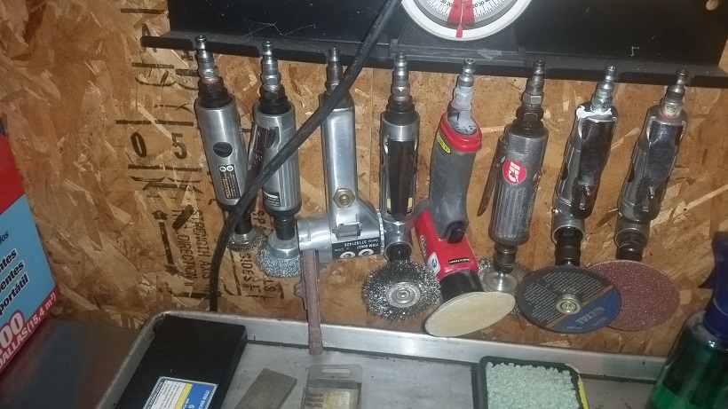

Got a couple new IR Die Grinders with a $100 Amazon gift card I received.
For twice the money $40, there's no comparison. The HF ones will be relegated to little wire wheels.

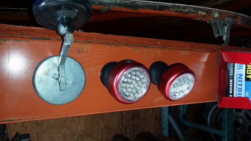

Then I found the replacements for my welding close up lights. (IMG:style_emoticons/default/piratenanner.gif) (IMG:style_emoticons/default/piratenanner.gif)
My McGyvered ones bounced off the floor one to many times. New ones $22 at NAPA.
