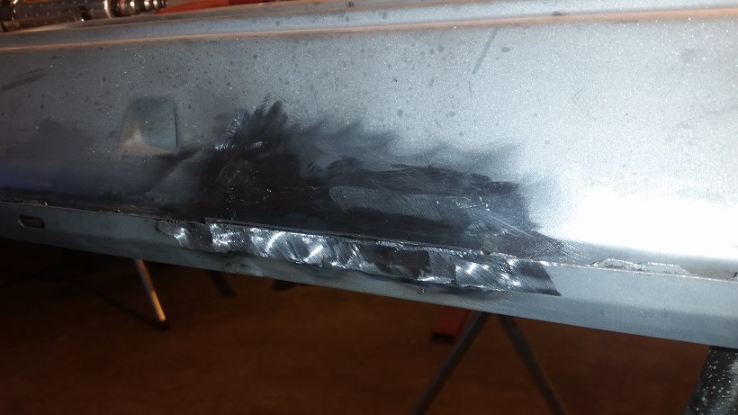

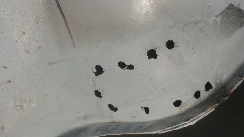

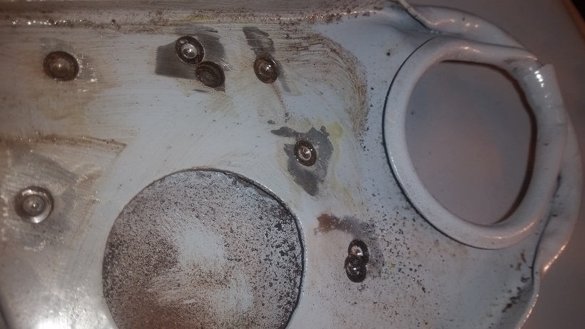

Finished up the door patches. Had trouble with the grinding. I'm sure the pitting on the backside is causing the issues. Weak spots.
Corner was a bit of work. The channel is two layers and pitted so it was either too hot or too cold.
Blew thru this area about 5 times over grinding.

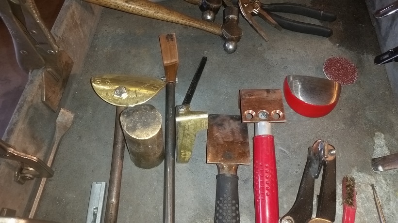

Here is my assortment of different types/shapes of brass.

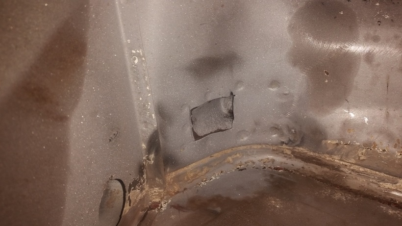

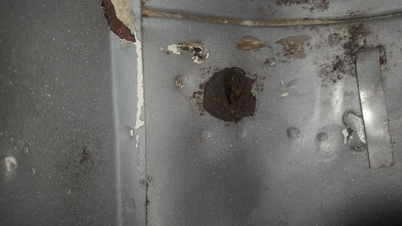

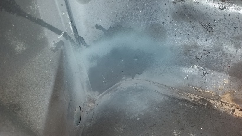

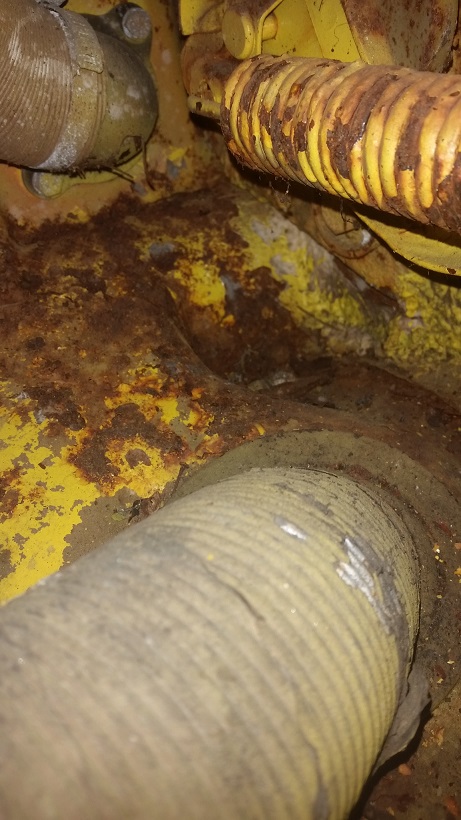

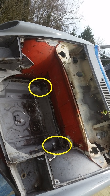

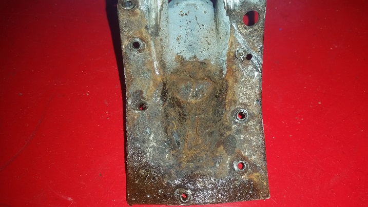

After bead blasting the trunk I found some more disturbing rust. It is the portion behind the front pair of steering rack mounts. Yellow circles
CLOSE UP
The dark portion is the backside of the mount.
Mount pictures
This is a piss poor design. No Drain so the air could flow thru.
The ? is. Do we take the support off and make a big patch? Or cut out the portion between the spot welds and patch it? I'm leaning on the big patch. But that will mean creating some kind of jig for returning it to right place. I've got just the right guy for that, LOL.
I'll need to take off the tow hook and patch under it. And there's a couple tears/cracks that will need to be strengthened.
After closer inspection it did have a drain. It just didn't work too well.

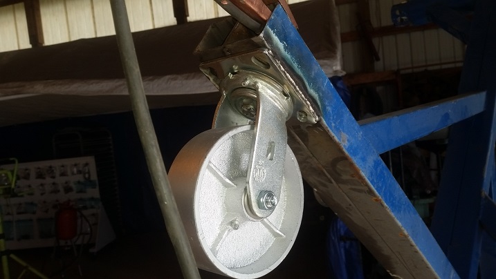

1. Bought some 6" steel wheels for the rotisserie. The 4" poly ones just take too much effort to get started rolling. The 4" ones will get moved to the body dolly.

I've been under the weather the last couple days. But Saturday we're back at it.

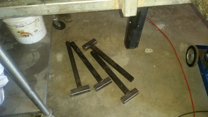

I installed the new steel wheels on the rotisserie. Now one person can move it with one hand.

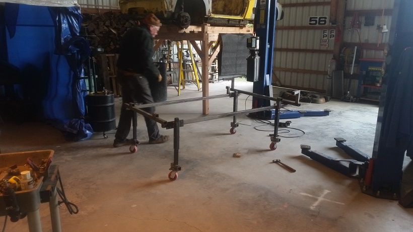

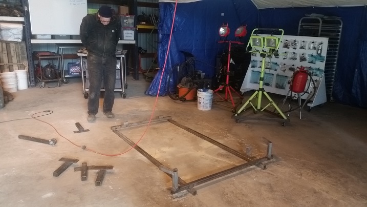

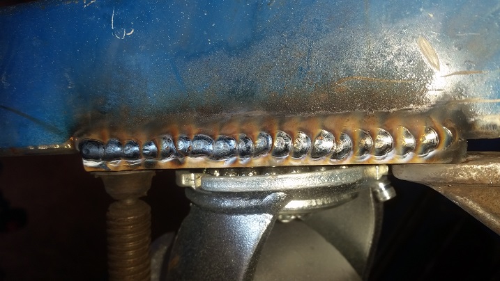

While I'm doing that, Super In Law was converting our body jig into a bolt on body dolly.
We scavenged some legs off some old produce display tables years ago.
These will be the legs with the old wheels bolted to the small tube on the bottom.
Here we are all finished up. Added ending 2/2/16

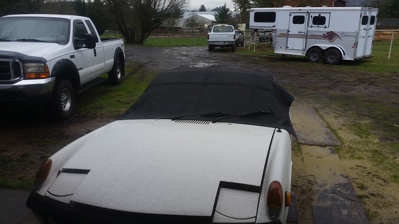

Another word of wisdom for those just getting into fabrication.
PLEASE cover all the glass on all your cars in the spray area when you you start to grind or weld. Those innocent little sparks will pit/melt the glass.
HF moving blankets are cheap.

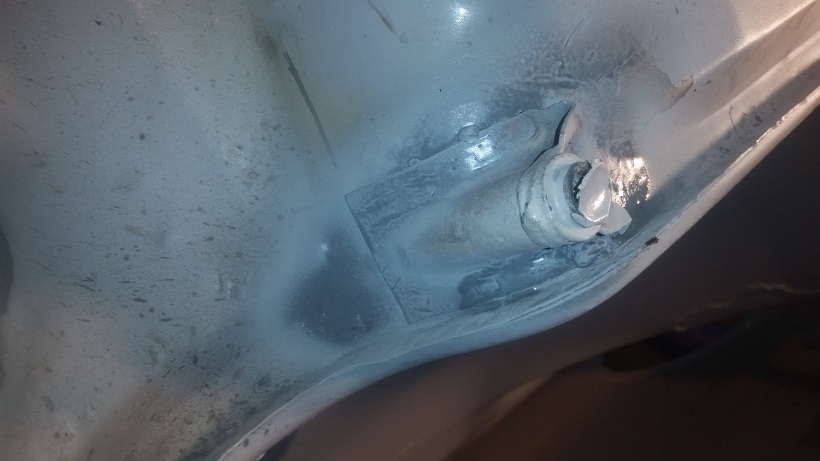

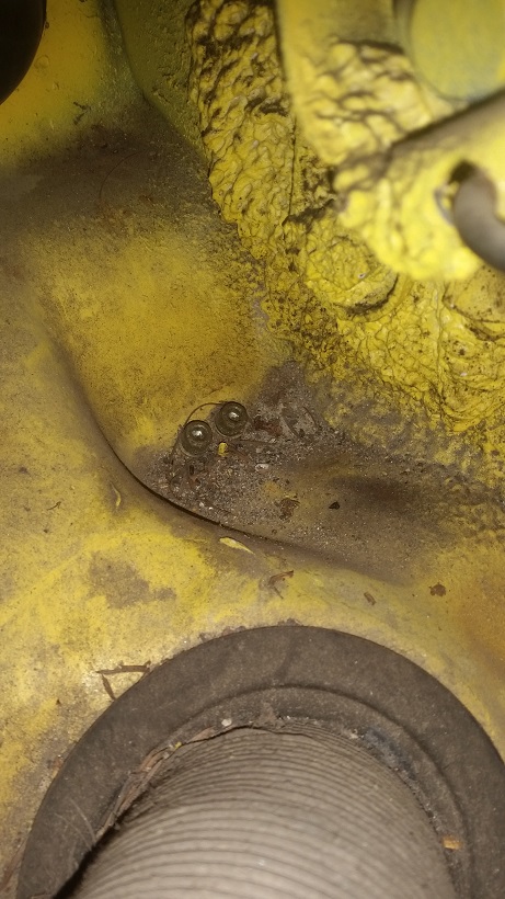

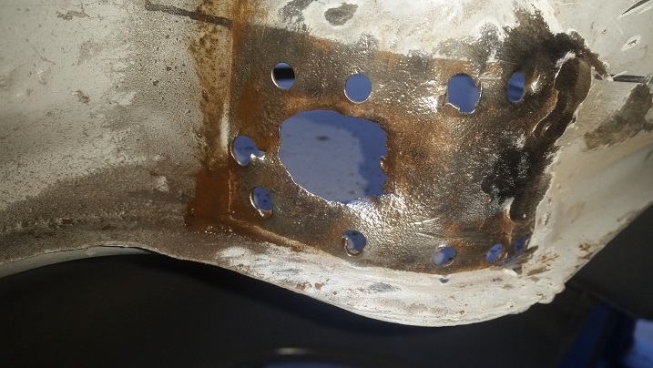

After the rotisserie was finished I went after the rust holes in the spare tire well.
After about 3 hours I had one of the suspension mounts off without too much collateral damage. Only one of the spot weld holes went thru. (IMG:style_emoticons/default/biggrin.gif) The trick is to watch the color of the shavings. Generally they'll be a bit of rust between the layers. You'll see just a short blip of brown in the shaving. That's when you've passed thru the first layer.
Because of the tight fit I used a 7/64 HF drill bit to drill thru both layers of each of the spot welds I could see. Because they seam welded after the spot welding, a couple were hard to locate. I drilled some from the inside, some from the outside.
Getting the seam welds cut without too much damage was a bitch. Most was done with the air hack saw bent like a noodle. After taking the guard/guide off. This was after I made a many and as big of cuts as I could make with the air grinder on the mandrel.
I'm always thinking would the time I just spent be worth the money I would be paying or charging ............ three hours to get a part off without damaging the part ?
The problem was exasperated by the fact that there was a spot weld under the seam weld. (IMG:style_emoticons/default/sad.gif)
This is a shot pre bead blaster cabinet. The mount is solid as a rock. Measured 13 gauge. Was left in the OSPHO pan drying. The metal in the rusted hole gets pretty solid right close to the rusted edge.
The welding in of the patch will determine how I proceed. Completely rosette weld in the 1/4" spot weld cutter holes? Or fill in and drill a new 3/16 holes?
cary

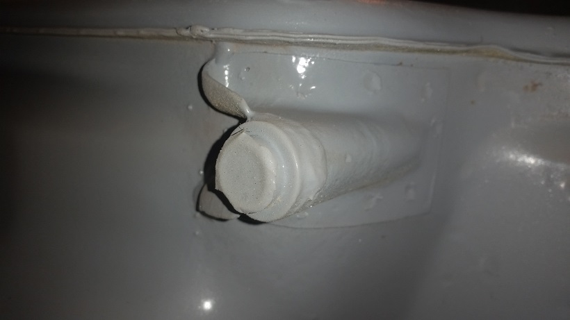

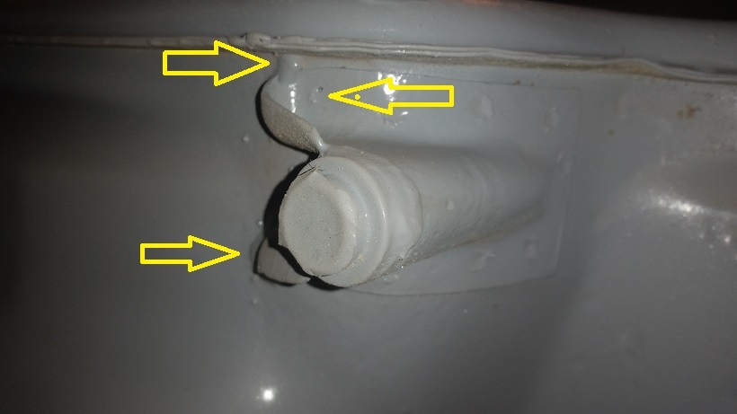

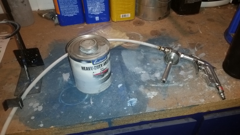

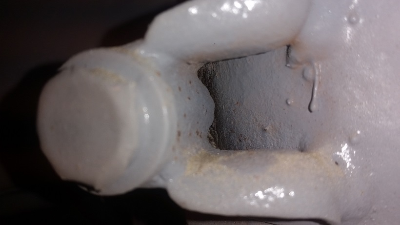

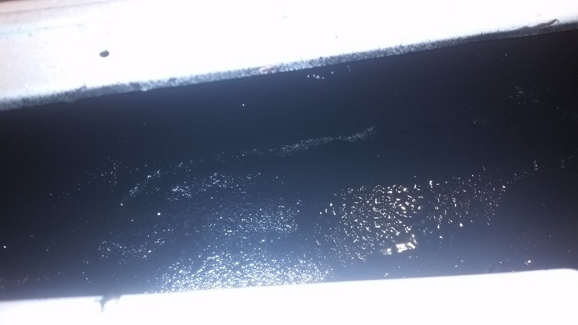

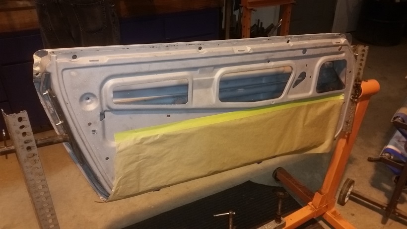

Decided to seal up the inside of the OSPHO'd door. I used the HD Eastwood stuff that I already had. Kind of messy, but should do the trick. I'll probably still seam seal the joint using my finger later. I'll wait till both doors are done.
camera lens must have had a smudge on it
I'll add a picture of the lap joint if I can take it

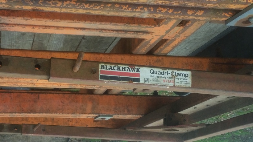

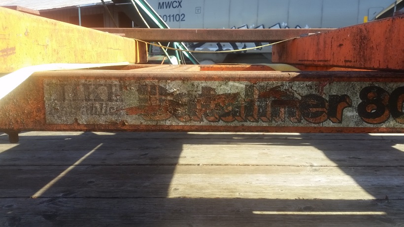

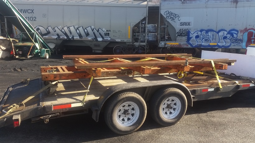

Nike Hydraulics Dataliner 80 Frame Bench with homemade drive on rails. It was on my retirement wishlist (10-12 years out), but it fell in my lap. It came with a Blackhawk Quadri-Clamp.
I have no intention of doing any frame pulling. Just a fixture to hold the tub in place when replacing longitudinals. For the short term it will give me endless hours of internet research time to figure out how I'll build the 6 or 8 tub mounting fixtures.

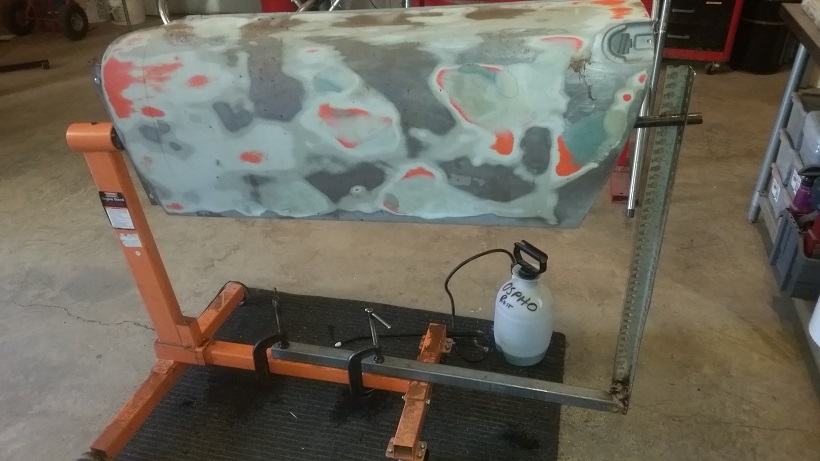

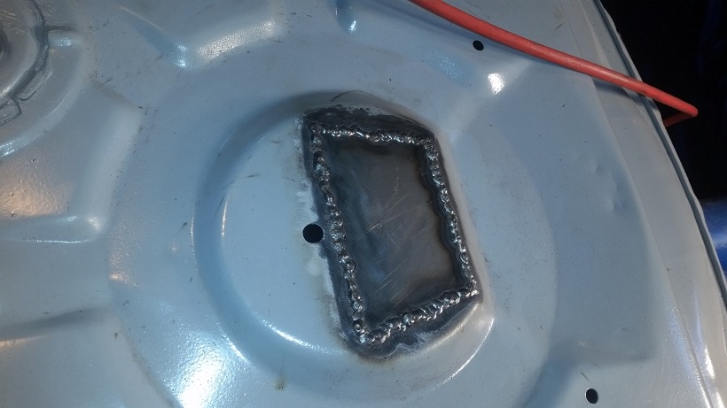

* Switched doors on the engine stand and sprayed it down with OSPHO.

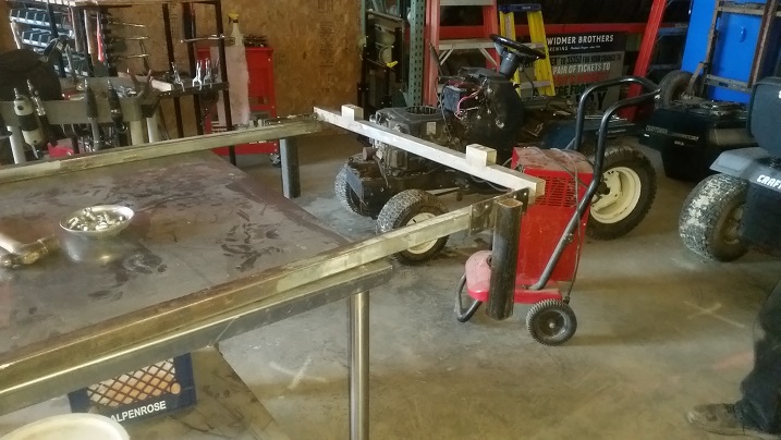

* Super In Law is working on the landlords lawnmower. He finally got it running. Looks like it will need a fuel pump dealy, engine vacuum diaphragm gadget.
Now back to the front suspension repairs.

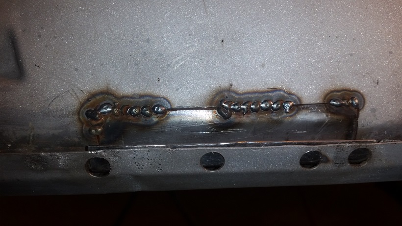

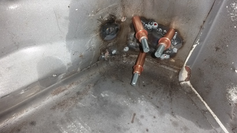

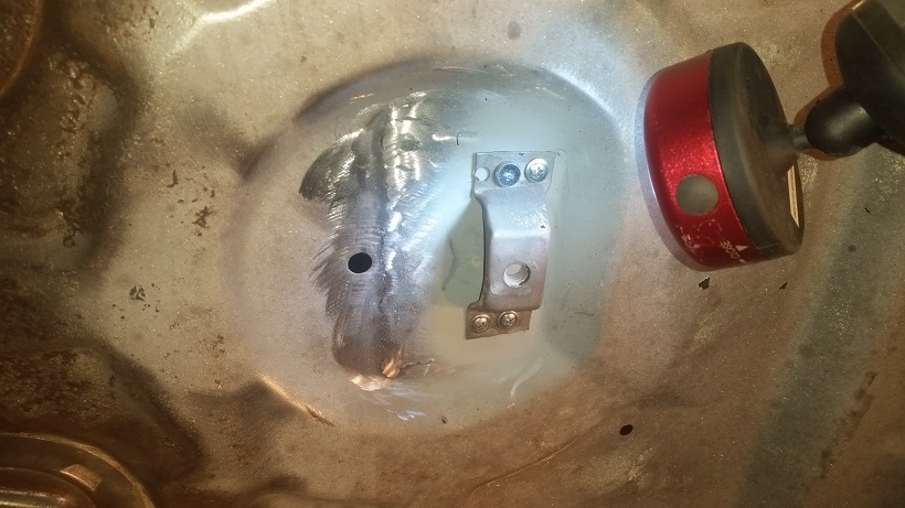

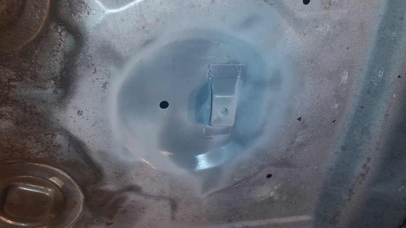

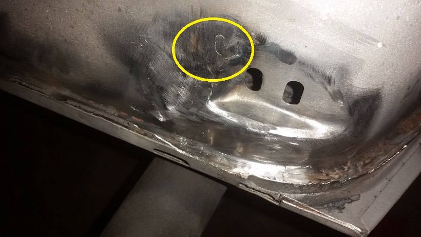

Patch plate went in without too much of a fuss.

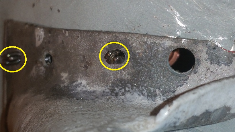

Decided to use the Clecos to hold it in place. Because you cant get your hand in behind the panel to hold it, it took two people. (IMG:style_emoticons/default/sad.gif) I almost bought a one man body shop in Montana years ago. So it kills when it takes two people to do something. What would I have done in that shop.
Yellow circled items are the business end of the Cleco coming thru.
Welding was a little tricky.
1. Dumbass used too much weld thru primer again. Should have taped off the welding surfaces and brushed those on after the sprayed on had dried.
2. Once again welding the 14 gauge mount to the 18 gauge tub.
Gooder as new ....................

Now to the other side ................

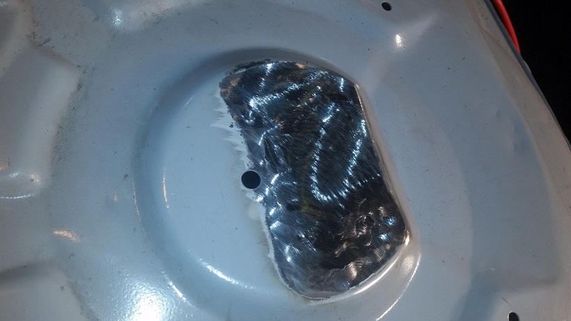

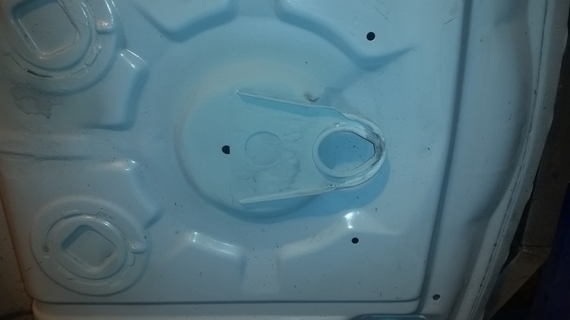

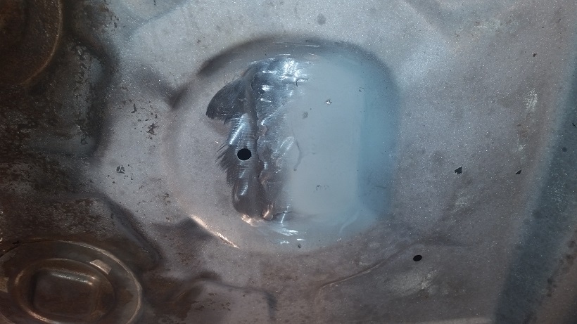

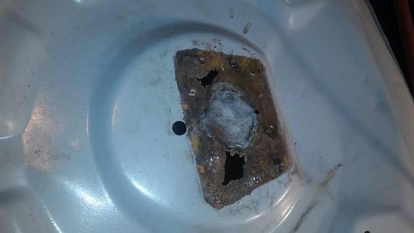

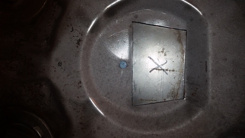

Cut out the hole from inside the trunk.
It looks like theres a second layer of metal. No, just a completely connected layer of rust. Chiseled it out with a screw driver and the air chisel turned down low.
Filled the spot blaster with glass and cleaned it up.
To be continued. Letting OSPHO dry 24 hours

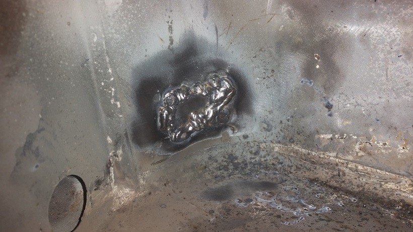

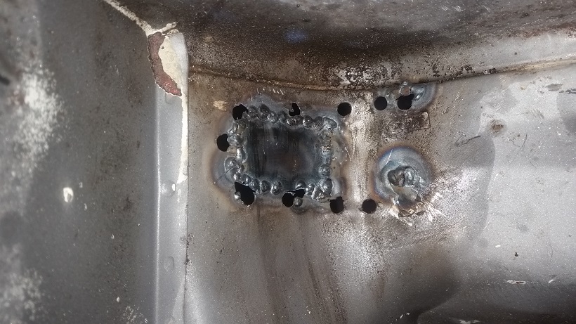

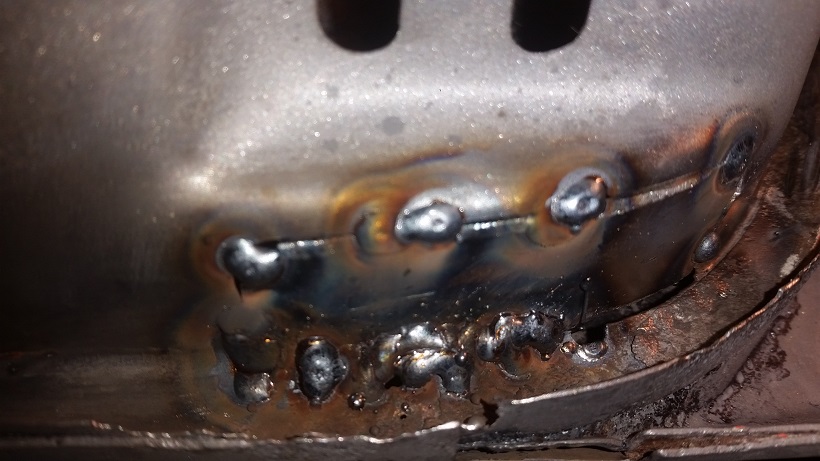

Welding didn't go too well. Didn't cut out a big enough hole. Edges of the hole were too thin and too much unseen rust under the edge. (IMG:style_emoticons/default/barf.gif)
But it cleaned up ok.

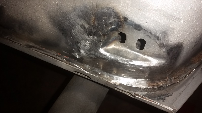

If I was to do it a third time I'd do it in two pieces. The area called out with the star gave me all kinds of trouble.
Doing it in two pieces allows for a complete refresh without removing the suspension mount. (IMG:style_emoticons/default/biggrin.gif)

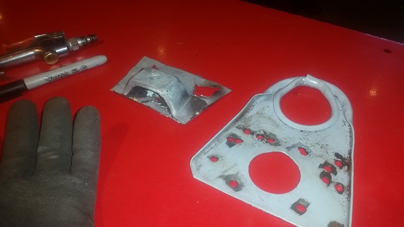

On to the tow hook.
I was bound and determined not to drill thru with the spot weld cutter this time. Didn't make any difference I ended up cutting it all out anyway.
Didn't shoot a picture at the end of the day after I cut it out. I could have cut it a little close to the cancer hole. Patch will be easy.
We'll do a little work on the tow hook and transfer the tire tie down to the patch panel.

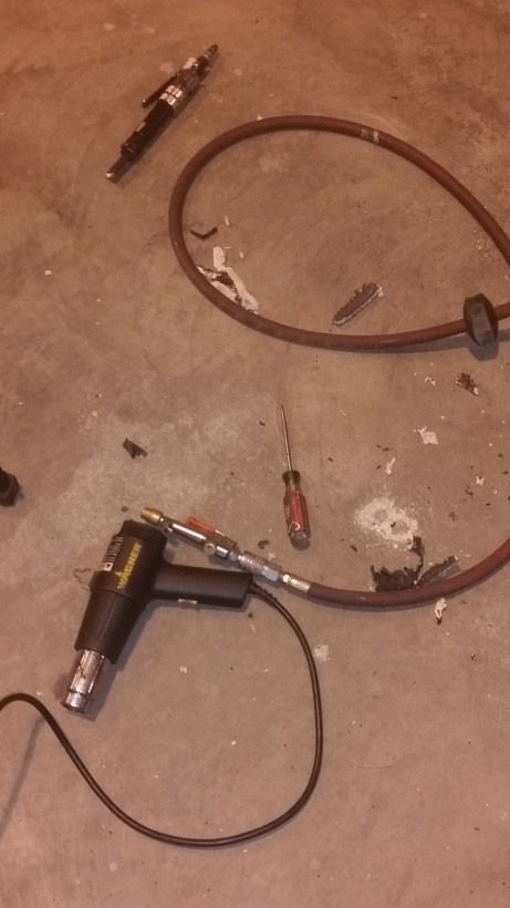

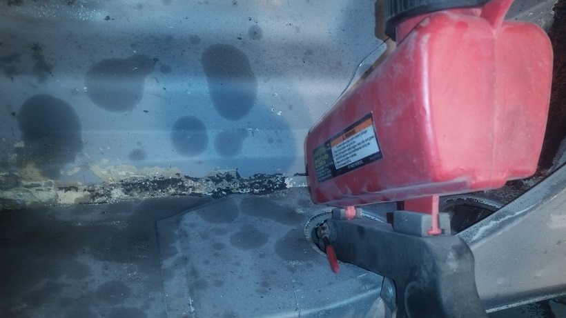

My middle son texted me yesterday and asked what I was doing today.
Answer : Pulling seam sealer from the front trunk. Boring
Pretty easy with the heat gun and the air scraper. Then come behind with a medium straight bladed screwdriver and the heat gun to clean out the seams.
* Super In Law found a dropped exhaust valve seat on lawnmower #2. Opened up the cylinder head, froze the seat for a couple hours and peened it back in. Kind of hillbilly.

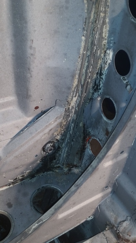

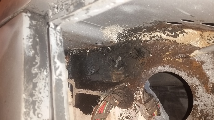

But as I began to work on the seam sealer in the gas tank area I find my next major rust challenge. Looks like one of the POs did a fine temporary leak repair above the front trunk cable pull. In the close quarters blasting I thought it was just some of the POR15 work we did when we got the car.
Looks like a steel plate and some seam sealer/tar. Don't thinks its tar. It's set up pretty hard.
Here's what It should look like. From 74 2L over in next building.
Here's what the parts car looks like. About the same as the project.
