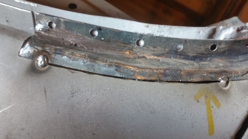

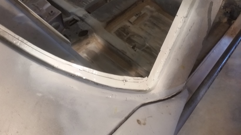

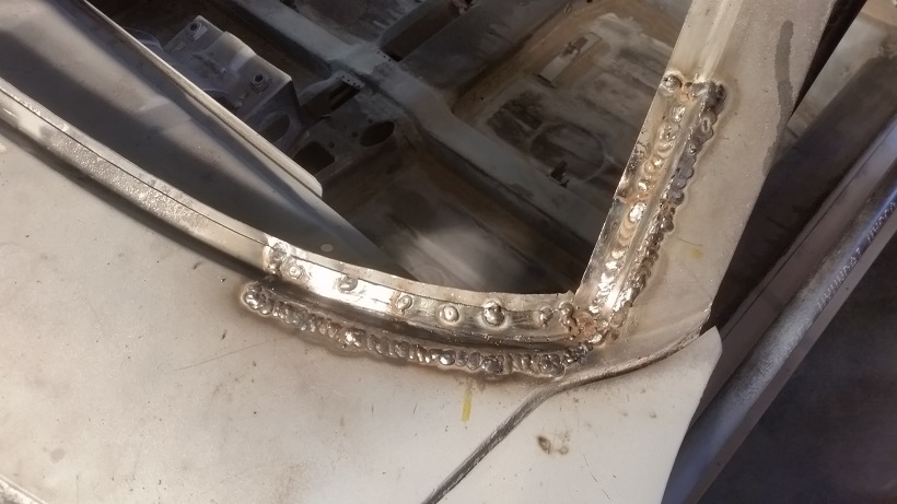

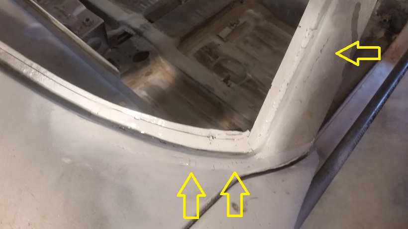

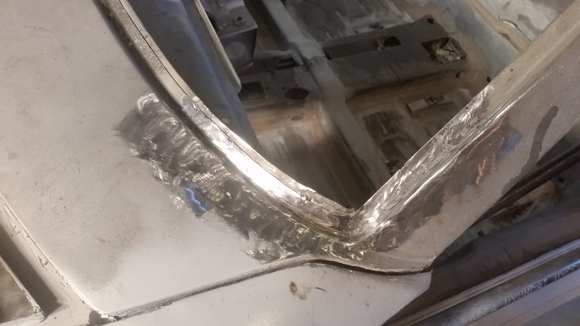

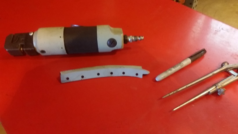

On to installing the left side window frame patch. I started with giving the patch and frame a shot of weld thru primer. Then punched the rosette holes on the frame side.
Gave it one tack so I could start the final fittings.
After cutting the patch to cowl seam again with Dremel. I tacked it in another couple spots.
Here it is all welded in.
After grinding.
After a shot of self etching primer.
It's going to take a little All Metal filler in a couple low spots (arrows). I refrained from over grinding, over working the metal and using the MIG as a glue gun to fill in the low spots.

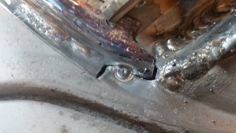

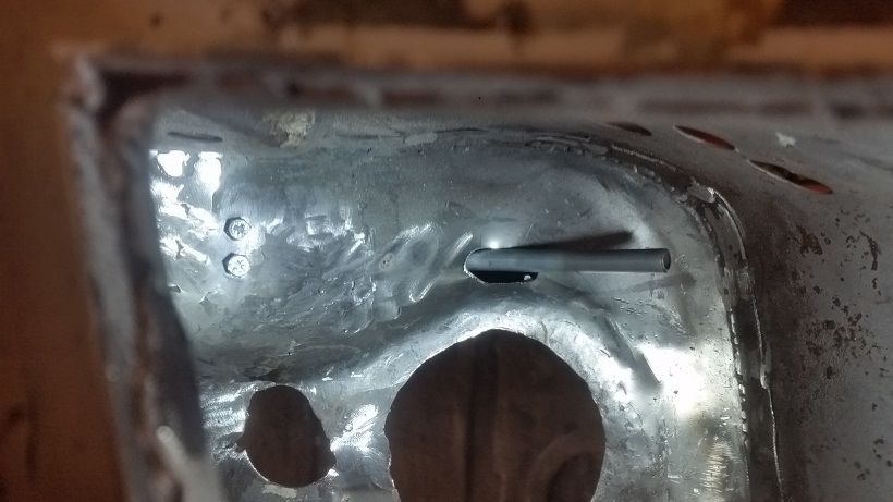

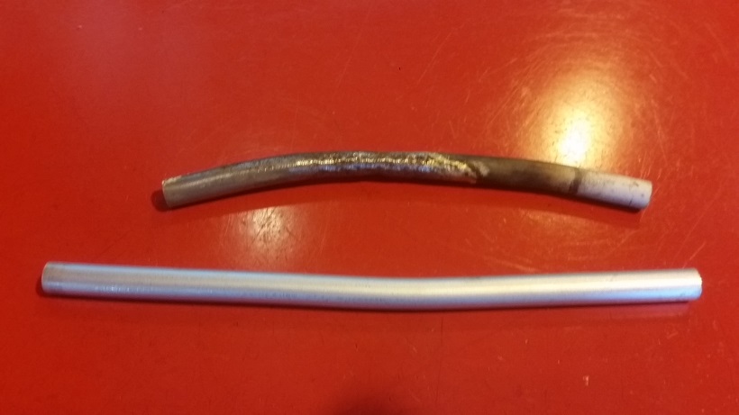

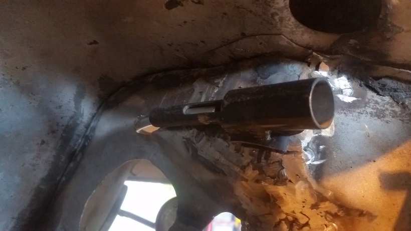

Had the torch out so I needed to reinstall the guide tube for the front trunk cable.
The tube is steel, not brass or copper. So I had to stop at NAPA and pick up six inches of 5/16 brake line.
I'll add a shot of final brazing.

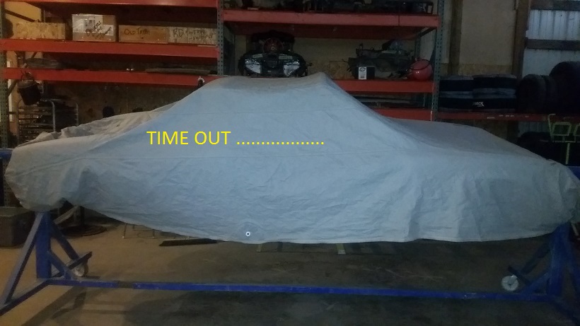

We'll take a time out for a while to do some work on Mark Whitesell's (914Rubber) project car.

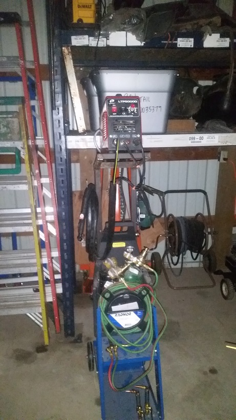

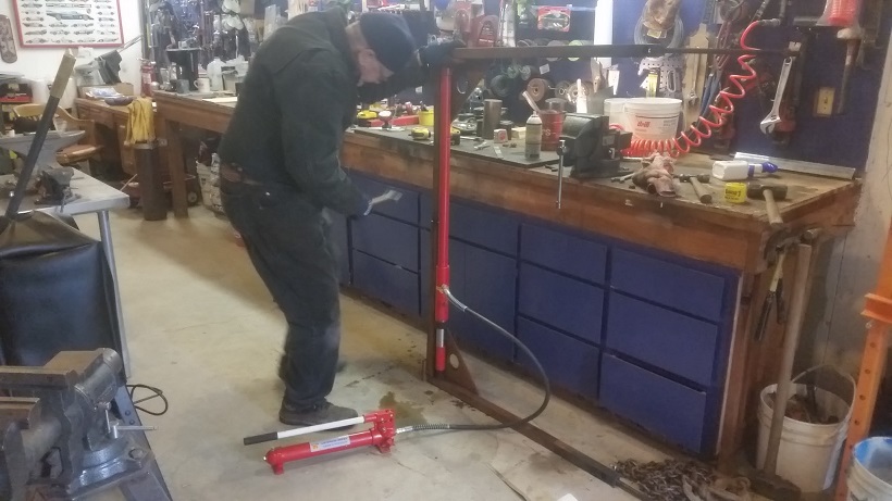

While I'm working on Mark's car Super In Law has been busy.
Starting the restoration of the pinch weld frame for the frame bench.
Today he built an extension for the welding cart that has the plasma cutter on it.
That way its tall enough to be used on the parts car that's on stilts.
Which gave us room to put the torch on the same cart.

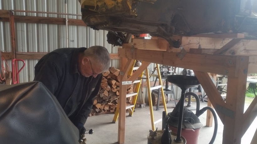

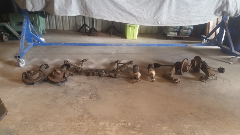

While I'm working on Mark's car, Super In Law stripped the front and rear suspension off the parts car. Now we'll decide what we'll cut it and keep and what will get shredded and melted.

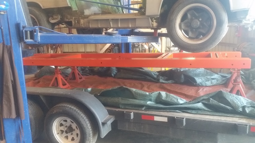

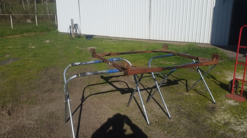

Weather broke so we took a break from Mark's car and got after prepping and painting my frame bench.

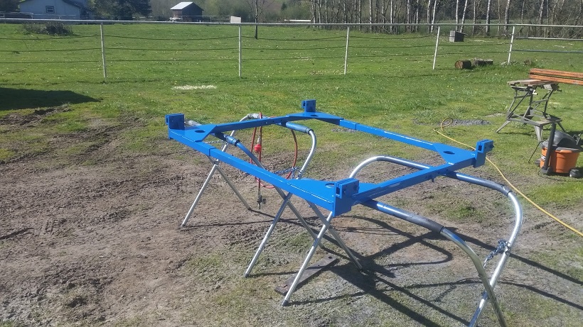

Super In Law has been refurbishing the pinch weld frame and its now ready for some paint. We start with another once over with the wire cup brush.
Tape off all the decals ........
Finished product ...............

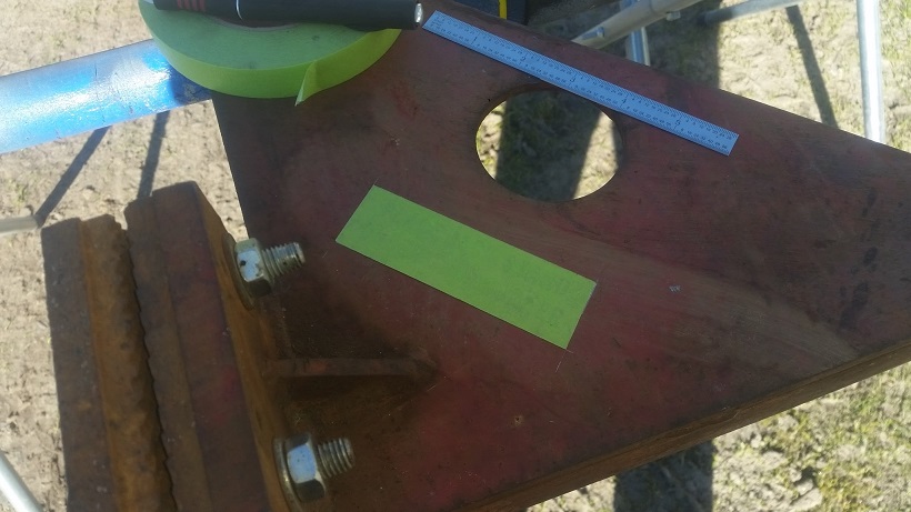

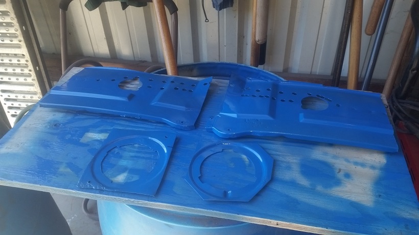

While I had the Ford blue in the gun I painted the templates that will be saved. I paint them to save myself from myself. I'd forget why I cut them out and they'd end up in the scrap barrel.

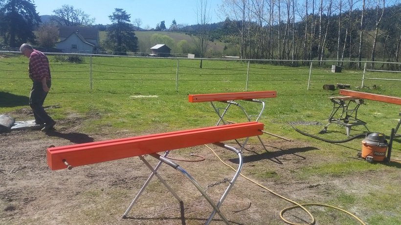

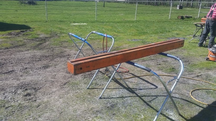

Then on to the bench itself .......... We start with wire brushing the cross members.
Then I shoot some of the bright Kubota orange. (IMG:style_emoticons/default/biggrin.gif) (IMG:style_emoticons/default/biggrin.gif)
Then we convert the open trailer into a paint station. Super In Law got busy with the wire cup brush. Then I jumped in with the DA with 40 grit. The DA made short work of it.
Turned out great. Gave me some good painting practice. Distance from the surface and speed of my fan movement.

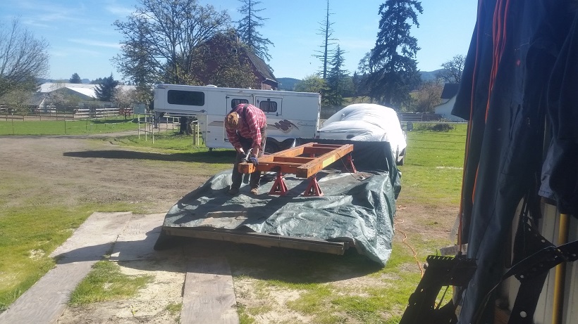

Member No.: 1,608

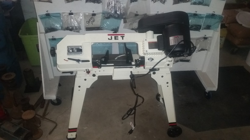

Took the day off, but we went and got a refill for our #2 Argon/Co tank. While at Newberg Steel Super In Law bought me an early and expensive birthday present.
Jet Horizontal/Vertical Bandsaw. (IMG:style_emoticons/default/piratenanner.gif) (IMG:style_emoticons/default/piratenanner.gif)
This should make the precision cuts we'll need when we create the fixtures for the frame bench.
My 18" welding clamps that I bought for future trunk installs arrived from ZORO.
Then we rolled the frame bench off the trailer.

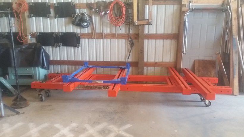

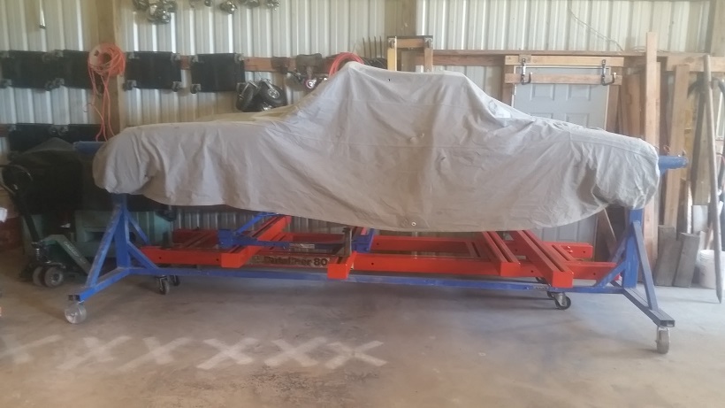

Here's a few shots after I got everything tidied up. The rotisserie will slide 1/2 way over the frame bench when it's up against the wall when not in use.

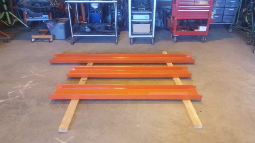

We decided that we'd paint up three of the channel irons that came with the bench. We'll use two of them to hold up the pinch weld frame.
