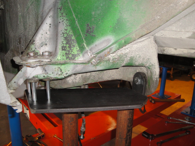

Next week will be spent building 3 or 4 fixture pieces for the frame bench.
I moved Mark's car to the frame bench this afternoon. My pinch weld fixture won't work for most of the work I'll be doing. i.e. Right long and hell hole.The fixture is in the way. So we'll be building the transmission mount and right suspension mount fixtures. Perhaps the pinch weld stands also.

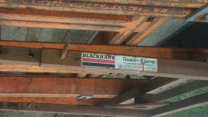

Would you happen to have any info on your pinch fixture ( manufacture, model # )?
I need to purchase or make one for my car.

Here you go ..............
Blackhawk Quadri-Clamp 97150

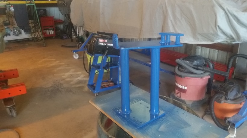

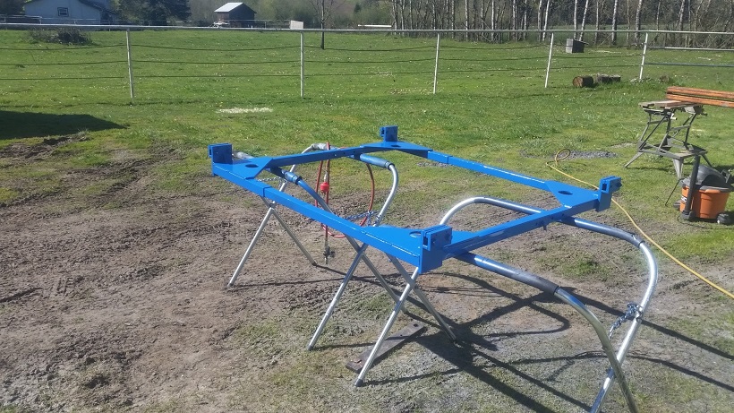

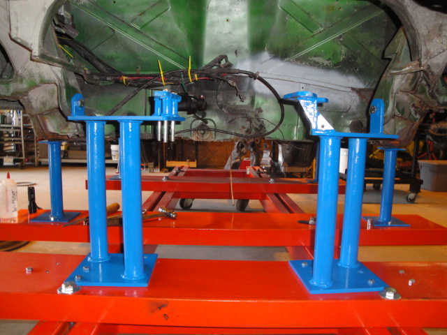

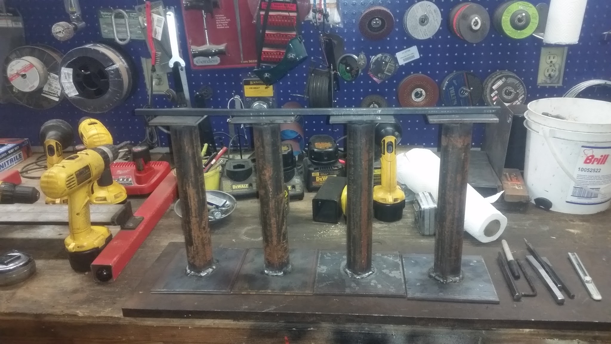

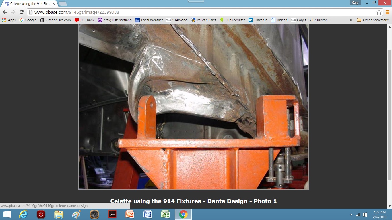

Here's the first fixture piece we're building. The long jack stands.
Our first version will be solid. We'll always set the car on the stands with the lift.
Version #2 will be more like the Celette. Tube in a tube.
I'm leaving them a bit tall so they can be cut down when the time comes to create the tube in tube.
Not really a pinch weld clamp. You pinch the entire car between 3/8" rails on top of the stands. We'll add gussets as we progress. Car is pretty light with no engine and transmission.

My brain hurts. I haven't done that much measuring and geometry in a long time.
With the girders not being perfectly formed. It took a few hours to get things squared up. Now on to the suspension and tranny mount supports.

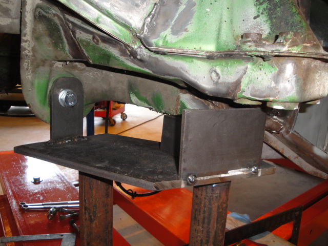

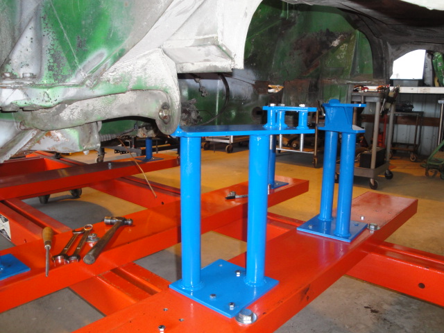

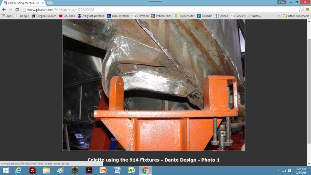

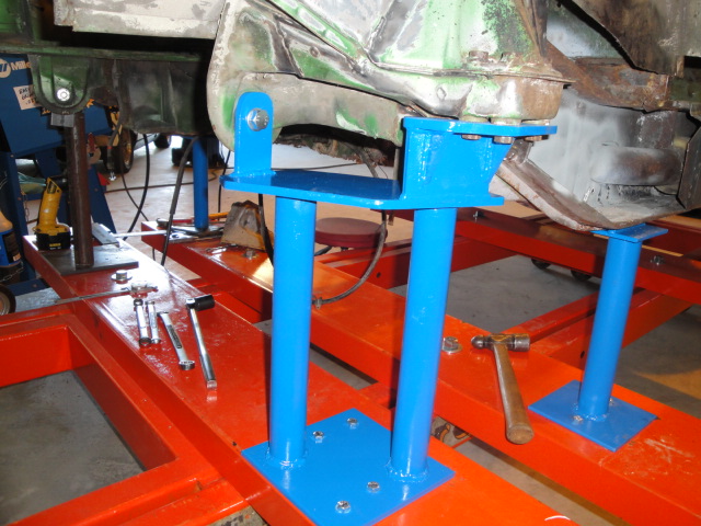

Here's the design I came up with after I cut the tubes an inch too short. (IMG:style_emoticons/default/sad.gif)
I couldn't get a 10mm bolt long enough to replicate the Celette. Going from the bottom thru the spacer and the two plates.
Here's the finished product all painted up.
Super In Law started the left side. We figured we might as well get it done while it was fresh in our mind. It will be created in the Version 2 style.
As soon as he gets finished I'll flip around the right side fixture and get back to work.

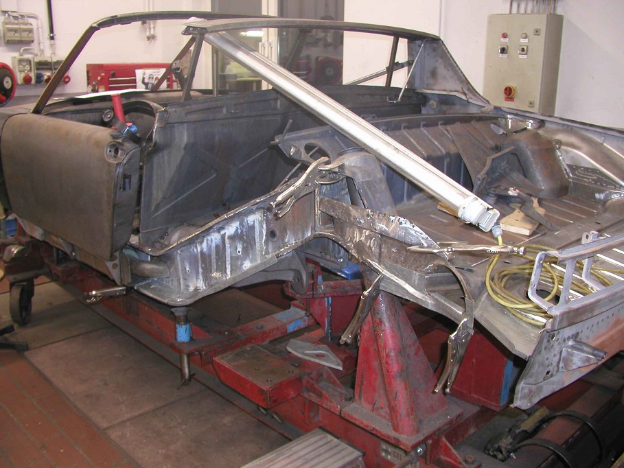

Like this picture of the Celette.
cary

Super In Law jumped on the left side.
Locating .............
He comes up with some of the damnedest contraptions.
So he could weld the pipes to the base plate.
Finished the paint job just as we were leaving ...........

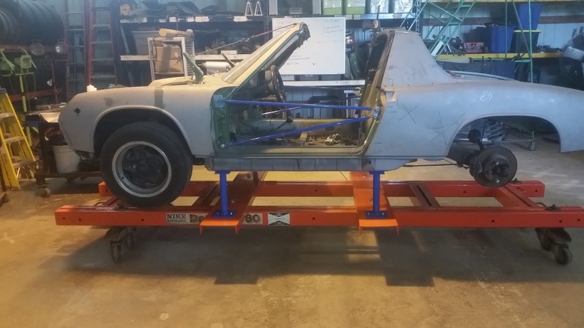

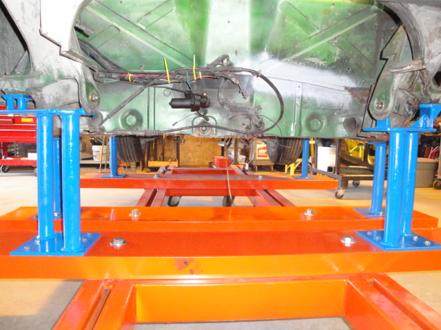

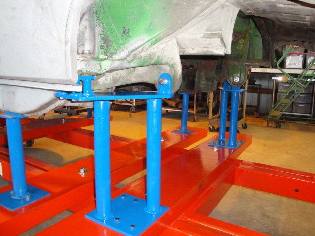

Here they are in the locked down position ..............
Now moved into the wheelhouse/long repair position ,,,,,,,,,,,,,,

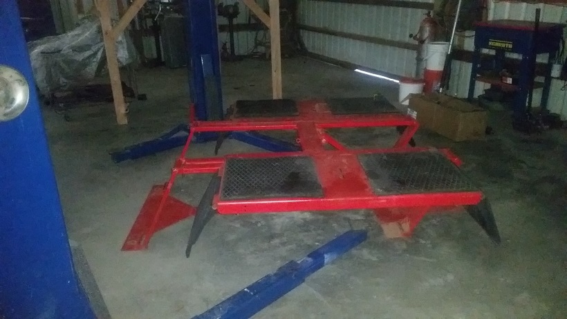

Taking delivery of a Challenger Low Rise lift tonight. Cheap.
Needs a hose and a new oil tank. Kind of rolling the dice. But we've had pretty good luck fixing stuff.

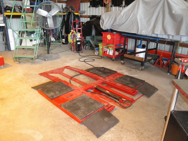

Low rise lift was delivered ............
Basically the same as putting the car up on jackstands. But a lot faster.

Super In Law got the low rise lift up and running .............
$560 after parts and fluid.
