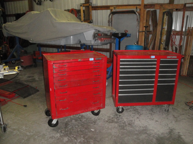

Picked up couple more tool boxes at a pawn shop this am.
Right one will become the primary shop tool box. Totally organized like my box at Rothsport.
Left one is an old Matco that will become a small parts storage box. Engine parts: seals, gaskets, etc. Tubes of adhesives, etc. $200 for both.

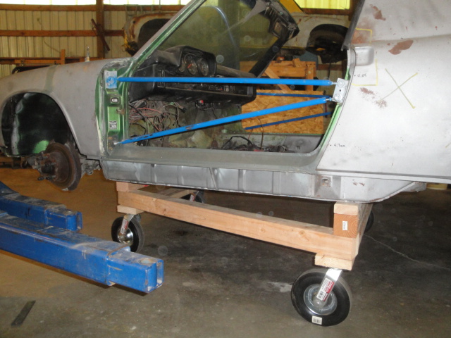

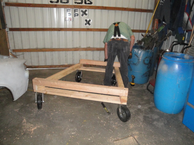

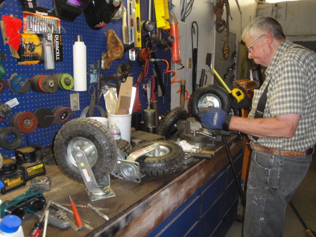

Super In Law is building a new wooden body dolly like Doug built for his car. Starting with re-purposing the inflatable rubber tires that we bought for the rotisserie that didn't work. Bought 4 new solid rubber tires and he is switching them out. Swivels on all 4 corners for ease of movement around the shop.

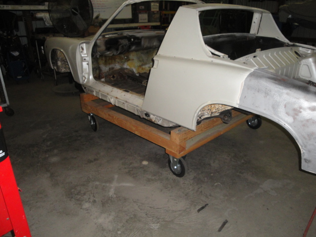

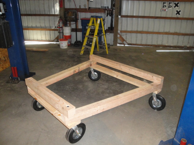

Super In Law finished the redesigned car dolly. I reshaped it into a trapezoid for ease of loading and unloading off the 2 post lift.
We did add a 2*4 to the top so we would have more clearance for the 2 post lift arms.
On a side note. The 10" wheel frames from HF, suck. To much lateral give in the frames themselves. The 8" ones on Doug's dolly are much easier to drive.

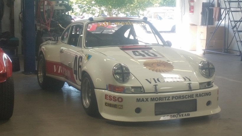

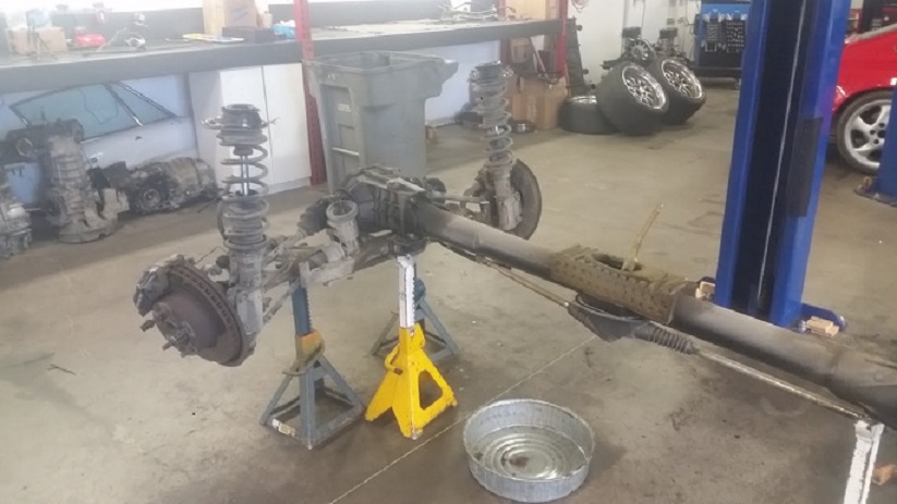

Here's a show and tell from my lift at Rothsport. I'm turning a 1989 C4 into a C2 that will get some back dated bodywork to create an SCRS.
Dropped the entire front drive unit onto jack stands to remove all the 4WD parts.
Here's an action shot of the SCRS on tarmac.
Off to work ................ (IMG:style_emoticons/default/piratenanner.gif) (IMG:style_emoticons/default/piratenanner.gif) (IMG:style_emoticons/default/piratenanner.gif)

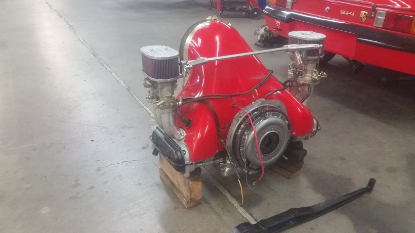

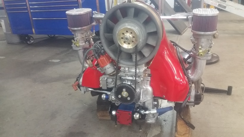

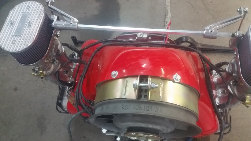

On a side note. I'll will shoot a couple shots of one of our members getting a new FAT motor installed in his 914 race car here at Rothsport. The engine is a piece of artwork. It's a 22xx. Big 911 fan. Dry sump. It's Bitchn. Then it gets all the Gamroth little tweaks.
Pictures added 8/24/16
Oh yeah, the 2056 D-Jet that came out might be for sale. I'll keep you posted.

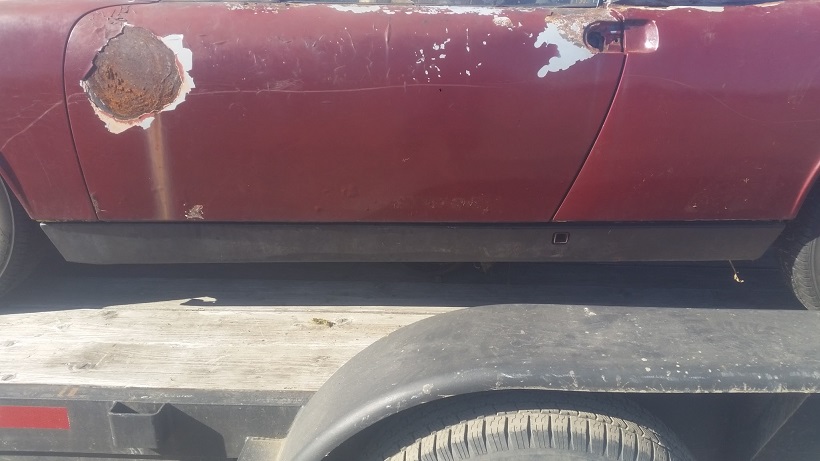

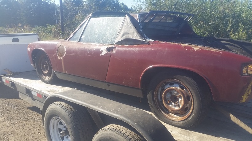

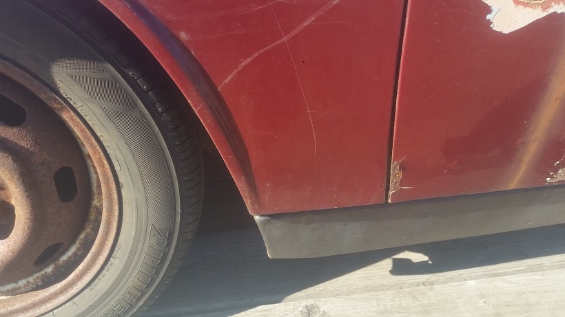

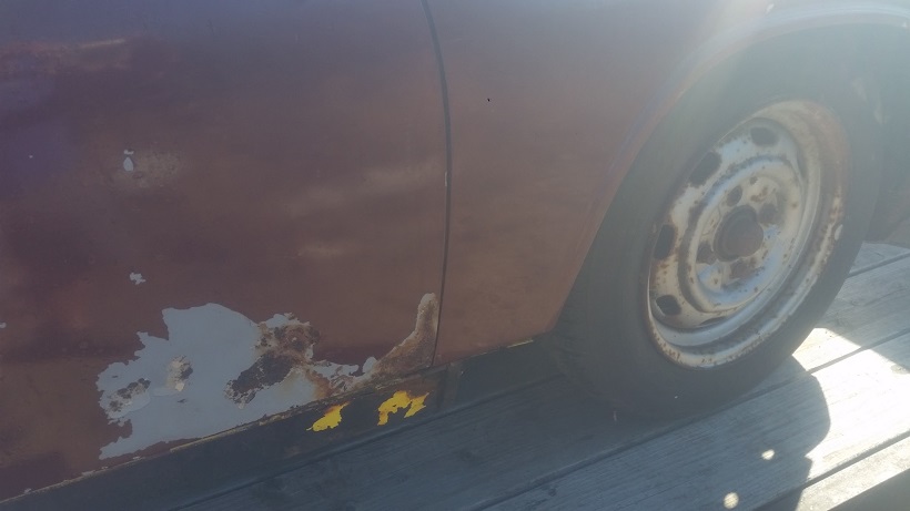

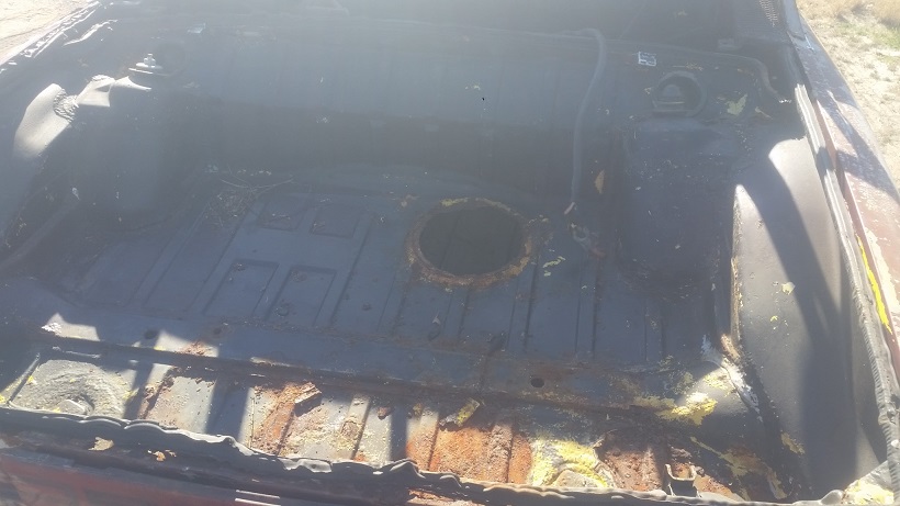

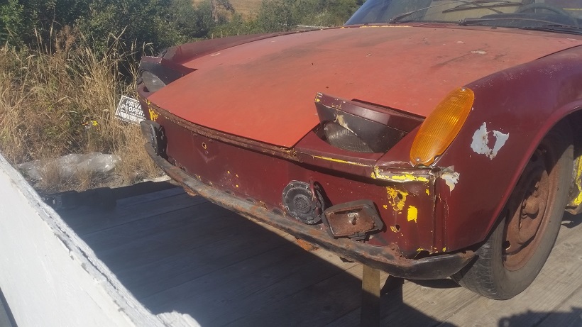

Now for the POS 72.
I should have been paid to take it away. Or at least got a couple packages of Sawsall blades.
I guess this was a flood damaged car from Centralia, Wa.
Here's what I see at first glance.
Both bottom rears of the front fenders.
Maybe a steel left rocker panel.
The center section of the front trunk panel. I'll cut it out whole.
Maybe the center tunnel and pedal cluster mount.
Drivers long will come out whole. From rear trunk to the door post.
Right door post.
Then the little bits and chrome will be inspected for value.
I think I can get my tank of fuel back. LOL
