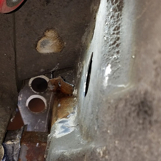

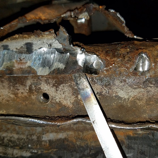

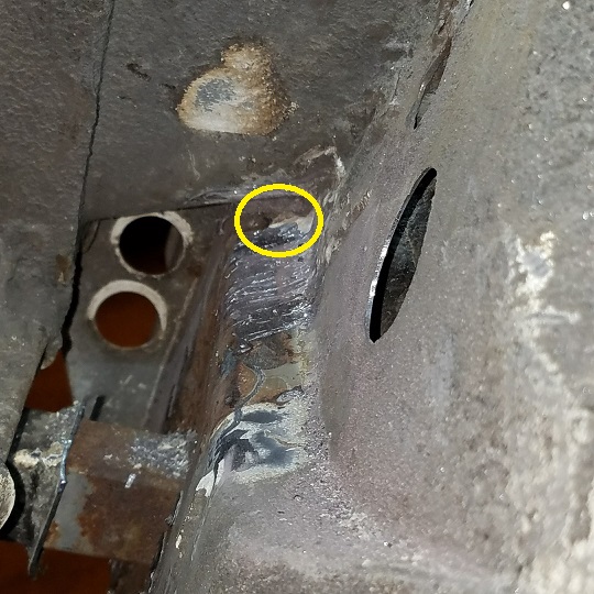

Doug's car is on the rotisserie so it's time to get after the jack points.

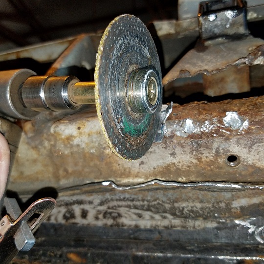

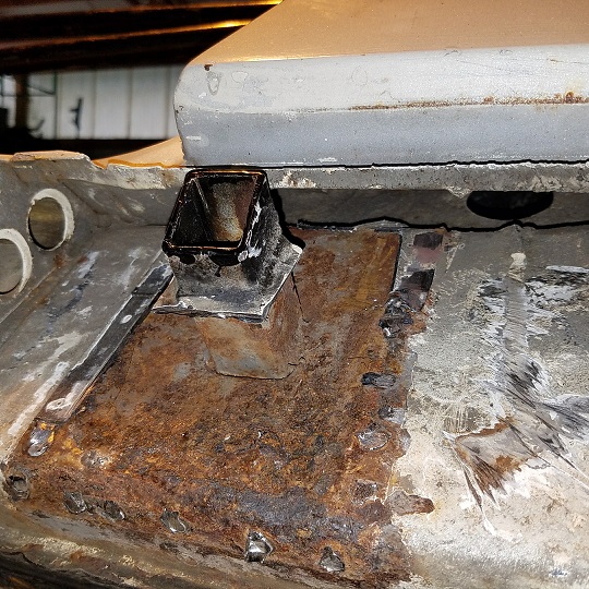

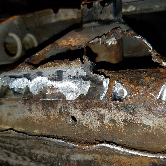

I decided not to clutter Doug's thread with this jack point removal conversation. I started with the portion that is exposed on the rocker panel. ![]() I'm using what I call the Rick (rick 918-s) method when I can can discard the outer layer/panel. I've covered this before. But here's a little more detail. The thing I'd like to add. When you get comfortable with the cutting disk on the mandrel. ![]() I cut down each spot weld with the cutting wheel like I've discussed before. But what I've learned over these many projects is too take it out in small portions. But you have to be real careful when making cross cuts in the outer layer. Sometimes I make a bowed portion to make the cross cut. You don't want to cut/damage the primary material. ![]() Don't put too much leverage on the screw driver. You can rip the spot weld out which would leave you an unnecessary hole. ![]() ![]() Had to bring out the big guns for the cut across the top of the jack tube. It allows you to use a sawzall blade. ![]() |

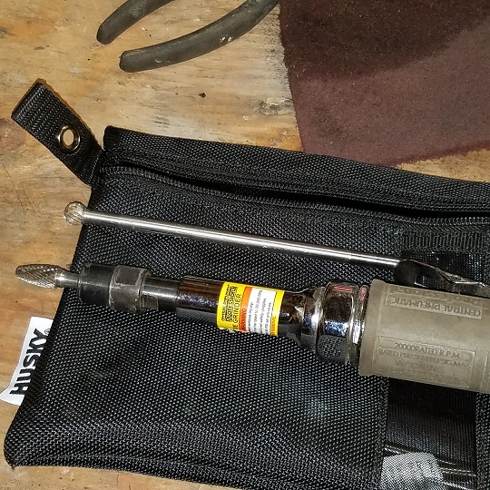

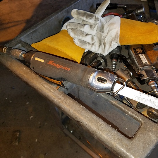

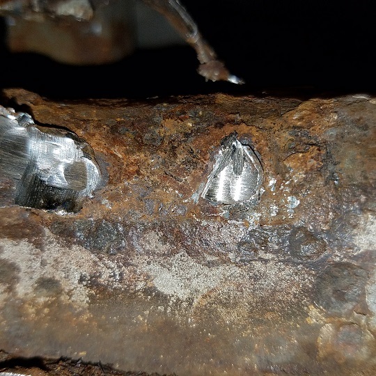

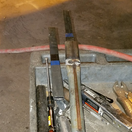

I went with Worn's suggestion of using an extended length carbide cutter.

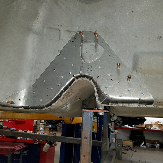

![]() Air tool is a little wild. I might take a look at Worn's suggestion of the HF electric one. But think I'll try the regulator that I use for paint guns for a start. When I ran out of length I added a tube to the extra Steck spot weld cutter Doug bought for me. ![]() First couple popped off pretty easy. The inside couple took quite a while. ![]() ![]() I'll probably still buy the 24" belt sander. The 24" will be 1/2 inch wide which should just about cover the entire shelf. Nice finish There's just a little tidbit right under the door jamb I couldn't get at with the 13". ![]() This one took about 3 1/2 hours. Next one should be faster if the rust is about the same. |

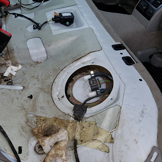

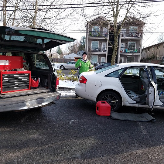

Sunday Morning Episode of Dad's Garage .................
![]() Changed out the fuel pump on the Audi in the St. Johns Safeway parking lot. It's under the passenger back seat. Fairly simple procedure. I came out a couple weeks ago and did the diagnosis. Power to the pump with ignition on. Pump no go. ![]() ![]() After the system pressurized she fired right up ................... |

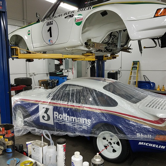

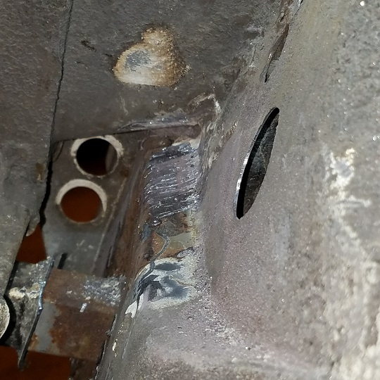

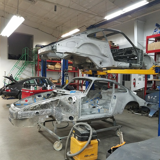

Things are kind of quite so I'd thought post a couple shots of my work on the rally cars at Rothsport.

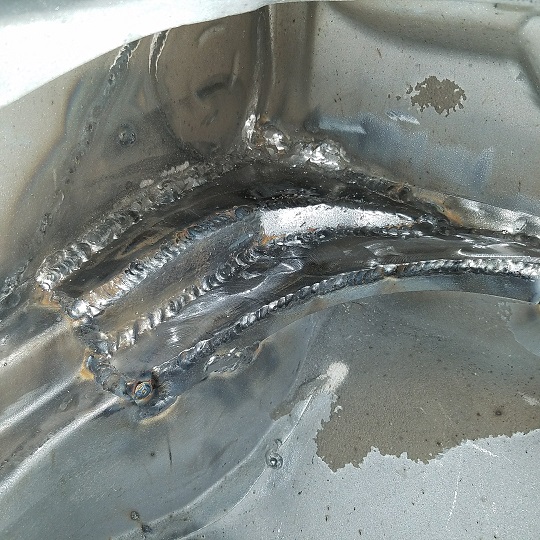

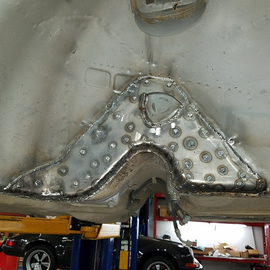

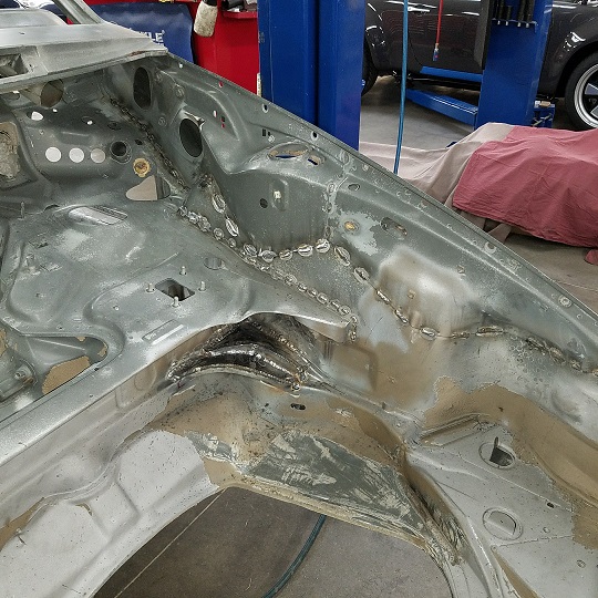

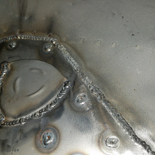

Top car is an 81 SC, the rental car. Bottom is Jeff's personal 964. Jeff's car is going back to the blaster for some rework. (IMG:style_emoticons/default/sad.gif) They're really struggling with the seam sealer and undercoating. I'm kind of picky. ![]() I've started seam welding the SC. ![]() Tuthill steering rack stiffeners. 10 gauge. Pallet of FIA roll cages arrived Monday. (IMG:style_emoticons/default/piratenanner.gif) ![]() Prodrive SCRS #7 is in the house. Because of my messy work it went under cover. It came in for some longer gearing. It was completely restored by Rothsport a couple years ago. ![]() |

I thought I'd add some insight into the issues we're having with removing the undercoating and seam sealer on the 964's. It's kind of uncharted territory. Not too many 964's have been totally stripped down to a body in white. The G body was easily stripped with media and walnuts. Old School. But that stuff didn't make a dent in the 1/4" of undercoating on the 964's. We're thinking the folks that Singer uses bake the tub in the powder coating oven, then blast it. But they do not remove the seam sealer. I need the seam sealer removed so I can seam weld the spot welded seams. I even torch the seams with a MAPP torch before I start welding and I still pull impurities into the welds. (IMG:style_emoticons/default/barf.gif) (IMG:style_emoticons/default/barf.gif) (IMG:style_emoticons/default/welder.gif) They quoted $3500. So it takes lots of grinding with wire wheels and cup brushes to get the undercoating down and out of the seams. Doesn't set to well with the chassis room boys. (IMG:style_emoticons/default/smash.gif) (IMG:style_emoticons/default/sawzall-smiley.gif) (IMG:style_emoticons/default/smash.gif) (IMG:style_emoticons/default/sawzall-smiley.gif) So were going to try an induction heating pad. Heat , scrape , heat & scrape. http://www.autobodytoolmart.com/inductor-p...u3-p-13991.aspx https://www.youtube.com/watch?v=gXIk_1tmt8c I'll let you can how it goes. |

Rothsport had sent one out to the ice blaster in the past and it didn't do any better. So that wasn't tried again.

Bill we saw that too. But we couldn't find anyone doing it on the west coast.
We demoed the Pro Max on Monday, it worked as described. It cooks a 4" * 6" area which then peels right off. Then move it along keeping the edge hot. Jeff ordered one yesterday .................. |

Based on info we got, in portland it's around $3500.
Which wasn't an issue. 3 month waiting list was. But we heard it still didnt get it all off a 964. |
