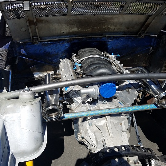

Last day of vacation before driving home. Julie and I drove up to Petaluma to see tygaboy and his project/shop. My wife Julie and his wife Lori (sp ?) hit it off and disappeared into the house.
I'm not an LS guy, but the conversion is stunning. Workman/craftsmanship is at the next level. If you've followed his thread, it's a creative work in progress. Heavy on the creative .............

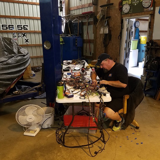

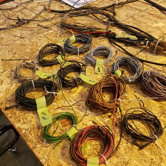

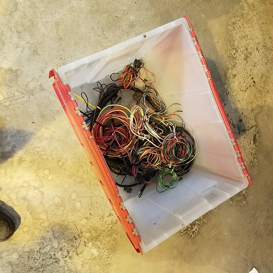

Doing a little work on Matt's melted harness. I harvested the wires out of my spare harness bits. Extracted some complete units, column switches, ignition, etc.
We'll have them extracted color by color for future repairs.
Like Matt's harness, the solid gray wire had a melt down. Best I can tell it's the luggage lamp feed that ties to the license plate bulbs. It's fused to #7. Hmm.

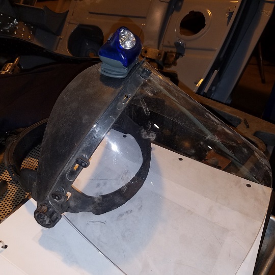

Another episode of Tool Whore. Added a HF headlamp to my face shield. Works pretty good.

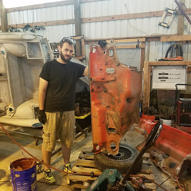

BIG DAY ON TAYLOR'S PROJECT
He finished the harvesting of the front fire wall. With the amount of welding that will need to be done I'll probably refurbish quite a bit of the flange. That will keep the edge from blowing out.

Matt continues with his harness rebuilding/repairing.

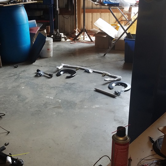

Tuesday 8/8/17.

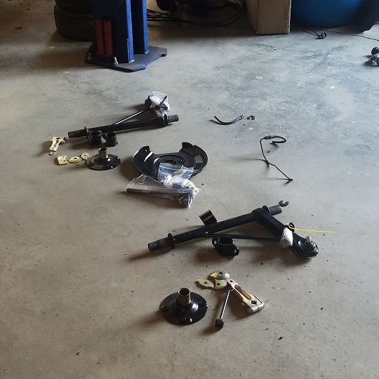

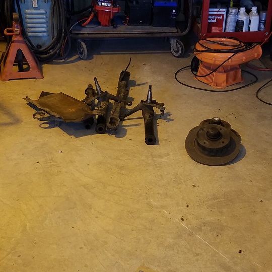

Spent half the day welding on Doug's car. Then started to assemble (dis-assemble) the suspension and brakes on Matt's car.
New 914 Rubber sway bar bushings
Dis-assemble : we removed the URO front control arm bushing from the refurbished control arms. No torch. (IMG:style_emoticons/default/smile.gif) Shop press and bearing separators. And some McGyvering on/in the press to make space for parts travel. Press will need to be upgraded to a 20 ton to make the project faster.
Trailing arms will get the new 914 Rubber control arm bushings.

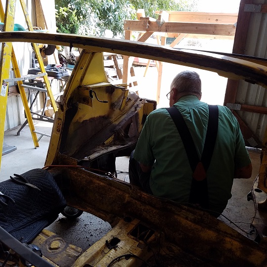

Since harvesting Chris's firewall patch Super In Law has continued to saw up the yellow parts car. Because it was a V8 attempt car not a lot of parts. saving odd things.
center section of rear taillight panel
remainder of firewall for 6 cylinder cover
front portion of engine tray
cable/tube section of rear lower firewall
entire right long, stem to stern
mount section of upper right long
late engine fan mount
both hinge posts, including long portion

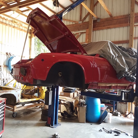

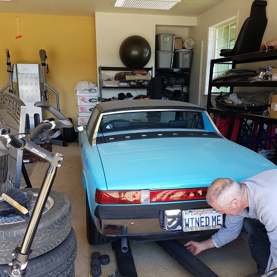

Did another visual on Taylor's project before heading to the Eagle Cap Wilderness for a 6 day backpacking trip.
Matt and I discovered that Taylor's clutch tube is totally disconnected in all three locations. That's first. Nice that's it's on a rotisserie for the floor pan entry.
Plus one of the right seat hinges needs to be relocated. Seat frame wouldn't go into place. If would waller out the holes it would be crooked.

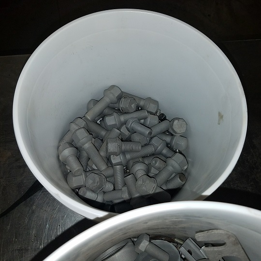

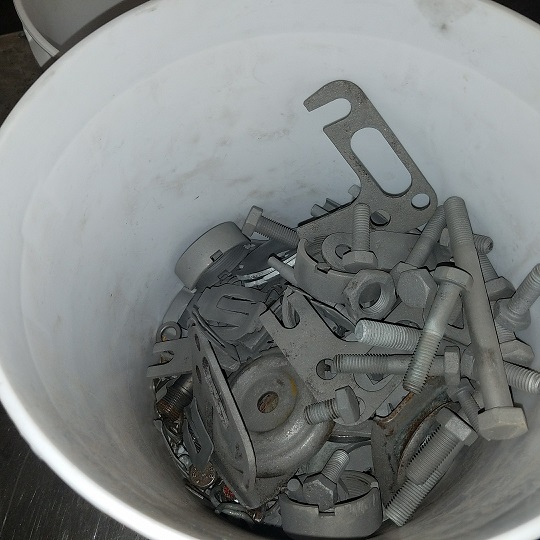

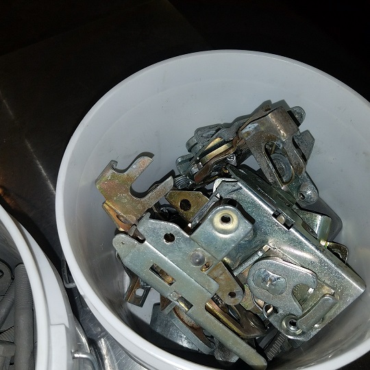

After harvesting all the hardware off the parts cars I figured it was time for a plating run.
Working with Matt and Doug has spoiled me.
Super In Law is wearing out the nozzles on the bead blaster. LOL.
We'll remove all the spring we can get at off the latches.
Next issue is where will I put all the shiny stuff when it gets back. (IMG:style_emoticons/default/dry.gif)

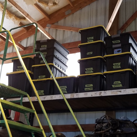

While I'm welding on Doug's car Super In Law is also breaking all the harvested parts and getting them ready to be put up into storage.
Kind of odd. Most of these parts cars have new disks on them. So they get put into storage to be blasted and turned down in the future.
As we were leaving last night I found 4 more totes of parts off the POS parts car that will need to sorted and prepared for storage, or tossed out. He'll be busy today. LOL.
Plus we'll be cutting down some pallets to 3 ft deep to put the totes on. Too big of a PIA up on the rolling stairs.
