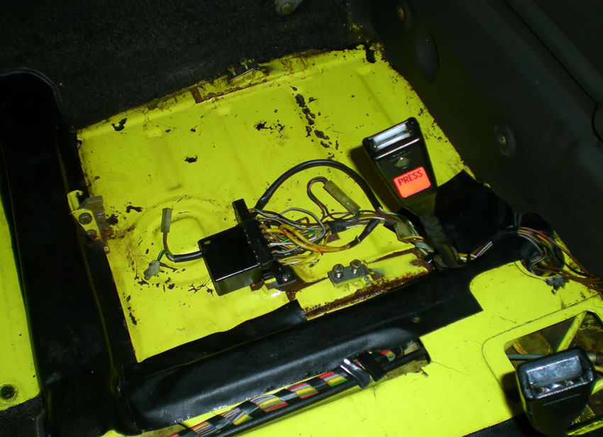

I know this relay was involved in the seat switches, which mine is by passed, but does it run anything else on the car?
Was there a smaller relay next to it?
Mine does not seem to have the smaller one.
Thanks

large is the interlock the small is the buzzer.

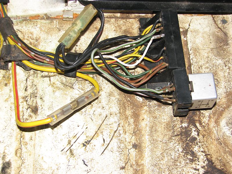

your yellow and yellow with red leads have not been connected together (factory bypass) so you will have to keep your relay plugged in.

Without the seatbelts fastened the car would not start. This worked in conjunction with the buzzer and the fasten seat belt light.

Unplug and remove it. Connect the two large yellow wires together. One solid yellow and the other yellow with red stripe. Take a test light and check the smaller wires for 12v with the key on. I have one black wire that hot with the key on. Seal the one (s) that are hot against grounding.

Make a small male male 8 gauge wire about 2 inches long.
Unplug and remove the logic circuit box (its not a relay) and plug the male ends of your new jumper wire into the yellow/yellow red wires.

You need the double male connector.

What about all the other (under the seat) wires? I would like to delete as much as I can. Thanks, mark

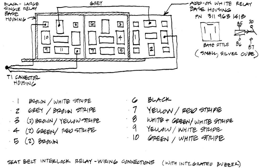

I had my father (retired EE) reverse engineer this thing a few years back...maybe more than a few.
I posted the diagram here (club/world prior to break)
I no longer have the diagram...it may be here.
Its all useless stuff...
Its all related to the seats pressure sensors, the seatbelt latch sensors, and the door opening light switch/sensor, and all of that starts a buzzer (which needs power) and lights up a light on the dash( which also gets power)
the rest of the wires are grounds.
Rich

The only power-in on the relay is on the following terminals:
15 (black wire) constant power.
L (yellow/red wire) switched power--after it goes through the warning light.
C (yellow wire) power when the key is in "start" only.
H (grey/yellow wire) switched power, which runs the "door ajar" buzzer
