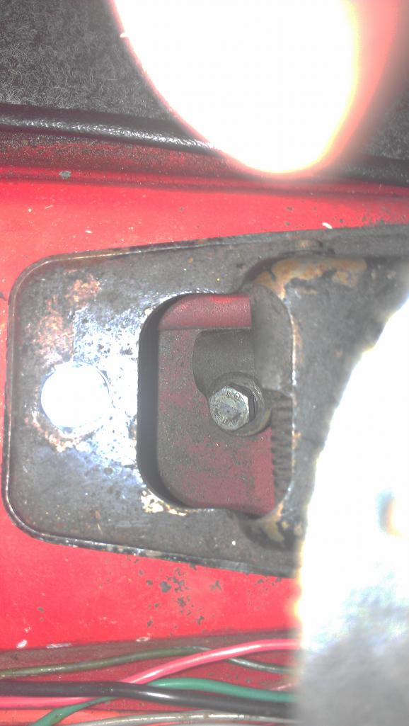

3. Put the shifter in neutral, and loosen the pinch bolt on the shift rod. This is accessible behind the shifter.
4. Completely disconnect the shift rod by pulling the shifter back into the third gear position. You should see the coupler laying against the floorboard (like in the picture below).

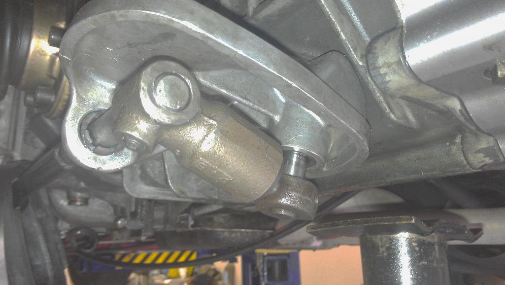

5. From under the car, put the side shift console on the transmission into 4th gear. This is done by pulling down on the shift rod and pulling it rearward.

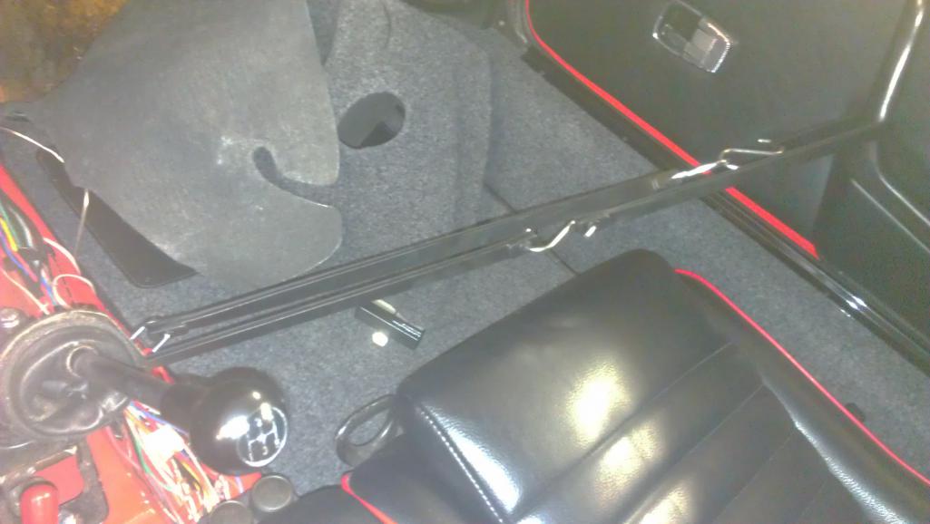

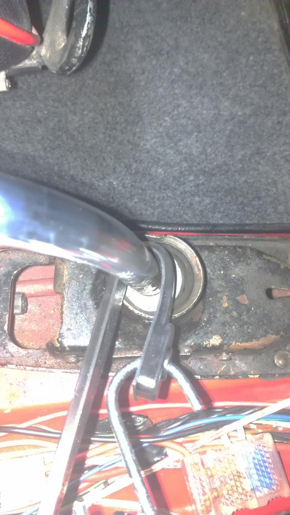

6. Back inside the car, put a rubber bungee cord around the base of the shifter, and loop the other end over the right hand door handle.
7. Make sure that the bungee stays at the base of the shifter.
8. Lift the shift rod inside the tunnel up, and slide it into the coupler on the bottom of the shifter. This is the hardest part of the job. The hole is small and both parts sag downward. You may have to use needle nose pliers or something like them to hold them up.

10. From under the car, move the shift console into the neutral position.

There are 3 fore and aft "shift planes" in a 914 transmission. Reverse/First, Second/Third, and Fourth/Fifth. When you place the transmission into Fourth, you are providing enough clearance to hook up the shift coupler, and you are insuring that the transmission end of the shift linkage is in the fourth/fifth shift plane. The bungee cord around the shift lever pulls the shifter into the fourth/fifth shift plane and holds it there while you slide the rod into the coupler. Then putting the trans back into neutral allows you to set the proper location of the neutral gate for each shift plane by making sure that the lower portion of the shifter is vertical.

Having done this an untold number of times over the years, your method seems sound. I'd probably fix that loose shift bushing in the console first, though. "Loose", you ask? There are clear signs it's moving around, and that's not good for the shifting precision we're all looking for.
