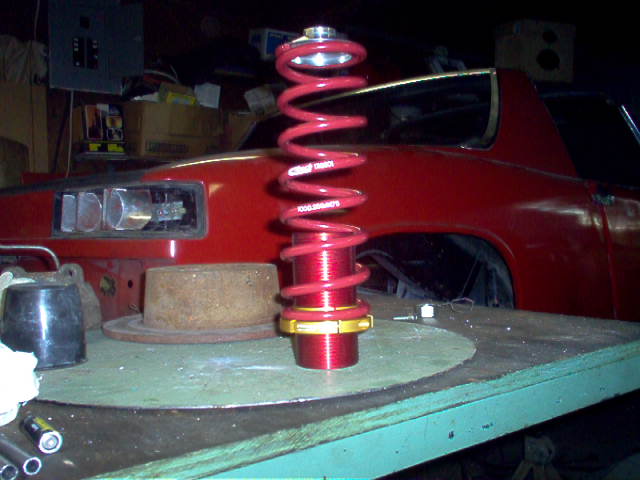

Mike,here's what I got from Ground Control for $199

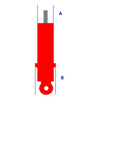

Hey Dave,
Can you verify the dimension A on your shock??
If I read your PM correct, the OD should be 2.17" along the entire length until you hit "B"???

Member No.: 914
yes, A = 2.17 "
i measured down by the shelf.
on one end of the collar, there is a lip about 3/4" inside. the collar fit on the shock, but catches that lip. dig it?

do the adjuster nuts have any kind of locking mechanism? 'cause otherwise i'd think you'd find them slowly unscrewing unless you used an additional nut as a jam nut...

QUOTE (ArtechnikA @ Jul 7 2005, 10:39 PM)
do the adjuster nuts have any kind of locking mechanism? 'cause otherwise i'd think you'd find them slowly unscrewing unless you used an additional nust as a jam nut...
on the Ground Control units, the adjuster nut is actually a clamp that is tightened by an allen bolt

QUOTE (ArtechnikA @ Jul 7 2005, 02:39 PM)
mine have a setscrew which presses a small piece of rubber against the threaded collar to eliminate twisting.
