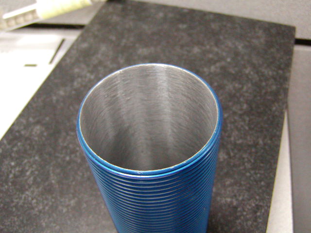

As an alternitive to welding you can use a "shaft collar". You will need to bore the center to match the shock OD, then just bolt it on - it won't move. My friend did this mod about 15 years ago on a pretty serious AX car and it's still working fine.
(IMG:http://i28.photobucket.com/albums/c240/srbliss/shaftclamp.jpg)
