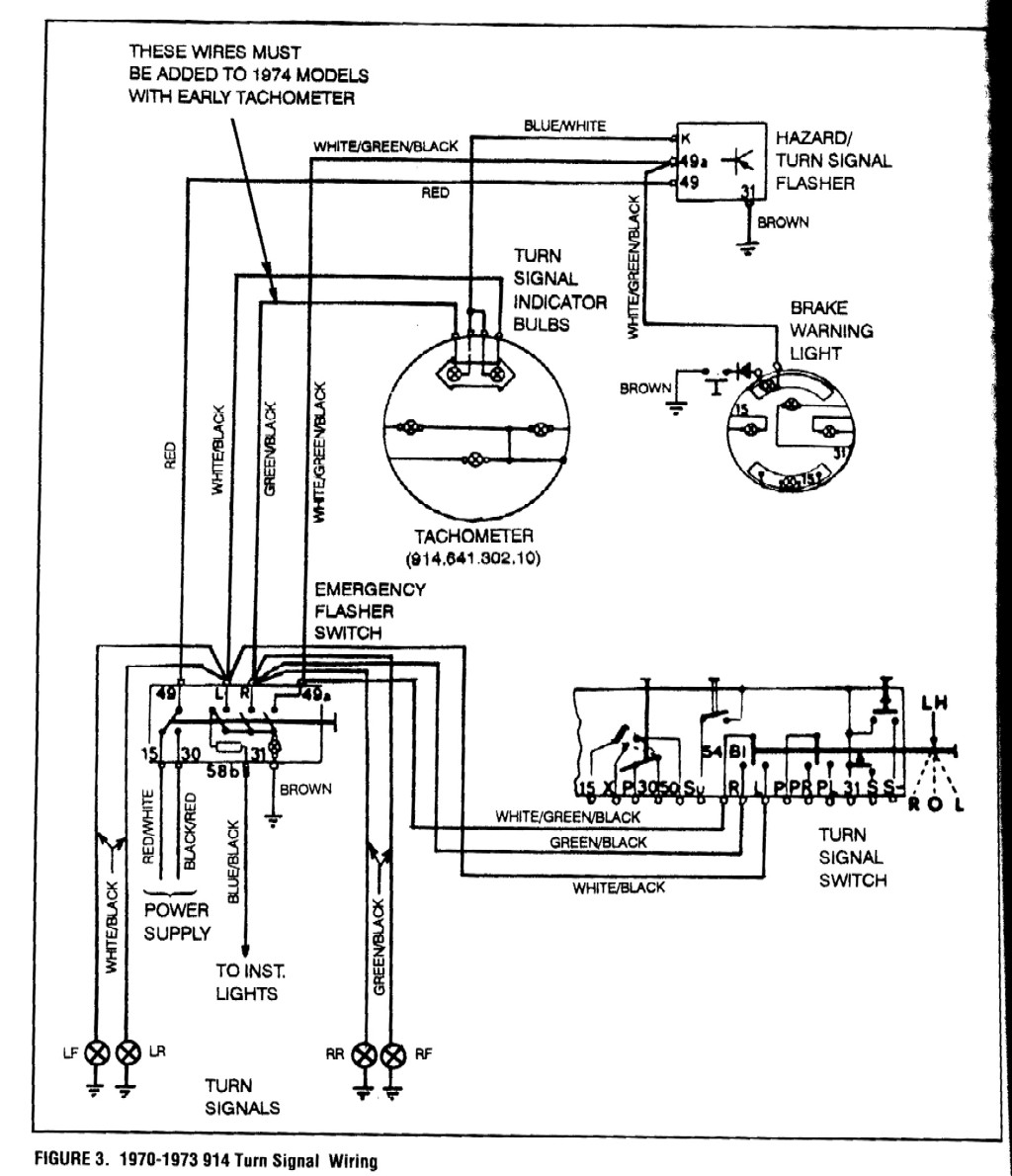

Has anyone rewired a later model car to that of an early model car to get individual turn signal indiators?
The early style was wired so that each indicator light (in the tach) had one of the turn signal wires (black/white stripe or black/green stripe) and the blue/white stripe.
As far as I can tell, the flasher relay is the same, but the wiring is different due to the fact that the 1974 and later cars only had the single indicator light in the tach. The 74 wiring diagram shows the indicator light wired to the blue/white stripe and ground.
Is this rihgt or not.
maybe I'll wire it up and find out.....

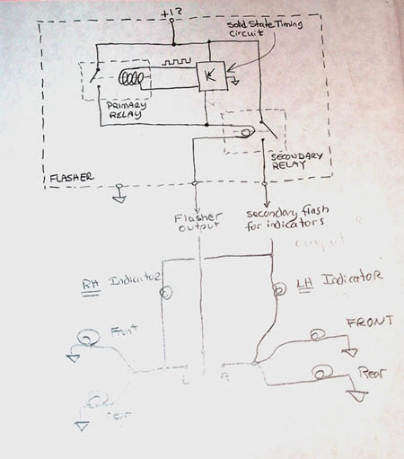

jk76.914   Hi Folks, well I'm back at it. I will go thro...   Jul 6 2006, 10:45 PM

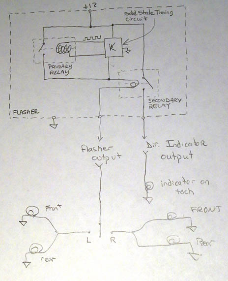

jk76.914   All right. Back again. Here's the schematic ...   Jul 6 2006, 11:35 PM

JOHNMAN   I found the answer several months ago in UpFixin v...   Jul 7 2006, 12:30 AM
BigDBass   Thanks for the excellent description.   Jul 7 2006, 06:53 AM
Lawrence   I nominate this thread for Classic Status! Ch...   Jul 7 2006, 08:51 AM
tdgray   2nd :thumbsup: Very good write up. Very detaile...   Jul 7 2006, 11:41 AM

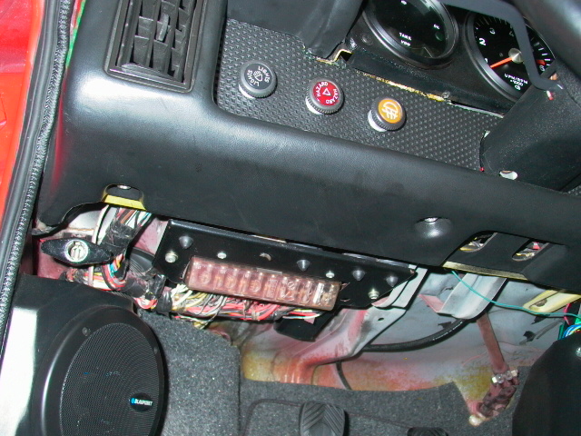

jim_hoyland   Good description; would you mind adding a few word...   Jul 10 2006, 09:07 PM
JOHNMAN   Jim, You would add two wires from the emergency f...   Jul 11 2006, 01:13 AM
jk76.914   That's right. I didn't want to pull out ...   Jul 11 2006, 08:28 AM
jim_hoyland   Thanks for the installation detail--makes sense to...   Jul 11 2006, 08:47 AM
jim_hoyland   One last question; do the repeater lights ground t...   Jul 11 2006, 09:39 PM
jk76.914   That's right. Just like the front and rear si...   Jul 12 2006, 07:18 AM
jim_hoyland   The Saabs sound good; would you have the part numb...   Jul 12 2006, 11:18 AM
