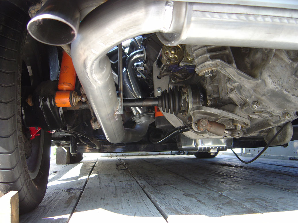

Though not an SBC, I used stainless mandrel bends and routed the exhaust over the axles. Not sure which muffler shops can weld stainless (perhaps these days they all can), but it's a pretty simple task for a decent shop.
There are quite a lot of V8 exhaust system pictures on this site if you search around. I seem to recall a dual inlet/dual outlet Camaro muffler that fits in the original location that looked real nice.

QUOTE(andys @ Sep 8 2010, 03:30 PM) *
Andys
Andy, thanks for the pic. It looks like you have two of the same pieces welded together on each side.
Mike Bellis
post Sep 8 2010, 02:32 PM
Resident Electrician
Posts: 8,348
Joined: 22-June 09
From: Midlothian TX
Member No.: 10,496
QUOTE(pete @ Sep 8 2010, 01:25 PM) *
Andys
That is exactly what the Renegade exhaust tube looks like. Without the weld in the middle.

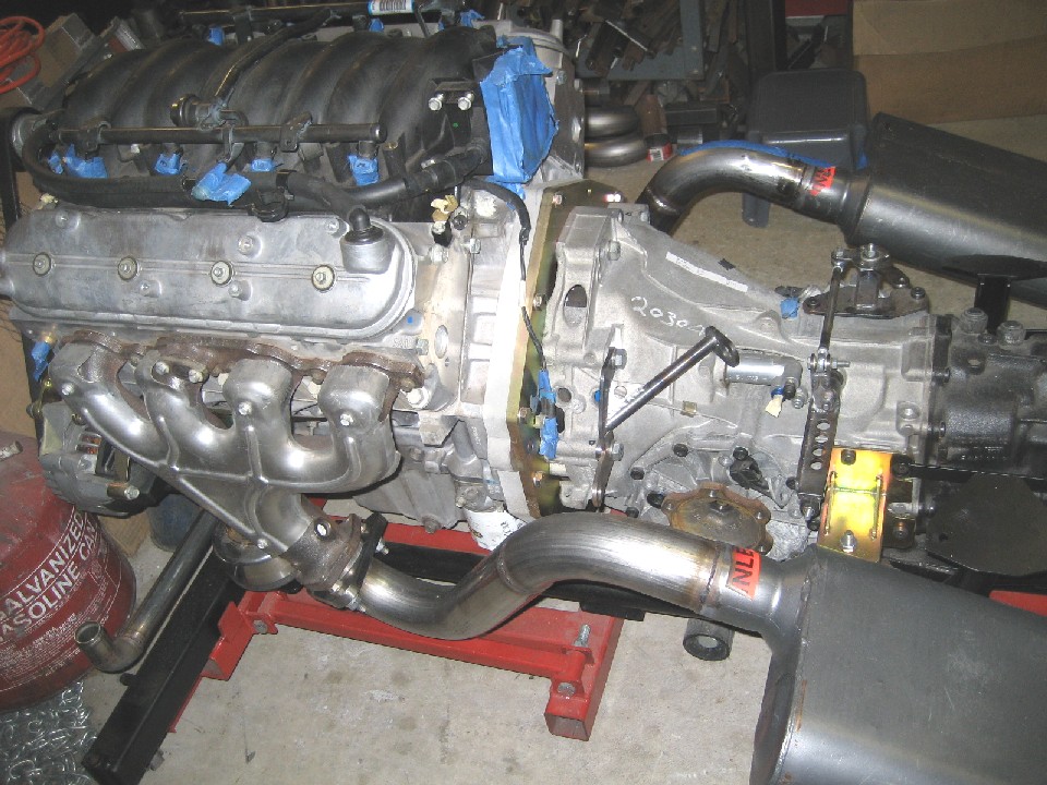

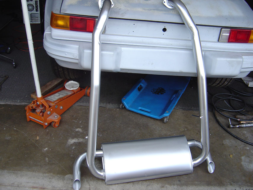

type47fan
post Sep 8 2010, 11:52 PM
It Looks Better In Person. . .
Posts: 860
Joined: 17-September 03
From: Carlsbad, CA
Member No.: 1,170
QUOTE(andys @ Sep 8 2010, 11:30 AM) *
Andys
Like this from skline's V8 Chalon project a few years back. . . .
pete
post Sep 9 2010, 07:07 AM
Posts: 158
Joined: 23-August 10
From: New Jersey
Member No.: 12,092
QUOTE(type47fan @ Sep 9 2010, 01:52 AM) *
Andys
Ha! That's pretty wild looking.

andys
post Sep 9 2010, 09:33 AM
Posts: 2,165
Joined: 21-May 03
From: Valencia, CA
Member No.: 721
QUOTE(pete @ Sep 9 2010, 06:07 AM) *
Andys
Yeah, that's the one I was thinking of; puts the muffler where it ought to be. BTW, I too am a proponent of running the pipes over the axles.
Andys
