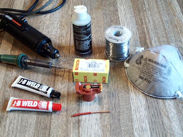

Things you’ll need:
Rotor, new or used. Since the primary failure of a rotor is in the internal resistor, if the tip and contact aren’t too badly burned, they can be polished up and re-used.
Soldering iron, solder, and flux.
#12 wire. AWG #12 wire is rated at 20 Amps, so that should be more than enough.
Epoxy. Since there is no real structural use here, choice of an epoxy is not too critical. Generally, longer cure times tend to indicate higher bond strength and higher temperature ratings.

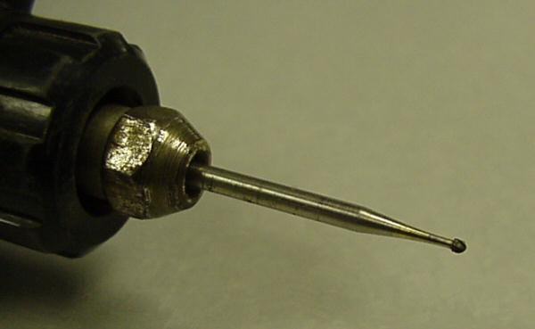

Dremel tool or die grinder with a small cutting burr.

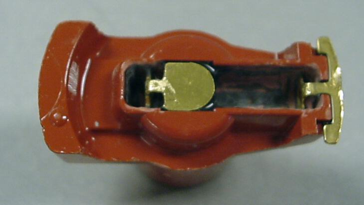

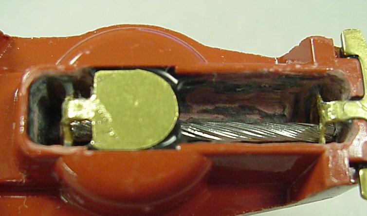

Use the Dremel with a small burr to cut the existing epoxy and the internal resistor out of the rotor. Leave the rotor tip and the center contact secured in the rotor, but clean out on both sides of the connection tabs.

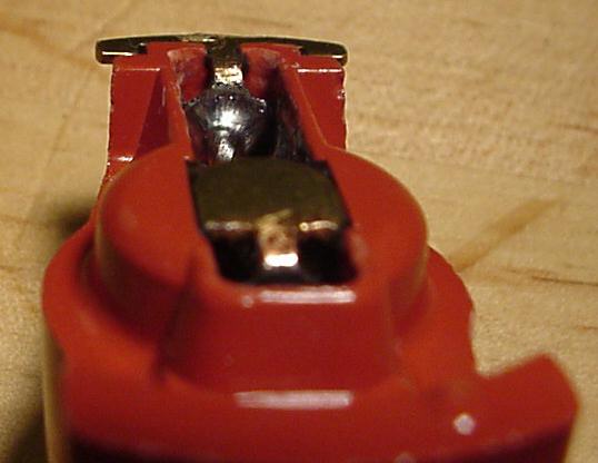

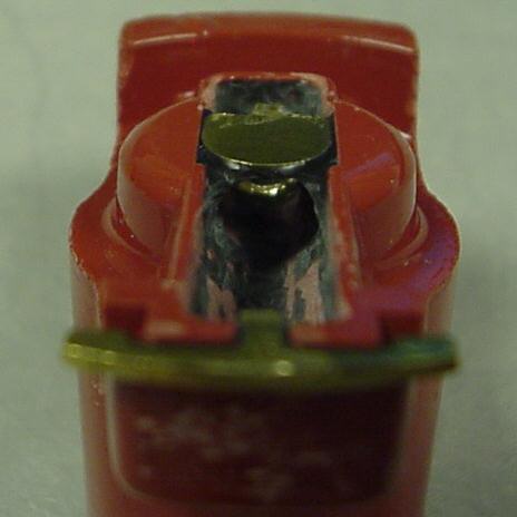

Run the cutting burr up under the center contact to cut a passage for the new wire, but leave the contact securely bonded to the rotor.

Forgot to post the picture (IMG:style_emoticons/default/confused24.gif)

Gently run the cutting burr against the connection tabs to grind all of the epoxy off of the surfaces so that you can make a good solder connection to the brass. Clean up the dust, and flush out the rotor with Isopropyl alcohol or Acetone

Strip the insulation off of about 1-1/2” of #12 stranded wire. Tin the wire and clean off any residual soldering flux.

The tinned wire is stiff, so you’ll have to carefully cut it to length. Slide it back under the center contact and through the hole in the center contact connection tab. Lower the front end of the wire and slide it forward into the hole in the rotor tip connection tab. There is no apparent stress relief in the original construction of the rotor, and the cavity was filled solidly with rigid epoxy, so I never really thought that stress relief bends were an issue in this assembly.

Put a little soldering flux on the connection tabs and solder the wire in place. Clean off any residual soldering flux. (Isopropyl alcohol, and/or Acetone is best since they will degrease the parts and leave no residue.
The major cause of failure in gluing or bonding is that the surfaces were not prepared properly. They must be absolutely clean!!! Make sure there are no grease or oil on the surfaces being bonded.

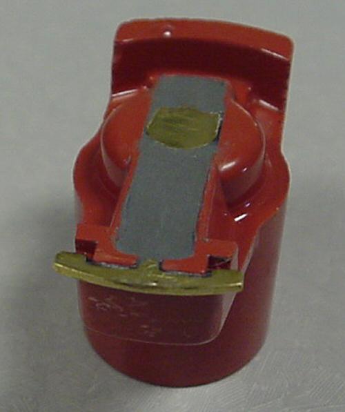

Fill the cavity in the Rotor with epoxy. Paste epoxies will require that you use a matchstick or a small piece of wood or wire to pack the epoxy into the cavity, forcing it back through the hole under the center contact. When the cavity is full, use a Q-Tip or a piece of cloth or paper towel wet with alcohol to wipe the epoxy off flush with the top of the rotor. Make sure you clean off the top of the center contact. Allow the epoxy to fully cure before proceeding. Heating is not really necessary, but it will speed the cure of the epoxy, normally 145 to 150 degrees F is sufficient. Heat curing will usually cause the epoxy to liquefy a bit as it heats and allow the epoxy to fill the cavity better, and may let any entrapped air rise out of the fill. DON’T use an over that you use for food!

When the epoxy is fully cured, use a small piece of wet-or-dry paper to polish the top of the center contact to make sure there is no epoxy residue insulating the surface.
