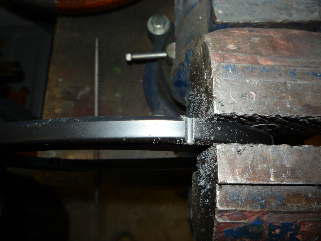

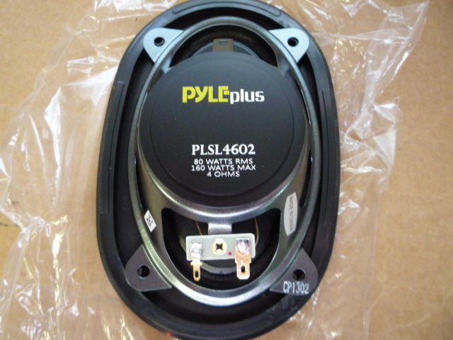

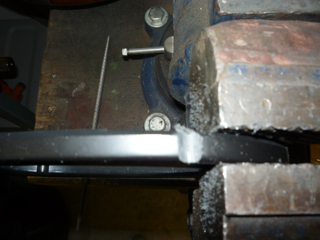

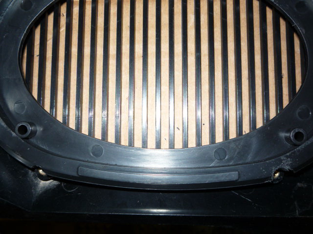

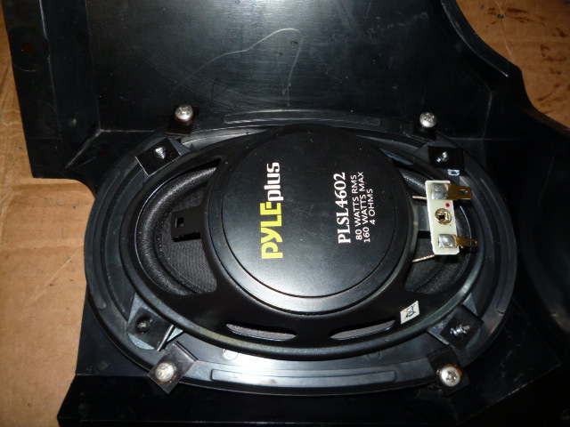

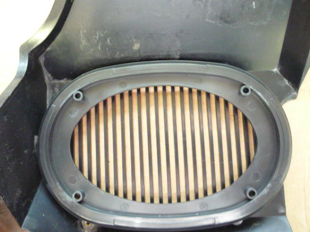

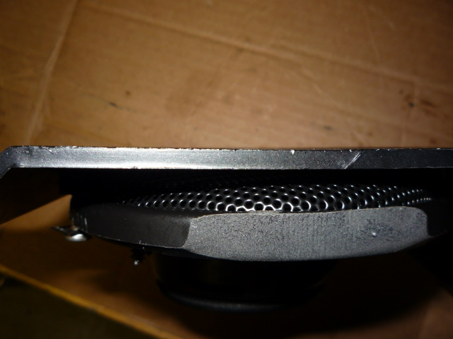

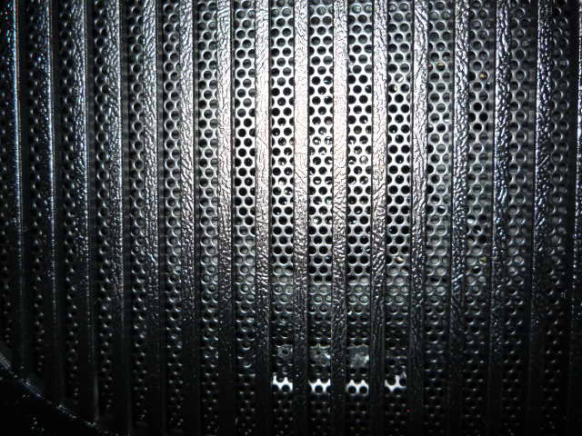

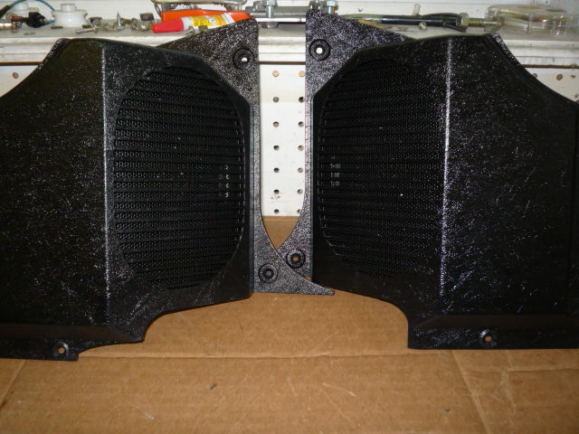

I am updating the sound in the orange 75. The factory speakers had crumbled. I pulled them out and went in search of some replacements. We all know that the speakers on the 914 were an odd duck mounting size. You have to also keep in mind that the speaker has to be low profile to clear the side wall. I found a set of Pyle coaxial speakers (4x6) that fit the objective. Of course, the speakers and mounts were not going to be plug and play but I found a way to make for a nice factory look fit.

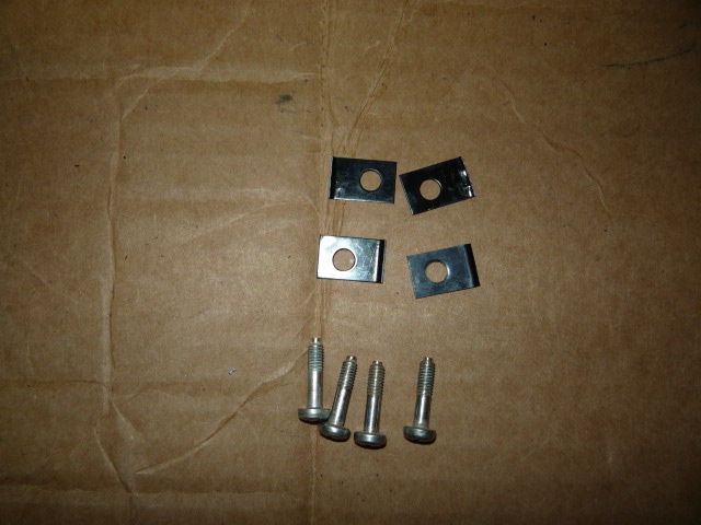

I took the speakers apart and checked the mounting out. Mounts with grill would fit in the stock location mount with a little modification. I ground off about a 1/4" of plastic on each end of the mount to fit inside the speaker housing. Marked the mounts for notching and got out the files. Used a V file to start notch and then a round file for the mounting slot. Put the speakers back together and mounted them in the factory holes. I need longer screws. so I used the front turn signal lens screws, they were just the right length. I broke the speaker mounting clips in half and used it to secure the speaker mount to the factory grill.

Not sure I follow, are you saying you can make them fit with the
grills fully screwd down? If so I will do this too, my old speakers
are dying.
914Sixer
post Aug 15 2014, 10:10 PM
Posts: 9,487
Joined: 17-January 05
From: San Angelo Texas
Member No.: 3,457
Yes, they will fit with the grill covers on the speaker. I will add some more pictures in the morning.

These fit really well BUT you have to do the modifications as shown.

Got the fiberglass already,
I do like the mod shown, as it looks completely stock
