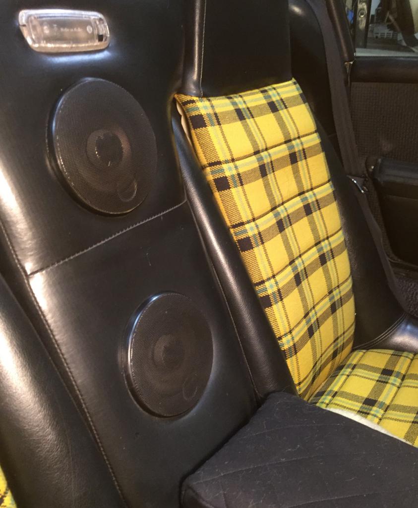

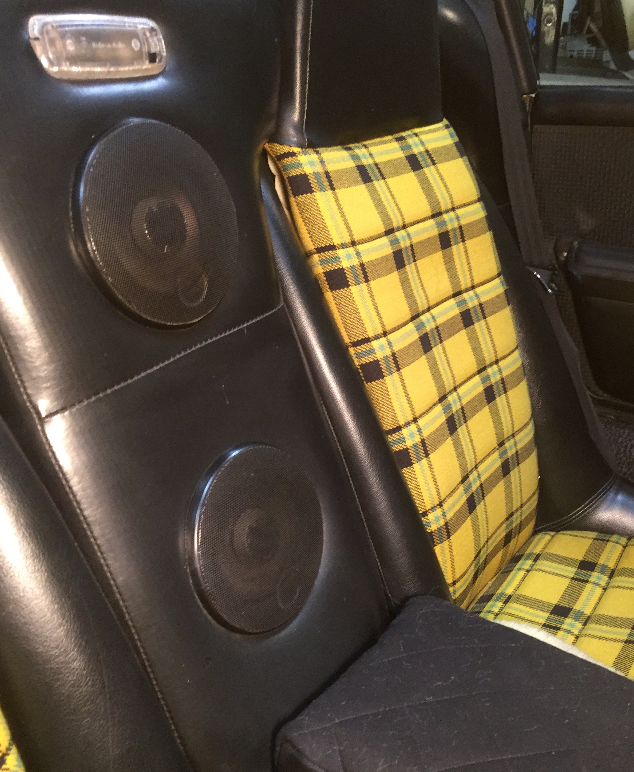

> Stereo speaker placement idea you might like, 6 speakers, sounds great even with no roof on!
oakdalecurtis
post Mar 26 2017, 04:42 AM
Oakdalecurtis
Posts: 1,407
Joined: 5-June 15
From: Oakdale, Ca
Member No.: 18,802

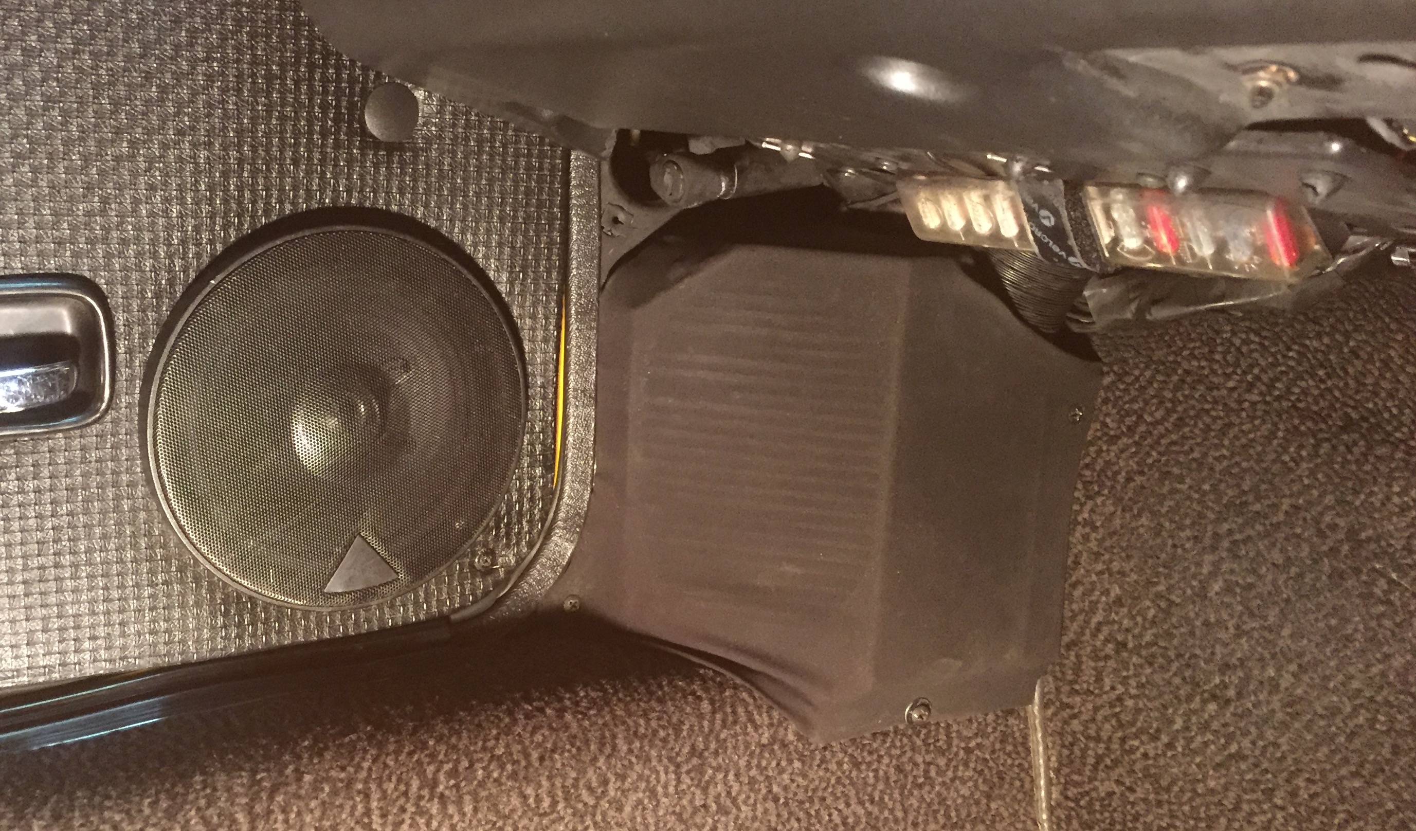

I have two speakers on each side in front, one in the original footwell location and one in the door, wired together in series as one channel. Each pair make up the front left channel on one side and the front right channel on the other side. Then I have two speakers in the center of the backrest. One is the left rear channel and one is the right rear channel. When I balance the music out from front to back, it's really easy to hear the sound because it's coming from very close to your ears in the backrest. The front two speakers on each side compensate for their inferior position by being paired for each front channel. Don't need an amplifier. Works better than I could have hoped! (Might also notice the velcro strap around the fuse cover to keep it from being bumped off accidently)
