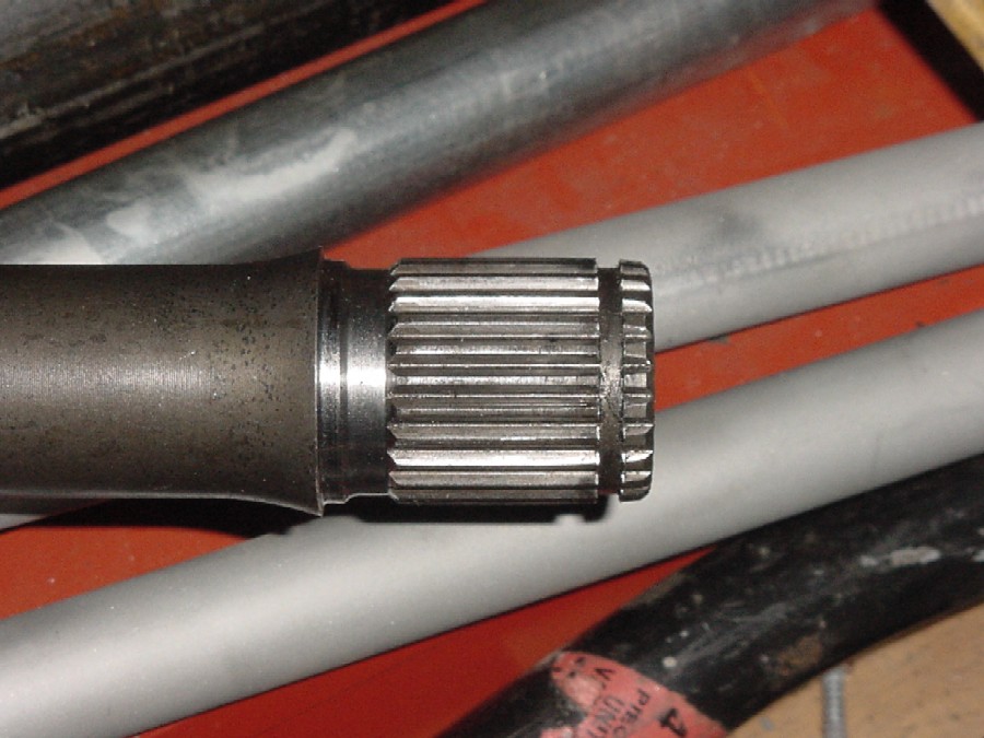

LvSteveH   They have a different spline count, and a six axle...   Nov 9 2006, 02:51 PM

GeorgeRud   I just checked my old 914 factory parts book, and ...   Nov 10 2006, 06:39 PM

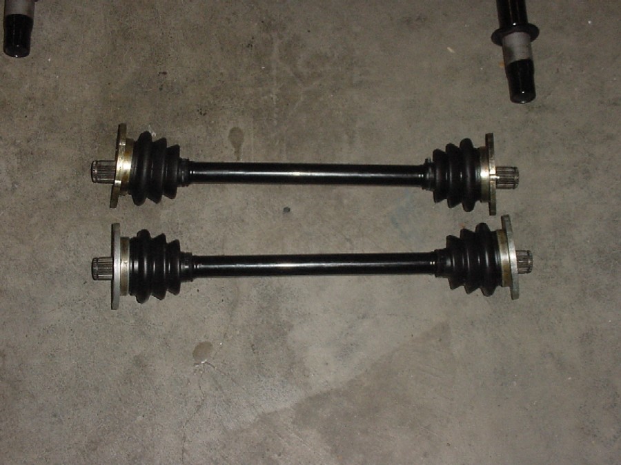

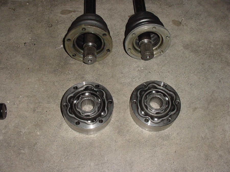

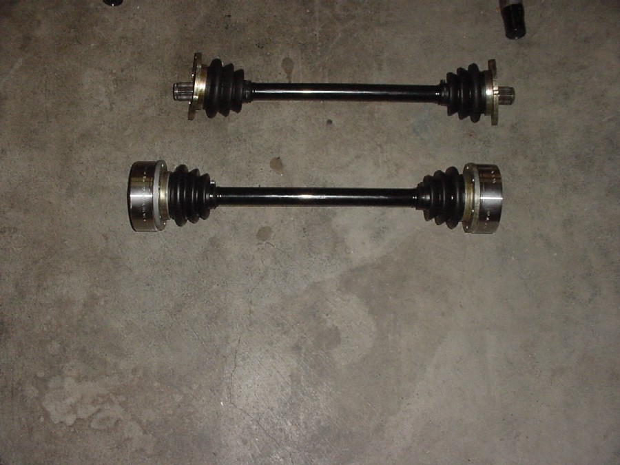

JOHNMAN   2 last pics The Cv joints are for up to mid year ...   Nov 12 2006, 03:10 AM
