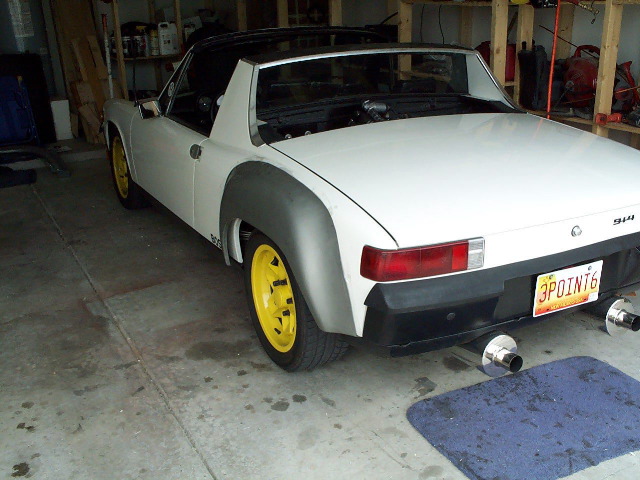

By request, I'm posting the few pictures I have of the installation of my steel flares.
I started by taping them to the car to find the correct position. It's a subjective placement and I recommend NOT using FG GT rockers as a guide. Mine would have been wrong if I had. Instead, I found that the arch of the flares was slightly larger than the arch of the factory fender. I taped them on in a position that split the difference when you looked at the car from the side.

Series9   With self-tapping sheet metal screws, I then attac...   Jan 12 2005, 10:17 AM
Series9   I then carefully cut along the scribe line, fit up...   Jan 12 2005, 10:19 AM

AndrewBlyholder   After you've cut the old fender at your scribe...   Jan 12 2005, 10:24 AM
Root_Werks   I put FG flares on my 914 and they look sweeeet, b...   Jan 12 2005, 10:27 AM
Series9   I left some small tabs on the old fender that I co...   Jan 12 2005, 10:28 AM

Phoenix-MN   I found that you can get a accurate cut line if yo...   Jan 12 2005, 11:26 AM

trekkor   I have a question. Why not lap weld, seems stronge...   Jan 12 2005, 08:03 PM

Series9   Butt welding is just the right way to do it. It...   Jan 12 2005, 08:30 PM
JOHNMAN   First off, thanks guys. This is exactly what I ha...   Jan 12 2005, 09:27 PM
mharrison   The preferred method of cooling for zero heat warp...   Jan 12 2005, 10:14 PM
scotty b   Another reason NOT to lap weld is the metal will s...   Jan 13 2005, 07:28 AM
