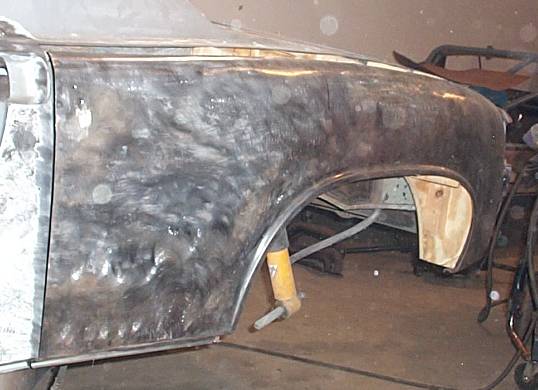

Chris, Do you use the "cut and weld" or the "hammer and dolley" method to achieve your rear flares?? They look great and I'm planning on the same for my car. Do you have any pics shot during the process??

QUOTE(East coaster @ Oct 20 2003, 12:46 PM)
I remove nearly the entire quarter panel from the car. I reshape it with power equipment as well as hammer and dolly. Then I add a little new metal at the perimeter and fit it back onto the car, where I carefully butt weld it. More hammer and dolly work is required after grinding down the welds inside and out. A lot of work goes into achieving that look.
Here's one picture. You can see the wooden form that I attach to the car while I'm shaping and fitting the flare.

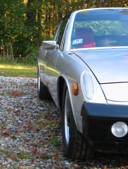

Awesome job, Chris! Nice subtle look for the flares. Hard to tell, just rears, or fronts and rears? Do you do a similar thing for the fronts too?

QUOTE(ss6 @ Oct 21 2003, 12:32 PM)
.Hard to tell, just rears, or fronts and rears?
Rears only on this car.
Here's another look:
