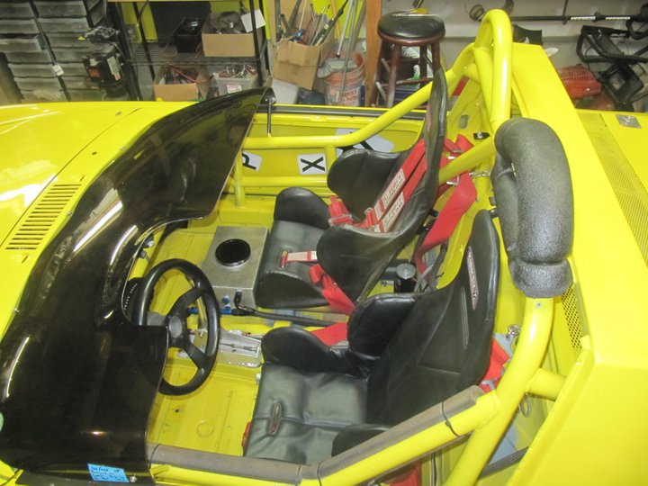

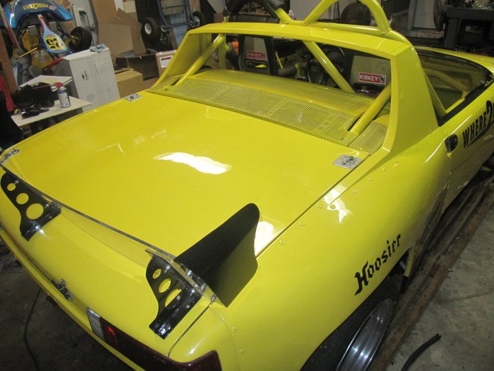

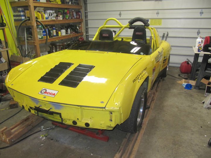

The car is officially ready to go. All the body panels on, fluids in, and everything checked. Just gotta load her up and take her to Dr. Bailey at Cobb Tuning Surgeline in the morning.
All the body panels on.
(IMG:http://www.914world.com/bbs2/uploads_offsite/a2.sphotos.ak.fbcdn.net-364-1299481523.1.jpg)
Engine lid fits with no issues.
(IMG:http://www.914world.com/bbs2/uploads_offsite/a5.sphotos.ak.fbcdn.net-364-1299481523.2.jpg)
Passenger seat in and waiting for Dr. Tim Bailey at Cobb Tuning Surgeline to work his magic.
(IMG:http://www.914world.com/bbs2/uploads_offsite/a8.sphotos.ak.fbcdn.net-364-1299481524.3.jpg)
We shall see how it goes.
-Britain
