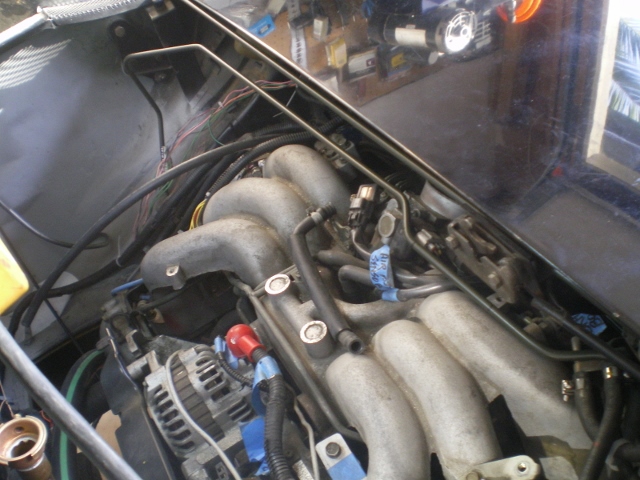

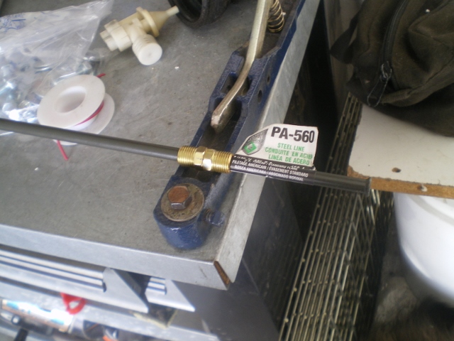

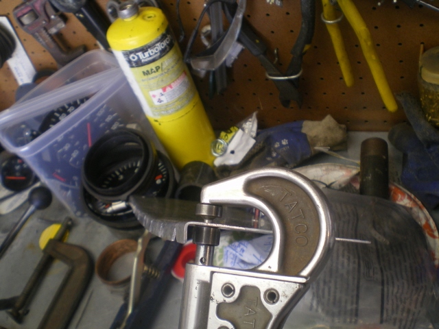

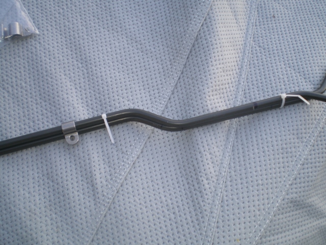

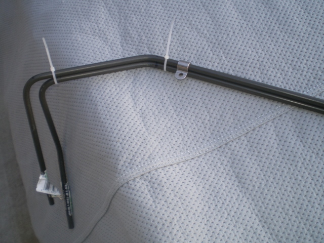

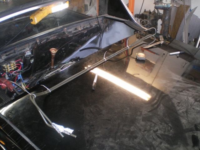

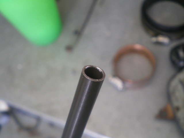

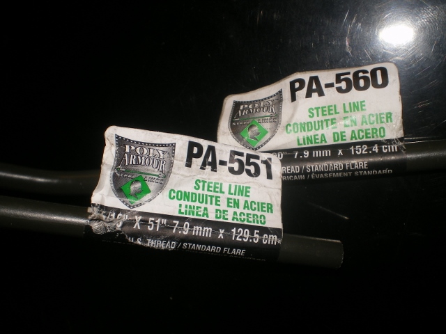

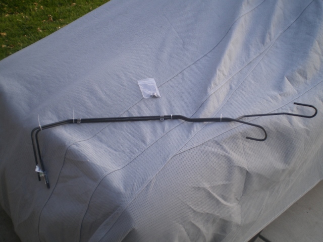

While waiting on some tach cans I thought it might be a good idea to run some fuel lines. My original plan was to run the fuel to the left side along the firewall. However, that side ended up being quite busy so I left the SS lines in place. I decided to run the gas line across the engine (just like the 914) but I didn't want to worry about the rubber lines shooting fuel about the compartment. So I bought these 5/16" anodized lines in 51" & 60" lengths. $15 for both.
Then a few simple tools and 45 min's later
Test fit the first piece. You can't see it but they will run one spaced above the other along a 1" path above the TB opening. No room to wiggle.
They're flipped 180 from how they'll attach. That will happen after I drop the engine again. Then I can do some spring cleaning and tidying up.

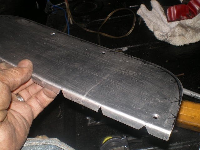

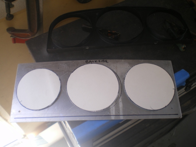

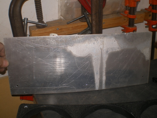

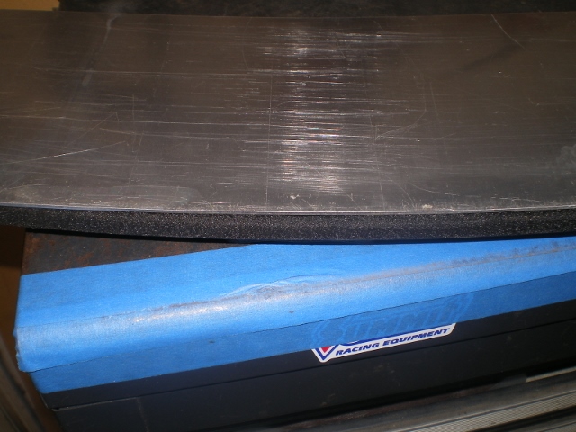

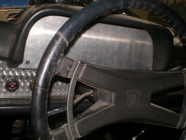

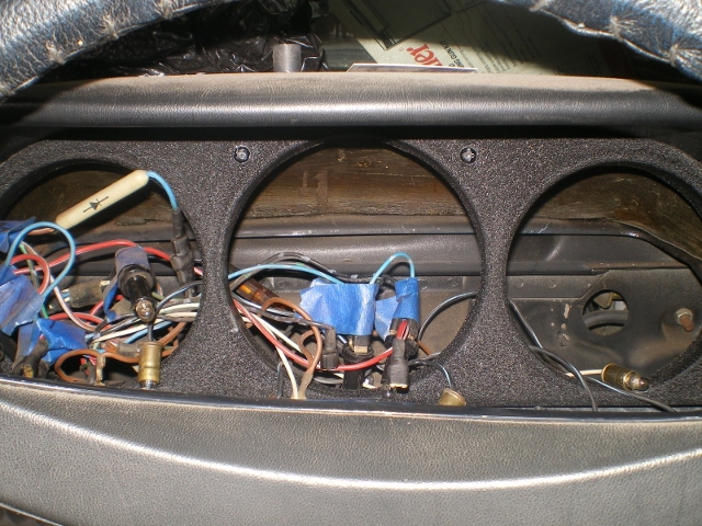

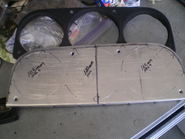

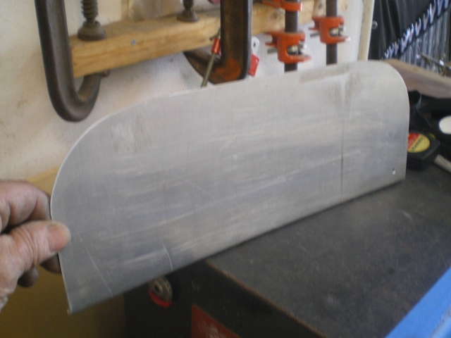

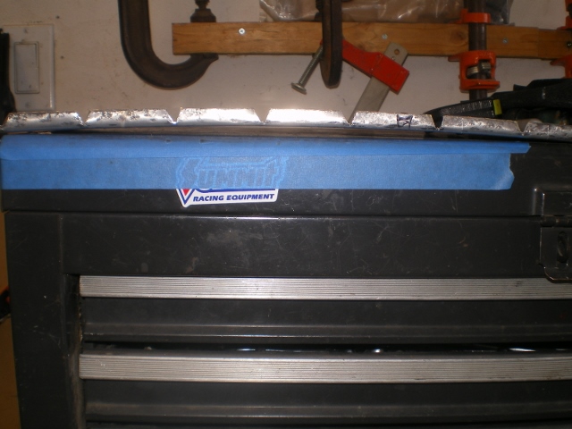

I found that I needed to change the gage layout a bit if I'm to use the Suby tack and Suby speedo. But I can't use the existing panel and need to make another one. The new panel will have 2 large cans and 1 small can vs. the old layout of 2 small and one large. I think there is just enough room but I won't know until I get the cans next week. But there's stuff I can do now. I need a model so time to pull the gages and remove the panel. Luckily I never removed the markers I put on last year so that was time saved.
A piece of some aluminum plate cut to appx size with a pilot hole for alignment to the OG panel.

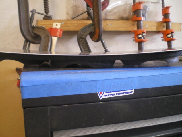

My tool box top has a nice big radius lip so I covered the edge with some blue painters tape and pulled the plate across it several times to get a gradual curve like the OG.
A quick layout check
Checking the bottom for flatness after the lower flange(s) were bent. I couldn't have one continuous lip because of the curvature of the face.
Another quick test fit. Still on track.
Now to countersink the holes
I need to buy another flycutter so I can cut those holes. The centers are punched so it will just be a matter of cutting the holes. But before I can do that I need to laminate the back with 5/8" poly carbonate. Once that is drilled out it should create the shoulders for the gages just as the stamped OG panel has. More when the cans arrive.
EDIT: These holes are marked incorrectly. They are each 5mm too large. So 115mm & 100mm.

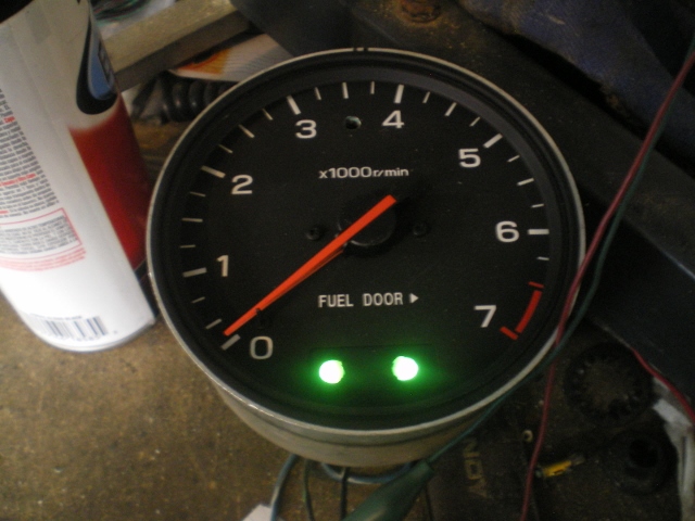

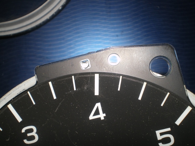

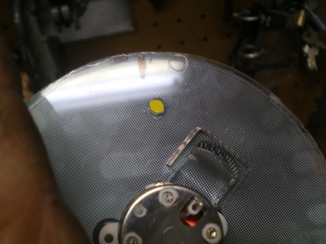

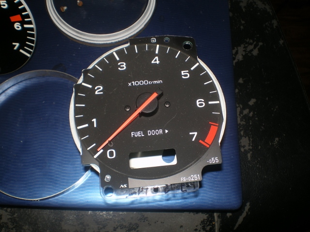

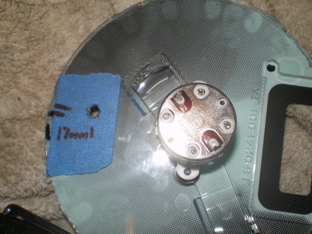

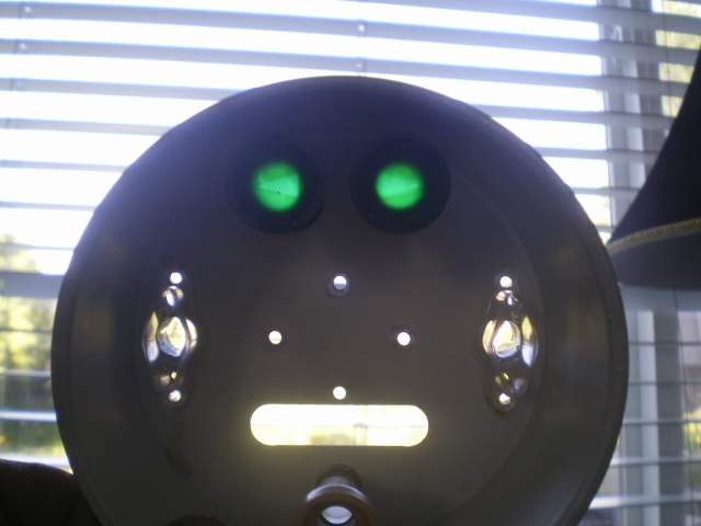

The 2 salvage tach's came today. Thx Garold, once again. Remove 4 screws on the backside and everything falls out after the bezel is removed.
These little post do double duty. They support the gage and also function as light tubes for the blinkers and HiBeam light.

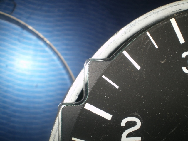

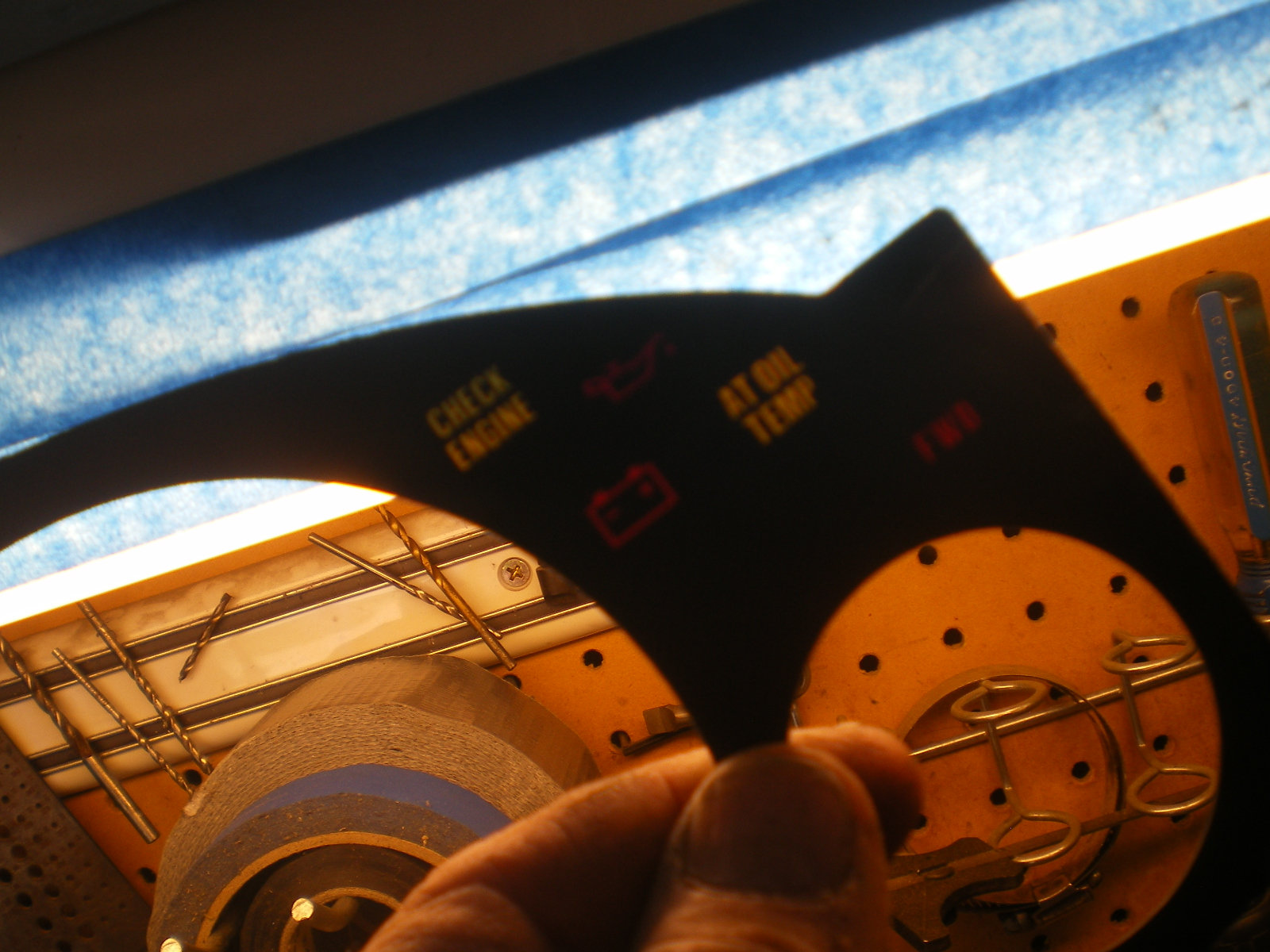

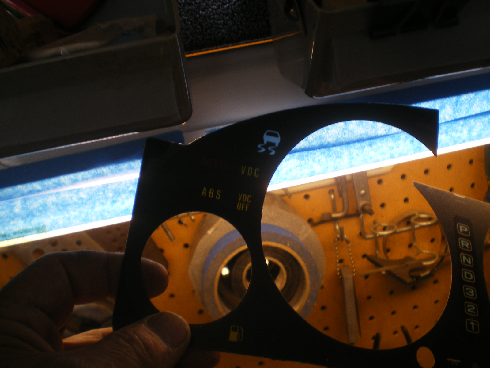

Here is the Suby gage that was cut from the panel cluster. It still needs to be trimmed.
Use the line that is the radius line of the gage face. It's where dull black goes to grey or clear.

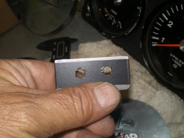

Then drill a hole (be damned sure to use a bit for plastic) as shown for the stock HiBeam indicator lite.

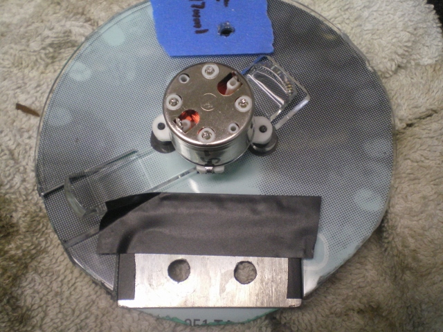

This is strictly a Shits n Grin mock up to see is it works. A piece of alum with a couple of holes and some electrical tape to blend in.
Temp taped to the back. Final vers will be glued in place w/ arrows.
The HiBeam hole (in yellow) from the back of gage.

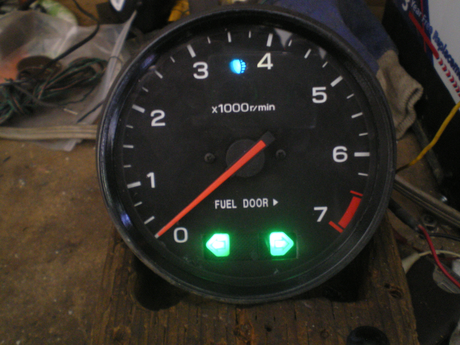

Put a little power to it to see what it would look like. It also need a blue lens for the HiBeam tube. The turn signals are now on the bottom and HiBeam on top. Otherwise it's pretty damned stock looking.

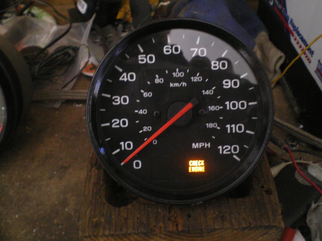

Next up is the Suby Speedo Transfer.

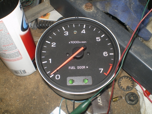

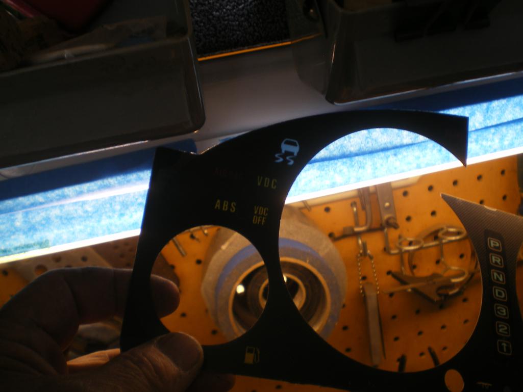

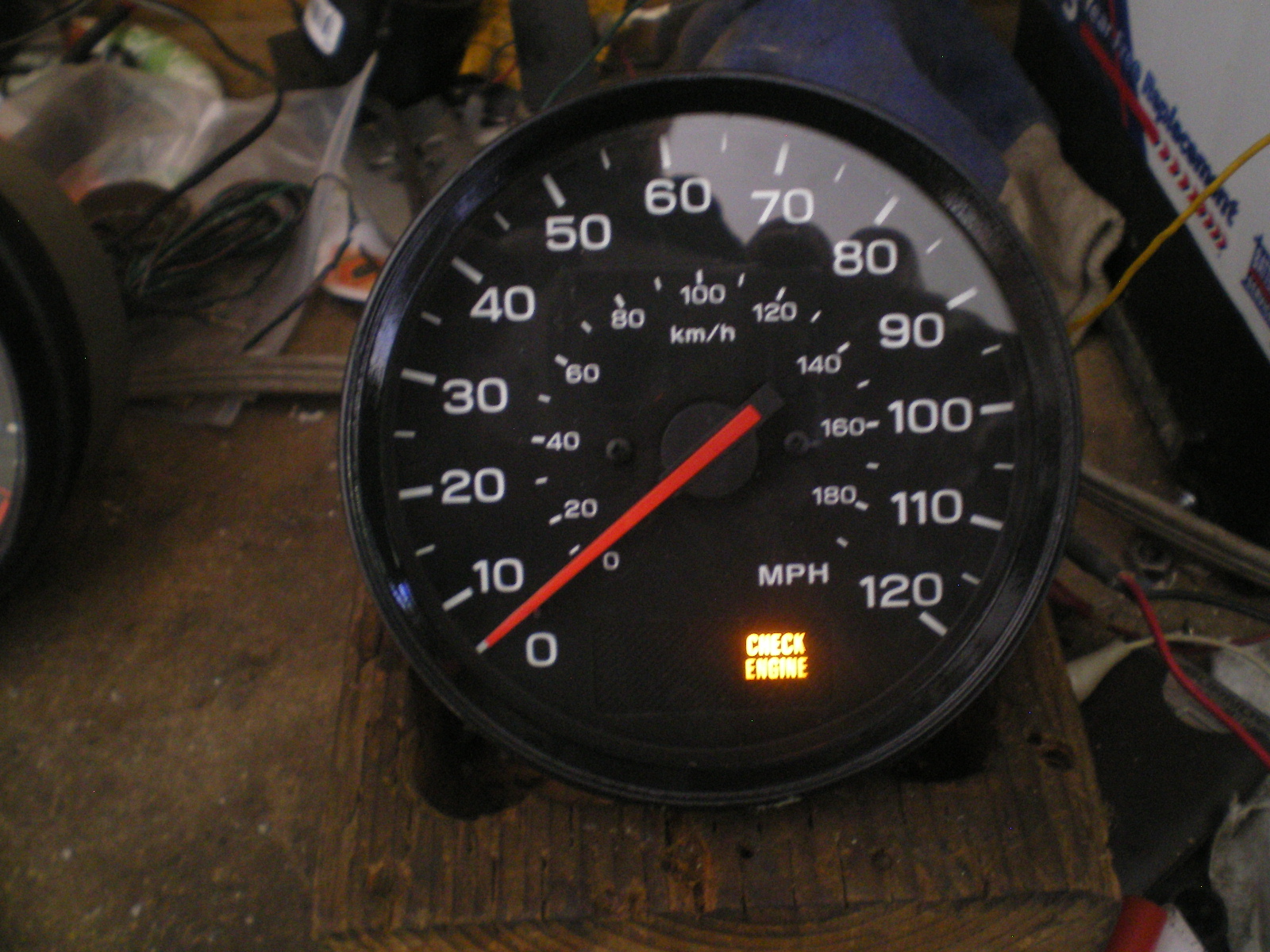

Well Mike, if it weren't easy and cheap I wouldn't do it. (IMG:style_emoticons/default/biggrin.gif) Thx Stephen and Chris. (IMG:style_emoticons/default/beerchug.gif) . Well this post on the Speedo install will be short because almost all of the work is the same covered in the Tach post! One difference is the speedo is also installed in a large "tach can". As you can see it is the same size as the Suby tach and needs to be trimmed to fit and the window won't have turn signals.
Then I peeled the laminate face off of the old Suby panel face and robbed some needed labels.

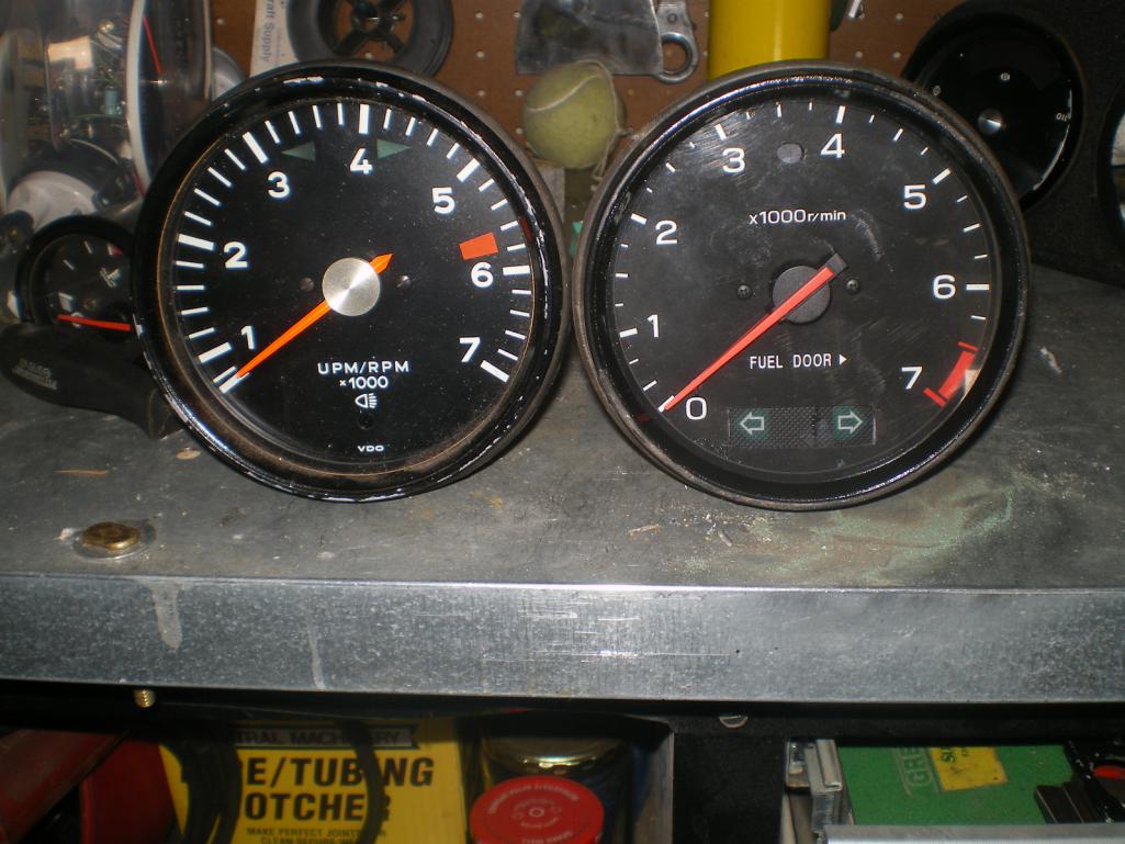

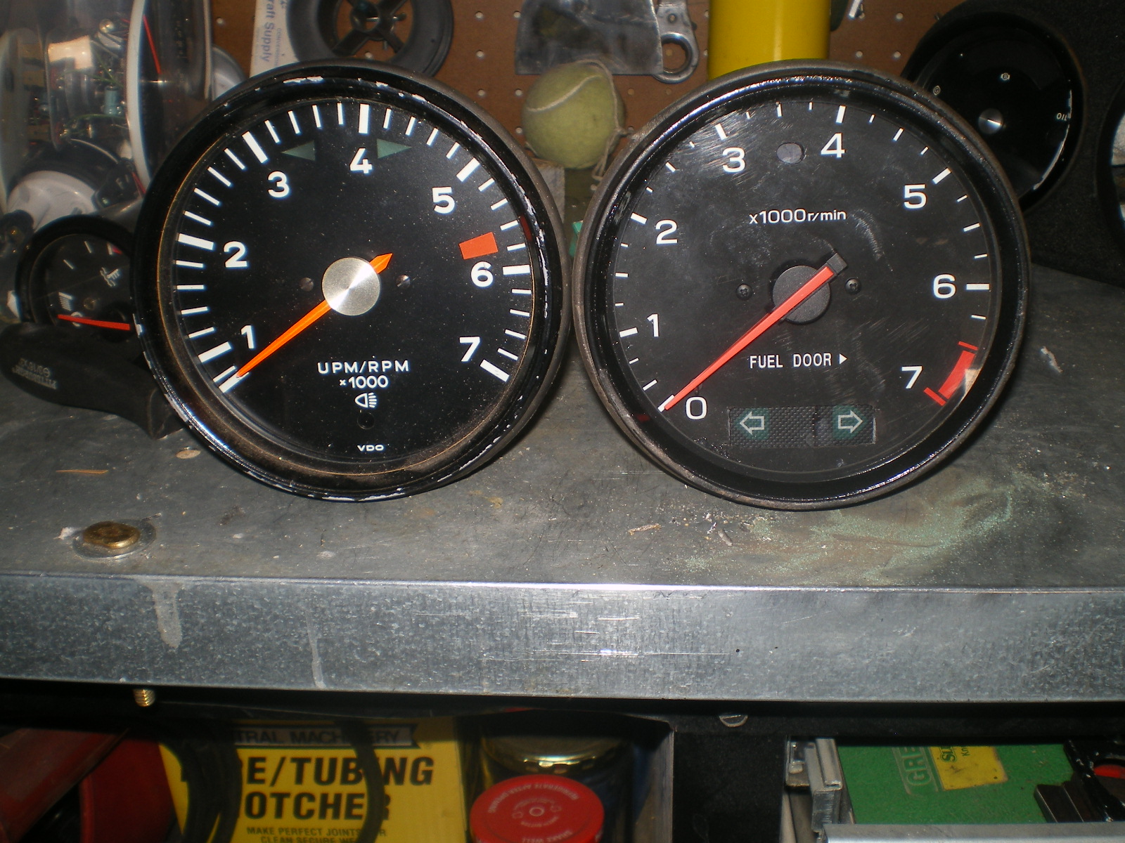

Thought I'd throw in this side by side of OG Tach and Suby Tach.
And the finished products
