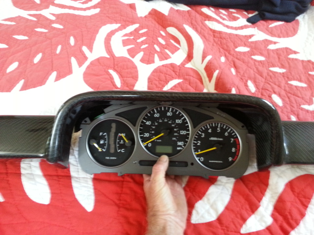

Well the tach should connect to the ECU, or at least that's the way the SVX's works. Only one wire though. The speedo connects to the sensor on the trans but there are not 4 wires there either. Seems like that "circuit board" you pulled the pins out of was something you might need to use still. You can probably still use the gauges, just have to take a look at what that board does and maybe leave the gauges connected to it and solder a couple of wires for the speed sensor and tach wire. Also follow the wiring from that board back to the ECU and see if there is anything else in between. If not you can have the SVX gauges. I definitely won't use those.
904svo
post May 21 2014, 06:50 AM
Post #366
904SVO
Posts: 1,129
Joined: 17-November 05
From: Woodstock,Georgia
Member No.: 5,146
QUOTE(Chris H. @ May 20 2014, 07:13 PM) *
There is a micro processor in the instrument cluster which drives the tach,speedometer and low fuel light.
post May 21 2014, 08:44 AM
Post #367
Posts: 13,852
QUOTE(904svo @ May 21 2014, 05:50 AM) *
Yea, I thought so. I guess if you don't have an easy solution I'm screwed. (IMG:style_emoticons/default/sad.gif) I did give a quick look at the circuit board but that is way above a plumbers pay scale. Those are incredibly small lines to follow; I don't think I could solder anything to the board successfully; and if I could I wouldn't know which ones to use or not use. I'm not sure if those SVX gages would work, Chris. I'll probably go with Dakota if this can't be resolved, easily.

QUOTE(76-914 @ May 21 2014, 06:44 AM) *
You could extend the leads from the instrument panel to the gauges, and hid the
instrument panel under the dash.

Yes, I've read (somewhere) about your tach conversion and will have to dig that up. And yes, I am using the stock fuel sender and gage, also. I'm running the Suby trans so I may end up with some magnetic pick up system (hall effect?).

Think I'm starting to migrate back towards the original direction of Speedhut gauges. I want something a little newer looking and those are so easy to set up. I'm not as good with small electrical stuff as you all are.
Kent I have the same Impreza gauge pod (manual trans so no PRND321 on it) and a tach adapt to change the tach to 6 cylinder readout. The speedo should connect to the vss on your trans. Probably would let them go for less than I paid (which is not much) if you decide you want to go that way.

This is what confuses me. I have a single lead from the ECU (smallcar harness) that is tagged for the tachto but the tach is the same set up as the speedo with 4 wires as shown below. Also a pic of the circ board they came from. Any idea which post are used and which are not?
QUOTE(Chris H. @ May 21 2014, 03:20 PM) *
Don't feel obligated, just telling you so you don't go buy 'em somewhere else for more. I think I got the gauge for ~$40 and the tach adapt for $65.
Shit, me too, Chris. I don't have a problem with cutting my losses. I checked my circuit board and it is cracked in a few places so that door is closed. If it weren't I'd take SVO's advice and hide the board. All I need is a speedo and tach so I may go the Speedhut or Dakota route. I'll keep your adp in mind if I go that route.

Check out the Speedhut stuff. The tach is totally programmable for most any engine and the speedo is gps. By the time you spend money on the senders you're half way there. A 4.5 inch tach and a 4" speedo revolution series is what I'm looking at. Brand new gauges, plug and play. The tach instructions are on the site too and show how to set it up on a bunch of different engine configurations. I'll go quad gauge too I think.
