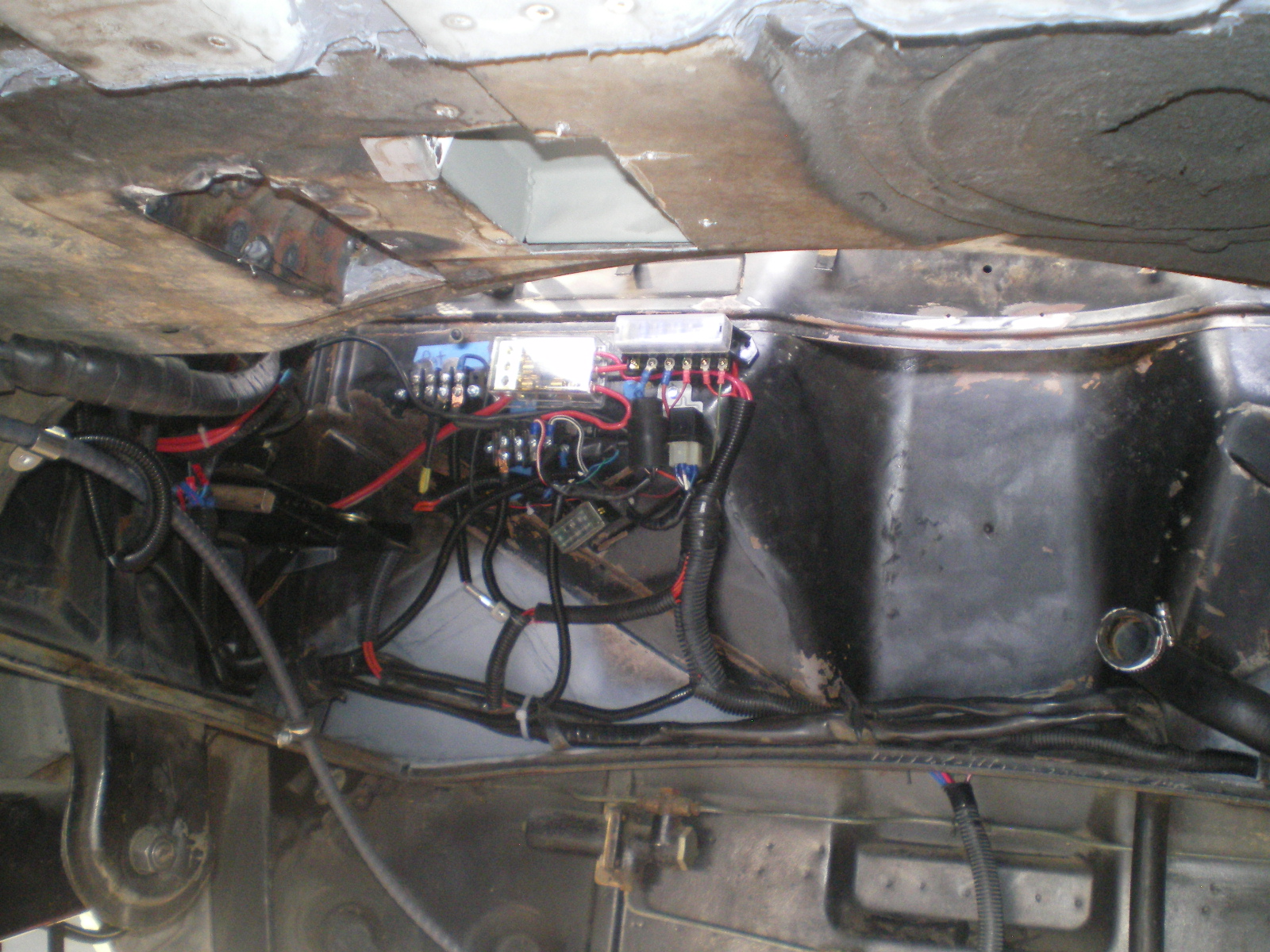

Well I dropped the drivetrain in preparation for cleaning up the Hell Hole wiring and some hose replacement. I'm writing it up step by step so I will have a reference one day when I've forgotten damn near everything I've done. (IMG:style_emoticons/default/mad.gif) This adds to the time it takes but what is really slowing me down is my neighbors kid who's decided to take an interest in my cars transformation. Not that I believe it's unusual for a 14yo kid to show interest in old cars. That is unless that kid's name is Brigitte. (IMG:style_emoticons/default/new_shocked.gif)

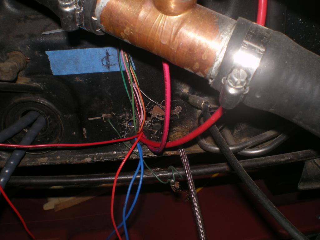

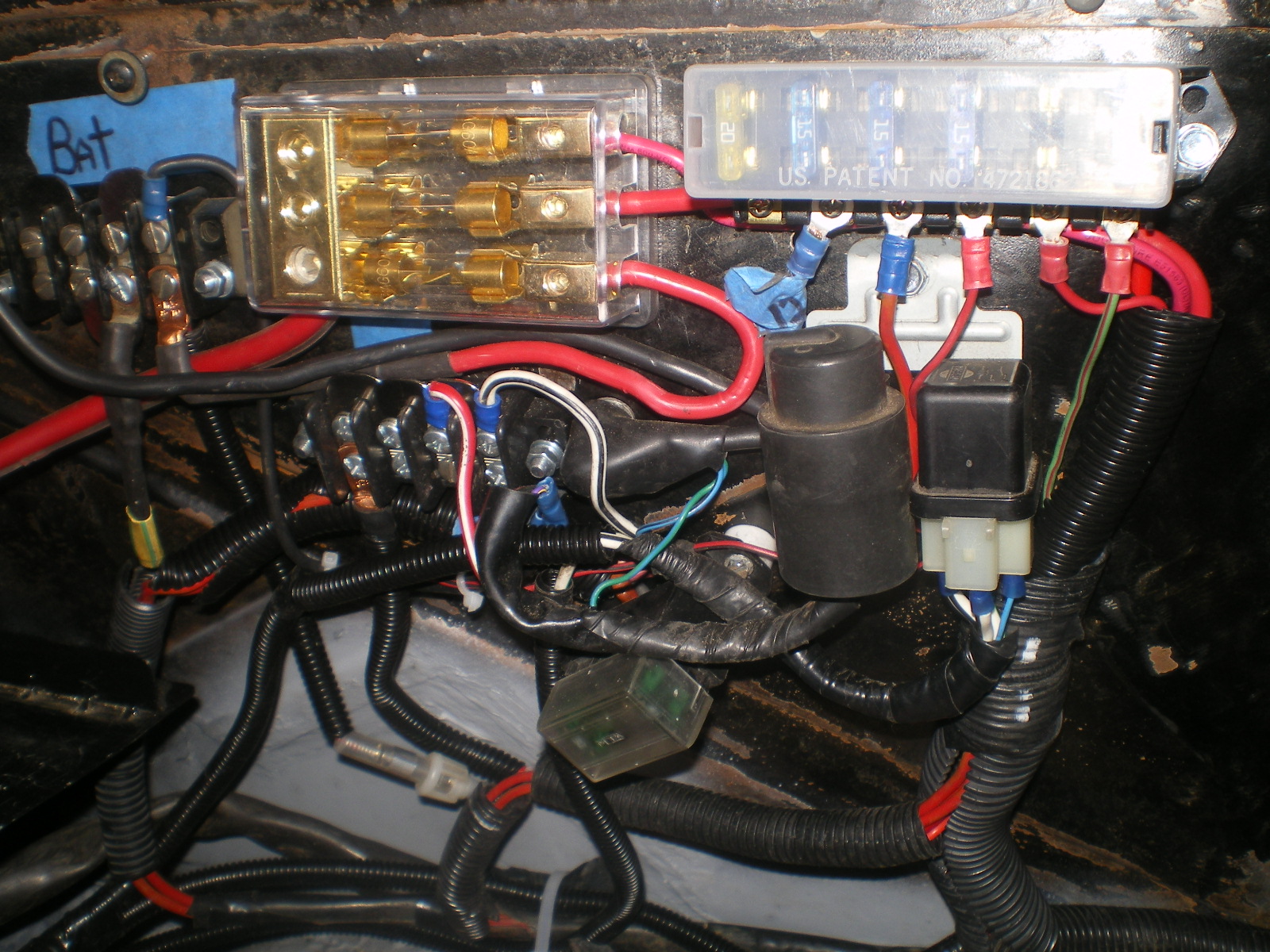

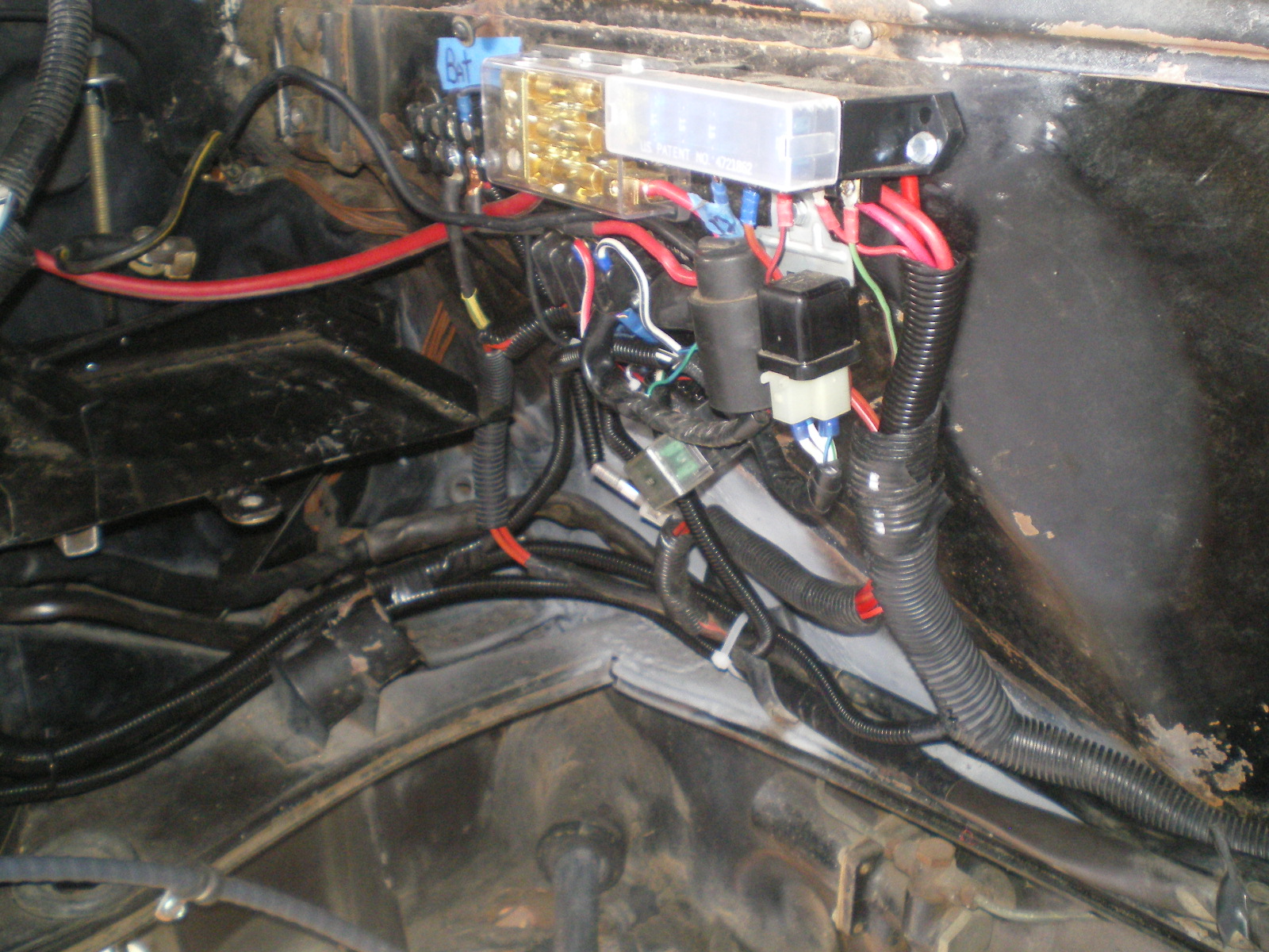

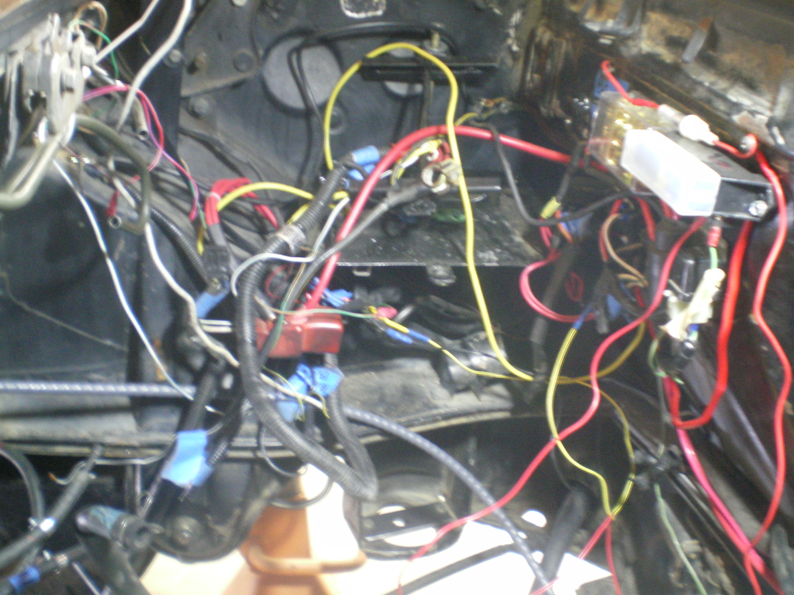

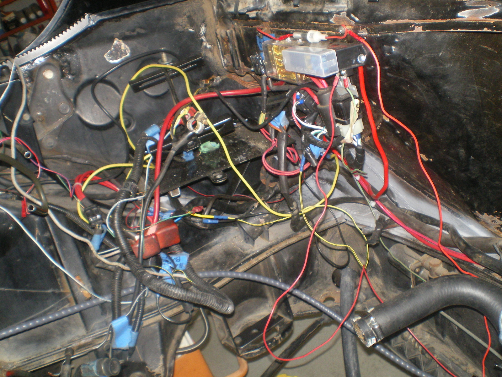

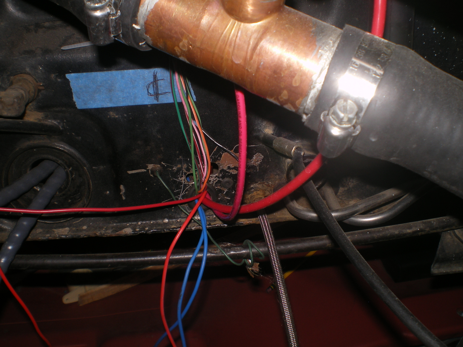

I had a few hours yesterday so I began to tidy up this electrical Rat's Nest that had been staring at me for the past few weeks.
My helper went AWOL which sped the process up greatly. (IMG:style_emoticons/default/lol-2.gif) I ran out of electrical tape so pardon the exposed wires, sloppiness and floppiness. Another 2o min's and it should be wrapped up. NPI
76-914
post Jun 15 2014, 07:23 PM
Post #427
Posts: 13,852
Joined: 23-January 09
From: Temecula, CA
Member No.: 9,964

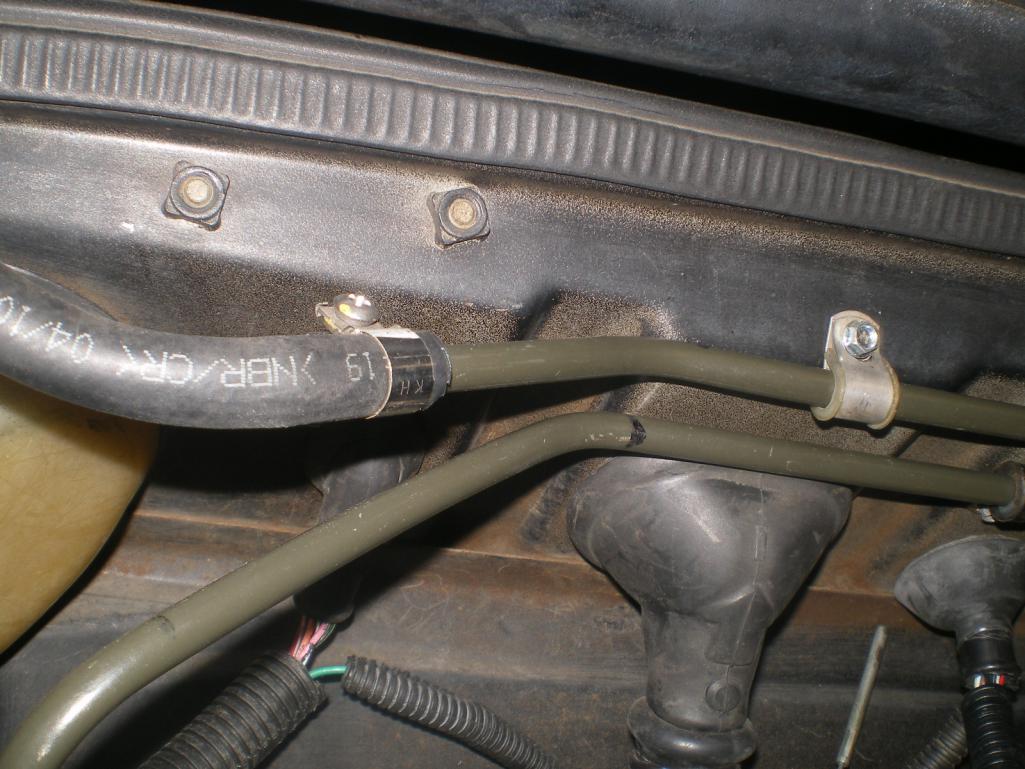

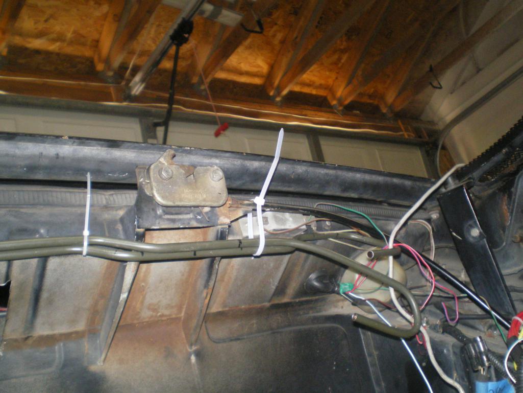

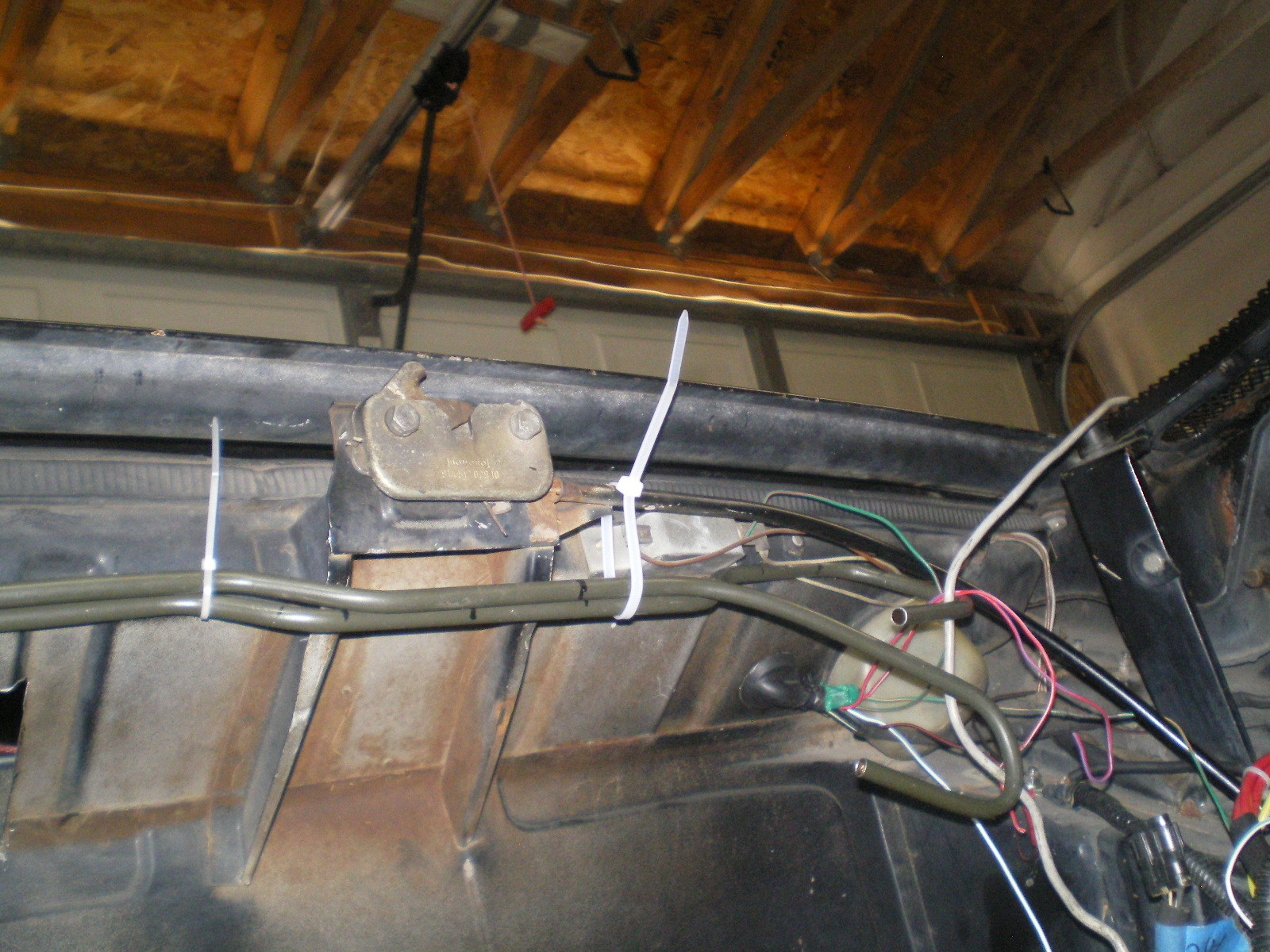

Strapped up my cables
and strapped the steel fuel lines with Adell clamps. The $11 I spent on these lines saved me $65 on 30R9 hose which needs to be replaced in time also. (IMG:style_emoticons/default/biggrin.gif)

Nice clean-up on the wiring (IMG:style_emoticons/default/mueba.gif)

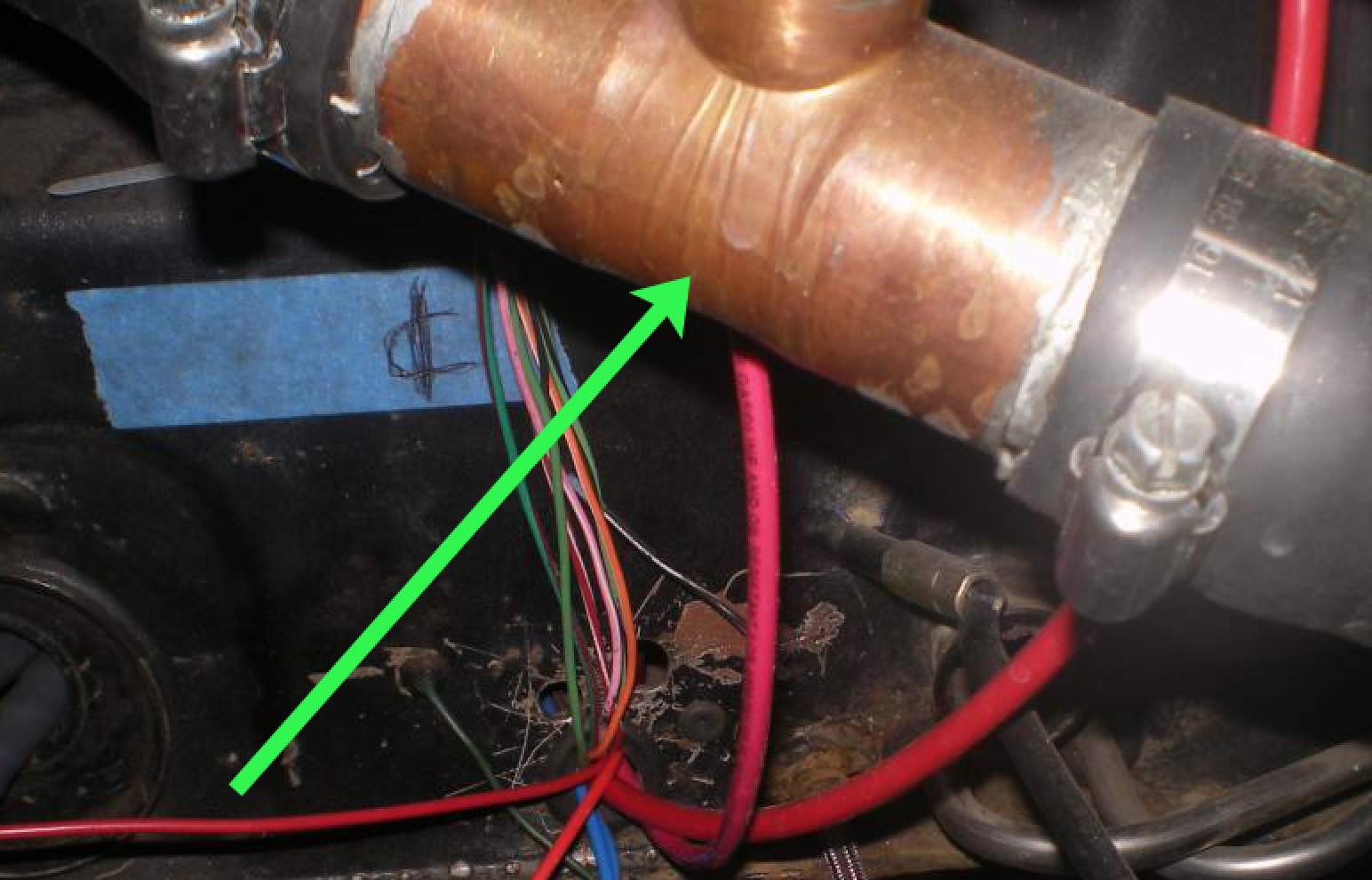

More info on this please!
I'm looking for how in the world I'm going to work the burp tank and fill lines.

(IMG:style_emoticons/default/av-943.gif) (IMG:style_emoticons/default/lol-2.gif) OK...........I'll go take a few shots. I wasn't going to post it until I finalized the "plumbing" because the use of materials shall change drastically. BRB

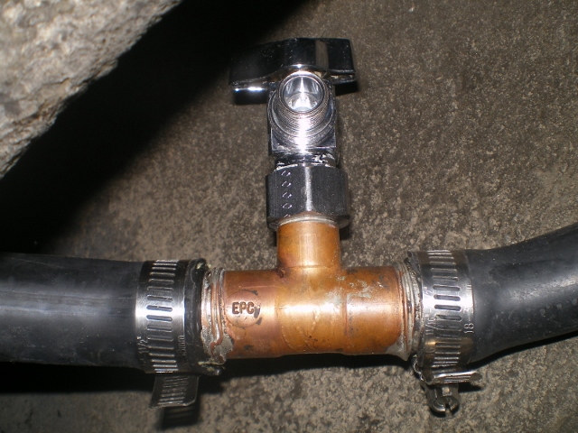

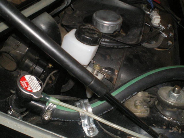

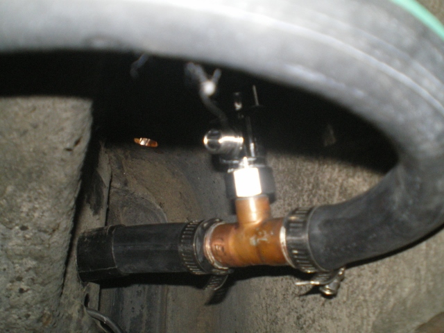

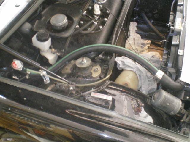

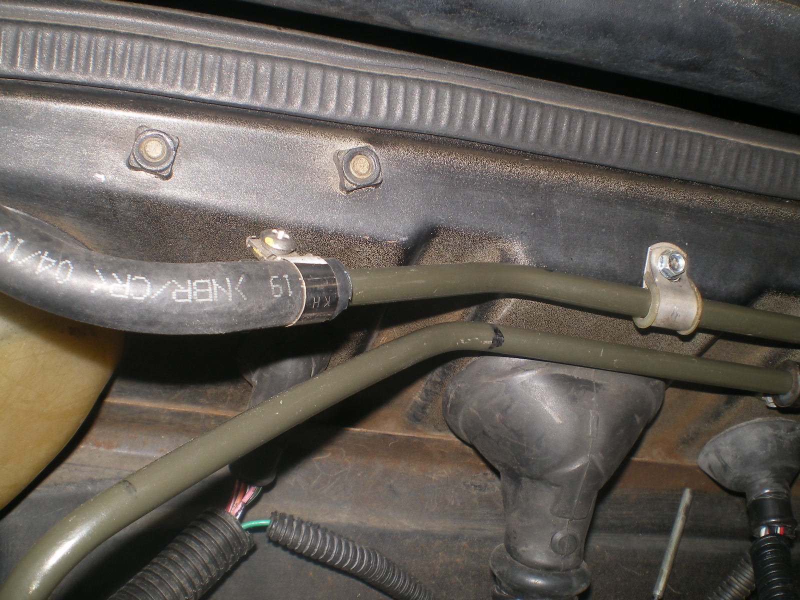

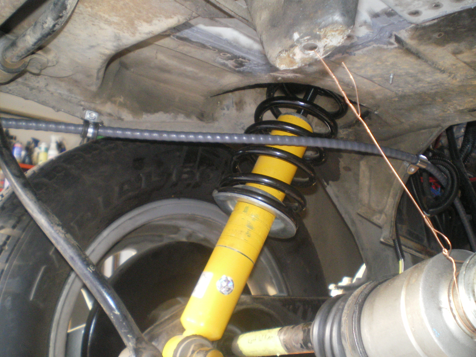

I think you can see why I wasn't going to post this. (IMG:style_emoticons/default/av-943.gif)
This is another shot of the drivers side. Note the antennae hole and that the pipe is beginning to go back downhill as it passes thru the fenderwell. This is the high spot on the L side. Also, this tee and angle stop will be replaced with a .75" Alum coupling tapped w/ a 1/4" ball valve w/ a screw driver slot rather than a handle. I put the drivers side vent here because I did not want ANY water leaking onto the fuse block below and inside.
The R side is different and should be able to vent out thru the fill cap but I may have to loosen the pipe clamp that holds the hose down in order to raise the pipe 2" or 3" when venting. On my EZ30, the outlet hoses have enough flex that I can lift them if necessary.(That is the Tee you referenced )There's a pic of that here a few pages back. I don't know how yours exits the engine so I can't help there.
The high spot on the R side is where the hose goes over bulkhead. That spot is about 2" higher than the fill cap.

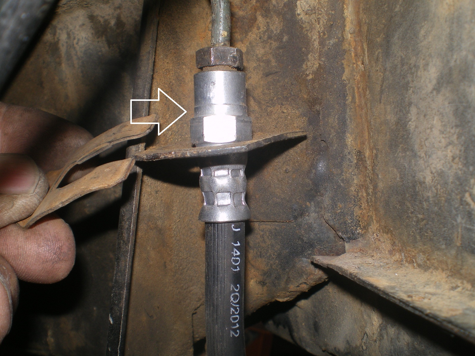

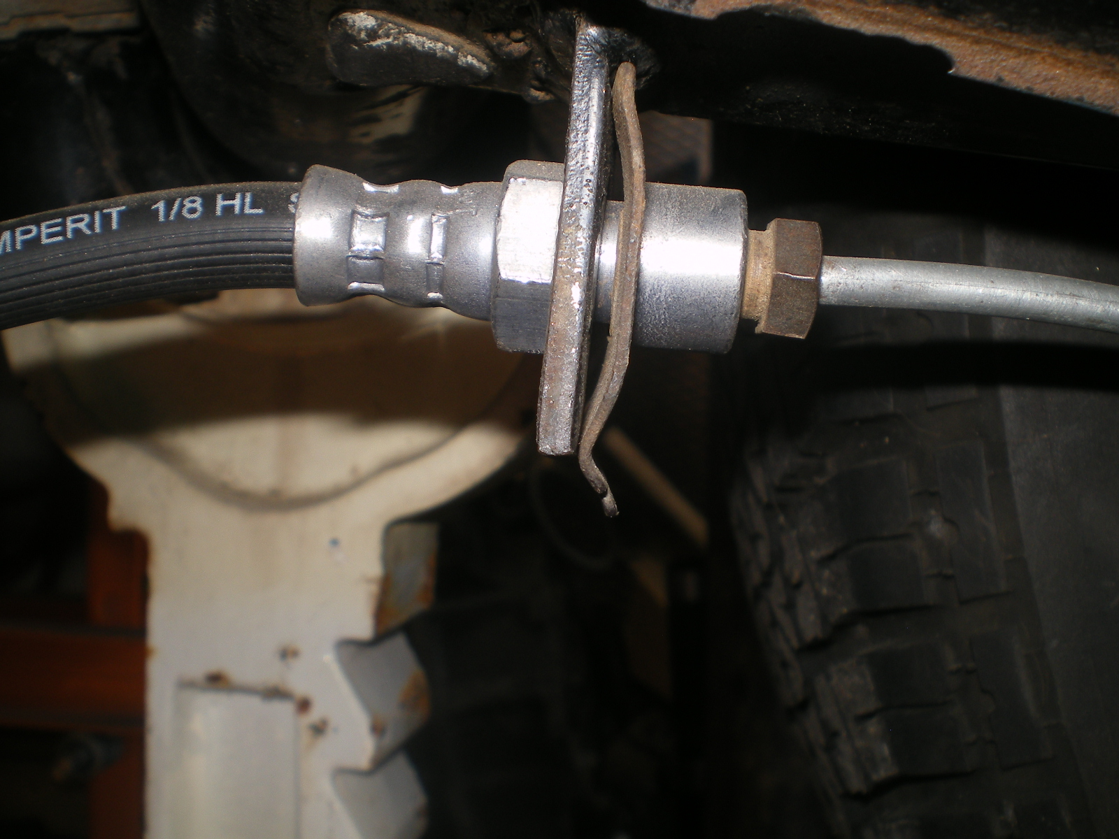

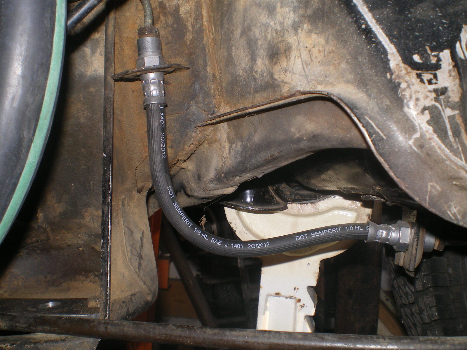

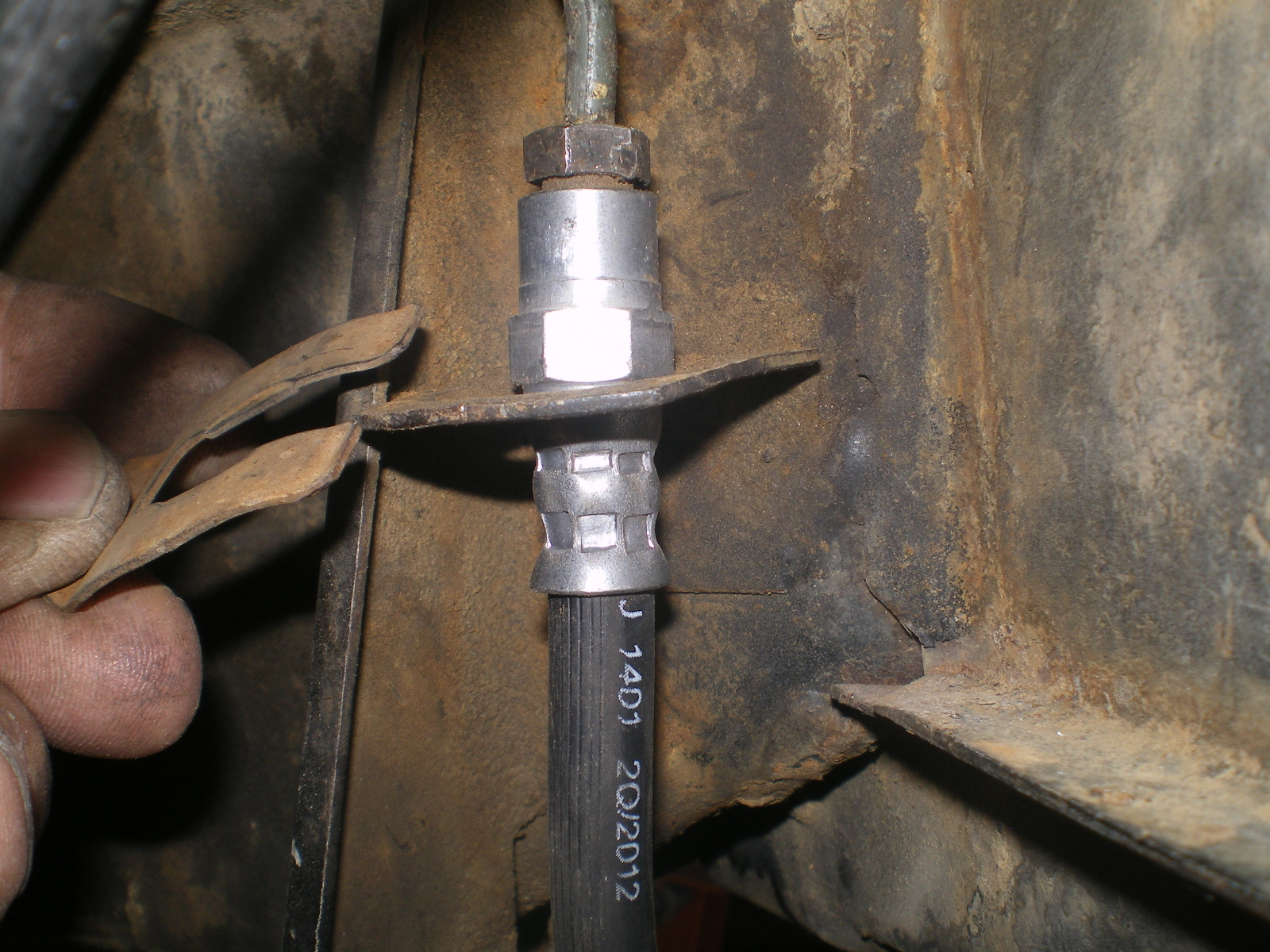

One of the things on my punch list. My brakes lines are bled & fitted up but I'm missing something. I tried to explain this to Erc @ the G&R Event w/o results but then again a pic is worth a 1000 words. Hopefully this will be clear. During the conversion I replaced all the brake items. The PO had used some small SS flex lines which I replaced. They were of a different size and IIRC they had a small union which received the curved washer/clamp. With this set up the upper piece will flop in the hole because it isn't secured. What did I do wrong here? What do I need to order and where do I get them? It should secure like the other end in the last pic, right?

The last pic is how it ought to be! Coming along!

I think you have that hose in slightly wrong on the top connection my brother. Need to move it so you can clip that piece into the little ring like the lower one.
The hex bolt needs to be on the other side of the bracket like the lower one is. Make sense?

Well it will pull down enough that the nut is below the bracket but if I slip that clip over it it will just pull down further. In other words I could pull it down another 6" but it would bend the tube above it. Is it possible the hole in that bracket was drilled out by the PO and is too large. What is supposed to keep it from pulling thru? (IMG:style_emoticons/default/WTF.gif) Heeeeeelp.

That doesn't look right.
I'd put a hose clamp in the bottom part and then use one of those C clips to keep it locked in place. Or, just the hose clamp.
I have SS lines without the flanges in front on mine and that's how I ended up having to do it too.

QUOTE(76-914 @ Jun 18 2014, 06:26 PM) *
So that hex bolt will go through the hole? I think the hole is too big or that hose is slightly different than stock. Did the old one fit OK? You could try a very thin washer but that clip pretty much fits the indented space exactly... How about a little JB Weld to close the hole up a bit? It's be plenty strong for that and might be easier than welding it up.

I think I'll ping Erc. It's all his stuff so I'm sure it is standard and correct.

Could you have the front and rear lines messed up?

Shit if I know but I don't think so. Everything up front fits fine. Right now I'm prepping for the embarrassment that will come once Erc or someone shines the "dumb ass light" on me. (IMG:style_emoticons/default/bootyshake.gif) On a brighter note, I received my fuel hose from Chris today. I'm in SoCal & Chris is on the opposite corner of the good old USA. I ordered Monday nite and received the order this morning. That's fast!
