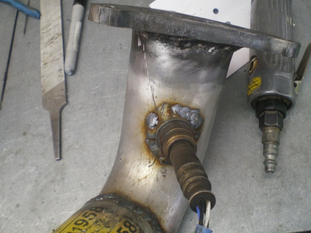

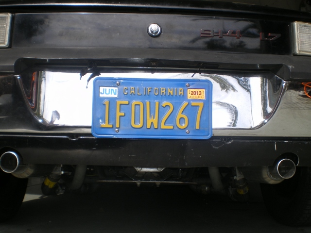

I received the missing reducer and 02 bungs so I was able to finish the exhaust system today. I welded in the bungs, screwed in the 02 sensors and began assm.

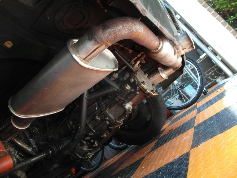

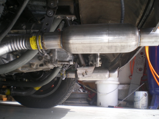

My mufflers and hangers

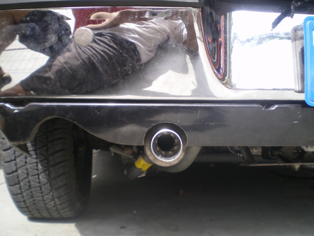

And with the bumper installed. I'll add some tips later but this is it for the exhaust now.

Nice work! Howzzit sound with the shorty glasspacks on there? (IMG:style_emoticons/default/popcorn[1].gif)

Those pipes look amazing! How did you get them placed so well?

To answer your question Ross; time and luck. I spent several hours with this because "it shows". Once I was satisfied with the left bank I duplicated the measurements for the right bank.

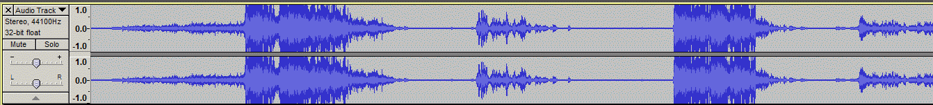

And here is what it sounds like. My comp skills are lacking so I'll just post the links. A real throttle cable should arrive next week then it's drive time and start shaking out the bugs. I'm not finished but getting closer.
https://www.youtube.com/watch?v=Y34k42Ck_20...eature=youtu.be
and
https://www.youtube.com/watch?v=zruK06mQbIA...eature=youtu.be

Sounds great! (IMG:style_emoticons/default/smilie_pokal.gif) Are the fans in front really that ratty sounding or is it just the audio quality? Sounds like they're on their last legs!

LOL. No they aren't. They're new and quite. It's just echo audio in that part of the garage. I love that big assed alternator on that thing. It can handle any load. (IMG:style_emoticons/default/happy11.gif)

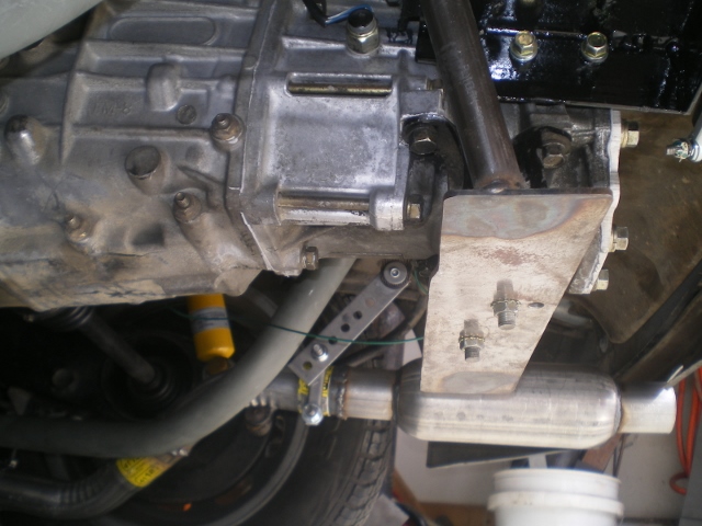

BIGKAT_83
post Aug 4 2014, 11:53 AM
Post #480
Posts: 1,800
Joined: 25-January 03
From: Way down south Bogart,GA
Member No.: 194

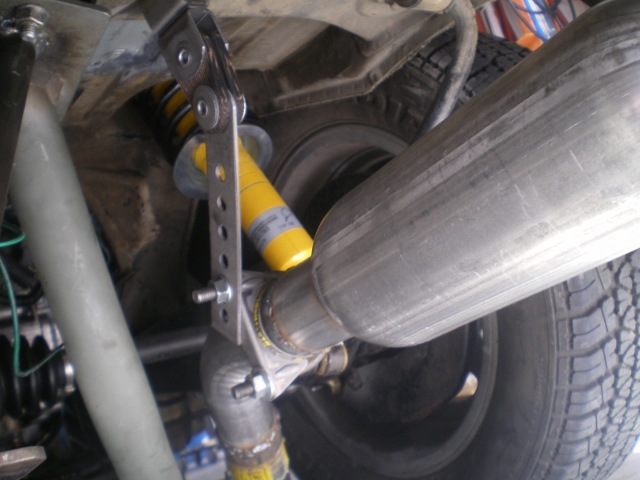

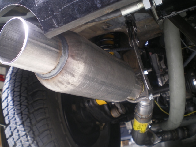

Kent.... here is how I did my mufflers. At cruise this is as quiet as my wifes Camry.
When I'm at a stoplight I have to look at the tach to make sure its still running.
From the rear
Under
