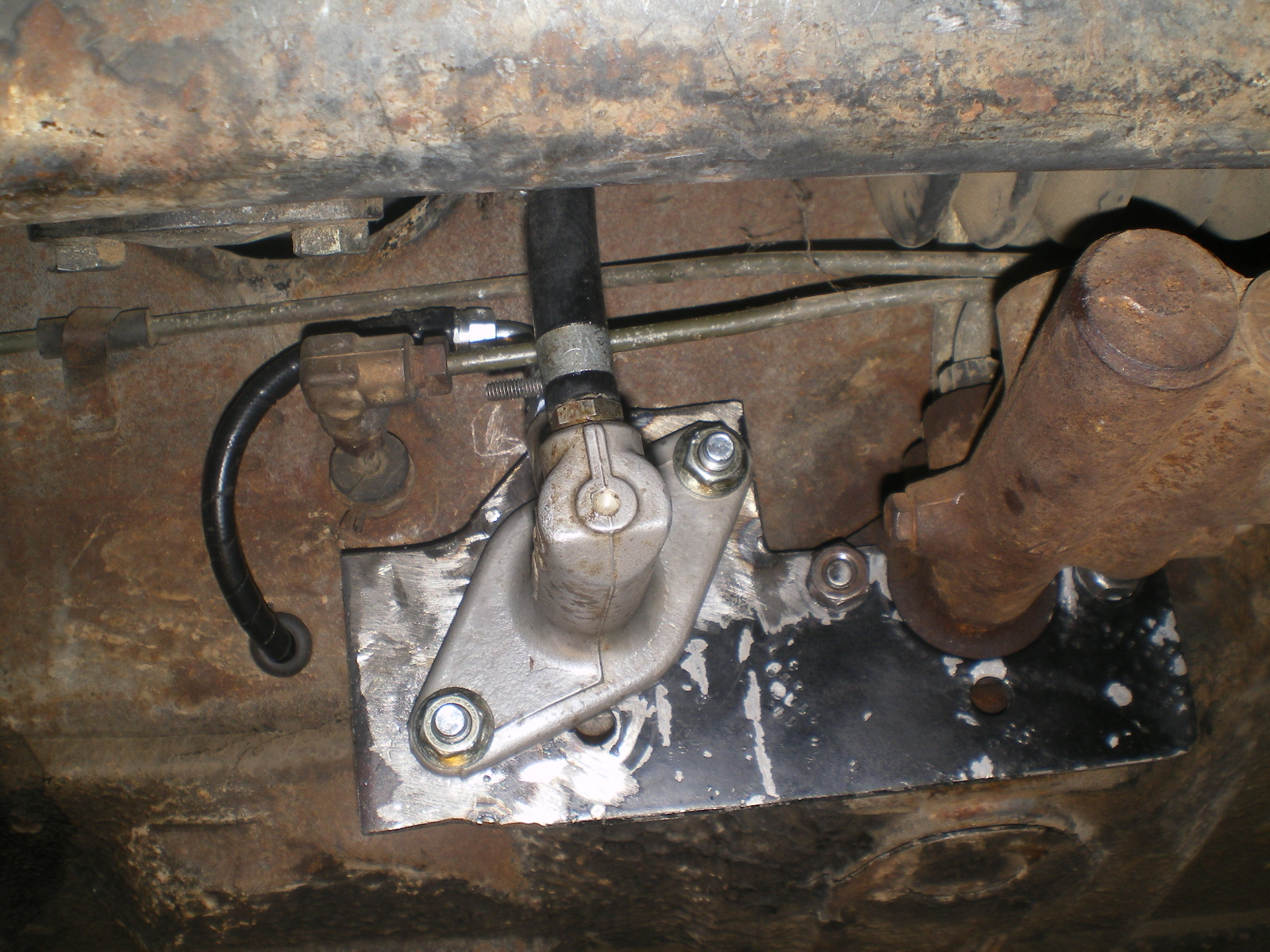

QUOTE(CptTripps @ Jan 15 2014, 10:31 AM) *
There are a few dimensions I'm missing, but I think I have it overall. Would you be kind enough to print this out and see if it matches the real piece you have?
I don't have dimensions for:
- Small Hole Diameters
- Distancees for A, B, C, D and E
This should be 210mm from side to side when you print it out.
It appears that,
D=52
B=probably 60
A=57
C=50
E=67, but doesn't appear to add up, looks too close to the edge for that, if 91 MM is C to C, and 210 MM is the OAL?
Small diameter holes would probably be whatever the bolt sizes are that hold the MC.

If you received a Master Cylinder plate from me I have important update information. First, the 3/4" Wilwood will work but it is very hard to push. Also, Chris and I had "sealing" problems with their reservoirs. I had to pull my tank to clean beneath it after mine leaked. (IMG:style_emoticons/default/barf.gif) Anyway at Chris' suggestion, and I'm pretty sure he stole it from BIGCAT83 (IMG:style_emoticons/default/dry.gif) , we tried a 5/8" Honda MC. It requires some quick modifications to the plate which I'll post here with detailed instructions, in the next week. If any of you feel uncomfortable with DIY then send it to me and I'll do it for you.
Another very positive experience with one of our vendors, Terry Cable. The first accelerator cable sent was bass akwards of what I ordered. When I called they said no problem and 4 days later, here it is. They are a very personable, customer oriented business. It arrived today and I put that puppy on tonite so that I could try the new clutch setup. That and to finally "put my foot into it"! (IMG:style_emoticons/default/calvin.gif) The clutch motion requires no effort and is smoother than greased owl shit. It shifted so nicely I took it for a quick spin (IMG:style_emoticons/default/driving.gif) on a country road behind us. I now have 6 whole miles on it; 4 tonite. A big positive is that I'm not experiencing any cooling problems at all (IMG:style_emoticons/default/biggrin.gif) , yet (IMG:style_emoticons/default/dry.gif) . I need to install a burp tank as I lose about 4oz's after it shuts down but I just top off before starting it. That short run tonite made every (IMG:style_emoticons/default/sheeplove.gif) hour of the project worth it. (IMG:style_emoticons/default/smilie_pokal.gif) Even the wiring. (IMG:style_emoticons/default/blink.gif) Damn that is some fun. You want to kinda aim that thing before you goose it. (IMG:style_emoticons/default/yikes.gif) I'm not complete by any means but I think I'm out of the forest. (IMG:style_emoticons/default/dance.gif) Time to install the interior and buy those OEM side mirrors that I'd promised myself if it ran. I wonder if RRC would be pushing it. (IMG:style_emoticons/default/lol-2.gif)

[quote name='76-914' date='Aug 14 2014, 08:14 PM' post='2074062']
If you received a Master Cylinder plate from me I have important update information. First, the 3/4" Wilwood will work but it is very hard to push. Also, Chris and I had "sealing" problems with their reservoirs. I had to pull my tank to clean beneath it after mine leaked. (IMG:style_emoticons/default/barf.gif) Anyway at Chris' suggestion, and I'm pretty sure he stole it from BIGCAT83 (IMG:style_emoticons/default/dry.gif) , we tried a 5/8" Honda MC. It requires some quick modifications to the plate which I'll post here with detailed instructions.
Is this reservoir leaking an isolated case, or are there others that are experiencing the same problem, along with hard pushing of it?

Do you have a link handy with the picture of the MC you are referring to?
BIGKAT_83
post Aug 16 2014, 03:14 AM
Post #496
Posts: 1,800
Joined: 25-January 03
From: Way down south Bogart,GA
Member No.: 194
[/quote]
[/quote]
I had posted it on page 11 of this thread.

Hard to see in the pic, being painted black, but is this even remotely close?
http://www.ebay.com/itm/New-Brake-Master-C...e54&vxp=mtr
What year of Honda?
BIGKAT_83
post Aug 16 2014, 07:57 AM
Post #498
Posts: 1,800
Member No.: 194
No, not even close.....Thats a brake master cylinder for power brakes.
The clutch master cylinder I posted is the aluminum one on the left.
[/quote]
Yep, I'm sure others will chime in at some point. After I thought about it I realized it's just common sense. If both ends are = in diameter then it is the same thing as you sitting behind the trans pushing the clutch fork in with your leg. No mechanical advantage. Remember the old 3 sp English bikes that came with a tire pump clipped to the cross bar and how skinny it was. Those tires took a lot of pressure and the fat pumps we used for our Western Flyers wouldn't do it. Chris said the Honda MC on ebay was only $29 used. I have one and it works great. Another plus is you won't have to cut the belly pan to accept it like the Wilwood required. I'll doc it all here is a few days. I'm waiting on some more parts to do Chris' so I'll shoot pic's then.
[/quote]
If the Honda MC is 5/8, I get the feeling, I will not be happy with the .700 bore Tilton that I have. Like everything else, I started liking the Honda MC more and more after I payed good money for the Tiltion.
