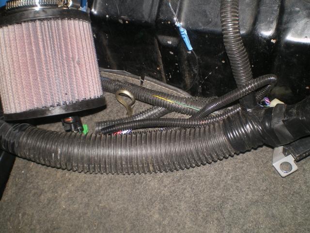

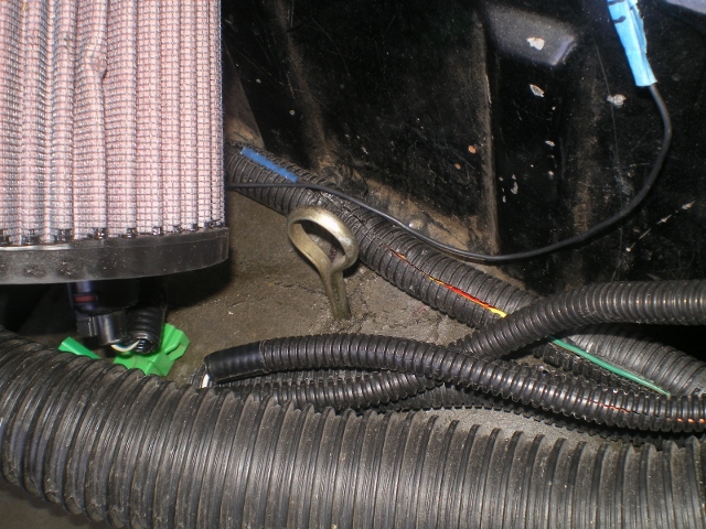

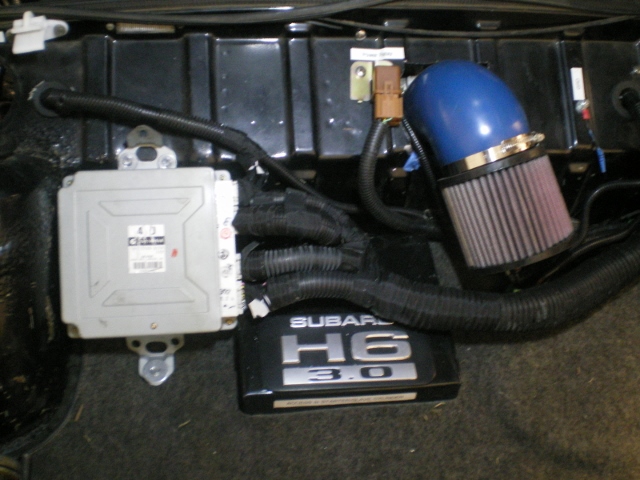

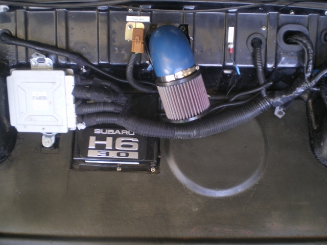

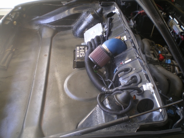

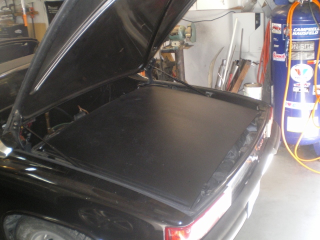

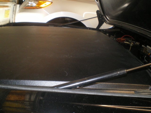

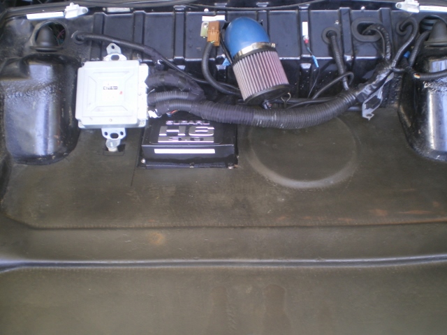

I threw in the rear carpet and liner after trimming to fit around some items. It will look much better with new carpet but that will come later. I will need all new rubber seals, carpet, paint, tires n wheels to get up to speed but this is good for now.
The best part was this; the top fits in it's OG location. (IMG:style_emoticons/default/piratenanner.gif)

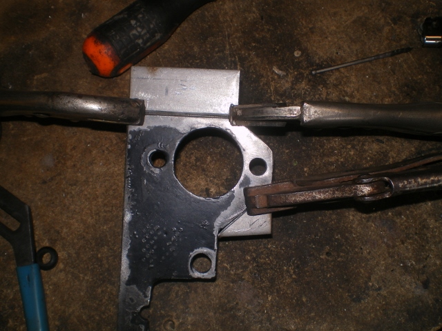

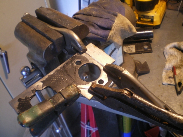

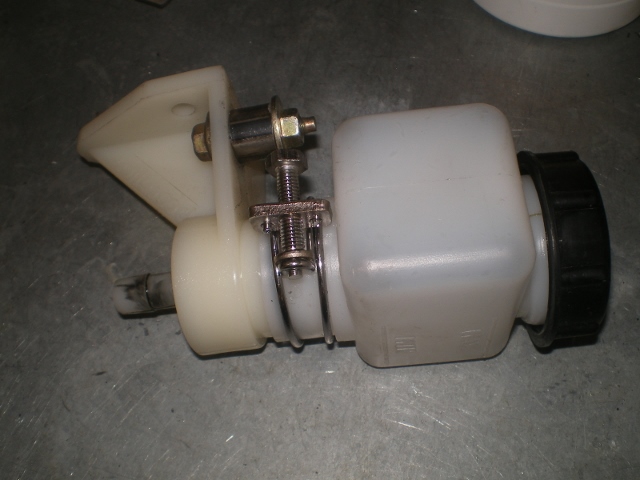

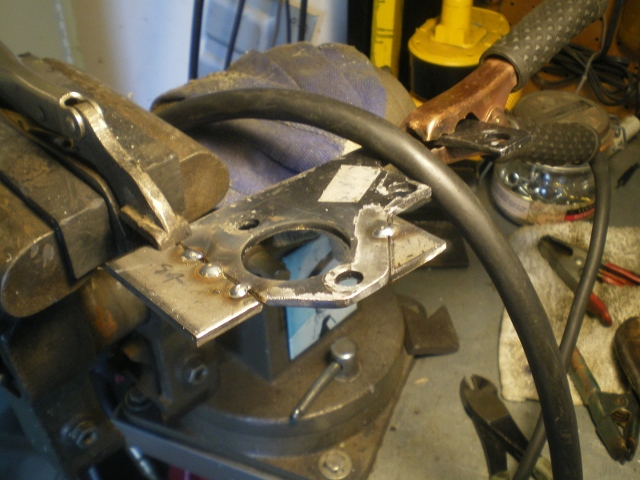

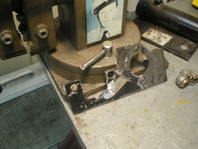

Might as well start posting some pic's on modifying the plate. Keep the bolts/nuts you used to mount the Wilwood MC to the plate. They are the same length/diameter. I cut 2 small tabs and beveled the edges before welding. You will need to grind it flat afterwards so the bevel is structural. Clamps them in place then move around with your spot welds, remove the clamps and weld. Then grind it smooth as shown.
**** More when the MC arrives.......
This is a good time to point out what I believe is a poor design with the Wilwood reservoir. The inner piece which holds the "single o-ring" isn't strong enough to withstand the forces placed upon it by the clamp. As it gives the piece takes on a tapered shape pushing the reservoir up and away from the base. Notice the 6mm gap? As it pushes up, the o-ring ends up below the hose clamp as you can see in the 2nd pic below.

I think I recognize that plate! Dang that looks nice.
Yeah totally agree on the reservoir o-ring. It's the same on the MC itself. And if you use a pressure bleeder you won't like what happens AT ALL.
Trunk is looking good Kent! I think I will use your half-canister to cover my starter and clutch MC holes in the trunk. Bunch of seal sealer and paint and it'll be barely noticeable.
I don't know if it would be a good idea or not, but could a person use some of that purple gunk that plumbers put on pvc to glue it together, to seal it??
BIGKAT_83
post Aug 19 2014, 05:28 AM
Post #519
Posts: 1,800
Joined: 25-January 03
From: Way down south Bogart,GA
Member No.: 194
I've worked with six of the Wilwood reservoirs and have had no problems at all. You may be a little too tight with the clamp. (IMG:style_emoticons/default/sunglasses.gif)

I found the 2nd cover I made ( the black square one) allows for easy future repairs that the smaller one(s) did not.
No. That purple stuff is an acetone based primer intended for vinyl plastics and is not a glue. Dirko might possibly work but I'd need to read up on it, first.
The GA models are known to be of a better quality. (IMG:style_emoticons/default/happy11.gif) Honestly Bob the unit leaked before the tightening began. True the reservoir rose as it was tightened but I could not find a "happy medium" where it would not leak. Not crazy about that single o-ring design either.
