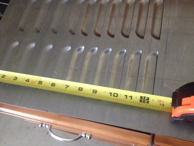

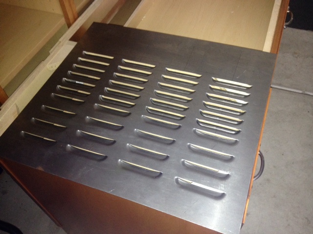

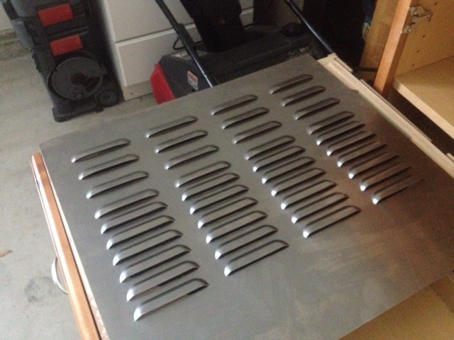

205/65 would be pretty fat and wide, I might be worried about rubbing (that's the weirdest thing I have typed in a while). 195/65 is very close to the original (tall) stock. Every brand is different though so check a few out unmounted before you get them installed.
Speaking of louvers (IMG:style_emoticons/default/piratenanner.gif)
Check out what I got done today:
oooohhh
aaaaahhh
other noises
Found the NICEST guy who punched some more louvers in my PM panel. He owns a one-man hot rod shop about 50 miles outside of the Chicago area (but 100 miles from me). Was doing some beautiful cars. All 1920's to 1940's stuff. His metal skills were amazing. Of course I left my phone in the car so no pics there (IMG:style_emoticons/default/headbang.gif) . Went from 16 to 40 total in a ~ 12.5 inch x 18 inch area. I also like the fact that the more concentrated ones are towards the back where most of the air will be exiting.
He said he would be willing to do more panels so maybe I'll do a group thing if there's a demand. Could probably do it for not much more than a Patrick panel but with about 3X the louvers.
OK Kent, I have 40, 4" x .25" louvers, what's my total exit flow area now? Am I at 2:1 if I cut the front out like yours but maybe not the upper bumper part? Just cut the holes into one big hole?
Edit: Duh, it's 40 square inches...I'll measure the inlet...probably NOT 2:1 but if I shroud it hopefully we'll be OK.

That panel gives you ~40sq inches. If your cut out is like mine (3.5" x 18") your inlet will equal 63". I've read but not confirmed that our target area for the outlet should = 1.7 x the inlet area.
63 x 1.7 = ~107 sq inches.
-40 sq inches
67 sq inches
So, if that 1.7 factor is correct you'll need another 67 sq inches. That being said, there are at least 5 unknowns that come to mind. First, is 1.7 factor an arbitrary number reached by someone? Was that figure for a LS1, 350 CI block, a 4 cyl Suby, a Ford 6 cylinder and so on? Where was that person's inlet and outlets located? What effect does hose size or routing have on this formula? Secondly is the location/placement of the outlets/louvers. IOW, are we placing the louvers in the lowest pressure area? The style of bumper that we use will greatly effect this location as well. I would think the louvers are most effective close behind the bumper where they ride in an relatively undisturbed slipstream. I suspect the air becomes quite scattered the further back one goes, which I'm sure has it's effect upon how efficient these louvers will be.
FWIW my total outlet area = 61 sq inches. So by following that formula I am 46 sq inches short or appx 43% undersized. As you know (Chris and I compare notes on a very regular basis), I'm very close, if not "at" the correct amount.
Alas, we may all be on our own until we standardize these installations and I don't see that happening unless people are willing to duplicate someones "correct" build.
I wish one of our AE's here was water cooled and could put the slide rule to this. A wind tunnel or raised flat bed truck + a 914 + some streamers and smoke pens would give the visual reference that my dumb ass would need. (IMG:style_emoticons/default/biggrin.gif)

Well I'm not sure if this will be enough but I'm planning to start by just cutting the holes up front into one big hole, so that's 2x18". Gives me 36 square in, 40 square out. If that proves to be inadequate I can cut out a section of the inner part of the bumper reinforcements. Definitely can get to 2:1 that way. I ordered the Renegade valance that looks like it scoops air in pretty well and then plan to make a ducting system like Ross's to push it back out. I think it will work fine.
76-914

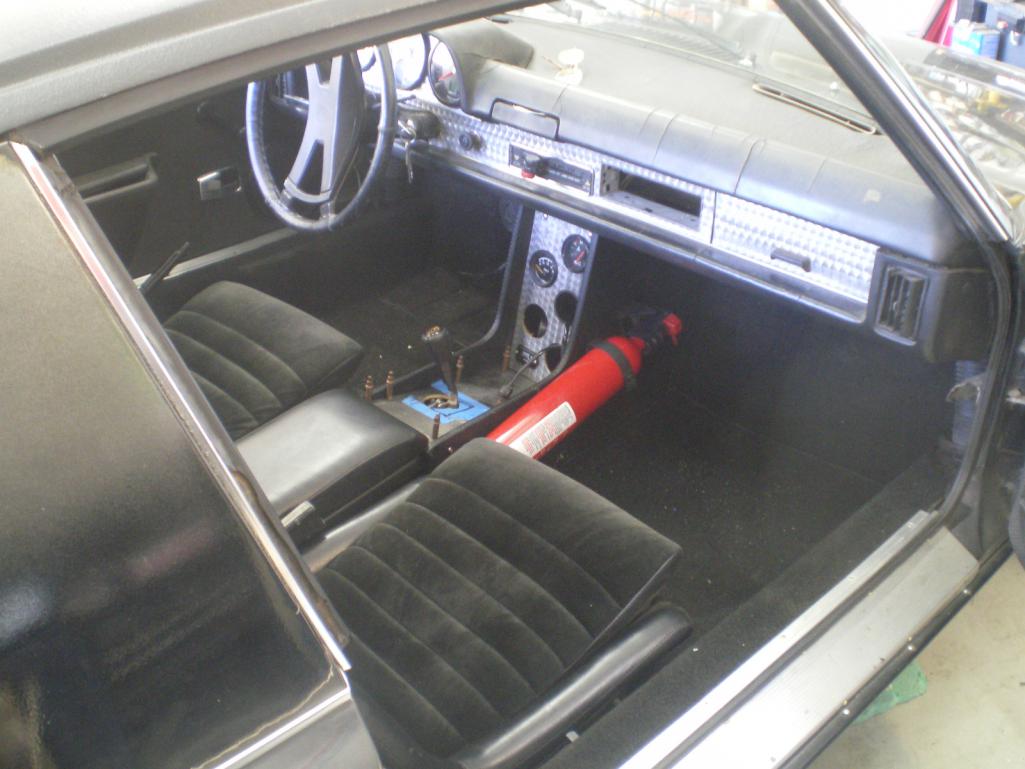

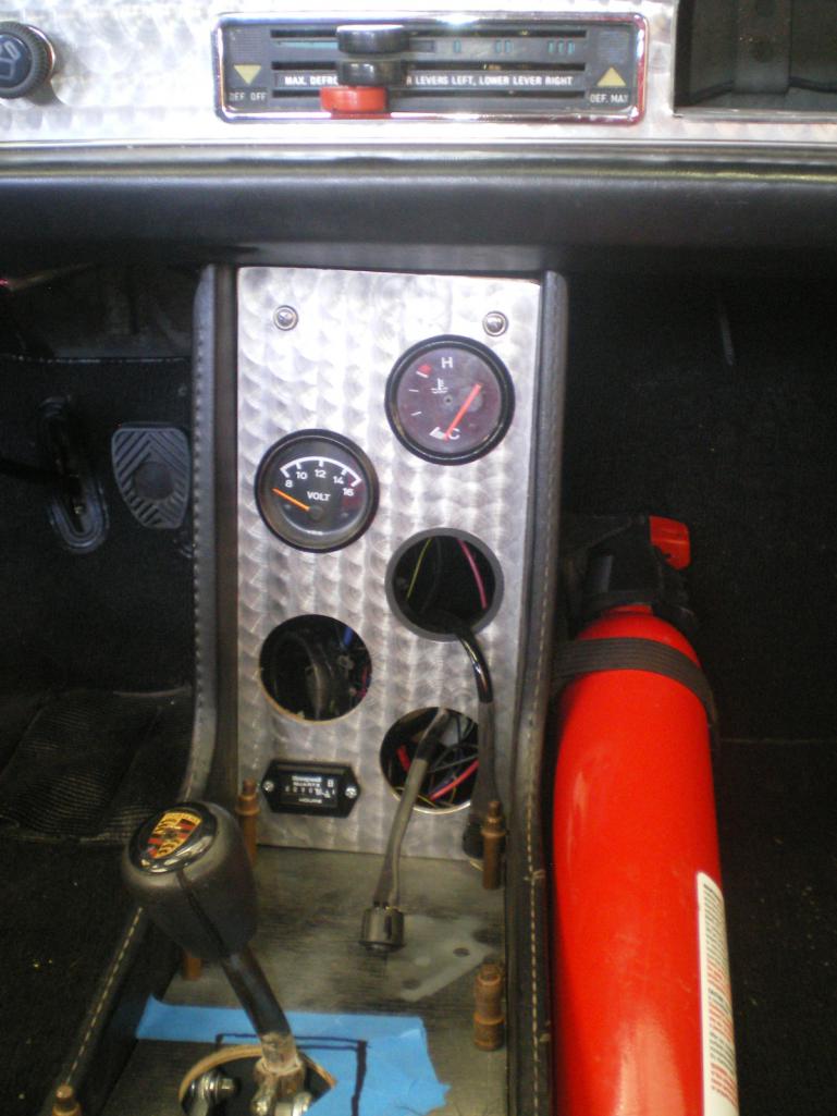

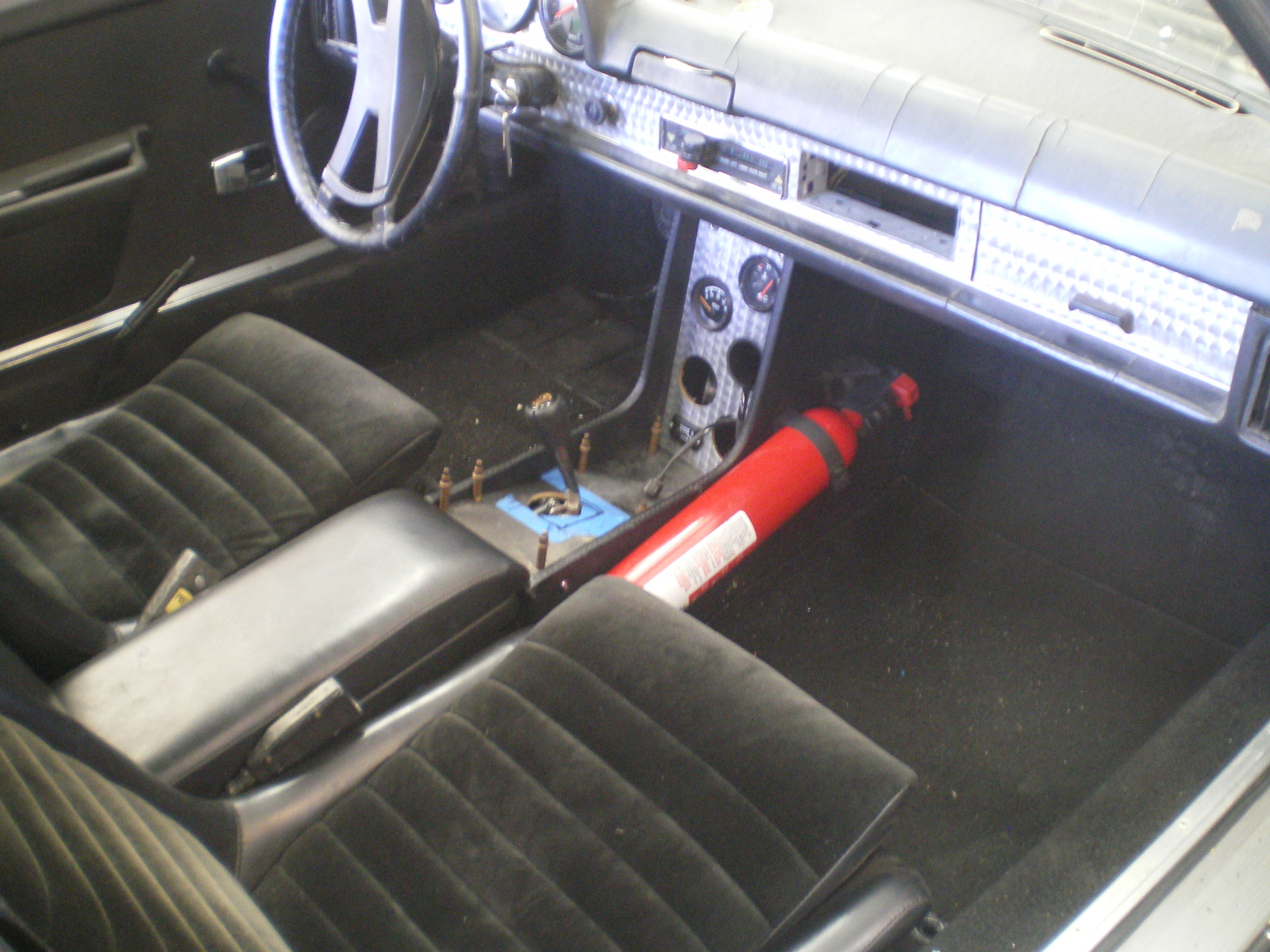

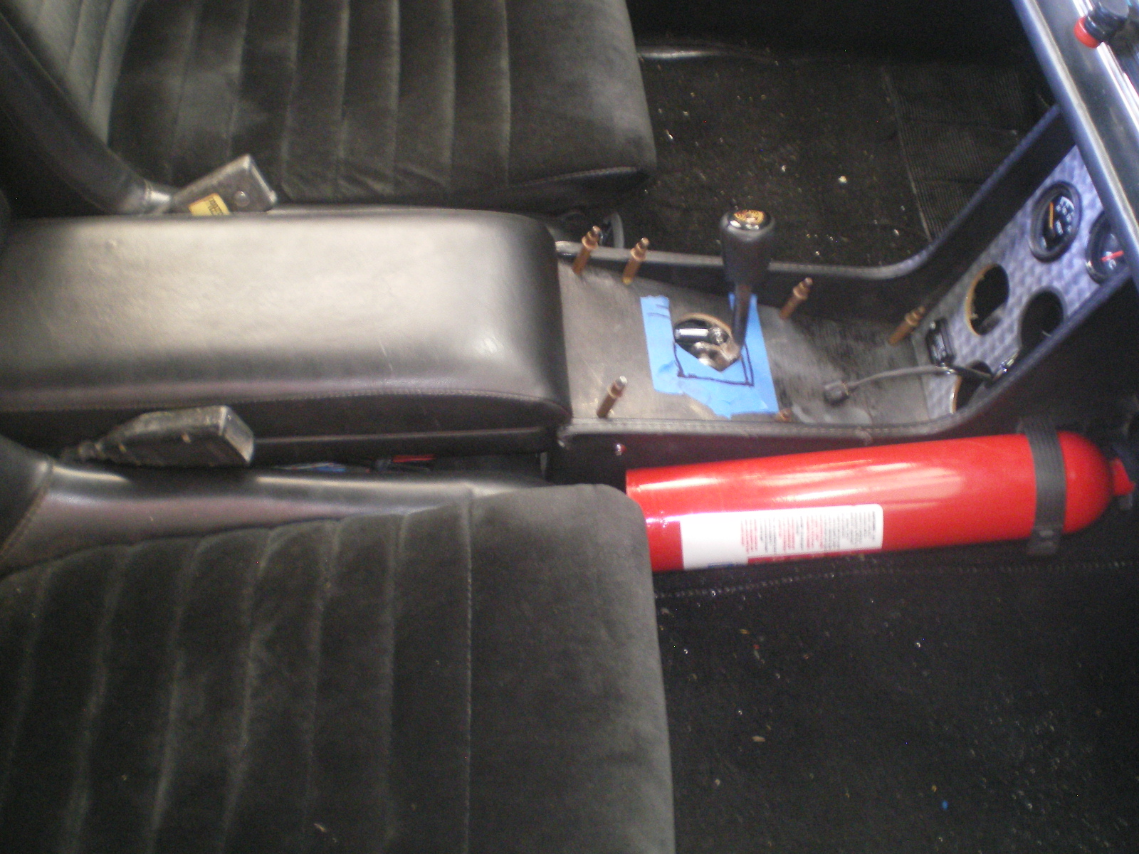

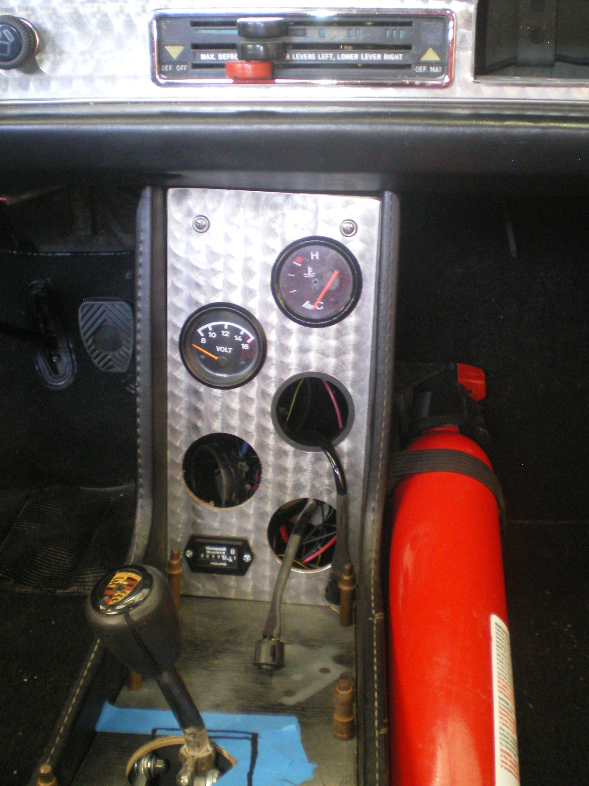

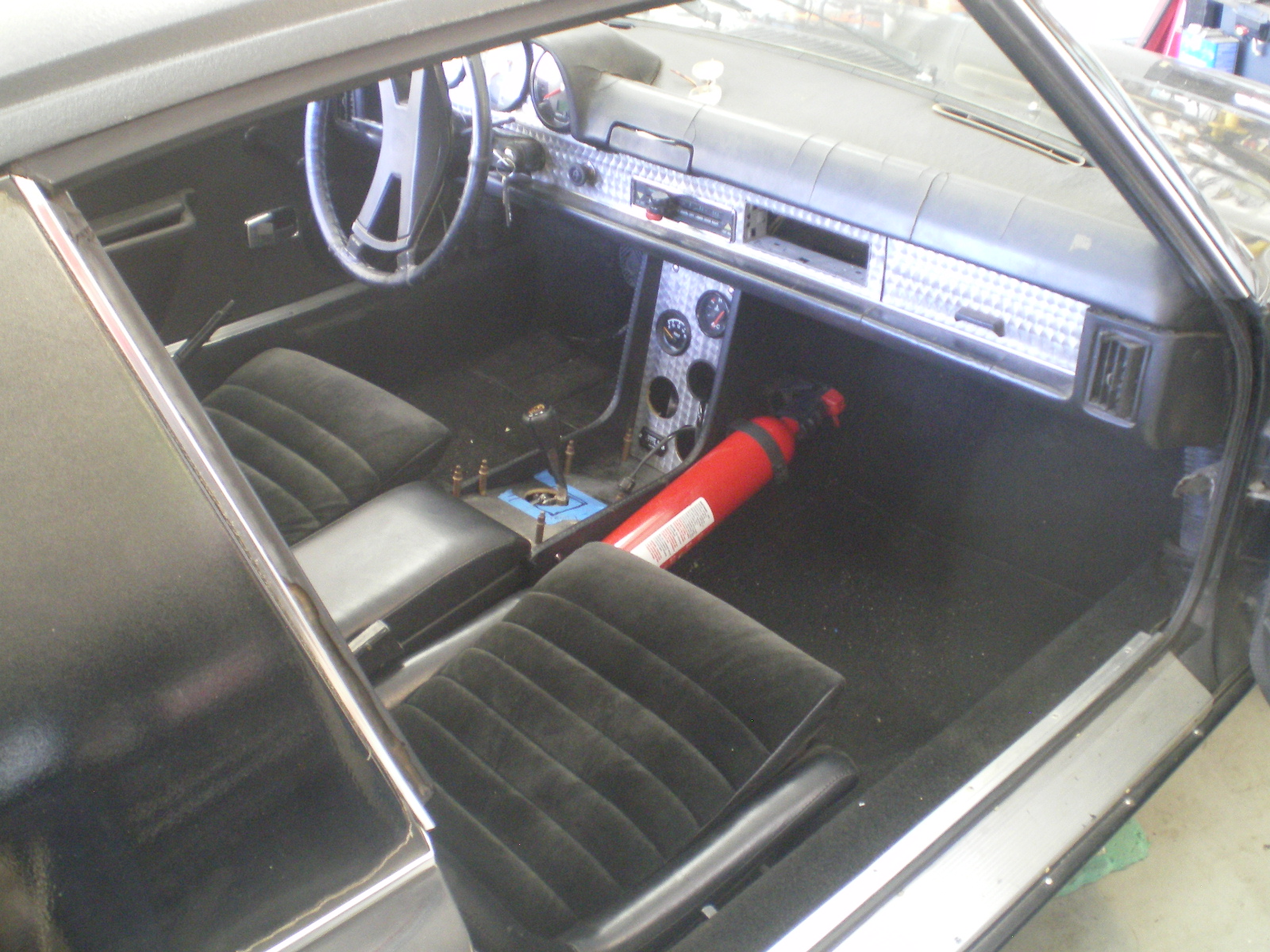

Toast is good people. (IMG:style_emoticons/default/grouphug.gif) Well, my Speedo died yesterday but no biggie. It's new. I had done a quick patchwork at the gage area that needed to be corrected. I wired in a 12v power outlet but it's not installed on the gage face plate yet. The CEL is also back there and waiting to be installed. Obviously I need to make another piece of the burled aluminum for the base plate. It will glue on the piece of plywood with a new shift boot. Use your imagination! Outside of the Burled Aluminum trim, it came out remarkably stock in appearance which is exactly what I had wanted. (IMG:style_emoticons/default/smash.gif)
Gone are the A/F gage, oil pressure gage, fuel pressure gage. One vacancy will be filled with the seat heater switches another with a courtesy lite and the 3rd hole with the 12v power receptacle. All of my ancient carpet was rejuvenated for $13 worth of Dupli Color Vinyl, Fabric and Carpet spray paint. Doesn't leave the carpet feeling stiff either. (IMG:style_emoticons/default/smile.gif) It does require vacuuming just like regular carpet though. (IMG:style_emoticons/default/headbang.gif) Anybody notice the missing radio? Not me. I can listen to that 6 all day long. (IMG:style_emoticons/default/wub.gif) The stereo is last on my list.
