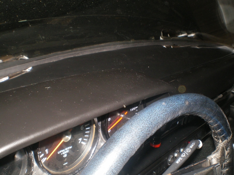

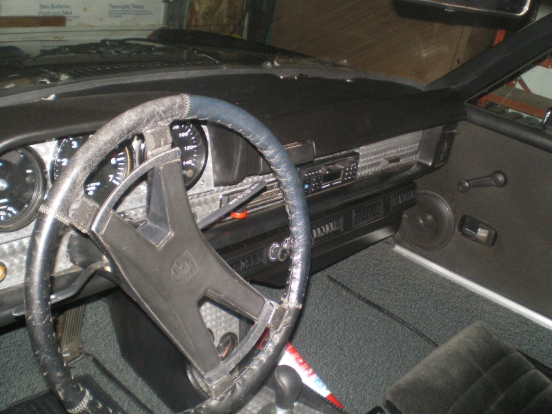

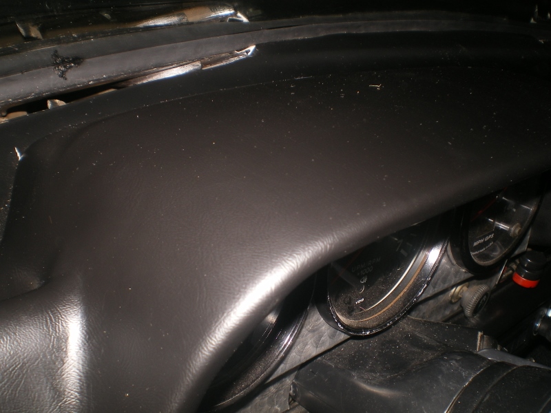

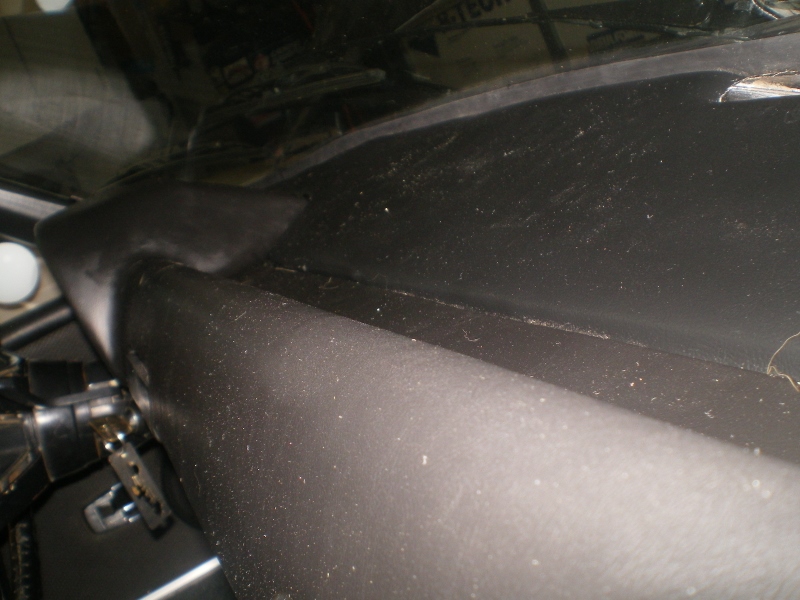

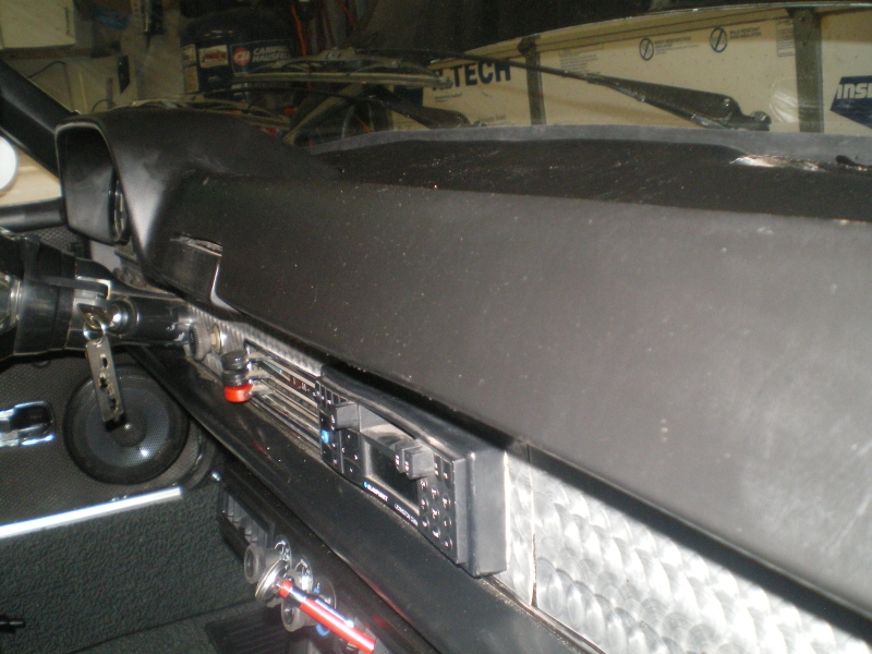

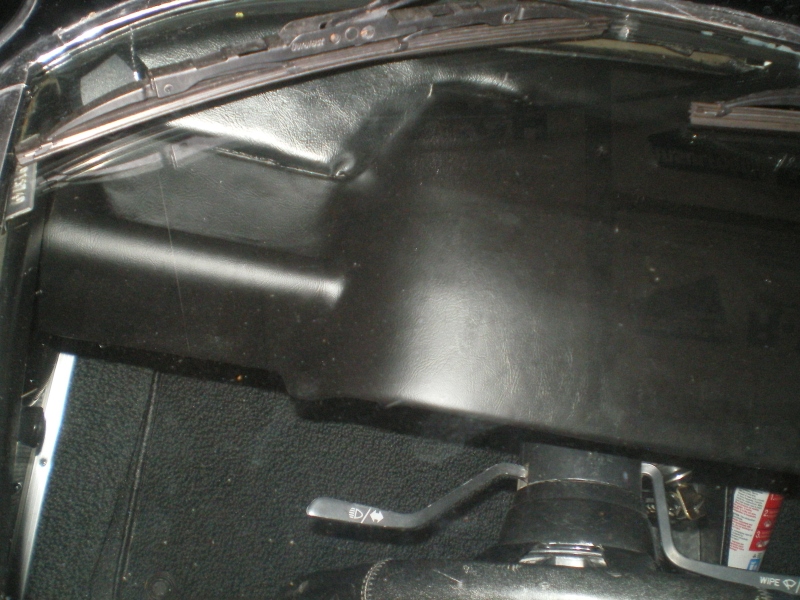

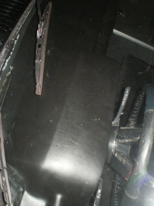

FWIW, Marks Dash Top appears to be an improvement over OEM as it is much more substantial. When each are held side by side, the OEM dash feels like a cheap imitation.

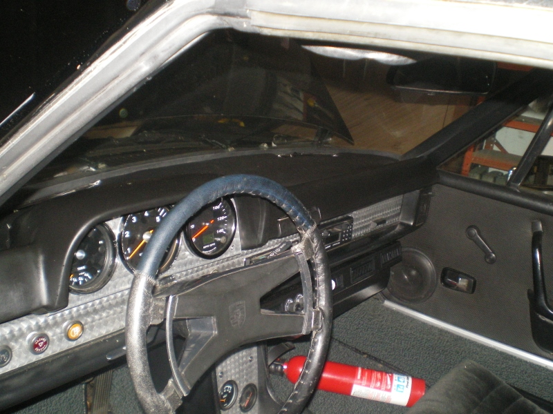

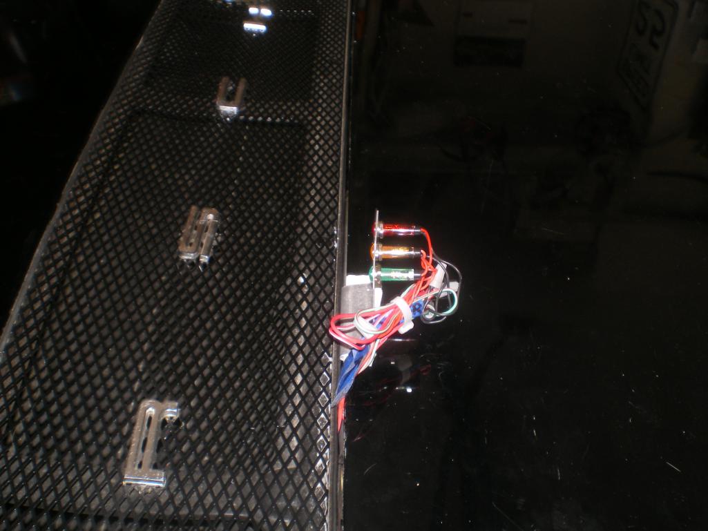

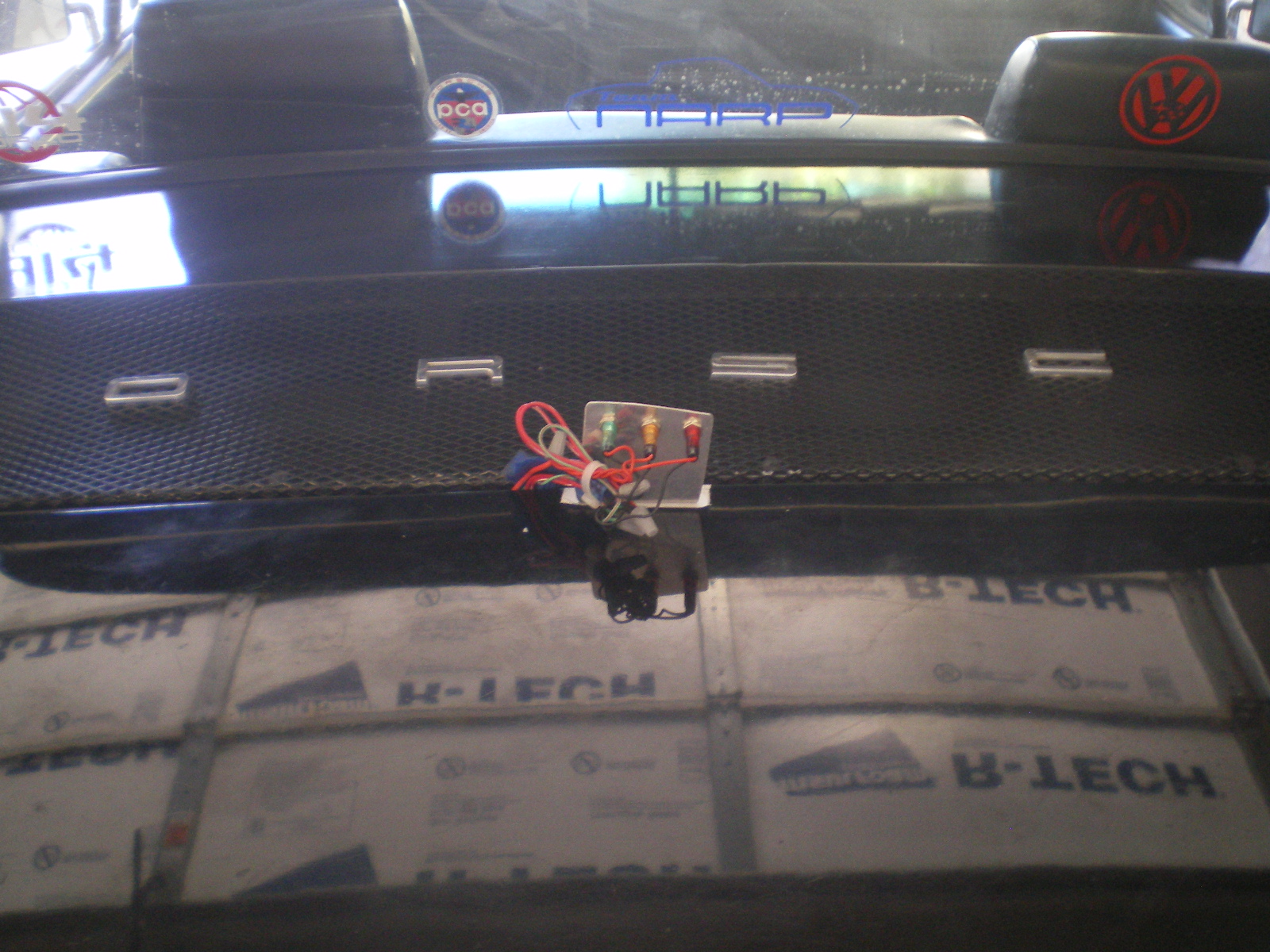

Damn, all this criticism of Marks product yet I forget to post some pic's of it installed. Those of you sitting on the fence should move on this. (IMG:style_emoticons/default/wub.gif) Anyway, here it is installed. Onward thru the Fog!

QUOTE(76-914 @ Oct 18 2015, 04:05 PM) *
Not criticizing Mark's products, just mentioned that my dash might be delivered with the 'patch' when it gets shipped (IMG:style_emoticons/default/shades.gif)
I've spent thousands for a lot of awesome products that Mark makes available to us (IMG:style_emoticons/default/aktion035.gif) ... I'm trying to get him to expand into the early 911/912 arena too (IMG:style_emoticons/default/idea.gif)

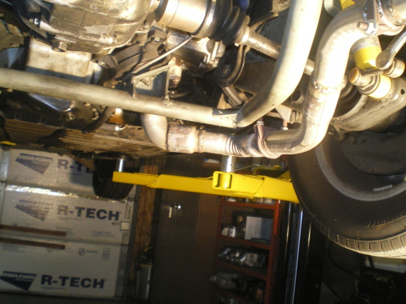

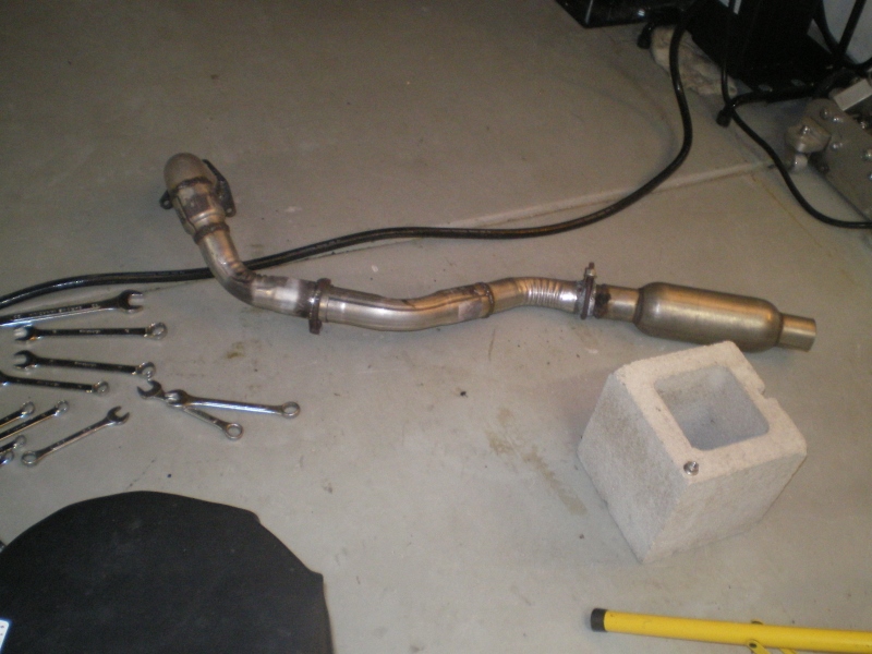

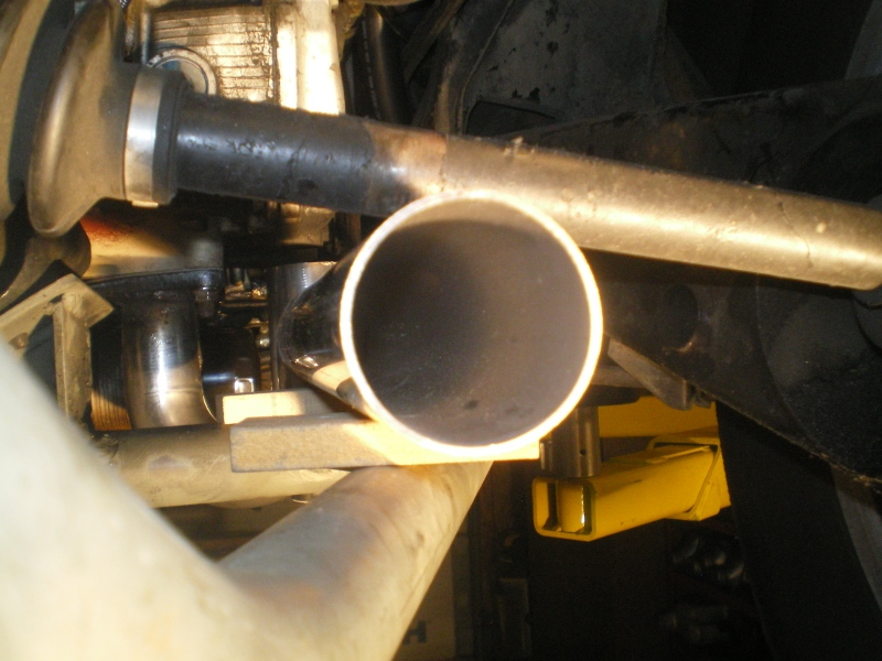

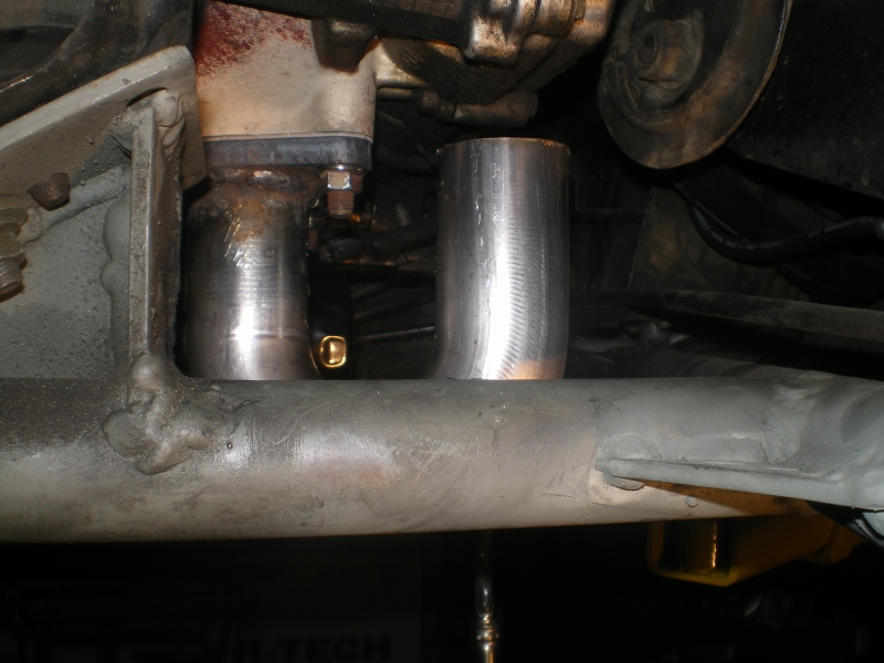

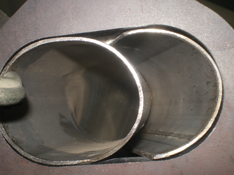

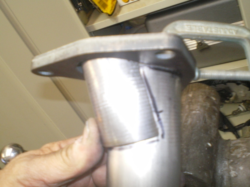

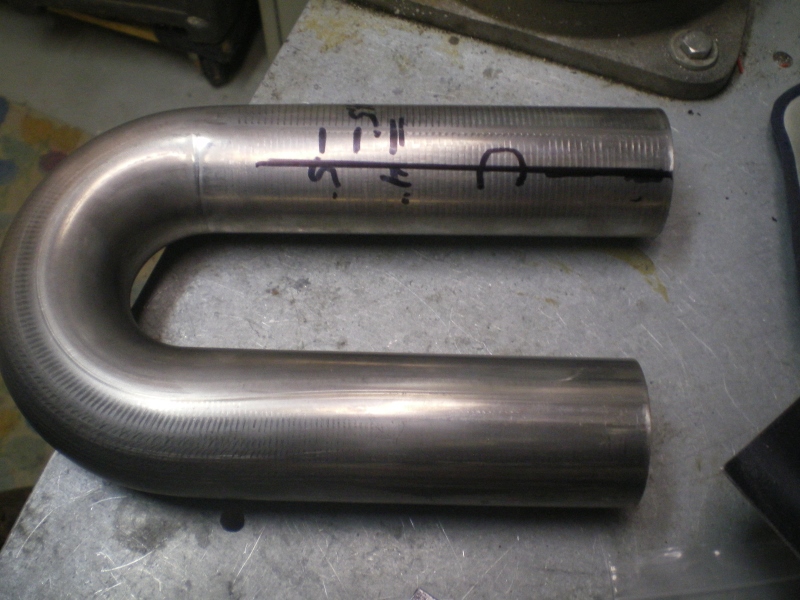

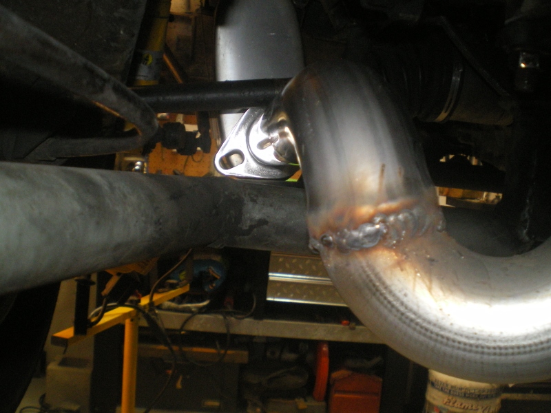

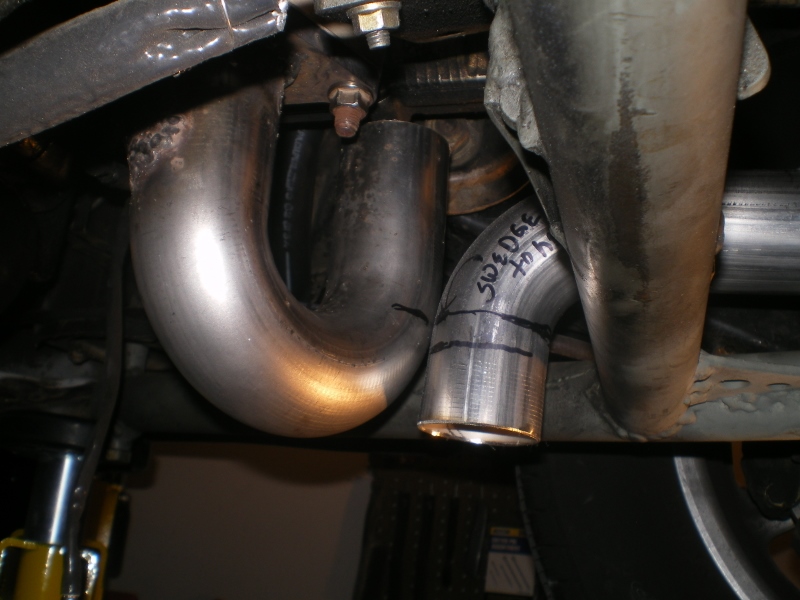

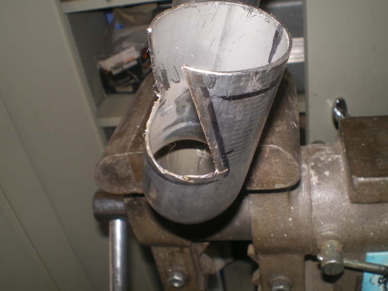

My new lift inspired me to replace my noisy and unacceptably low exhaust system. By using SS my product line triples and allows me to reconfigure the existing system thereby shortening it and allowing the use of a normal muffler. (IMG:style_emoticons/default/biggrin.gif)
Here you can see it runs beneath the engine cradle giving it just 3" ground clearance! (IMG:style_emoticons/default/blink.gif)
An entire side with the whopping 10" Glass Pack. At the time, there wasn't room for anything else.

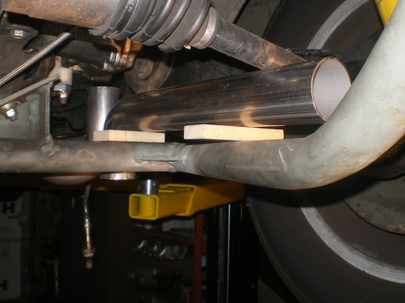

This is the piece that should allow me to change things around and shorten it up. A 2" 2r 180' or U Bend.
The 2" is too small so I will have to add a piece to fill the oval flange.
This piece will need to have one end expanded at the muffler shop manana.
I ended up with 1/2" clearance between the engine cradle and the drop arm when fully extended.
Here's the end that will need cut, expanded and welded to complete the sharp turn 90'.
If this works I'll order the pieces for the other side and the mufflers and flanges. Oh, almost forgot to say thanks to Mike (Mueller) for the SS wire. I owe you one. (IMG:style_emoticons/default/beerchug.gif)

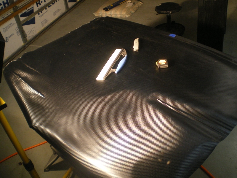

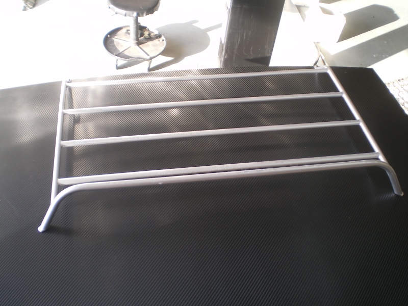

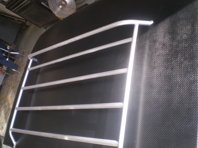

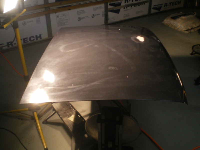

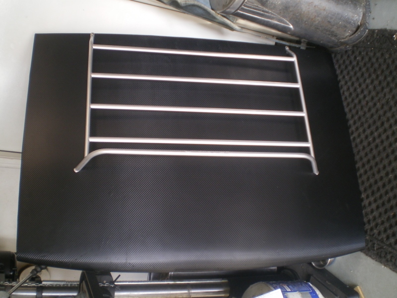

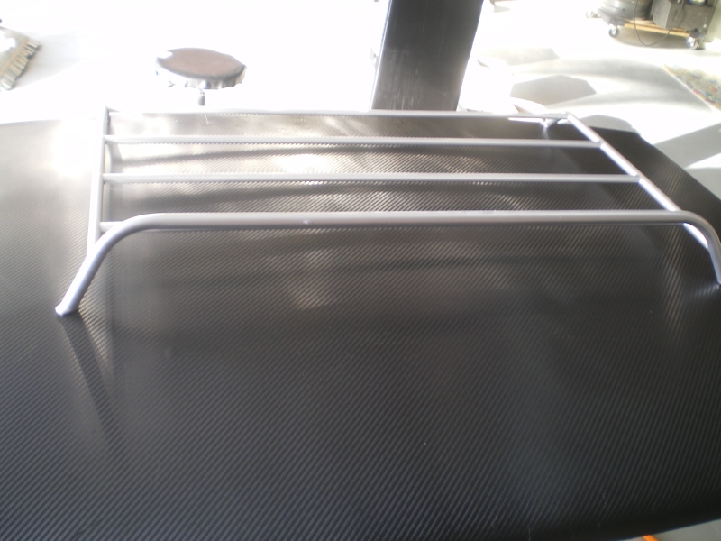

WCR convinced me that I did not have enough space when traveling with my wife. I bought the luggage rack from Steve a few months back. I still need to fab the proper brackets which are on the underside. Picked the lid up a couple of weeks ago from Ian, IIRC. The lid was from the 914 used in the "Wheeler Dealer" episode. Not that I give a Rat's Arse about that. The CF Wrap from Amazon for <$18. It's only use will be when we travel and I couldn't see dropping a bunch of $$ on this project or drilling holes in my existing lid.

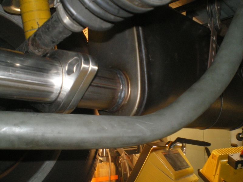

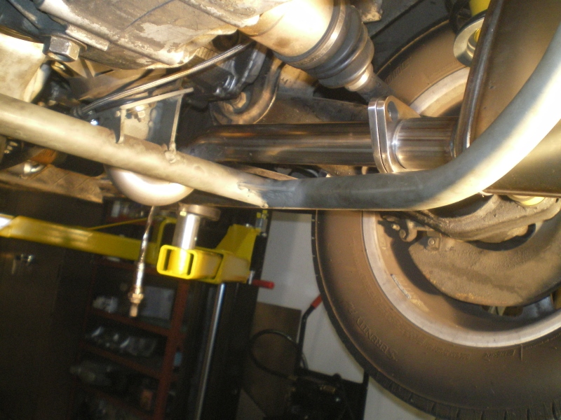

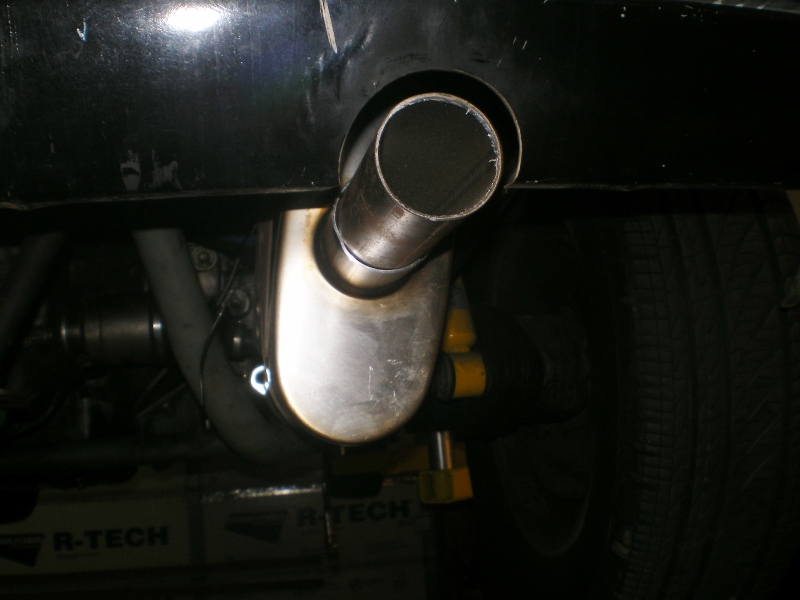

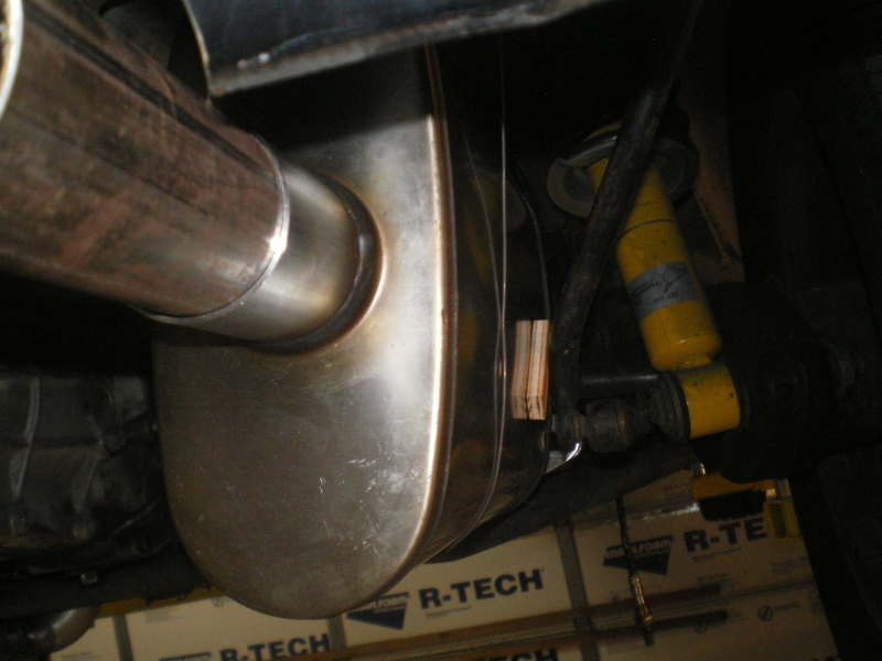

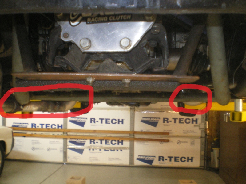

The muffler arrived yesterday and I was able to test fit it. The 4"x9" oval shape works. That's the good news. The bad is that I probably won't use this muffler. It's about as straight thru as the existing Glasspacks. (IMG:style_emoticons/default/mad.gif) No problem. The shape was my main concern. My concerns were threefold. 1st was quite, then clearance and finally use the existing cutouts on the rear fairing.
If you think the U fitting weld joint isn't square your right. It was necessary to center up with the "channel" the muffler will sit in.
These flanges will move in front of the stub axles for added clearance but they actually clear as they sit. I just don't see any sense in crowding the axles if I don't need to.
The strap on the left side of the muffler will be R&R'd during assembly. Managed to hit the old cutout's in the rear fairing. (IMG:style_emoticons/default/biggrin.gif)
That 1/4" wood spacer between the muffler and rear sway bar is there until I spot weld the muffler up.
You can see the ground clearance difference between the old system on the left and the new system on the right. (IMG:style_emoticons/default/piratenanner.gif) Now that I know it will fit, it is ime to order the parts for the left side.
