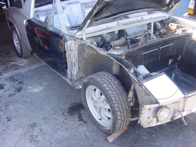

The project started in January 2003 when I picked up the silver roller pictured below. Its a '74 and was pretty much stripped. It had a suspension and a few other parts but was missing a lot of major things like and engine, transmission, glass, hoods, gas tank, interior, wheels, etc. etc.

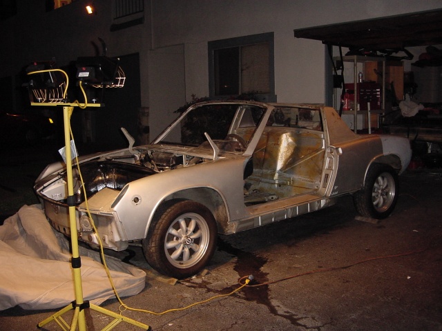

Here's the car as it was when I brought it home:

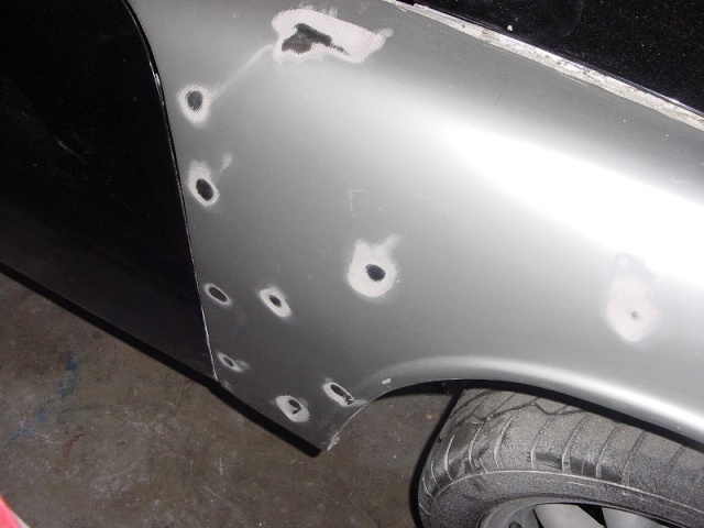

TonyAKAVW   Here's a detail picture. This is the weather ...   May 19 2005, 11:12 AM

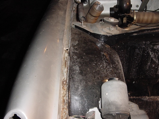

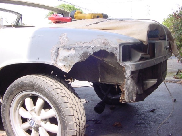

TonyAKAVW   Some more ugliness on the front fender.   May 19 2005, 11:14 AM
TonyAKAVW   Well, the fender was junk, so I removed it.   May 19 2005, 11:15 AM

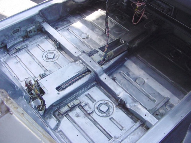

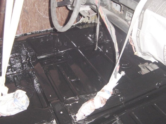

TonyAKAVW   Heres the floor, stripped to metal.   May 19 2005, 11:23 AM
TonyAKAVW   Another messed up fender. I have since found and ...   May 19 2005, 11:24 AM

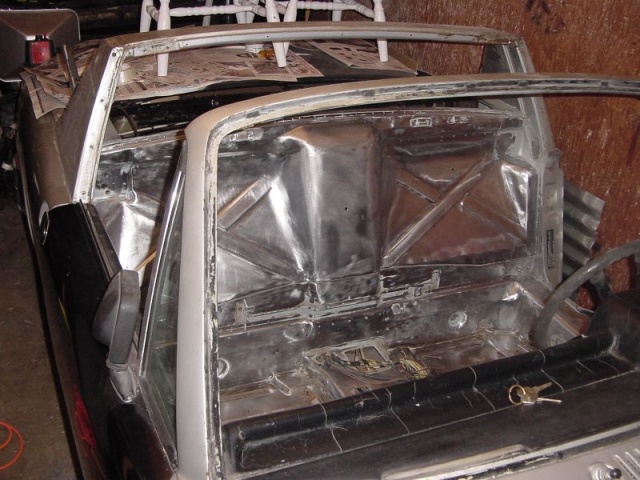

TonyAKAVW   The whole interior got treated with metal etch and...   May 19 2005, 11:27 AM

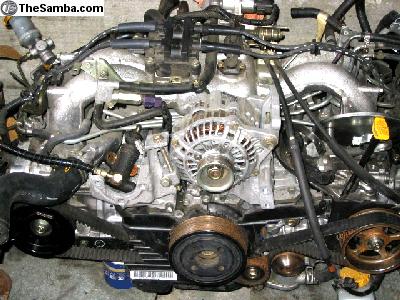

TonyAKAVW   Here's the engine that is going into the car:   May 19 2005, 11:31 AM
Dr Evil   In the first pic your cord is lying in some fluid ...   May 19 2005, 11:33 AM
TonyAKAVW   The motor came with the ECU, wiring harness, and a...   May 19 2005, 11:36 AM

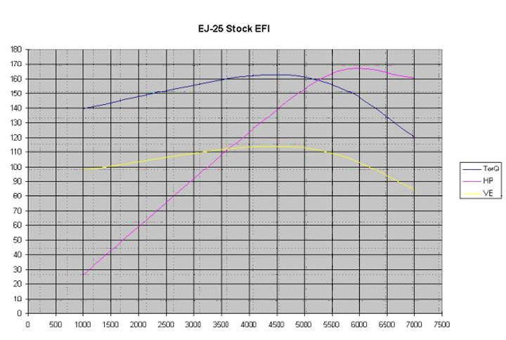

scott thacher   9144guy, i will tell ya the suby 2.5 moves out qui...   May 21 2005, 09:43 PM
