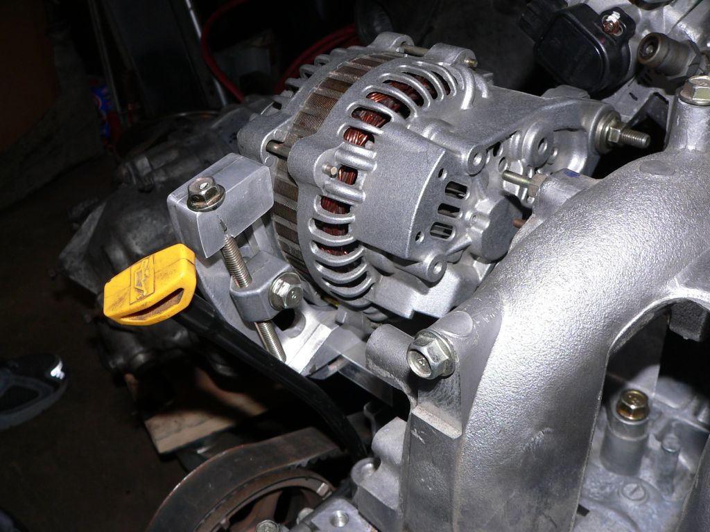

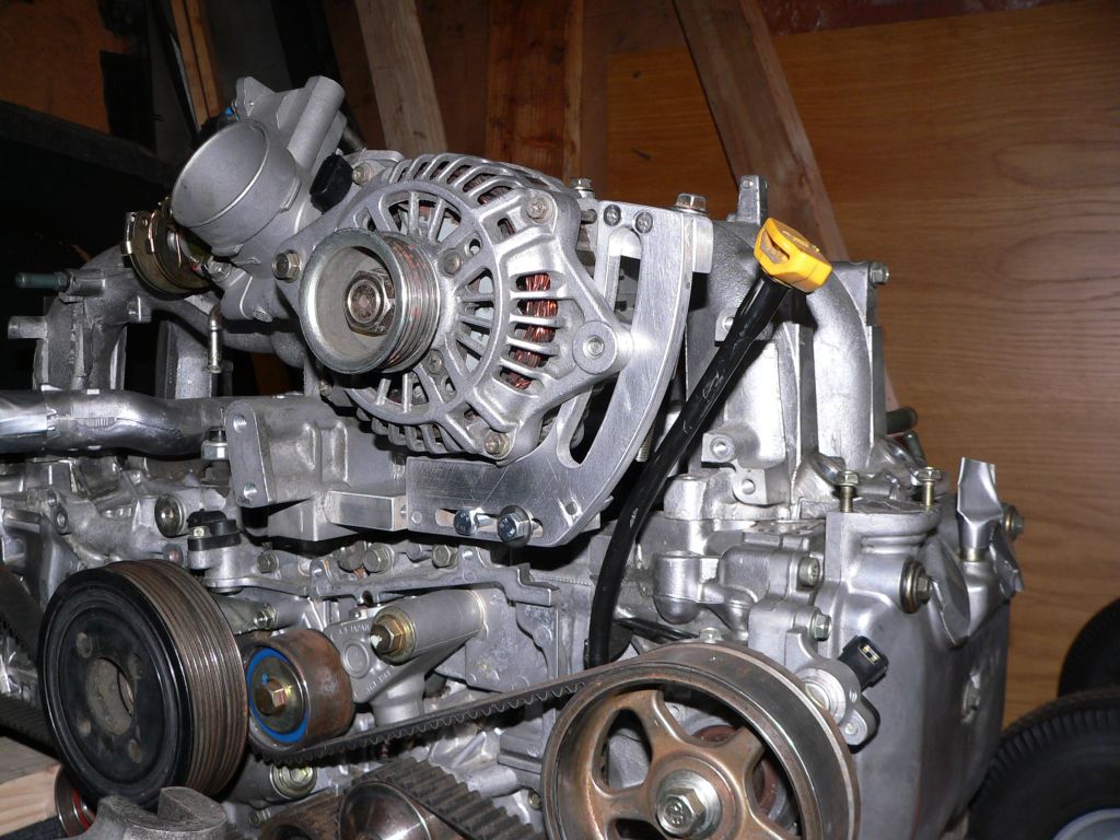

I'm 95% done with my alternator bracket. I need to get a small amount of aluminum welding done, and hacksaw off an extra piece of metal and its done.
Conceptually my alternator bracket is similar to that of others who are doing/have done a Subaru conversion. Basically take the alternator and flip it over, out of the way of the intake, and build the 'adjustment' half of the bracket to hold the loose end.
The bracket was made in my father-in-law's machine shop in the outskirts of Buenos Aires. Thats right, I couldn't go for two weeks without doing some 914 related work. Lucky for me, my father-in-law is really excited about the projecct too. Last time he came up to visit he did some body work for me (IMG:http://www.914world.com/bbs2/html/emoticons/smile.gif)
Machining was done with a mix of tools, including my favorite, the vertical EDM, which we used to make precise internal right angle cuts, and the horizontal adjustment channel.
The original bracket which I took with me caused some problems at the Argentine customs. Upon X-raying my baggage the attendant asked me to pull out the offending metal piece. He held it for a moment, looked it over, asked what it was, still acted concerned, looked it over some more, and eventually gave it back to me. So if you ever want to take stuff in to Argentina, just pack a random piece of oddly shaped metal and it will distract them. Or maybe I just got lucky (IMG:http://www.914world.com/bbs2/html/emoticons/unsure.gif)
Anyway, on with the pictures..

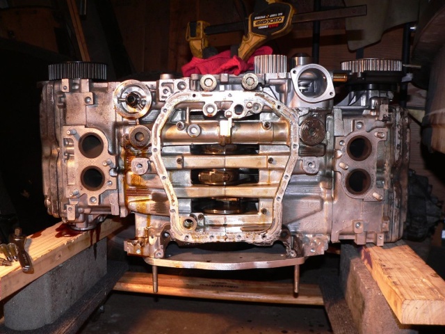

Still working on getting the timing belt installed. I made a stupid mistake of cutting off the old timing belt before aligning the timing marks. Because of this I have some uncertainty of where the timing is. So after consulting with Bondo, I decided to pull the oil pan off, rotate the crank to MDC, and then rotate the cams to their appropriate positions and then the crank to its position. The engine is an interference type, so I can't just freewheel everything into place without being careful.
Hopefully by end of tonight I'll have the timing belt on and install the cover, the crankshaft pulley, etc. I think now is probably as good a time as any to modify the oil pan and oil pickup tube.
Here's a photo of the motor's guts.

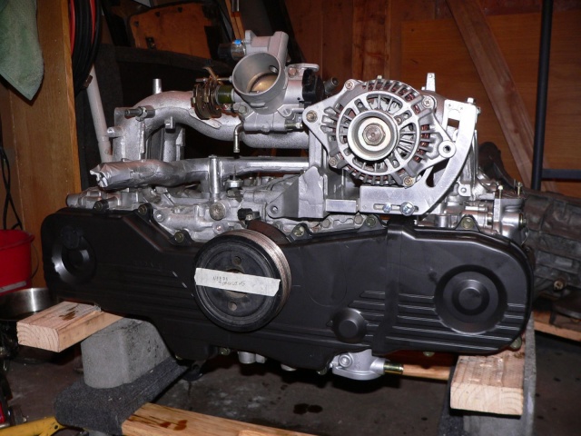

The timing belt is installed and the oil pan mating surface is cleaned up.
Left to do on the engine:
torque the crankshaft pulley
install the water crossover pipe
install the thermostat and water pump right angle pipe
bolt down the intake manifold
install fuel injectors and rails
do all the hoses on the engine and install misc. valves, filters, etc.
bolt down the throttle body
install oil filler neck
modify and install new oil pan and pickup tube
re-arrange the wiring to fit properly.

bad ass alt bracket tony!!!
sooo over engineered!! (IMG:http://www.914world.com/bbs2/html/emoticons/laugh.gif) (IMG:http://www.914world.com/bbs2/html/emoticons/smilie_pokal.gif) (IMG:http://www.914world.com/bbs2/html/emoticons/smilie_pokal.gif) (IMG:http://www.914world.com/bbs2/html/emoticons/smilie_pokal.gif)

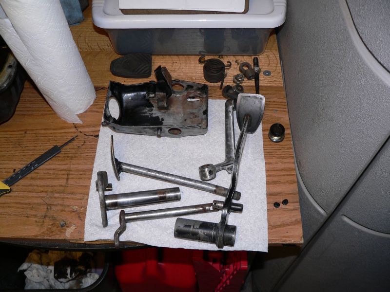

After working on the engine I am taking some time now to work on some other parts of the car which need attention. First up is the braking system which is essentially non existent.
I will be using A calipers on the front which came on the SC front suspension that I have. For the rears, I will be using stock 914 rear calipers but spaced to fit 911 vented rotors.
First things first though. Tonight I worked on the pedal cluster. I really need to send a couple parts to a sand blasting place. These will get powder coacted and re-assembled with new bushings. Because the brake light switch failed I am going to engineer a repalcement for it that whould be substantially cheaper than the repalcement 914 switch.
-Tony

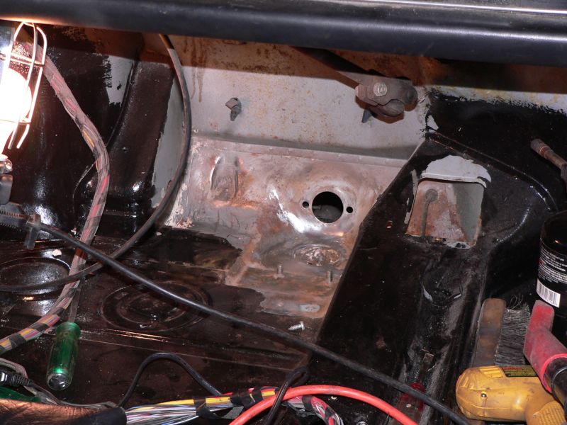

The last remaining arear on the interior of the car to be POR-15'd is the pedal cluster area, and tonight it got stripped down and got the usual pre-treatment. Might be able to get it painted tomorrow night.
-Tony

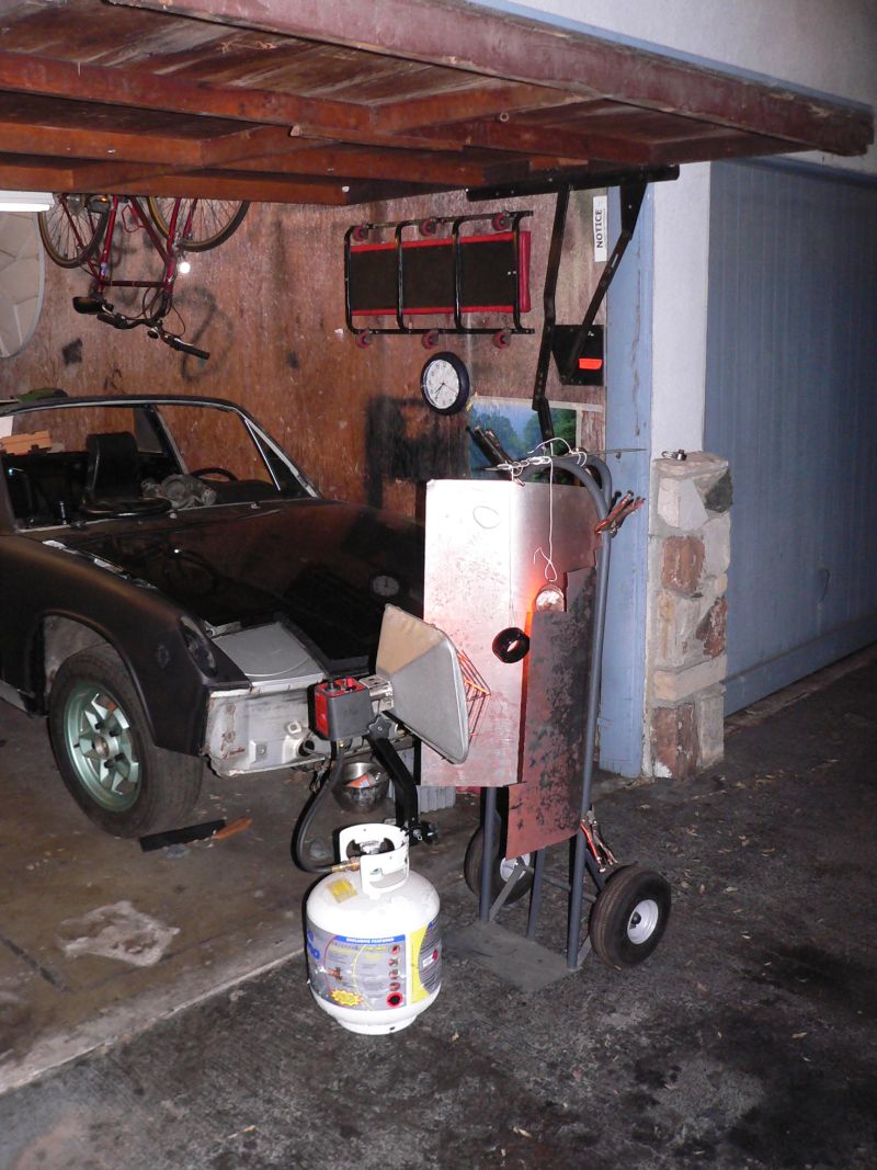

I did do some powder coating however and made a really quick and dirty oven. I took a piece of sheetmetal (rusty of course) and bent it into a U-shape and clamped it to my hand dolly, and set the propane heater in front of it. I then suspended the parts with teflon wire, (which is great for the powder coating and heat resistant for curing) and after coating baked them. I suspended an oven thermometer in the back, to ensure that I was getting to 400 degrees even at the back. Seemed to work quite well.
-Tony
