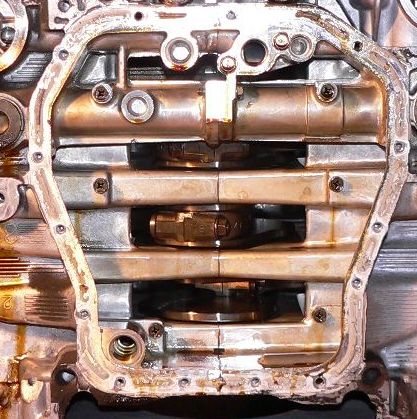

Running the crank into the oil has the same effect as riding a bike into water. check to see if you can get a windage tray for your application as they work to "scrape" oil from the crank, prevent some of the "foaming"and provide a slight barrier to oil slosh, they bolt on to extended main studs, in a SBC they can give a rather significant HP gain as well.
TonyAKAVW
post Nov 2 2005, 05:32 PM
Post #177
That's my ride.
Posts: 2,151
Joined: 17-January 03
From: Redondo Beach, CA
Member No.: 166
Here's the bottom of the engine looking inside. The crank is above the top of the oil pan considerably.

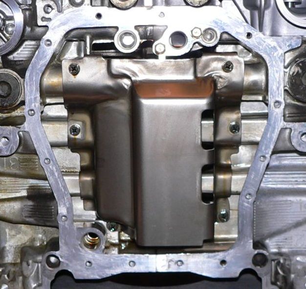

And here it is with the windage tray in place. I suppose that blocks some of the oil splashing.
