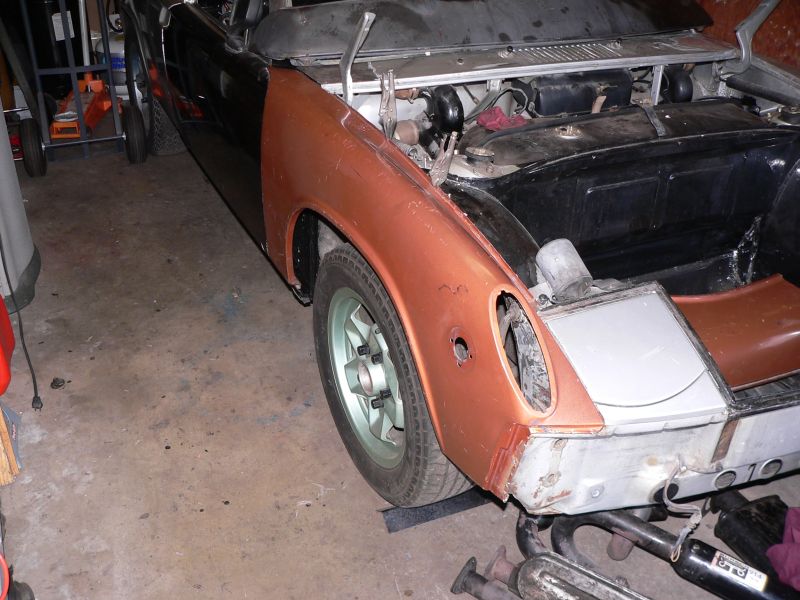

Here's the new front fender held in place with vice grips. When I got the fender it was essentially a quarter of a 914. It was a real chore to first cut off 90% of the excess metal and then drill out every single spot weld. Bondo helped out a lot by letting me use his brand new plasma cutter. I think that is perhaps one of the coolest tools around. Just the thought of vaporizing steel with electricity!
You can catch a glimpse of the new rear fender section in the front trunk.

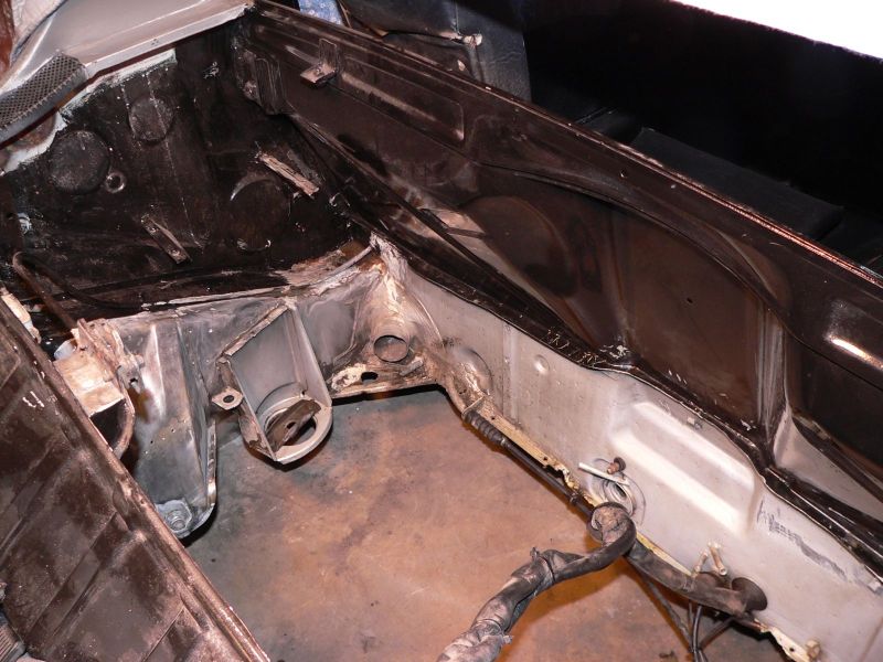

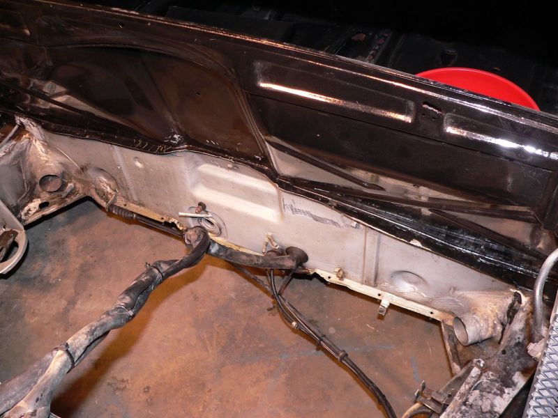

Spent a few hours today cleaning out the unnecessary metal from the engine bay. The mtal I took out is the metal that surrounds the type 4 engine tin. Its unnecessary for a water cooled engine, so to make more space in the engine bay I got rid of it. I may also remove the stock engine mounts but for now I see no good reason to remove them other than aesthetics.
I have a bit of welding to do on the hell hole side of the car, but its not going to be too bad.

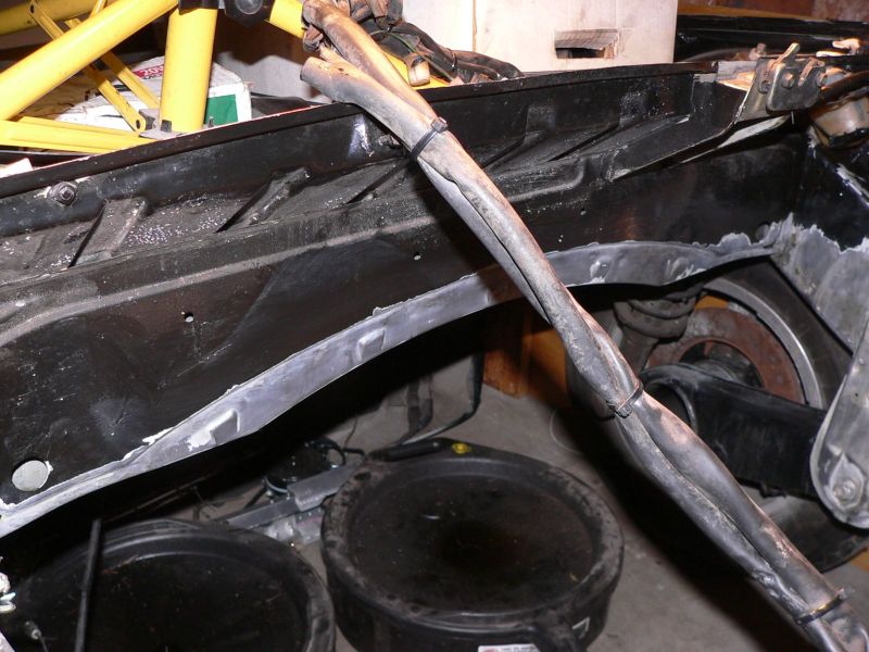

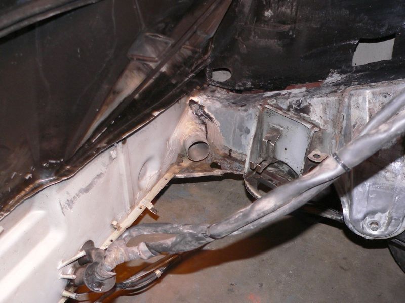

Some of the metal coming out from the firewall is still there. It comes out about an inch or less along most of the firewall. Getting rid of it alltogether is a bad idea, because the two halves of the fireawll joing together. If I need to remove more later I'll do so, but I suspect I'll be fine.

Next step is to paint over the bare metal with POR-15. I gave it a good treatment with a phosphoric acid rust converter, washed it off and dried it.

Dood, your metal cleanup work is beautiful, way clean.
nice!
Thanks!
I used a combination of cutoff wheels, grinding wheels, and a wire brush wheel.

tony as for the engine bay clean up what you did is perfect, the engine will fit very well. before you go any further i would recommend getting the wiring harness, fuel, and brake lines secured or set up to be. the reason i say this is the next thing you will have to work on after por 15 will be motor mounts and radiator frame. as a matter of fact you might want to start on the mount now so when you por the engine bay you can por the new mwtal as well.
edit: tony you could remove the stock motor mounts but they are really really well attached line 50 spot welds per mount
